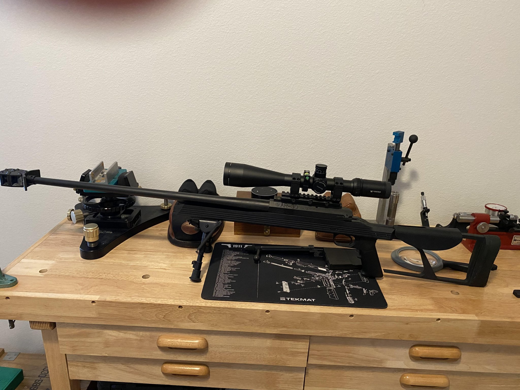

I do have this old 20min riser. It's made by UTG Leapers, so I'm sure quality is low and I hate the thought of it being on my rifle. The thing is it seems to be a solid chunk of medal, it's heavy but with a rifle that's already heavy it doesn't matter.
So now if I use this I will have the 20 MOA and the 15 that came on the action. Do you think I'll still be able to sight in at 100yds with 35mins in my base?

35 moa won’t zero at 100 with that scope probably.
Also you’ll find at the upper end of travel shading appears and image starts to suffer.
