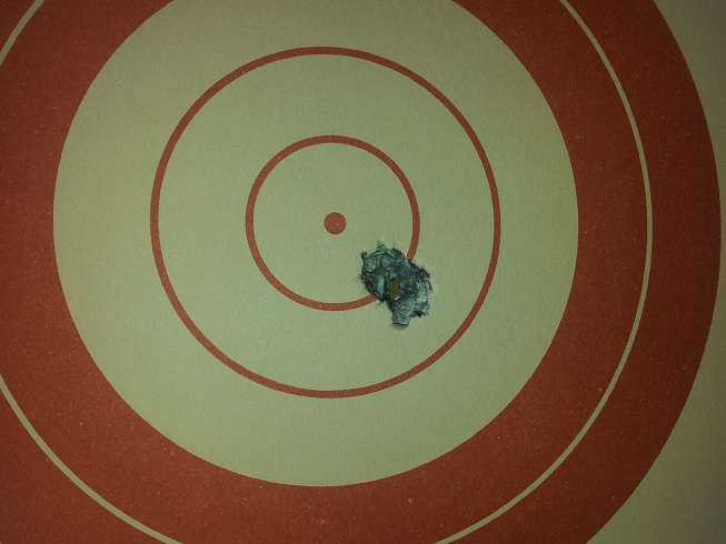

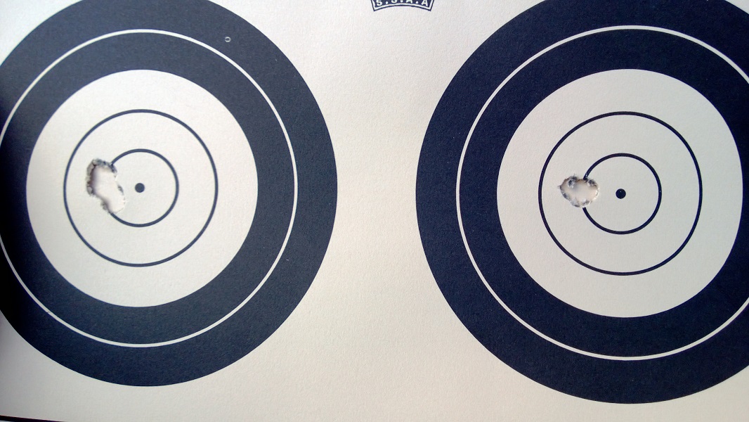

I have a 20'' 308 w/1:10 twist, I was told when I bought the rifle that 155gr ammo will not work well with 1:10 twist. Well since I had two cases of ammo bought (long story) prior to receiving the rifle I decided to put the 155's to the test, I have put 60 rounds down range and my average 5 shot groups are between 1/2 and 3/4 moa (with two groups smaller than 1/2 moa). So is there anyone else shooting 155's out of a 20" 1:10 twist with similar accuracy? Oh and I am using factory Hornady TAP ammo.

Dyers 155gr over 46.5gr AR2208 (varget) jammed 10thou from a 24" 1:10 Krieger.
I have a 22" 1-10 Spencer barrel that loves the sierra 155 gr palma match. I run 44.5 gr. of varget and Federal 210m primers. It drills the same hole every time and kills amazingly well also. I'm re-barreling that rifle with an 18" and will work up the load when that gets done for a dedicated hunting rifle.
I'll also work up a load for the 155's with my Tac Ops which also has a 1-10 but a Krieger barrel.

I have a 20" 10 twist shooting 155's 1/2 moa and under. Tell that gun store guy he needs to do more shooting and less talking.
