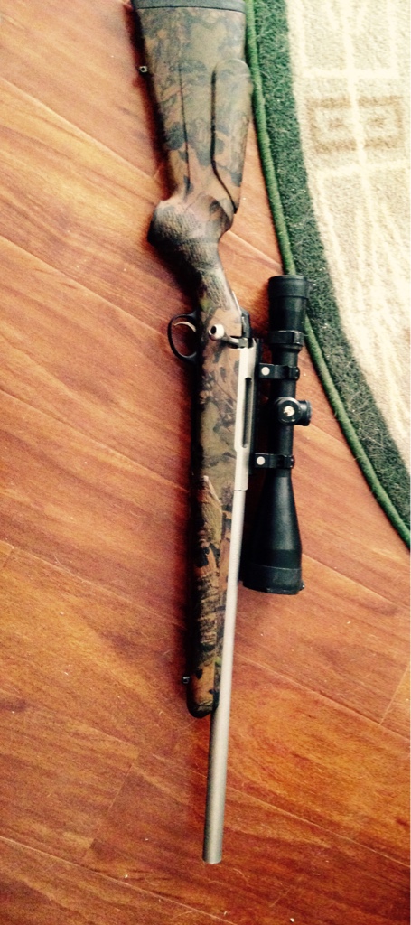

Marlin XS7 308 with factory bbl cut to 16" , threaded 1/2x28.
Bolt knob chopped and threaded for Atlasworxs bolt knob.
DIY stock forend widening and stiffening.
DIY grip texturing/action bedding.
Paint job courtesy of the Krylon Custom Shop. [emoji12]
ARC M10 rings.
Razor HD gen 1 EBR2B
SAS Reaper TI
I can't wait to try this with some factory Lapua 155 Scenars!
Very nice ! Post results for 155 . i would like to try them myself.

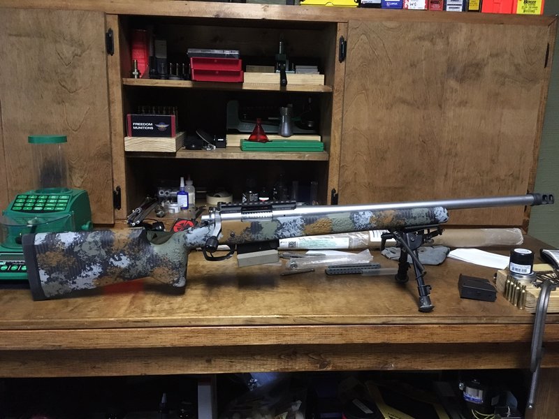

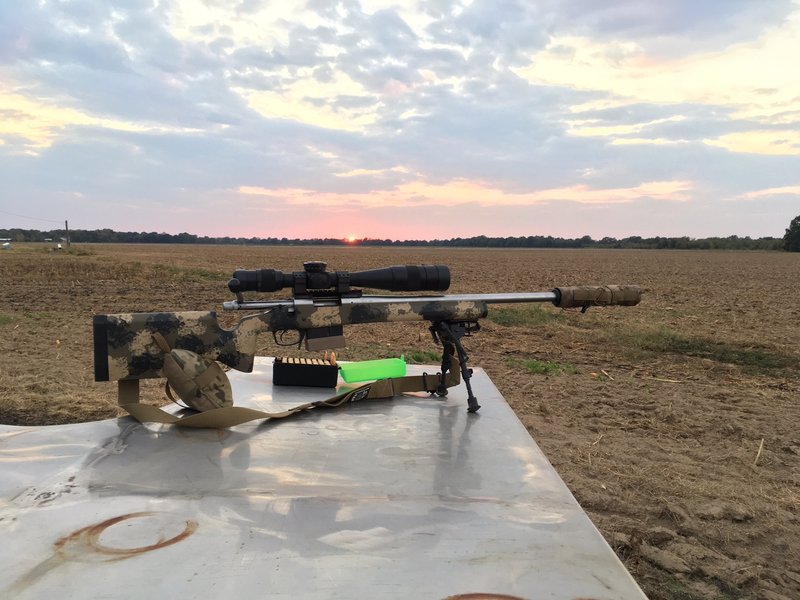

I finally put on my 16.5" barrel. It's a switch barrel setup built by RWS and I couldn't be happier with the way it turned out. I plan on working up a load and shooting it next weekend so I'm ready for some coyote hunting.

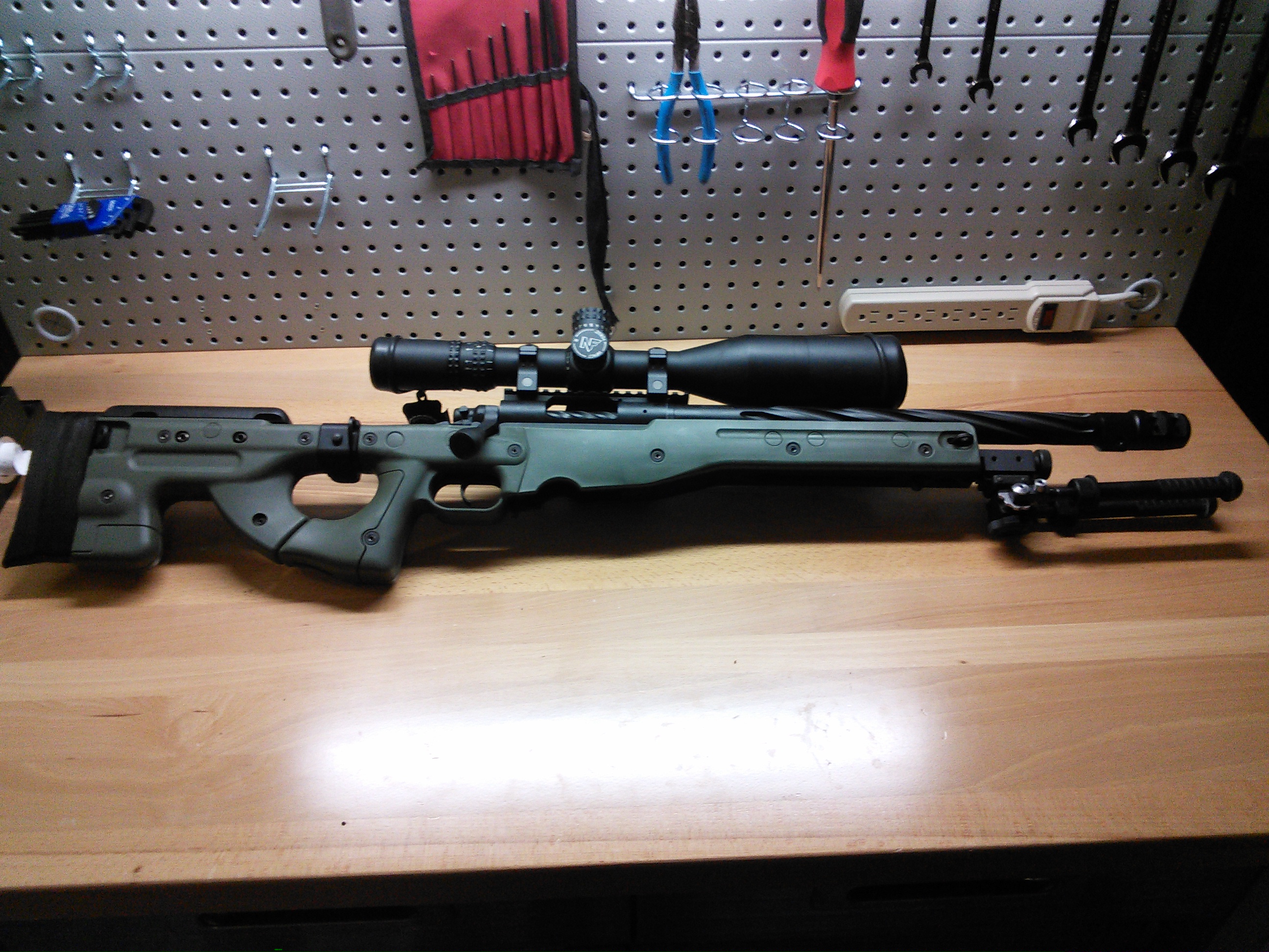

My 18" 6.5x47L.....one of my favorites.

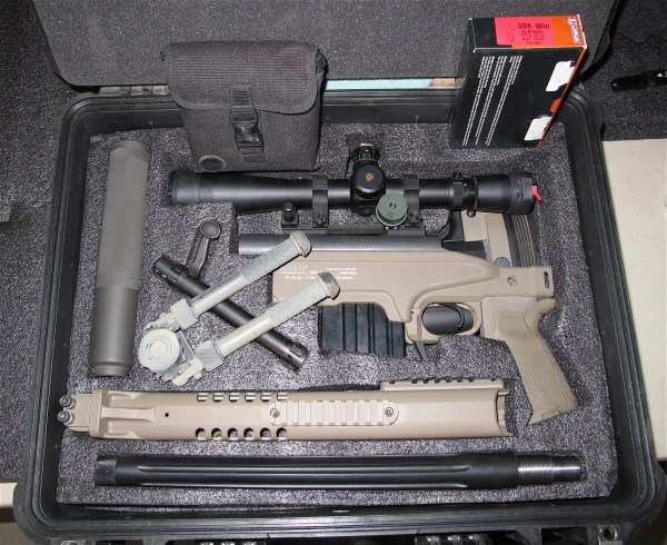

18" RVC Bartein
Timney
LRI knob and flutes
PTG DBM
LRI lug
All cerakoted in Coyote Tan
Trued R700 SA spun up by LRI
MCM Gamescout 40% MD Tan, 30% LtTan and 30% Black
Did you get the weight of the EH1 mini chassis vs the T4 mini chassis?
Looks good by the way.
Thanks TJ. Yeah it saved a 1lb. Of course bedding, with aluminum DBM, would've saved more. Mini-chassis is pretty much 10 ounces or .62lbs, that puts it almost exactly at 2.5lbs, a pound less than the T4. The bartlein blank behind it is the same contour (sendero/varmint) planning on starting it at 18 with heavy spiral flutes, plus an LRHS, i think i should meet my goal of 10-12lbs, obviously leaning toward the heavier side of that spectrum with the can. Hard to argue with the mini-chassis for the price when the stock would be 675$ out the gate, quality DBM is going to run 275$+, then bedding 250$+, then i also didn't have to wait for it to be built, which is a huge reason i put the T4 up.
I checked the Mini-chassis when i got home thought it would fit the Timney 2-stage but it still doesn't. That safety pivot pin that goes in and out when actuating the safety is still binding. So now i'm thinking i'm going to either put a relief cut in it myself or sell the timney and just move to a single stage triggertech.
