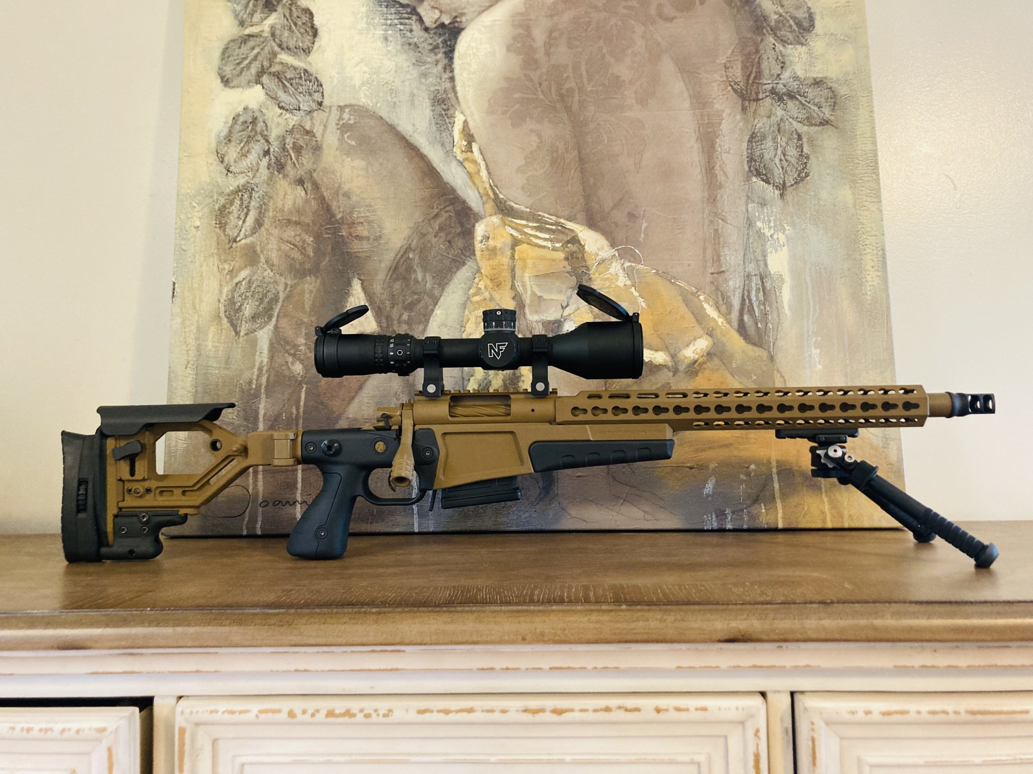

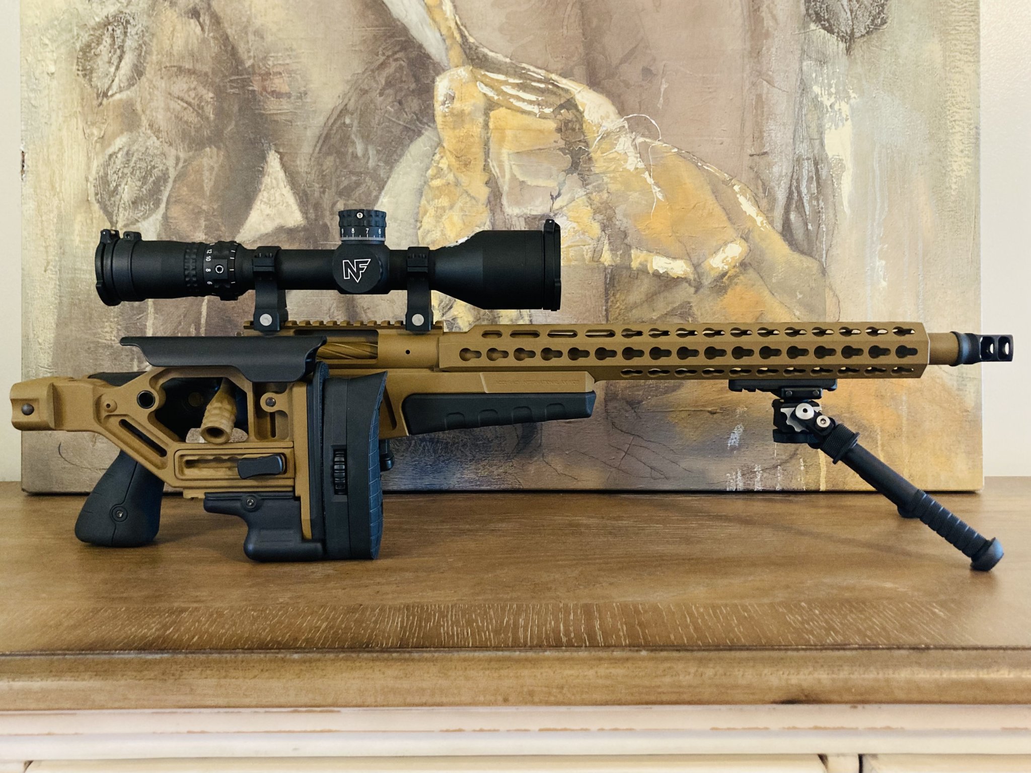

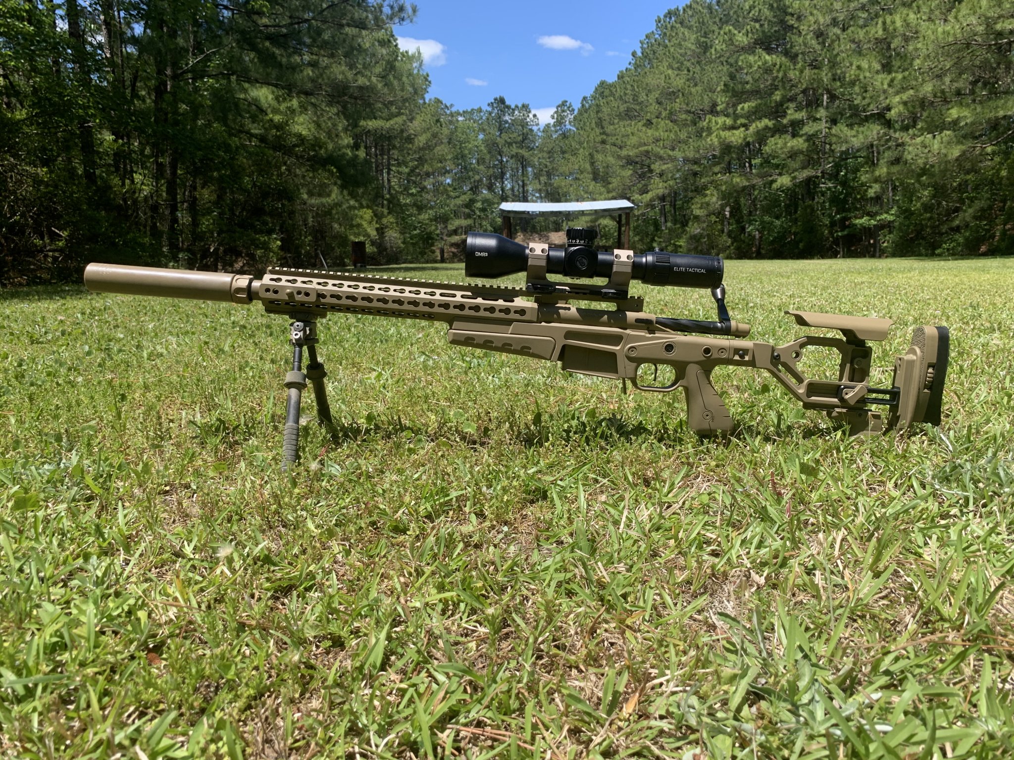

Has anyone done a short 16-18” 6.5x47? I’ve always been intrigued by the cartridge. Of course, I could just do another 6.5cm.

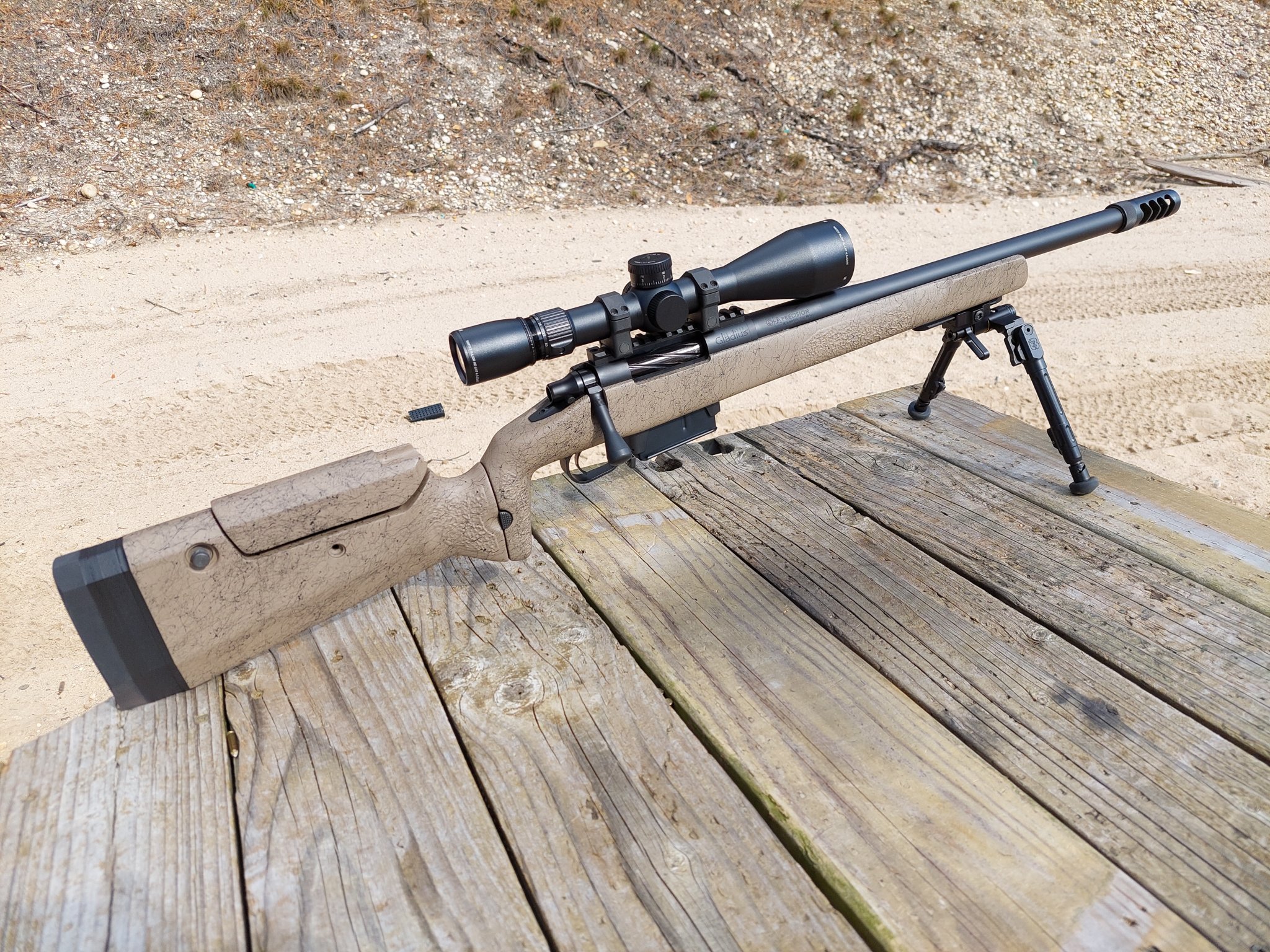

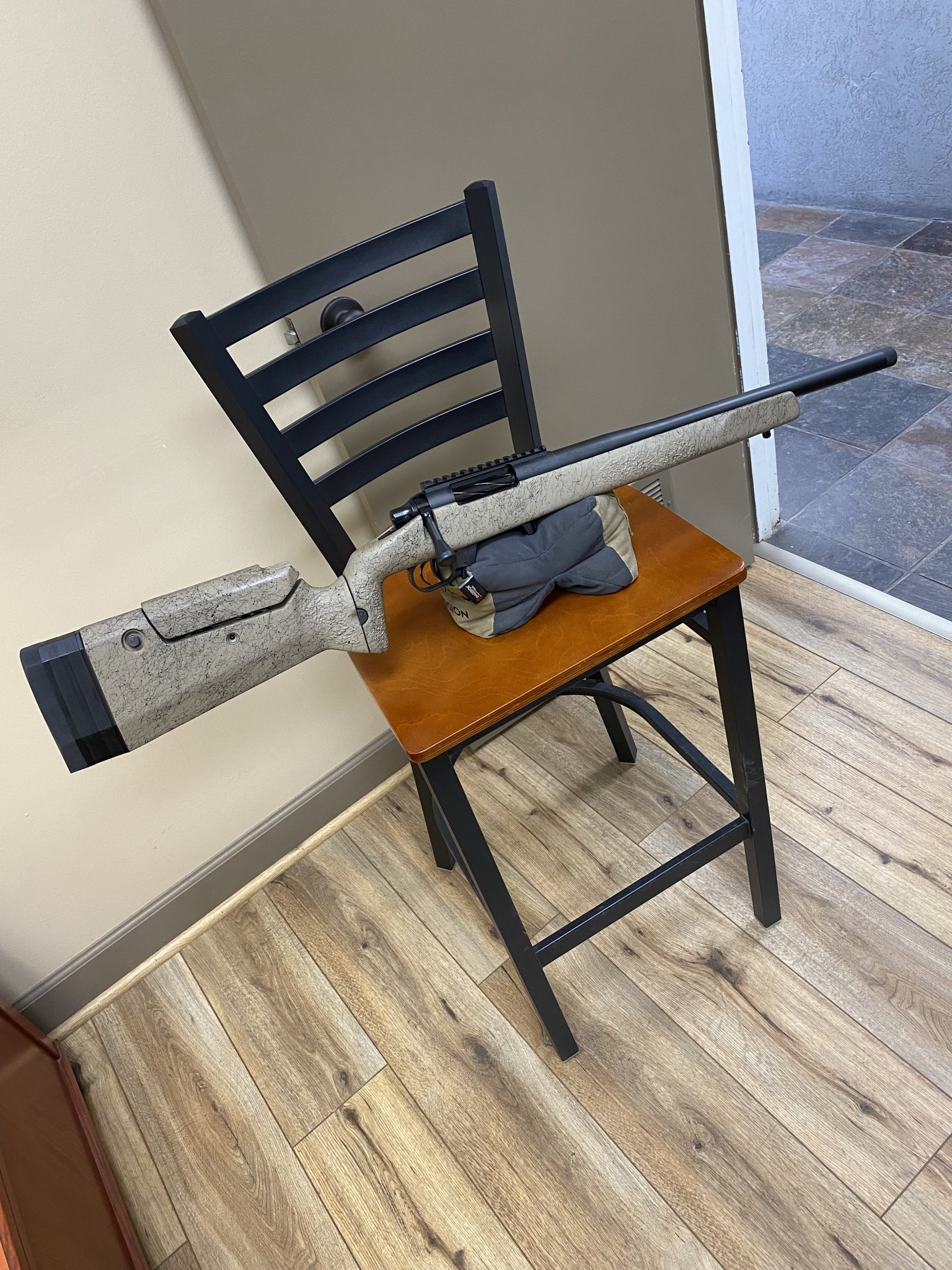

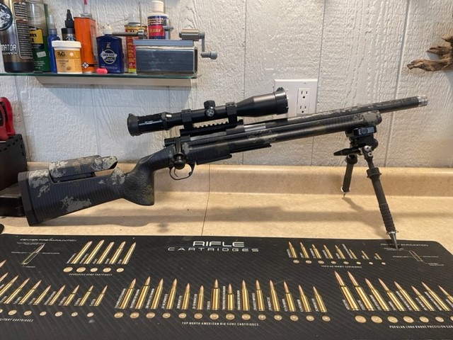

Picked up a used PVA barrel on here and chopped it to 18”. Slapped this rifle together with some spare parts to see if I’ll like it. Getting 2700 with 130HVLD over 37gr Varget. I might pick up an 18” bartlein Carbon for it.

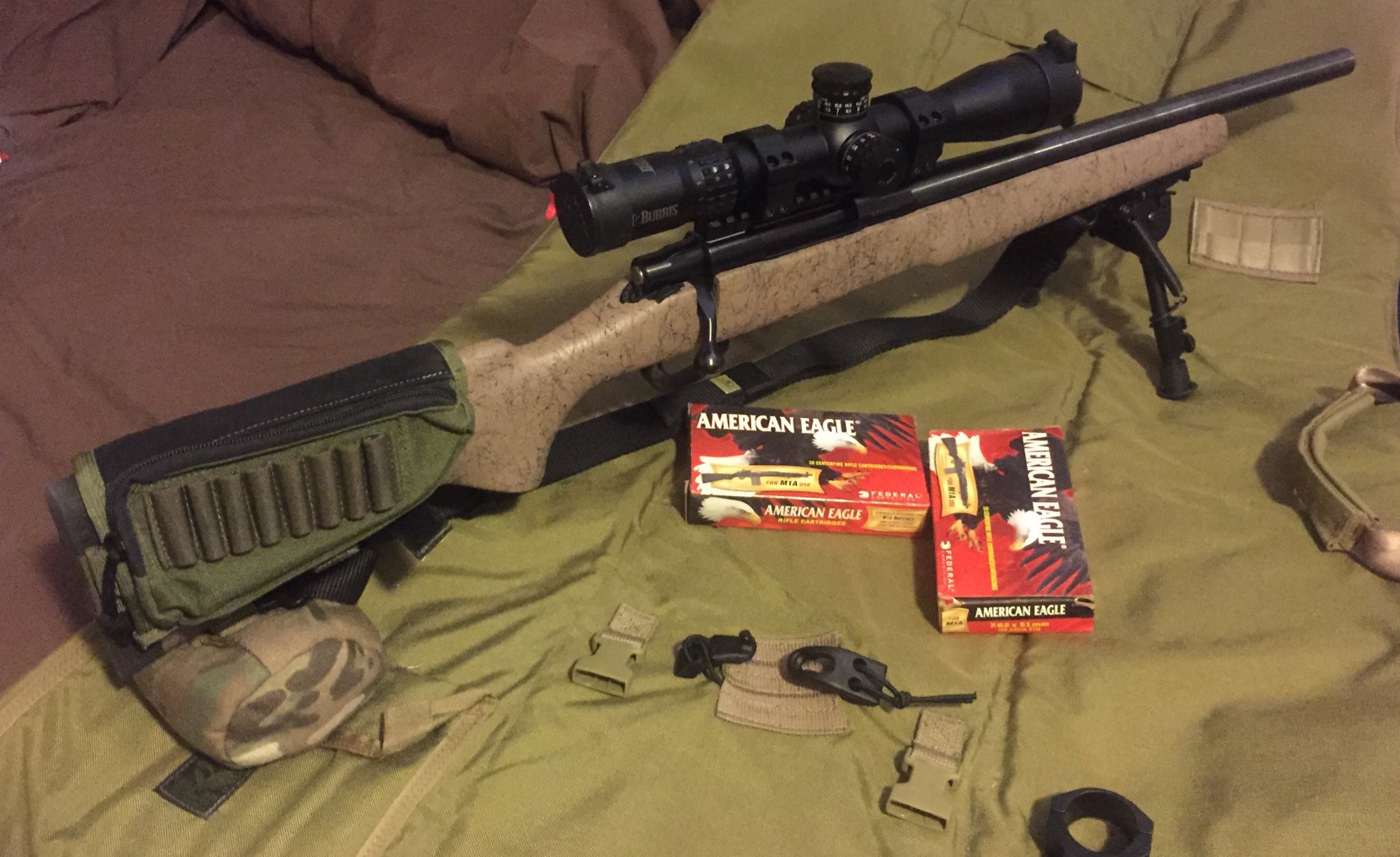

Finally got my first shorty 6.5 wrapped up. First 5 shot group after a little break in and zero was .53” with factory Prime 130 so should be a good little deer blind and range rifle.

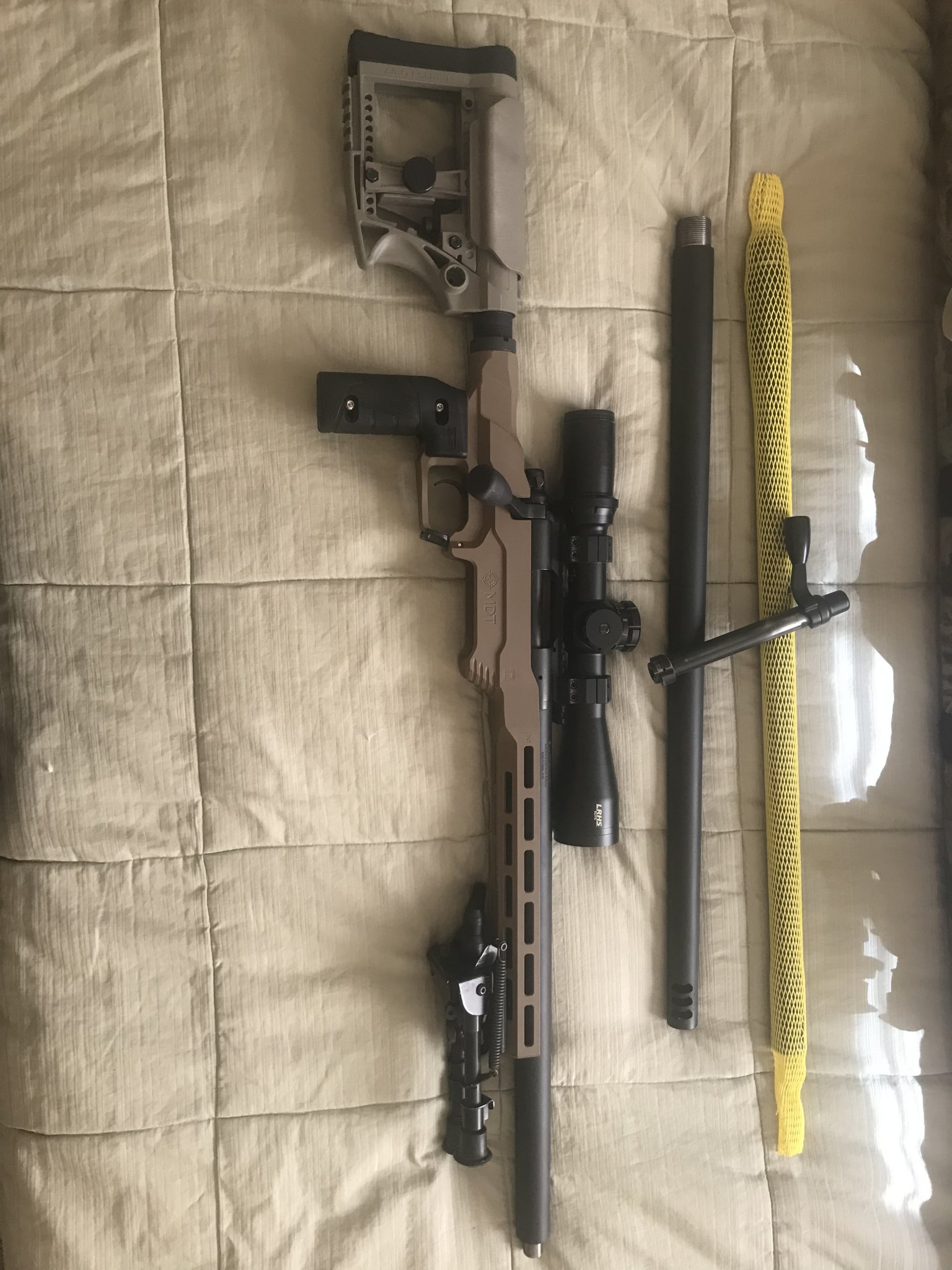

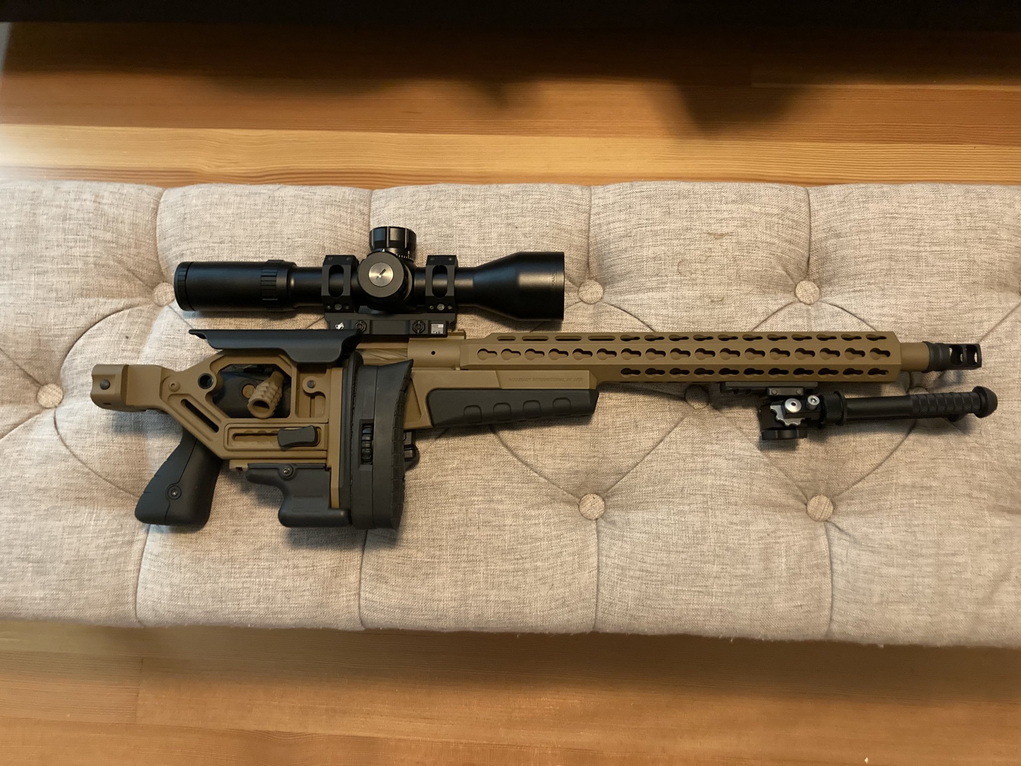

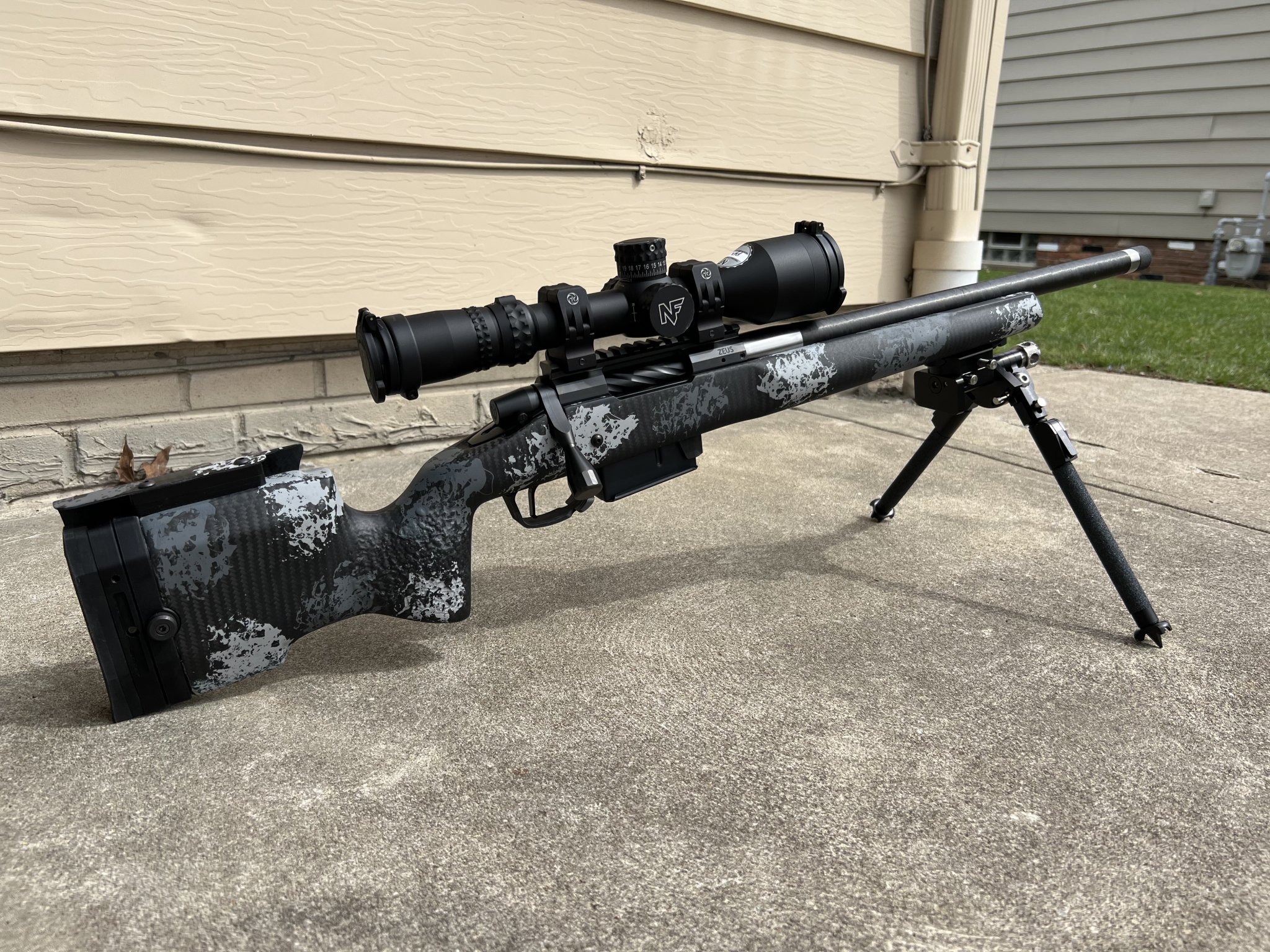

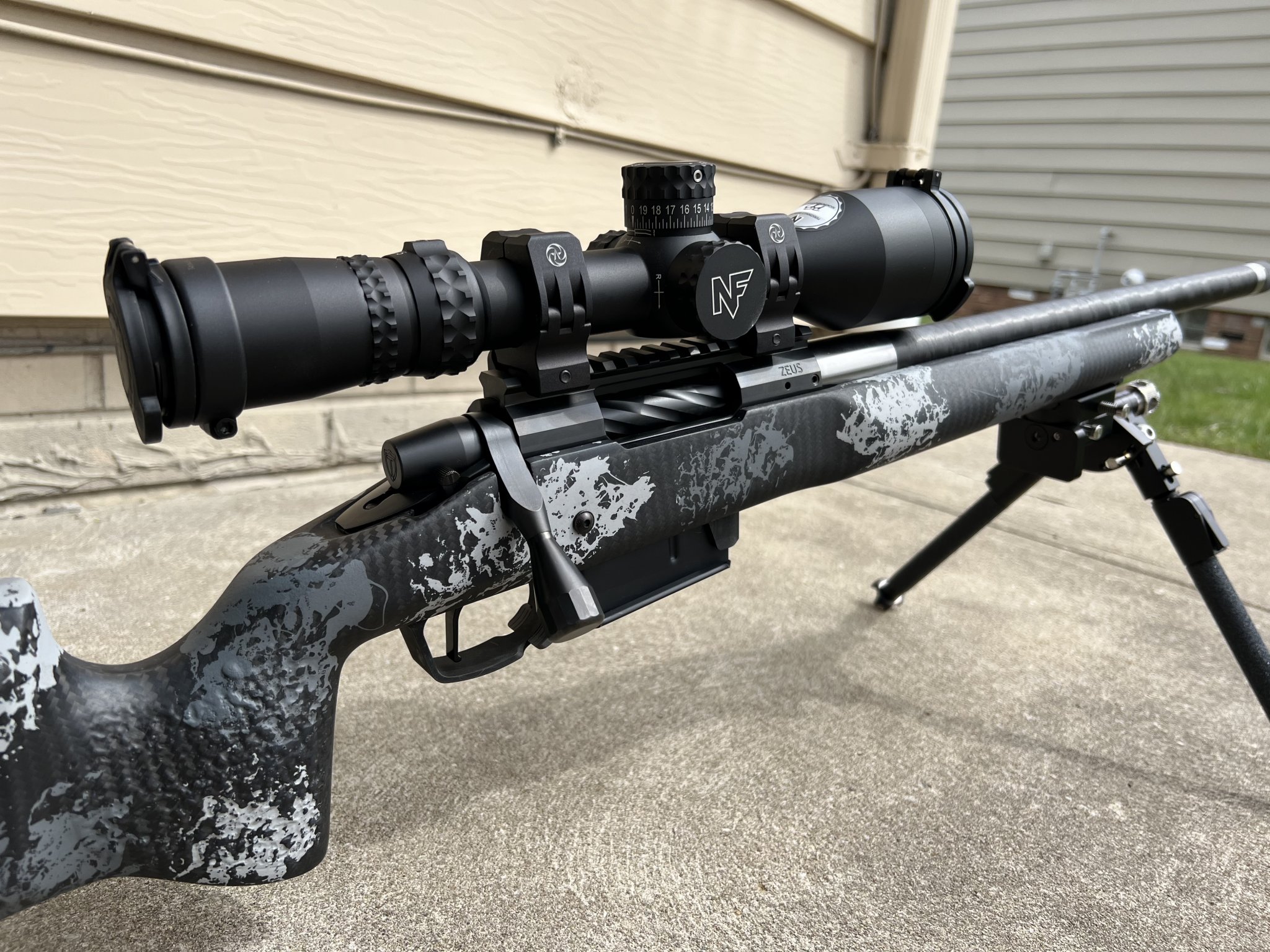

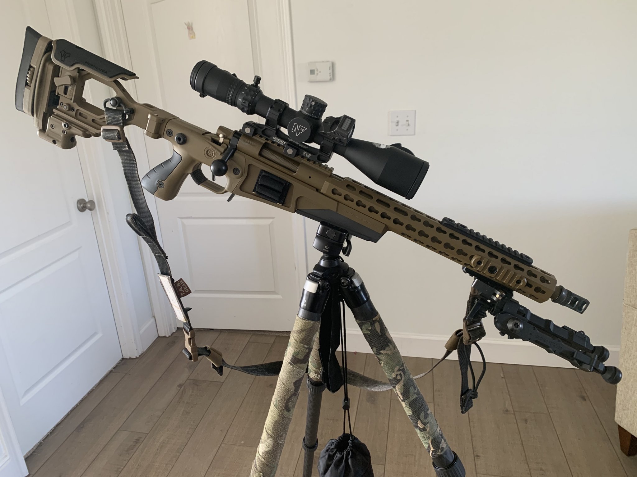

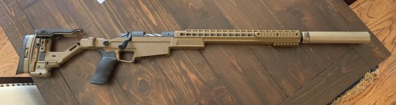

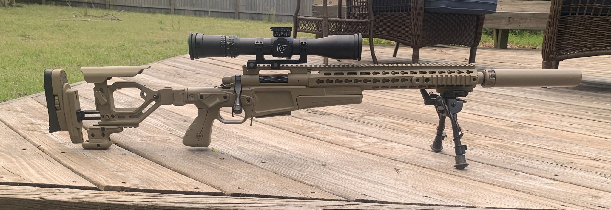

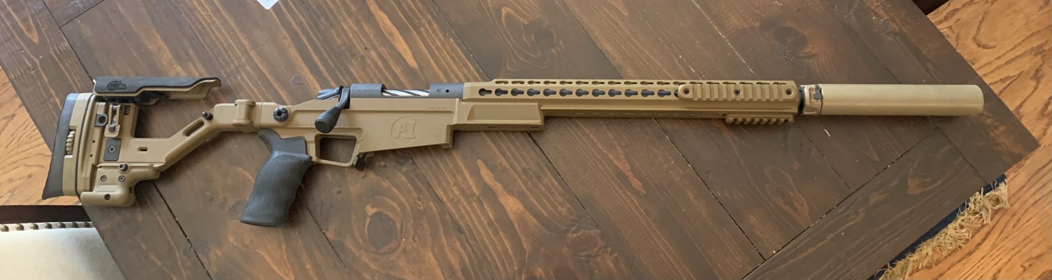

Got my kid’s 18” .223 all finished up.
Some break in and quick load development led me to this.
Thats 5 shots, 100 yds.
Kinda slow speeds at 2625, but tight SDs. Not many rounds through it, so expecting some speed as time goes on.
Pics of rifle coming.
Rem 700, Brux 1/8, .223 Wylde chamber.
MDT LS XXL and MDT vertical grip with a Luth AR butt stock to get the needed 11” LOP. Seekins 20 MOA base and rings. Bushnell LRHS 3-12.
ETA: Shown below with .473 bolt, 6BR barrel, and a 6.5 creedmoor barrel in the plastic sleeve.
Kiddo is dry firing daily, really getting stuff down.

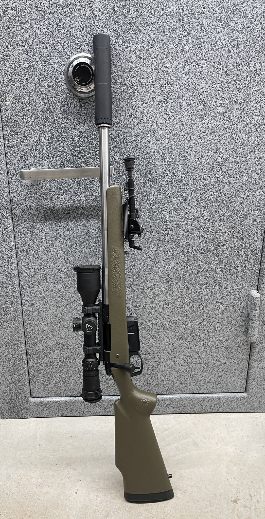

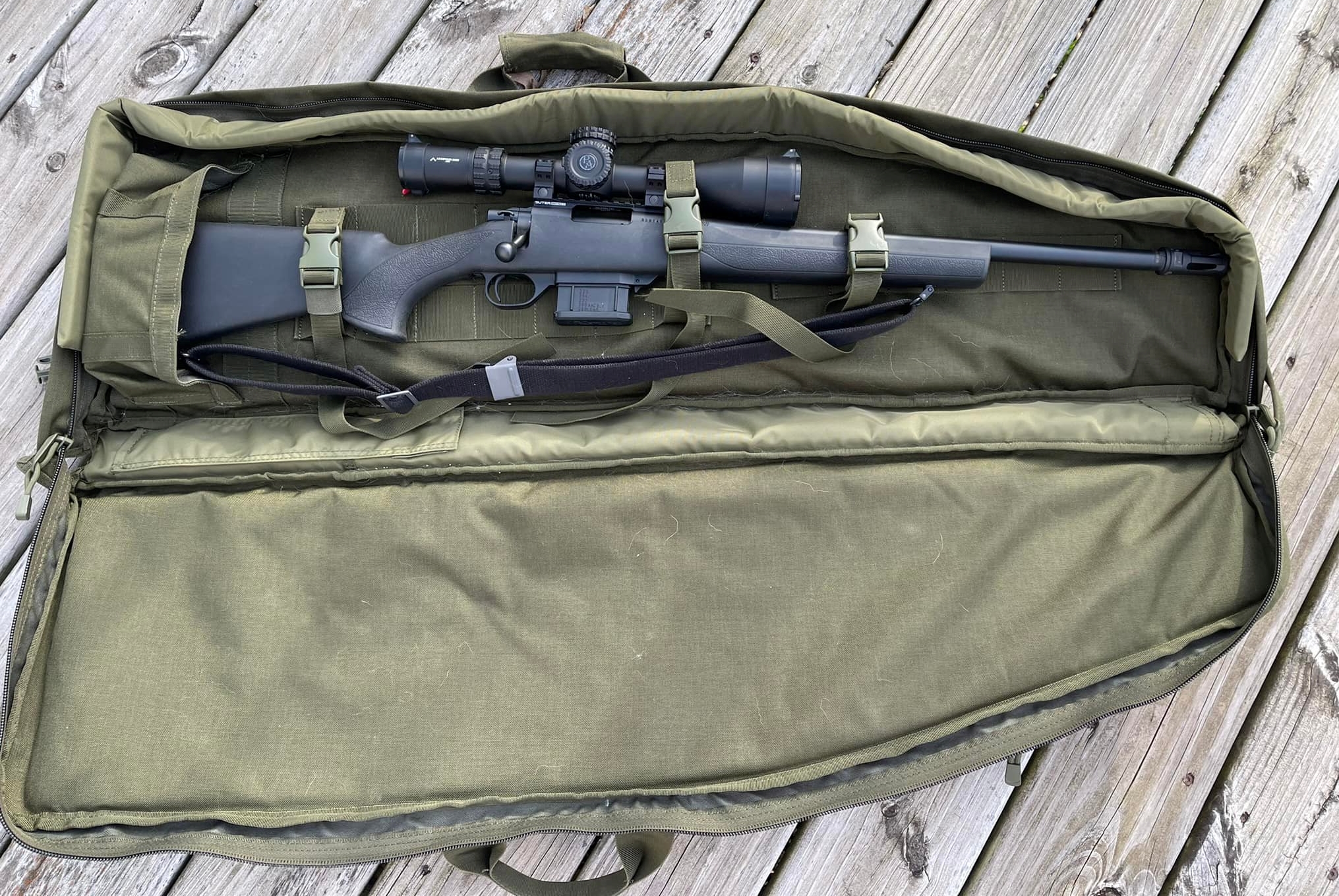

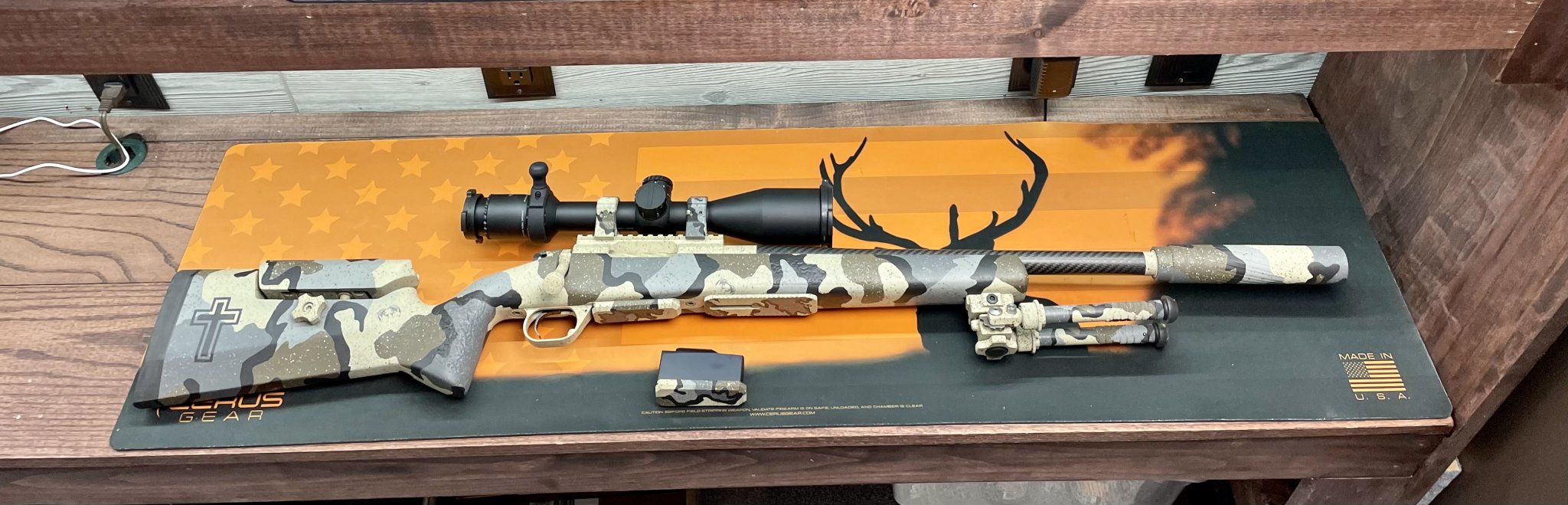

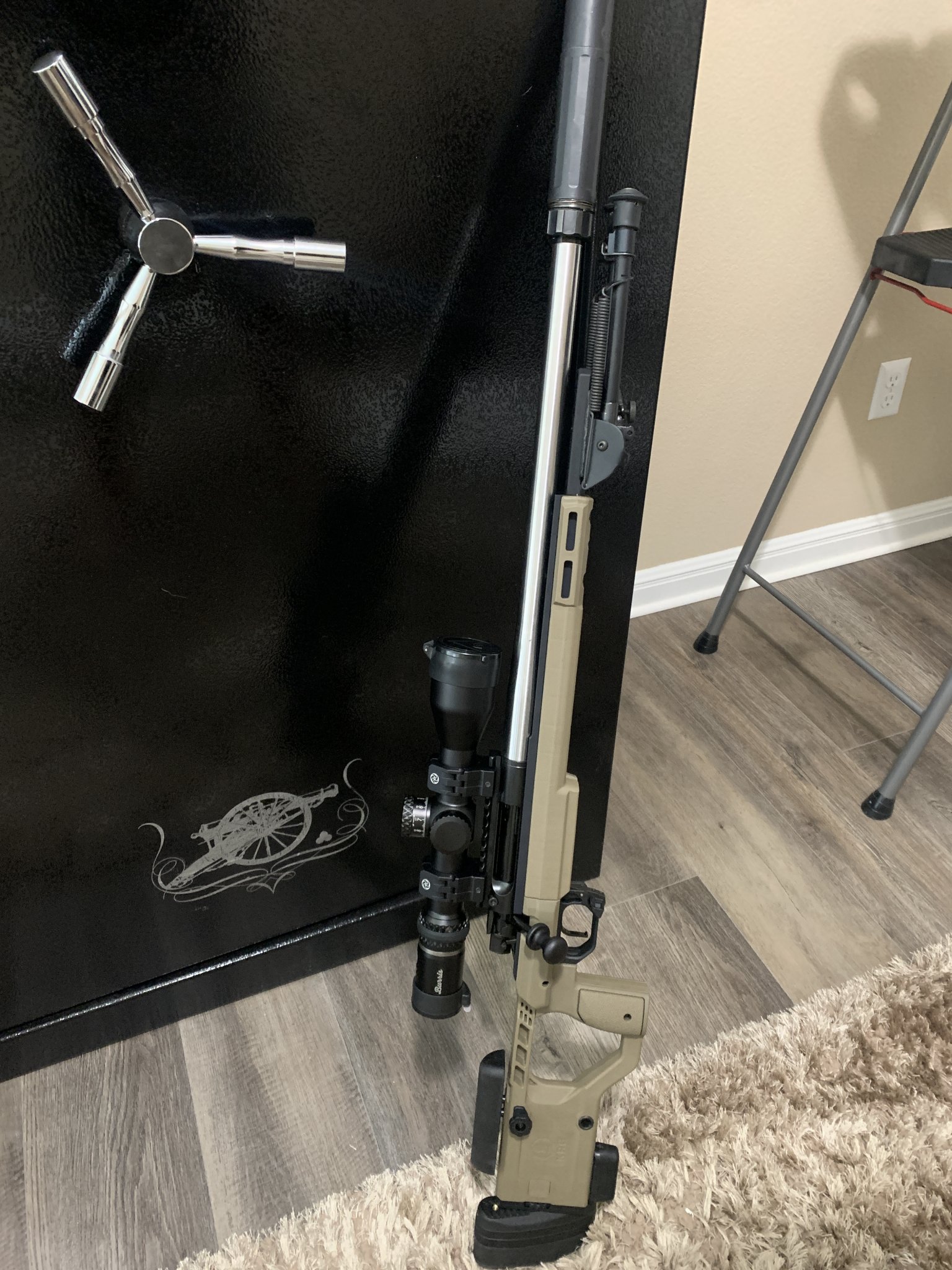

Mini Howa in .223 with 18" heavy barrel, and Primary Arms Glass.
Oddly enough, I was happy with the factory 20" barrel, but sold an old rifle, and wanted this one to fit into my leftover AIM Tactical drag bag... Boom, it had to lose 2" off the barrel because I wanted to keep the suppressor mount.
That AIM bag looks nice.
Gonna snag one for my kids new rifle.

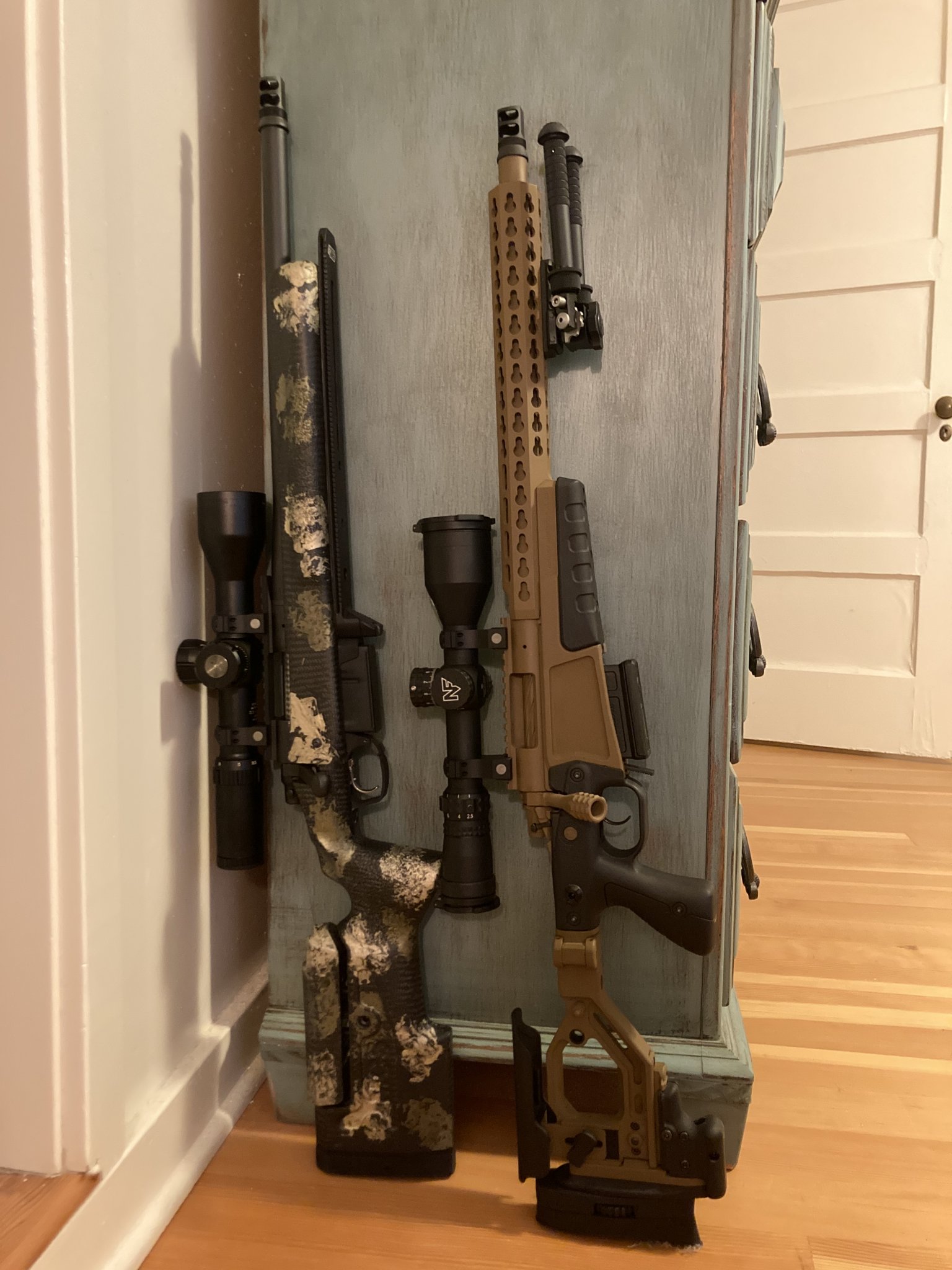

And a 2 barrel sleeve and bolt holder set from softcock on here. Looks there would be room for them on there.
All I have are 175’s right now. They are running 2450.
Have 150 and 162 eld’s on back order

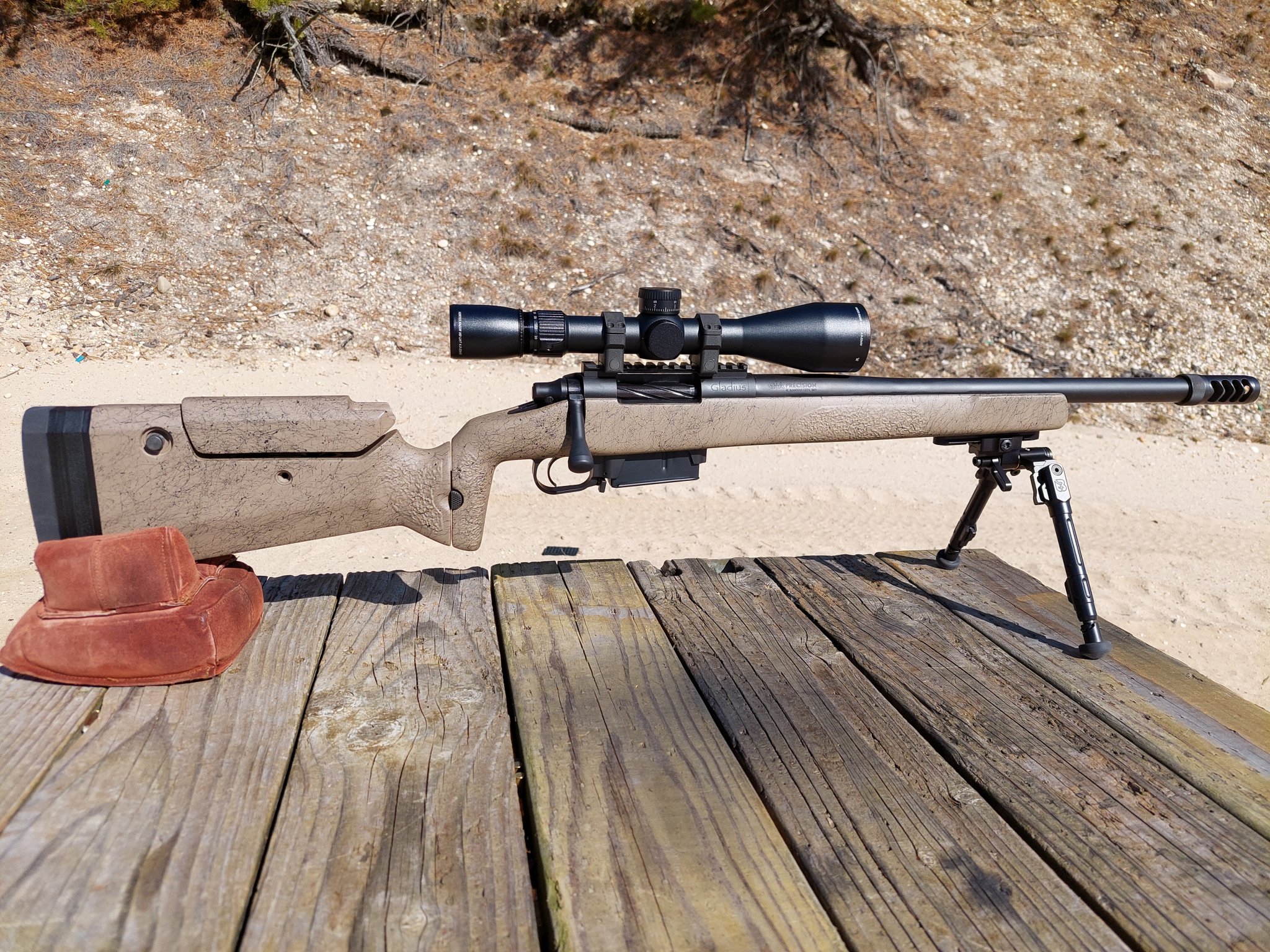

Nice, I dig M70s, and would like a shorty 7mm-08, that bottom rig speaks to me. Are you running the factory 9.5 twist tube? If so, are you getting good stability with long 175s? If it's been re-barreled, who did you have do it?

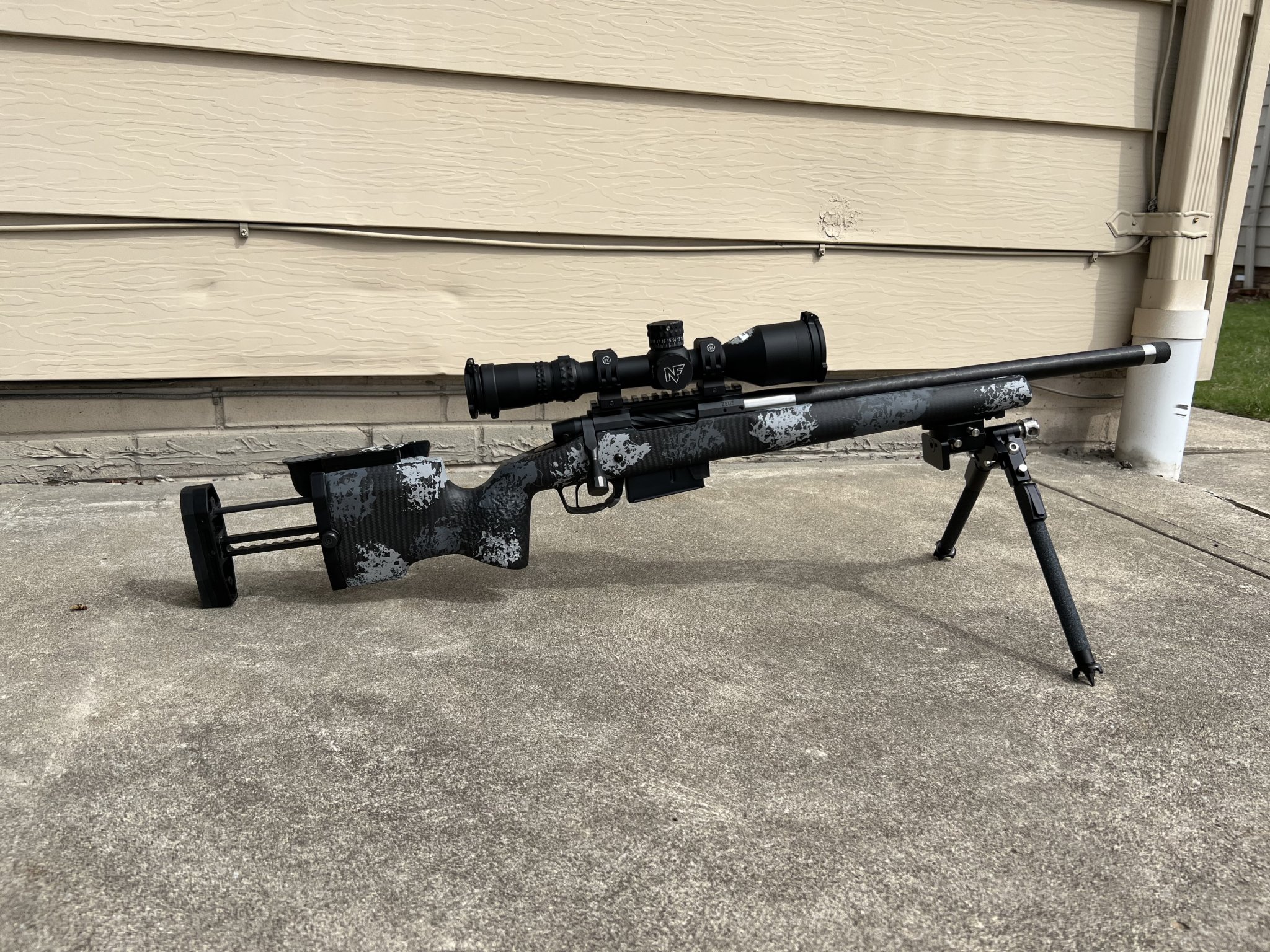

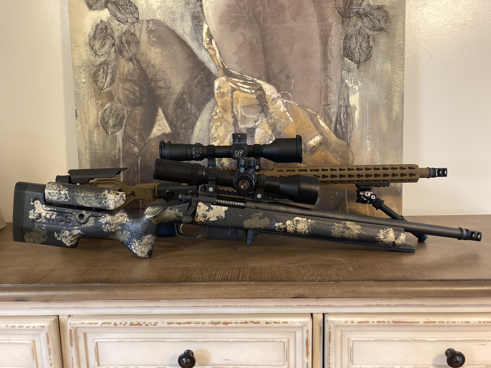

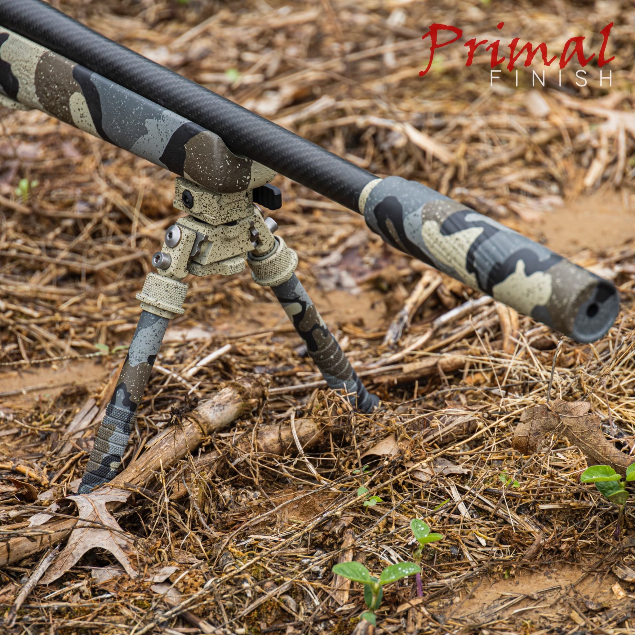

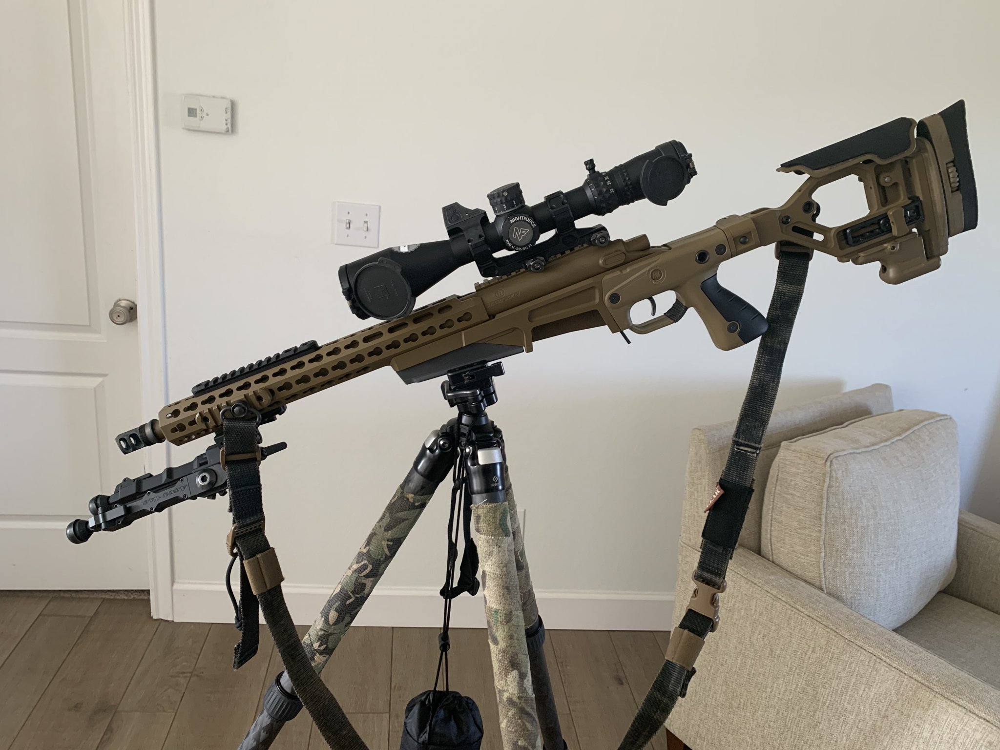

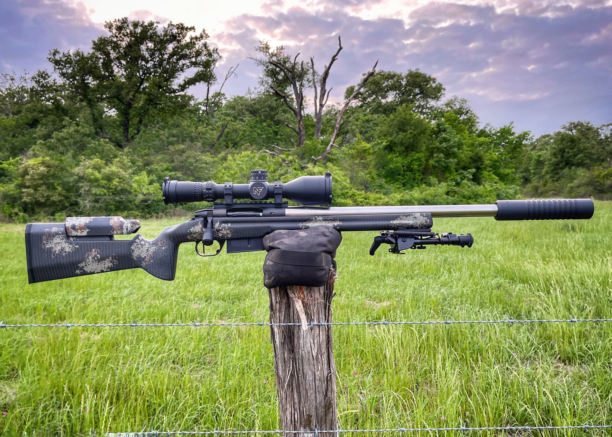

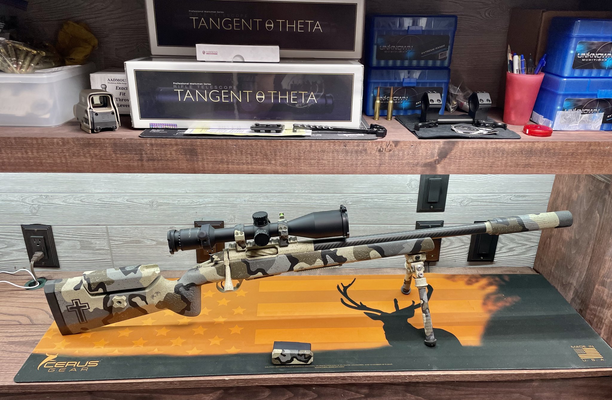

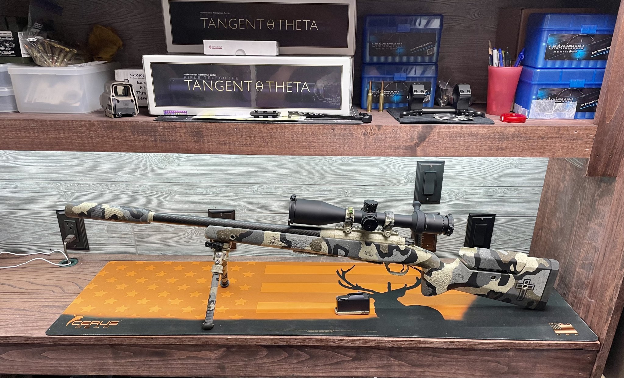

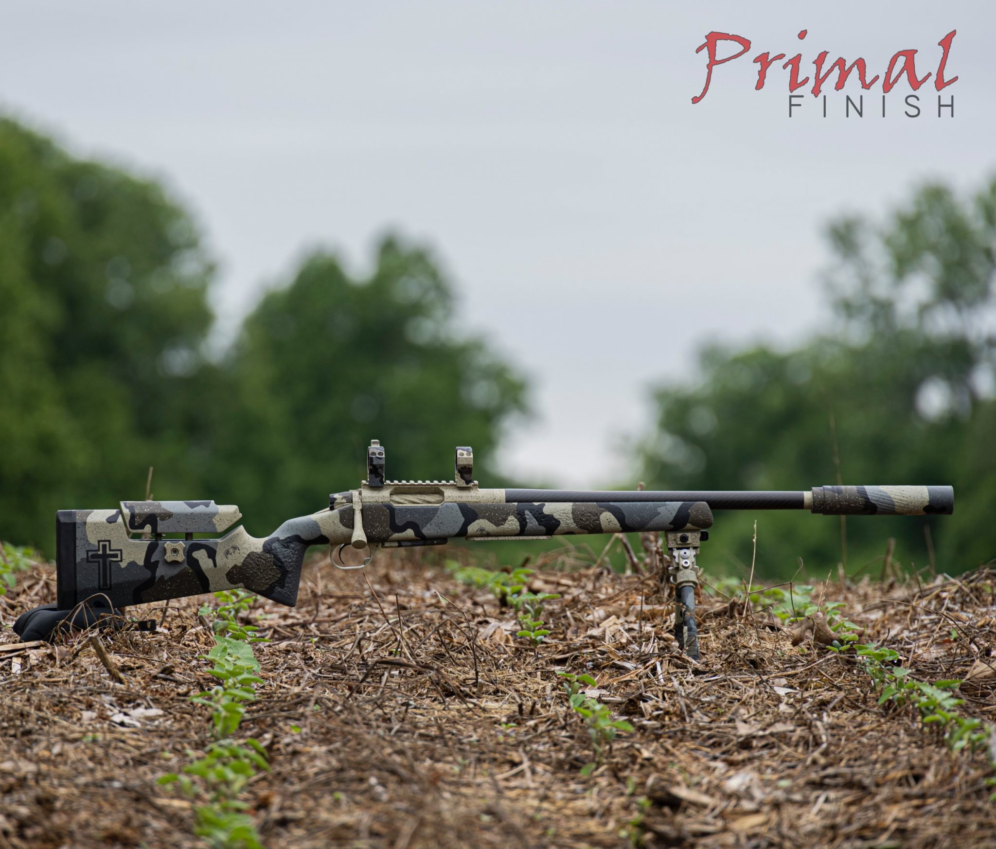

TS Customs build got a make over from Daniel at Primal Finish who is a class act guy to deal with and does phenomenal work.
•Lone Peak Fuzion SS
•18” Benchmark Carbon 6.5cm 1:8tw
•Manners EH1A w/ Hawkins Metal Hunter Flush mags
•Hawkins Lite Rings
•TT315M Gen2MilDot

View attachment 7877404TS Customs build got a make over from Daniel at Primal Finish who is a class act guy to deal with and does phenomenal work.
•Hawkins Lite Rings
•TT315M Gen2MilDot
Great looking rifle!

Thank ya!
Hell yeah, shorty’s are awesome and so is Travis! What caliber you getting?

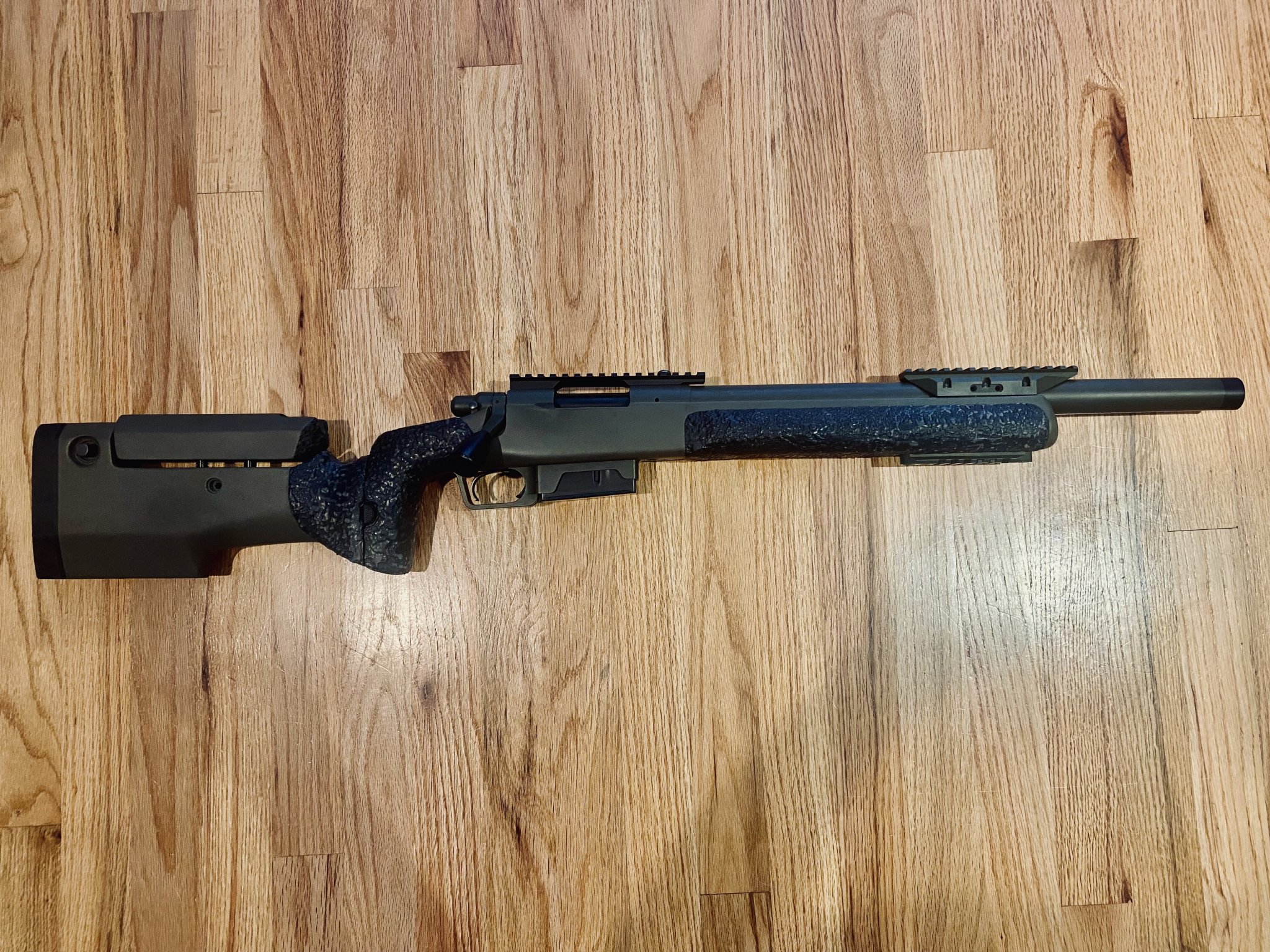

Howa 1500 in .308 with the factory 24” barrel cut to 18” and glass bedded in a B&C stock. View attachment 7877671
How does this one shoot? I picked up a 1500 in .223 for my daughter several yrs ago and bedded it into a Boyd's At-One so it could grow with her (should probably swap for a nicer stock now).....anyhow, that darn thing shoot ragged hole groups with 69 gr Sierras.
