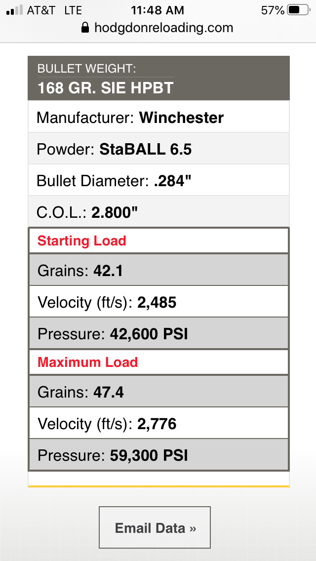

I have a friend that uses hornady 162 in 7-08 and gets great speed and accuracy albeit in a 24” barrel. But I would be willing to bet you could get to 2750-2800 with the right powder. But it’ll be hot and loaded kinda long I would imagine.

Have you seen Hodgdon’s Staball data for 168’s?
StaBall looks to have a lot of potential, but for right now I'm hoping I can get decent velocity with H414. I have quite a bit of it, and around 700 Federal GMM LR mag primers to use up.
