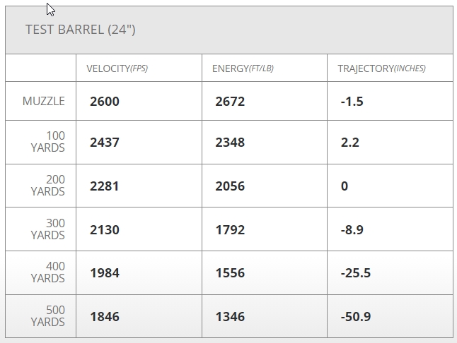

Great to see this thread started back up. I've been extremely busy these last few months, but I will be finishing up loading for the 178's and finishing my data collection soon. I will be sure to finalize all results and share them with everyone. Next research will be 6.5CM with the 143 and 147's in Hornady's bullets. I did load 2 sets of 5 shots at 42.5 and had good results and accuracy. I will have to dig that info up and share soon.
Has anyone worked up an accurate load for the 308 Winchester using the IMR-4064 with Hornady 178 GR ELD-X out of a Remington R5 20" bbl. I run IMR-4064 in this rifle shooting the 168 GR HPBTMK and all works well at 43.5 GR of powder. From what I can tell it appears 43.5 GR of IMR 4064 will be fine with the 178 GR bullet based on what I see coming from IMR web sight where they are using 180 GR SP and still be under their max load. Any ideas on this before I get busy loading. Please send your input to [email protected] too since I don't visit here often. Thanks in advance.
So I guessing 41.75 GR of IMR 4064 pushing 179 GR ELD-X will have slightly higher pressure but will not exceed max pressure the R5 will hold. From what I'm seeing here 41.57 GR of IMR 4064 would be at the low end of the scale even when launching a 180 GR bullet and should be safe and may even produce a velocity of ~ 2,500 FPS. I believe Hornady 178 GR ELD-X from the factory is 2,600 FPS
There is just so much information out there like this that make me wonder what's true and what is not. ( 42.5 grains averaged 2,730 fps and flat primers. Between ( 41.0 and 41.5 grains is likely to duplicate factory velocity. ) It does appear that 41.57 GR of 4064 is a good place to start and may be spot-on where was my wanting to start at 43.5 GR would have been a problem base on what IMR suggested as seen here. Thanks for the information and the starting point. If all is well this 178 GR ELD-X should be very accurate and more effective on the ( mark ) than the 175 GR HPBTMK unless Hornady G7 BC is a lie in order to sell their product.

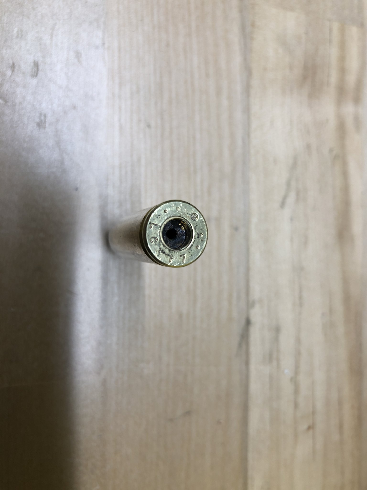

I keep hearing about LC brass being good and then I hear it bad. So what is it? Is this military brass the LC you're all talking about
LC brass is military brass. It is stout and tends to be thicker than many commercial choices. You might want to sort them by weight.
Are you saying the volume of the LC's brass used by the military are not consistent. So I'm guessing these LC cases are not what is used to build military precession sniper ammo. If not, do you know what brass they use to get consistent volumes
I not familiar with the consistency of the brass used in military ammo designed for long range use, such as M118LR. I would expect that it would be more consistent than garden-variety LC brass. The military can procure most any ammo they like from vendors to the specs that they develop. There are others on this forum who are more informed than I am about military processes.

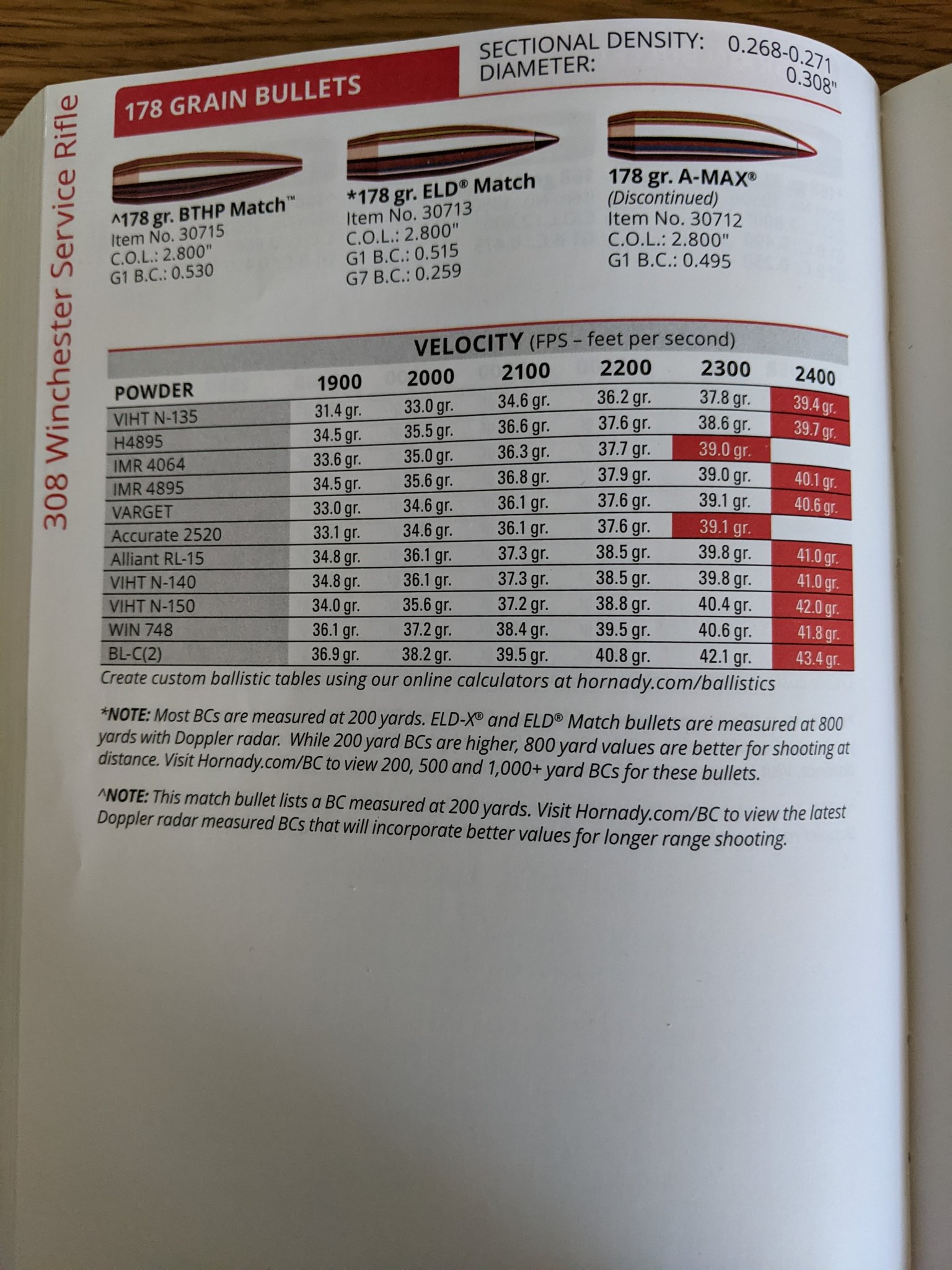

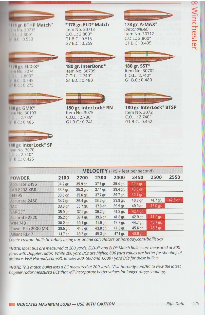

I am having trouble finding established load data for the 178gr ELD-X bullet for my .308
Anyone have a min and max load from Hornady in the 10th edition or elsewhere? I’m using 9th and nothing. I generally use Varget but I wouldn’t mind seeing 4064 as well even though i should get a higher FPS with the Varget.
In addition I wouldn’t mind seeing the minimum and maximum FPS if it’s not too much trouble.
Anyone else running Varget on the ELD-X’s? 43gr for me in that bullet range has generally shot 1/2 MOA for me in my McMillan Tac-308.

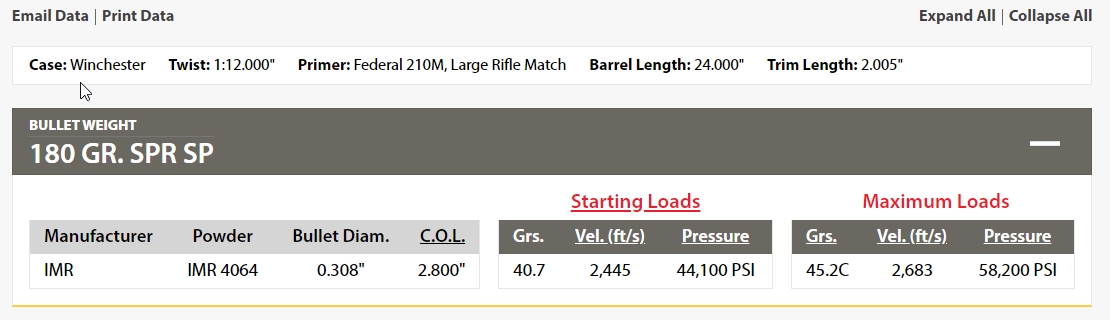

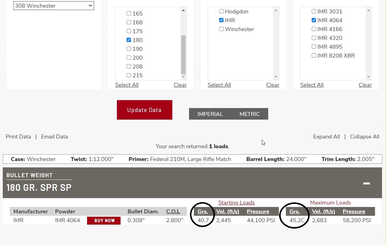

How come IMR-4064 is not listed in their manual and yet it comes up as the powder used in their military contract build sheet I have seen out here on this forum
1. When it comes to published manuals, there's a reason why it's a good idea to have multiple sources to cross reference load data. The books are cheap, buy multiple different ones.
2. I think you're new to handloading, so just keep in mind that for liability reasons, most max charge listings in manuals are conservative. In those cases, it's easy to exceed the ratings the book max. When working up loads, do so CAREFULLY.
3. Military loads tend to be loaded "hotter" in many cases. The highest velocity load is not necessarily the most precise. You as a handloader have control over that. The military also does not reuse brass.
4. Using load data posted on any forum as a reference should be taken as a rough guideline of where you may or may not see good results. Your equipment (rifle, press, dies, components) and your practice (handloading steps) will ultimately dictate what results you get.

I bounced around a lot of different reloading data and eventually grabbed a copy of QuickLoad just to have another reference. Ultimately, between how varied the data can be and how conservative the data can be, I wanted some idea of what pressures I might be running. QL isn't perfect, of course, but it's worthwhile, I think.
For example, QL tells me that in a SAAMI chamber at 2.8" COL, you should get roughly 2600 fps out of 42 grains of IMR-4064 @62 ksi. That 39 grain charge is, in QL theory, 49 ksi (waaaay light) for 2425 fps (or near enough).
The other thing to remember is that bullet shape matters...maybe a lot. An old school 180 grain design like the Partition, for example, is 1.260 inches long. That 178 ELD-X is 1.401 inches long. That means if you seat both of them at 2.8 inches you get (again, QL theory) a usable capacity of 47.35 grains for the Partition and 44.78 for the ELD-X. Now, the obvious issue is that different brass has different internal volume. That being said, that internal volume difference is significant and it impacts your pressure curve/build. For example, if I run that same 42 grain charge of 4064, I get 2525 fps @ 55.25 ksi for the Partition. That's one nice thing about Hodgdon on-line is it breaks things down by bullet.
Overall bullet length has less to do about pressure than bearing surface. Take the 215 berger hybrid and the old standard 190 smk. The Berger is far longer but has a bearing surface of .463. This is why the 215 can be pushed to the same speeds even with 25 grains more weight. Run cfe223 or lever revolution in the 308 and you will get more velocity with the 215 vs the 178 load you have in this post with 4064. Change the coal to 2.940 to fit in the longer acis mags and you open up ballistics that the 308 never had before. Run the 178 with these powders and add in MR2000 and you will see a major uptick in velocity without undue pressure. Think 2800 in a good 26" But like all rifles some will work out and others ust will not shoot the combo well
Bearing length certainly matters, but it’s not an input variable in QL so far as I can tell. I’m not sure what needs to be tweaked in QL to model that, but it’s something to play with anyway.
Seating depth/COL is an input with easily identified secondary effects though, even shooting the same bullet.
My point was that @nvrpc1 cannot expect different bullets with different effective seating depths (or bearing surfaces) to use the same powder charge.
