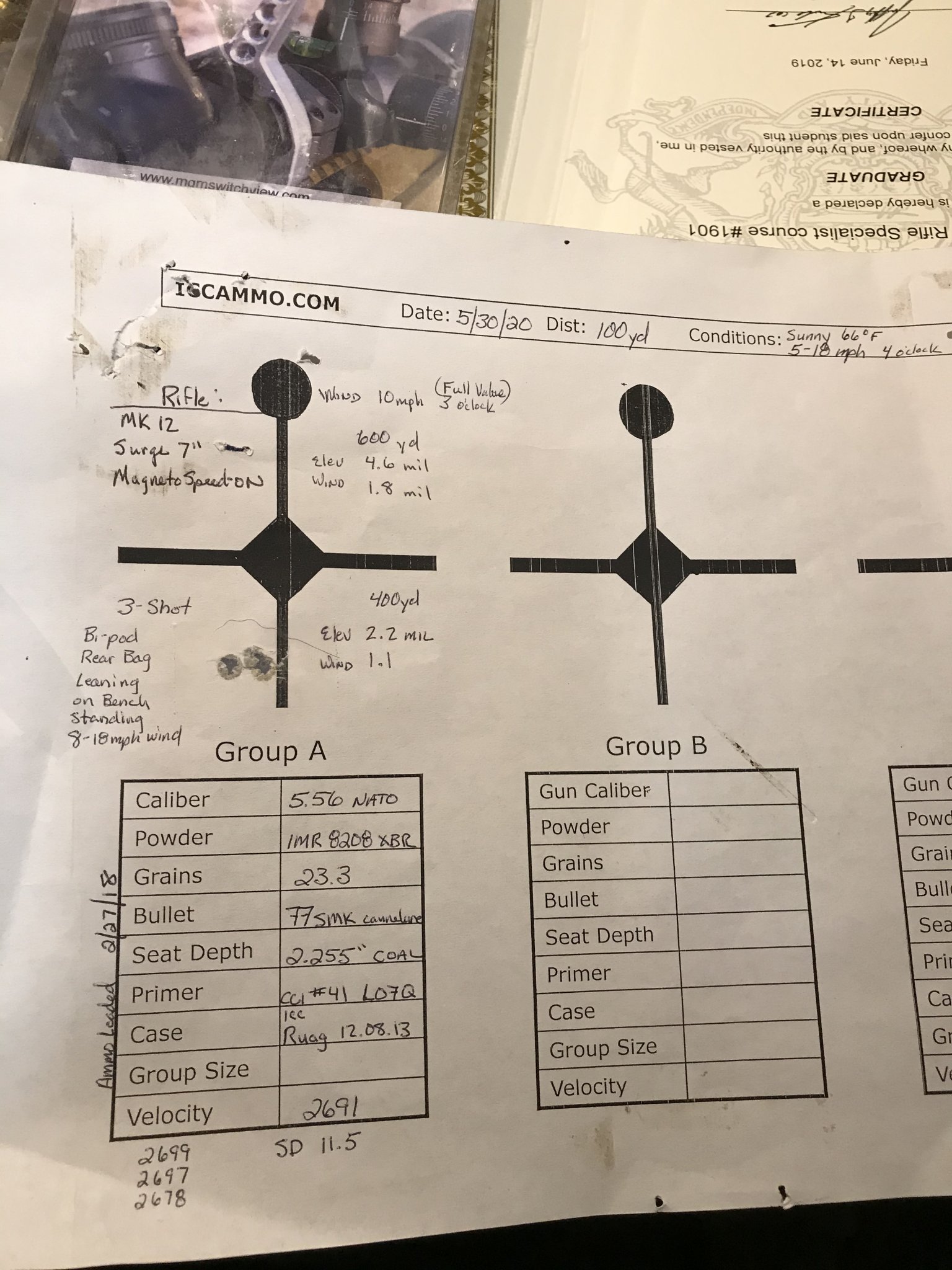

Had a chance to try some of this powder out. Here's the stats:
AR
18" WOA match
Winchester brass
WSR primer
77gr SMK'S
Loaded @2.26"
23.8gr 8208xbr (seems to be the sweet spot for my rifle)
2720 fps (pretty sure my chrono reads fast. My .308 loads are about 40 fps faster than normal reports)
Now here's the dilemma. Anyone try this powder with Berger 70gr VLD's? I'm getting my best loads with these bullets over 25.6gr varget (2760 fps). If I can get over 2800 fps with the VLD's and 8208 I'll be in business. Is it worth a try?
