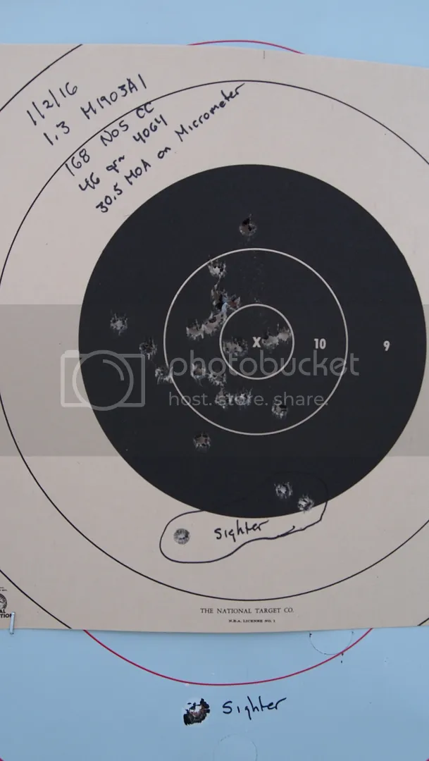

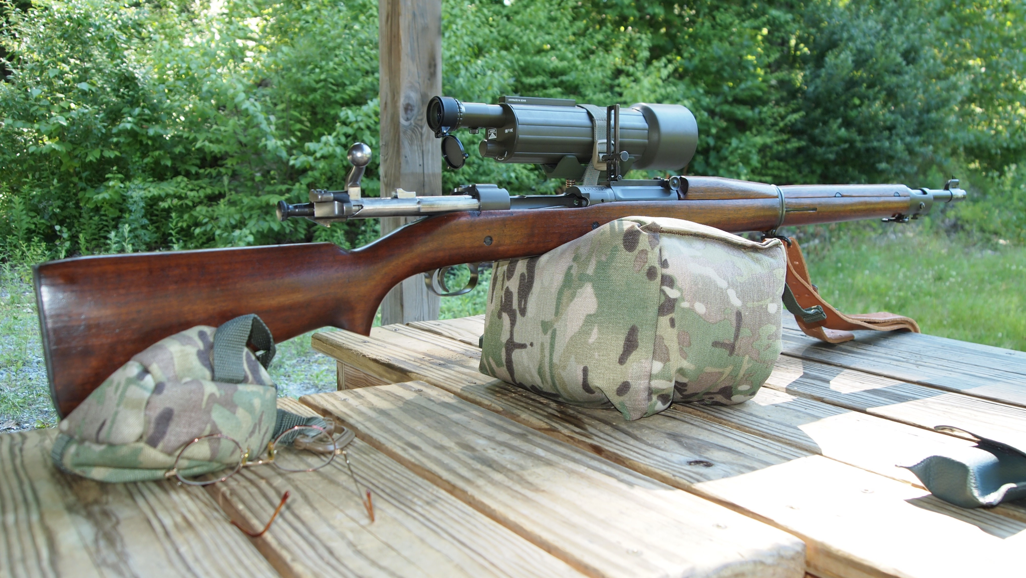

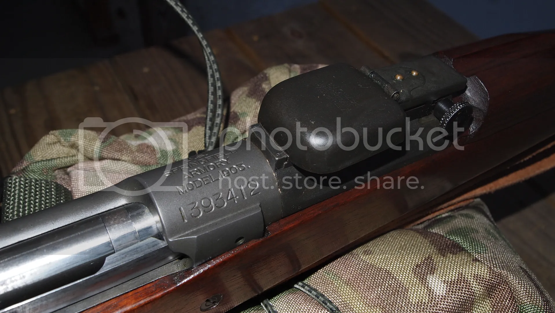

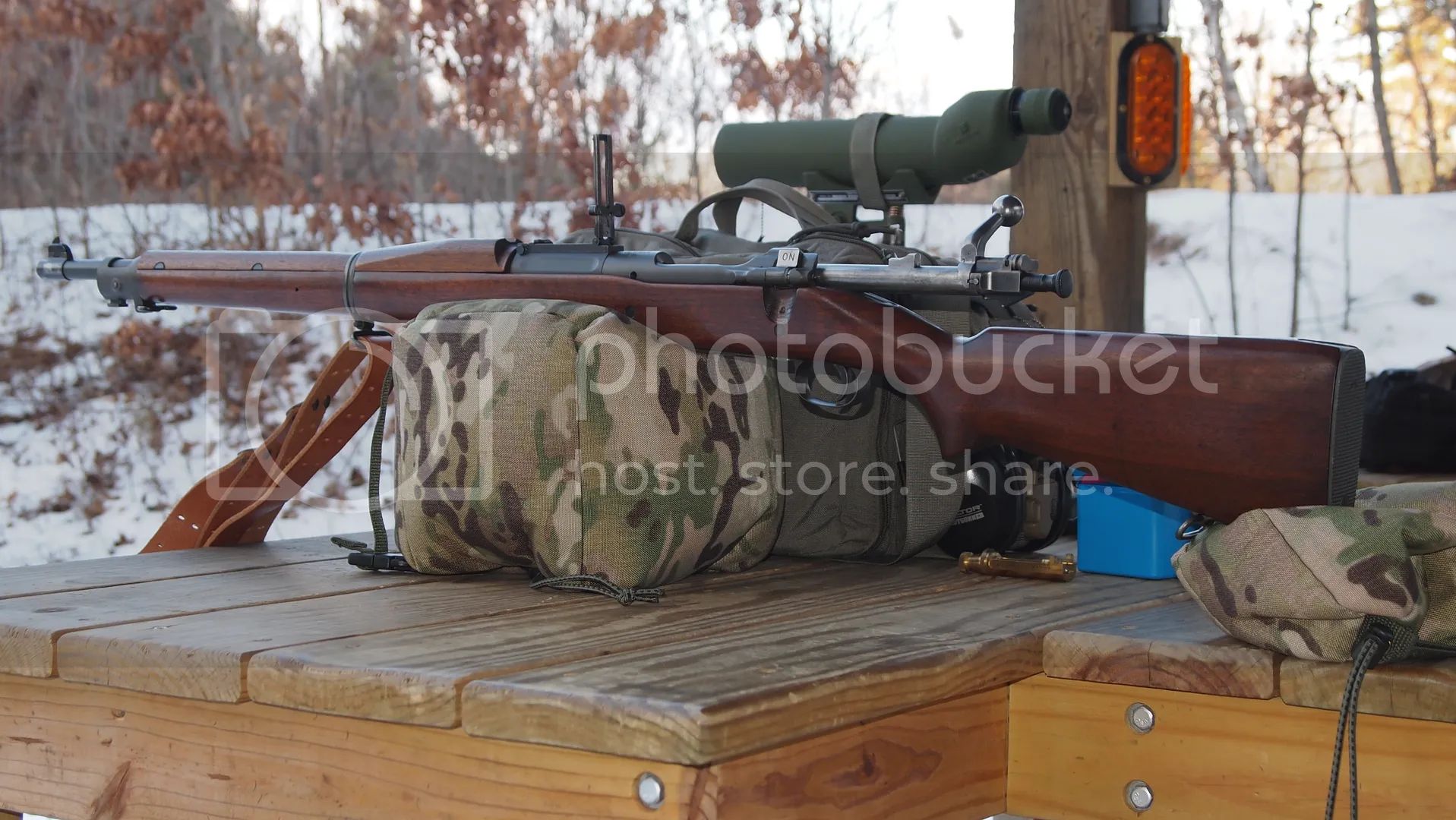

    This is my 1.3 Springfield 03 in C Stock........Gungnir.
    This is my 1.4 Springfield in C stock - Nothung.
    Prewar stocks are recognizable by the "trim" wood. the other option are Keystone replacements. Keystones are great stocks but they have "fat" dimensions....especially at the wrist. sorry for the watermark Photobucket stole my pictures I guess.
    The 1.3 I bought from the Honey Hole. Appears to have been someones "Pet" match rifle....desirable bolt, reverse safety, well preserved, has CMP paperwork.
    The 1.4 was a weird coincidence. saw it in the classifieds at Culvers shooting Pages and I commented "If you were within easy ride of Massachusetts Id be all over this" Guy responded and the town in MA he was in bordered my own. It has a NS bolt and came with a heavy checkered butt plate/door. Again appears to be someones "pet" rifle.

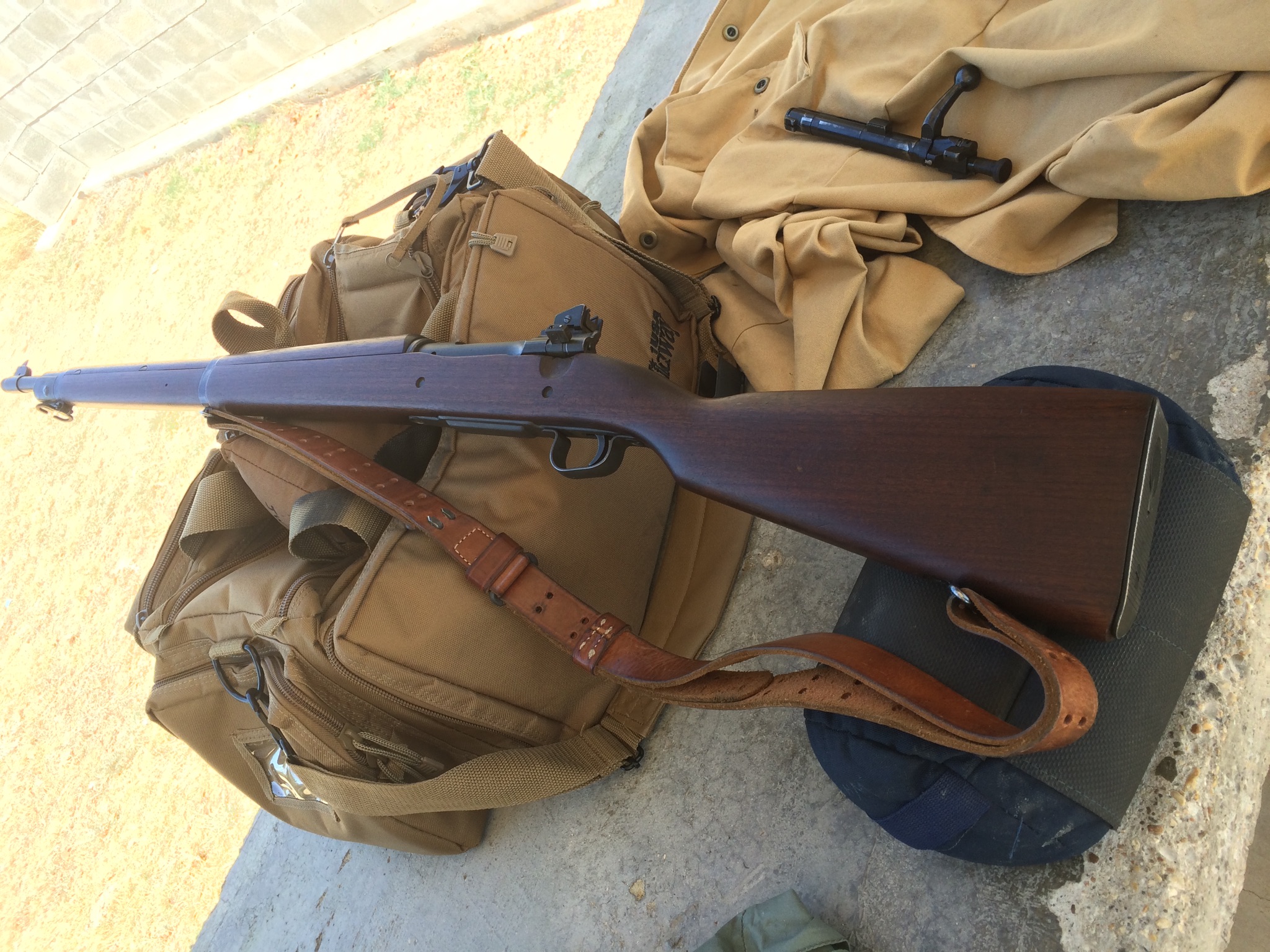

    1942 SC, unissued.
    Nice looking rifle, only 5540 SC rifles were made in 1942 (they all had Sept 1942 barrels, but were note finished until December 42' due to an issue with the rear sight parts that required replacement before they could be accepted). Per Canfield's book, the SC contract began with serial # 3608000.
    BTW, I will note in defense of the historical record, that all SC M1903A3s were made with 'straight' grip stocks. Your rifle has a nice looking 'scant' stock (aka 'semi-pistol grip'), which was only used during WWII by Remington on some of the M1903A4 sniper rifles. After WWII the scant stocks were used quite a lot as replacements. Attached is some info from one of many reference books on the M1903 rifles (03' Springfield Service Rifle by Bruce Canfield). The original issued SC stocks are also pretty easy to detect by unique inspection cartouche and inspection stamps on bottom (The 'band spring inlet' on the right side is round at the ends, which is also unique, as Remington stocks have a square cut). Anyhow, just an fyi re SC M1903s. They are neat rifles.

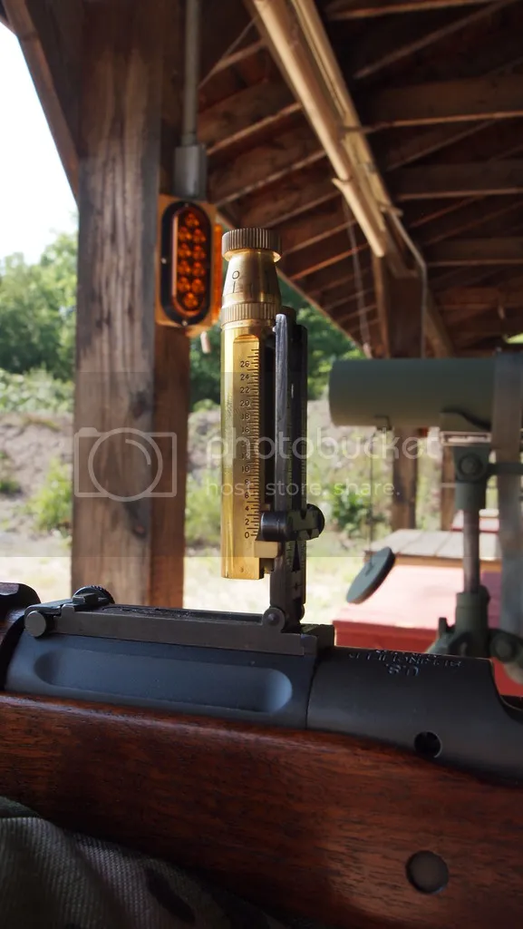

    This is an O'Hare sight micrometer reproduction

    Its a fantastic tool. Cant shoot 03 without it. Ill post some pics of my original.
