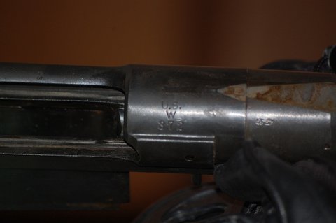

DSC_0973_zpsng34oprg.jpg ahh finally finding and figuring out how to post with a smart phone.
If you can see the two proofs on the barrel, would that explain why my Winchester 1917 was a two groove?
Check to see if there is a seam foward of the chamber... or an ordnance escutcheon (flame and shell) with JA above it... those are the only two possible explanations for a two groove barrel on a M1917. That is a VERY early Winchester M1917... like end of first week/beginning of second week of production off the top of my head. It was manufactured with a 5 groove barrel, but the rifle did not have parts interchangability... lots of hand fitted parts, no bueno for the field.
For those who wish to get one as a shooter, you may find this useful...The groove diameter for Second World War replacement two and four groove barrels are between .3075 min through .3095 max, except for a time when up to .310 was allowable...most of the barrels meet the min/max standard. The First World War 5 groove barrels run a nominal diameter of .310... let me explain. The barrels were rifled using the enfield system...the bore diameter was .300 with a rifling depth of .005, giving a nominal groove diameter of .310 +/- due to wartime manufacturing tolerances.
