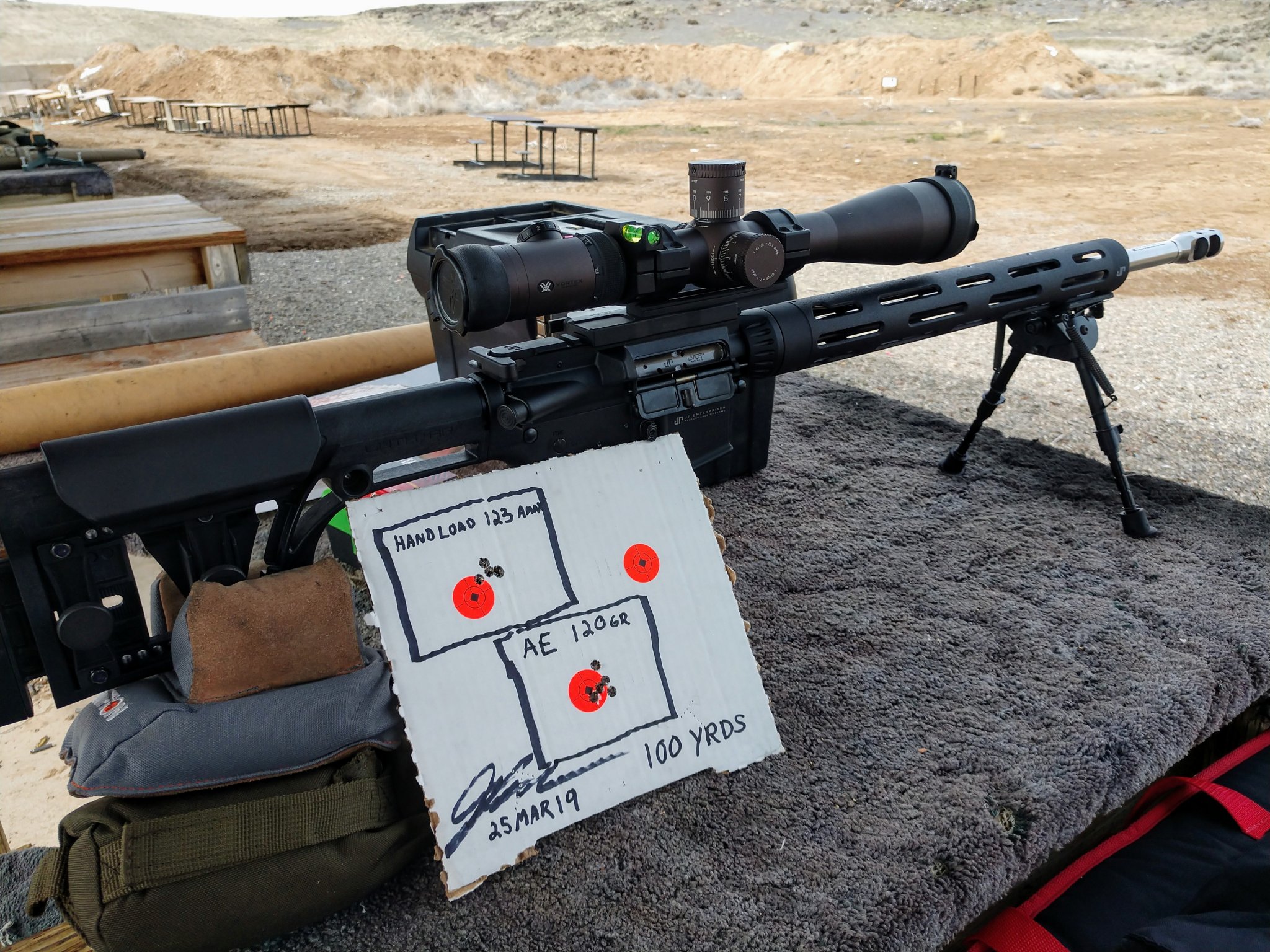

Have you considered getting a 6.5 Grendel? A 20"-22" Grendel with the 123 eld is absolutely perfect from 100 - 600 yards, essentially no recoil, very cheap to reload for and has a longer Barrel life than a .223, hell it's got a longer Barrel life than a 308.

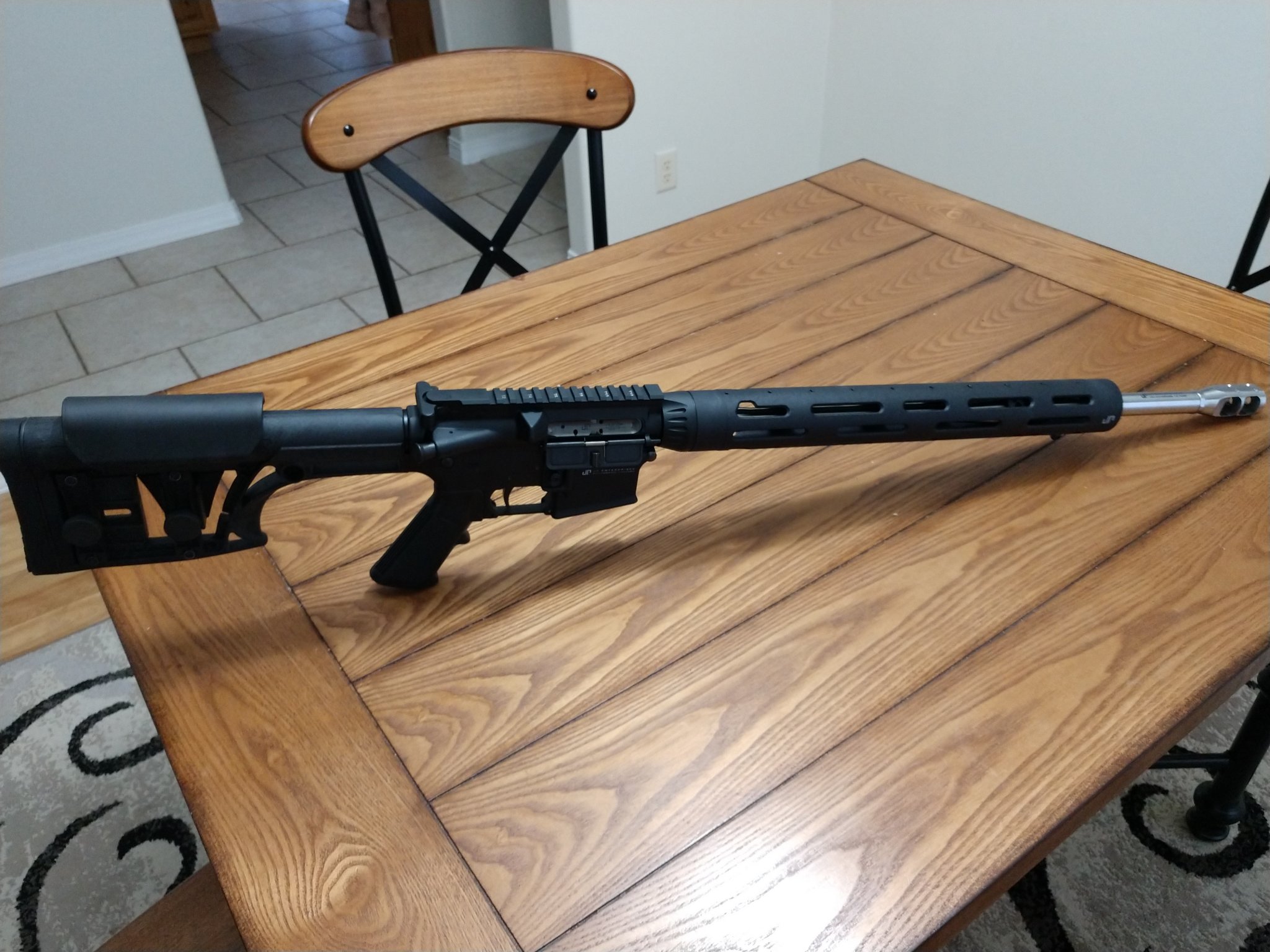

I just put this rig together for a friend of mine returning from deployment, I bought all the parts from JP but assemble it myself, it works out to be a few hundred cheap cheaper than buying a complete upper and stripped lower and about $500 cheaper than buying a complete rifle. As with any build I help somebody do I conduct proper barrel break and gas adjustment, and provide a load recipe thats pretty solid 6.5 Grendel load that seems the work well in most platforms 1/2 MOA or less.
I have considered that and I've got some compelling reasons to go that route.
I talked my bro into getting a JP 6.5G. He shot it a ton for a year then got married and started complaining about ammo costs so I helped him get all set up to reload at my house. Now he barely touches it and I've got tons of his brass, some mags lying around, dies, a spare bolt and loading experience I can put to work.
His gun shoots awesome, and there's no doubt that contrary to what Strelok tells me 6.5G struggles less in the wind than my 75 ELD's at 2850fps, and misses are way easier to spot.
So I haven't ruled it out, but my inner ballistics nerd thinks 6mm Grendel is the ideal diameter for the case and forming it is easy. Then my inner cheapass tells me 22 Grendel uses inexpensive bullets and should shoot very flat. Both of these start to deviate from my goals of brainless loading, simplicity and plentiful brass I won't mind losing.
I've pretty much ruled out 224V just because I don't have buckets of brass or mags or bolts or dies lying around for it. Nothing against the cartridge itself.

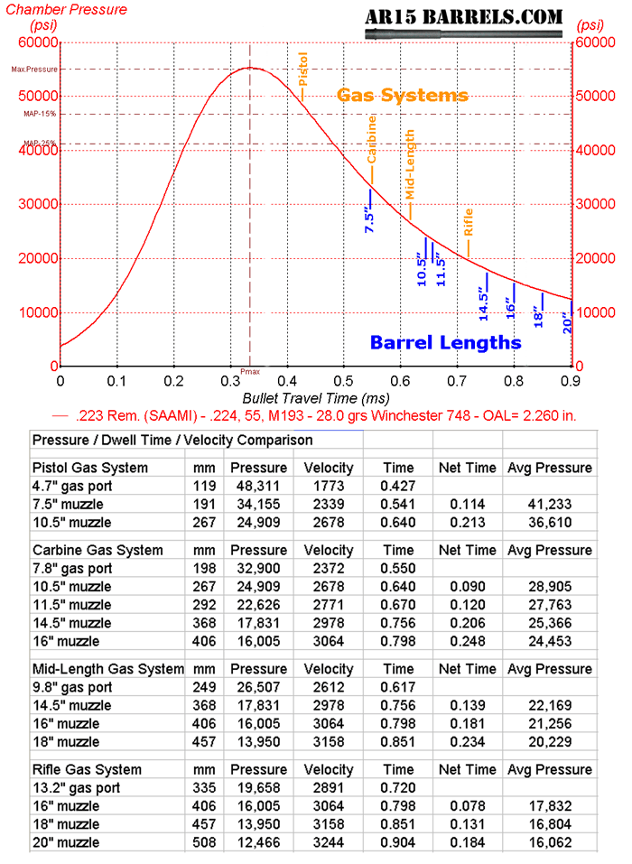

looking at this graph... ( From here... https://www.ar15.com/forums/AR-15/H...d-how-everything-works-in-harmony-/66-266108/ )
It looks like the difference from a .223 is going to be very little by adding a +2 gas length. There would be some drop in Gas port pressure.. but not a lot.
