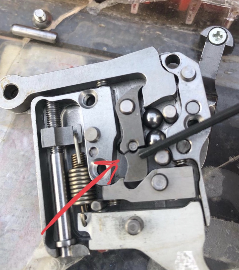

A good buddy broke the sear lever after maybe 100rds on his 223. He was at Rifles Only, made it through a few stages then he was done.
The part that gets me is breaking during a match. Most of the matches I’ve been shooting in, if you have a really bad stage, you’re done for the day. It’s so tight at the top, hard to have a failure and overcome it.
Sounds like a bad lot of steel, those top sears are the beefiest part of the trigger, if that cracked and broke I'd guess bad materials.
It was the sear lever on the inside of the trigger, but ya it’s not a small part either, sheared in half

Broke after only 100 rounds sounds like some sort of defect. I'm sure bullet central/BnA are taking care of your friend - that's what matters.
I have three BnA Tacsport triggers and thousands of rounds shot between them with no issues. A BnA trigger breaking at ~100 rounds is a statistical outlier. If there was a clear pattern established of them breaking I would be a lot more concerned.

Yup they got him a new one, only lost out on match fees, travel and wasted time.

It worked, for around 60-80rds
another 20 at the match then shit the bed

Yeah, I'll rephrase. Not sure I'd call it good after 60-80 rds. Obviously stuff can fail anytime, but...
Seems to me stuff breaks most commonly at two points, almost immediately if there's an issue with how it was produced, or at the end of it's serviceable life when it's worn out. You need to verify your stuff works before you trust it enough to base a match/trip worth a couple grand upon.
