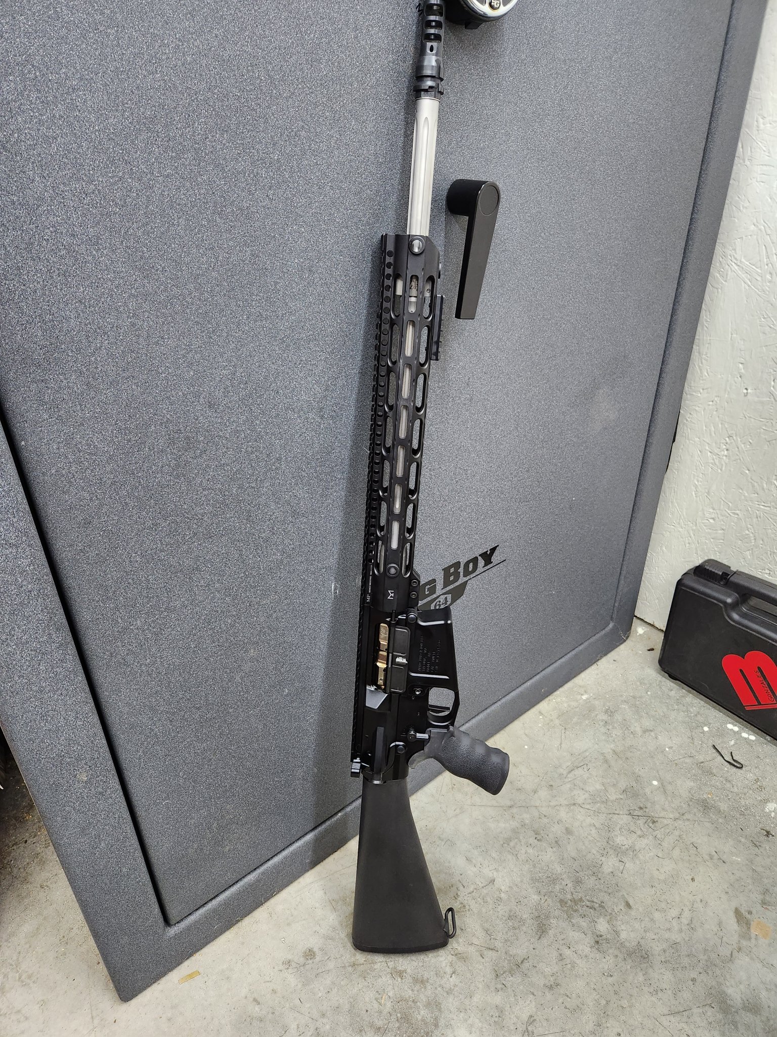

Here is my A5 build with Wilson 20" fluted super sniper. Just gotta find a sweet deal on a scope and I will see how it shoots

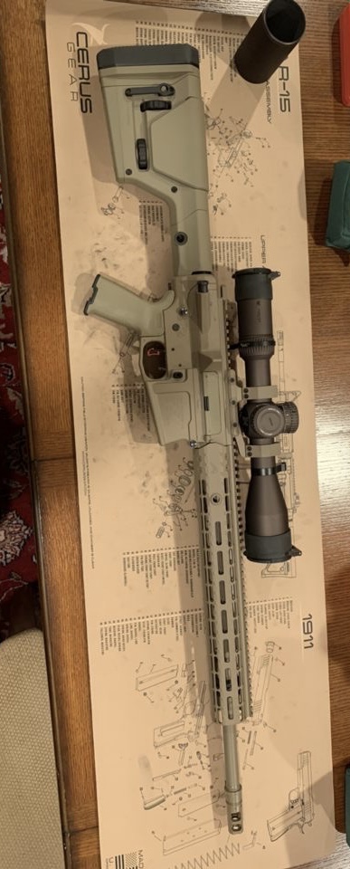

M5 is Aero upper and lower, LPK and rifle buffer kit. Geissele SSA-E. Magpul PRS. Rubber City BCG. Just ordered the Super Sniper 20” .308. Not sure about muzzle device yet, or optics.

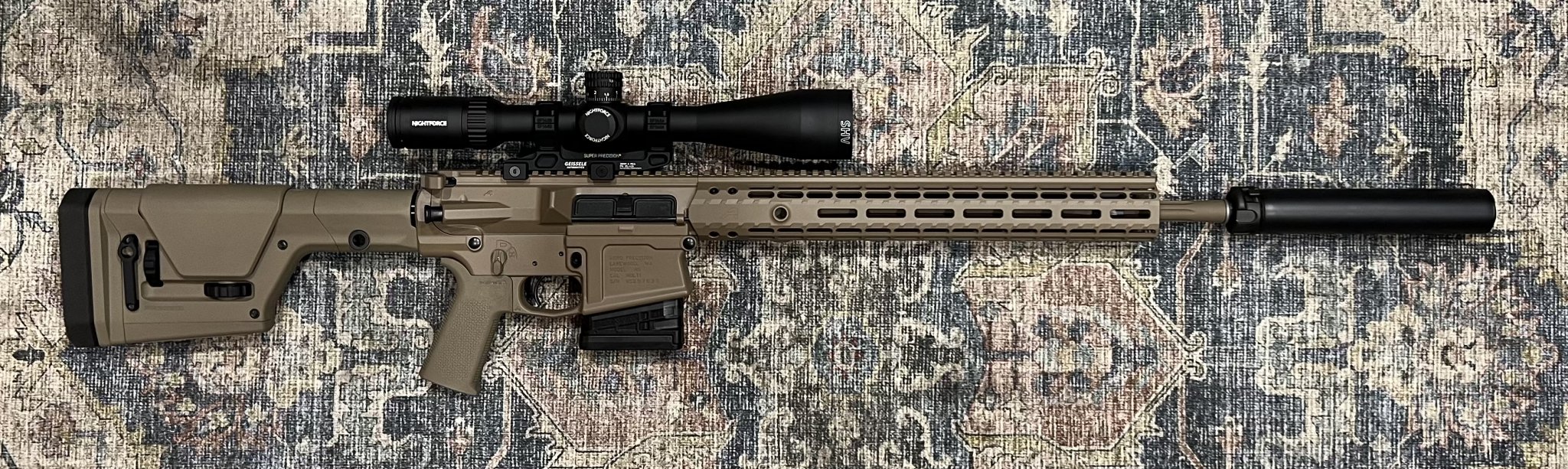

That looks identical to what I’m wanting for my build. What optic and mount are you running?
Vortex Razor 3-18 w/ EBR-C (I think) mil dot reticle, pic had an aero precision mount but that mount isn’t great on mine. Maybe it’s because it’s an AR-10, but the scope moved every 20 or so shots and then the mount cracked.
Replaced with Seekins rings and zero problems since. If I did over I’d just pay the $20 bucks or whatever to get the seekins rings cerakoted when I did the barrel and brake.

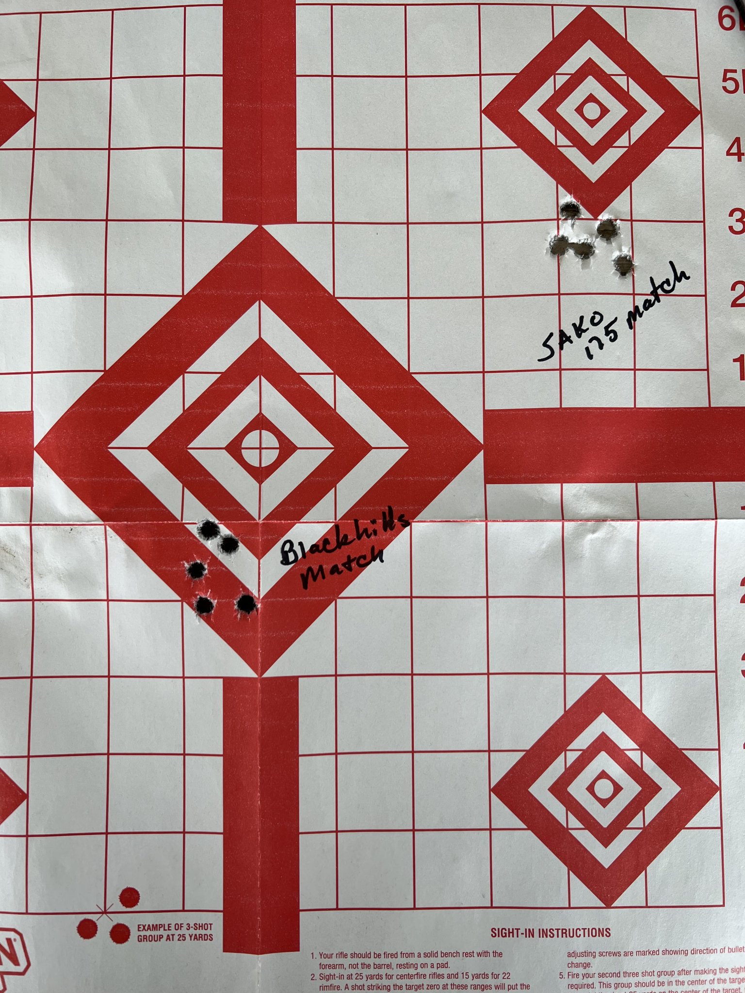

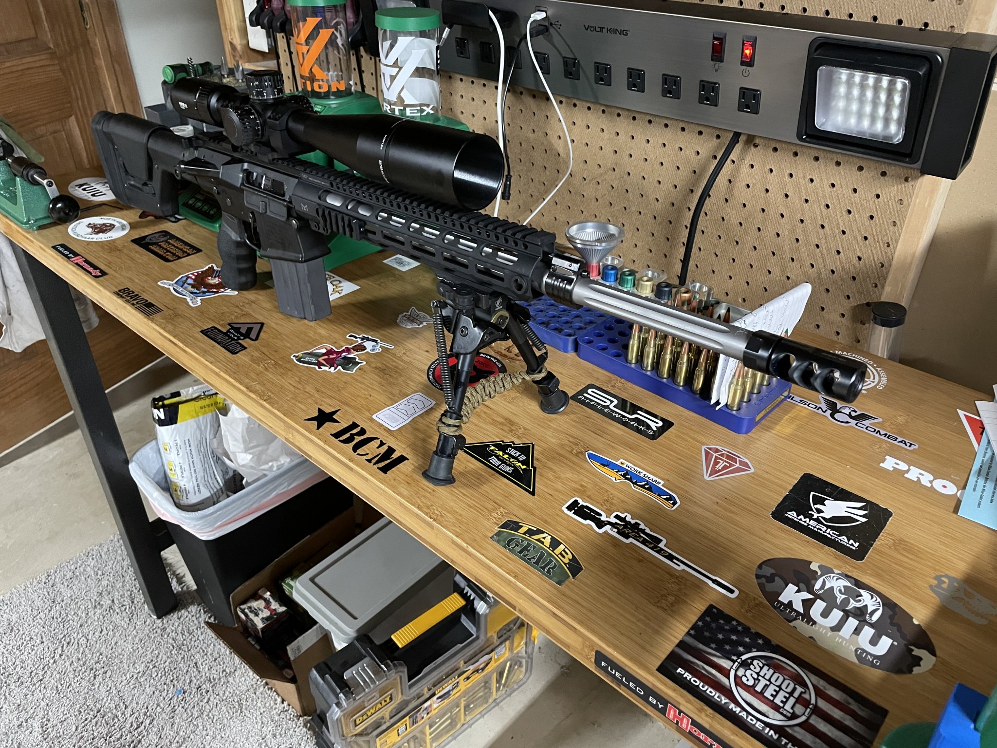

Following along on this thread I put together a similar .308 build. It’s on standard M5 receivers, Wilson Combat 20” fluted barrel, blem RCA HP bolt carrier group, SLR Sentry 8 agb, and a Triggertech Diamond 2 stage.
I finally put some rounds on it today to break in, zero, and just burn some powder. Right off the bat this thing was stacking shots with 168 FGMM. Going to work up a load and see what happens with some Varget or Imr 4064

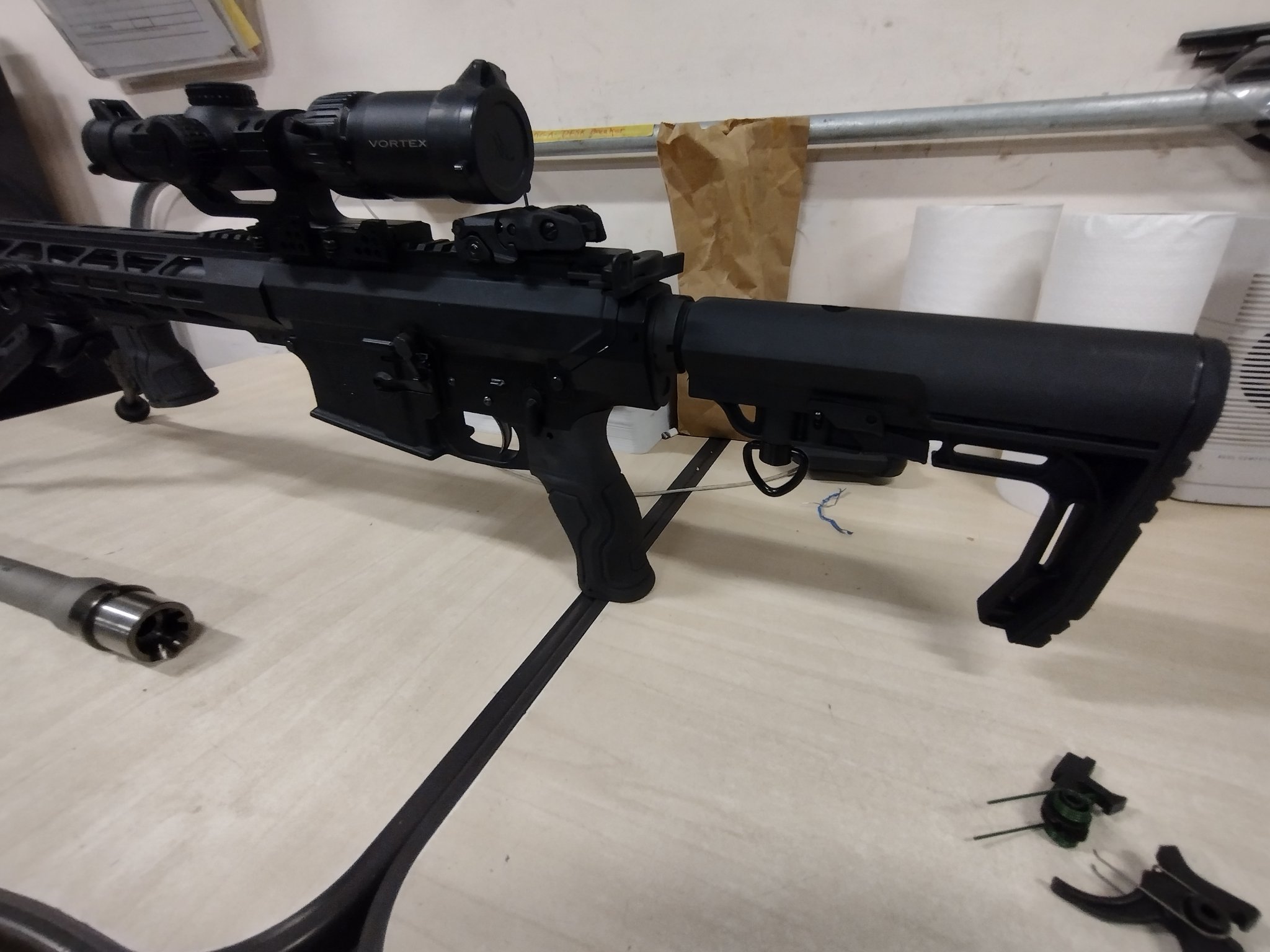

I ordered both, a couple of other tools, got free shipping. Gotta love a plan coming together. I've got a DB-10 with a 16" barrel. I installed 2-stage trigger, MFT battle link minimalist stock, FAB Gradus grips, Surefire warcomp and a Vortex strike eagle 1-8. Stumbled upon a DSG (BA) 16" SS 6.5cm barrel and ordered most of my parts from Diamondback to build a 2nd complete upper. I paid for, and now waiting on a SS adjustable gas block and a 6.8 Surefire muzzle brake. Haven't decided on optic yet.

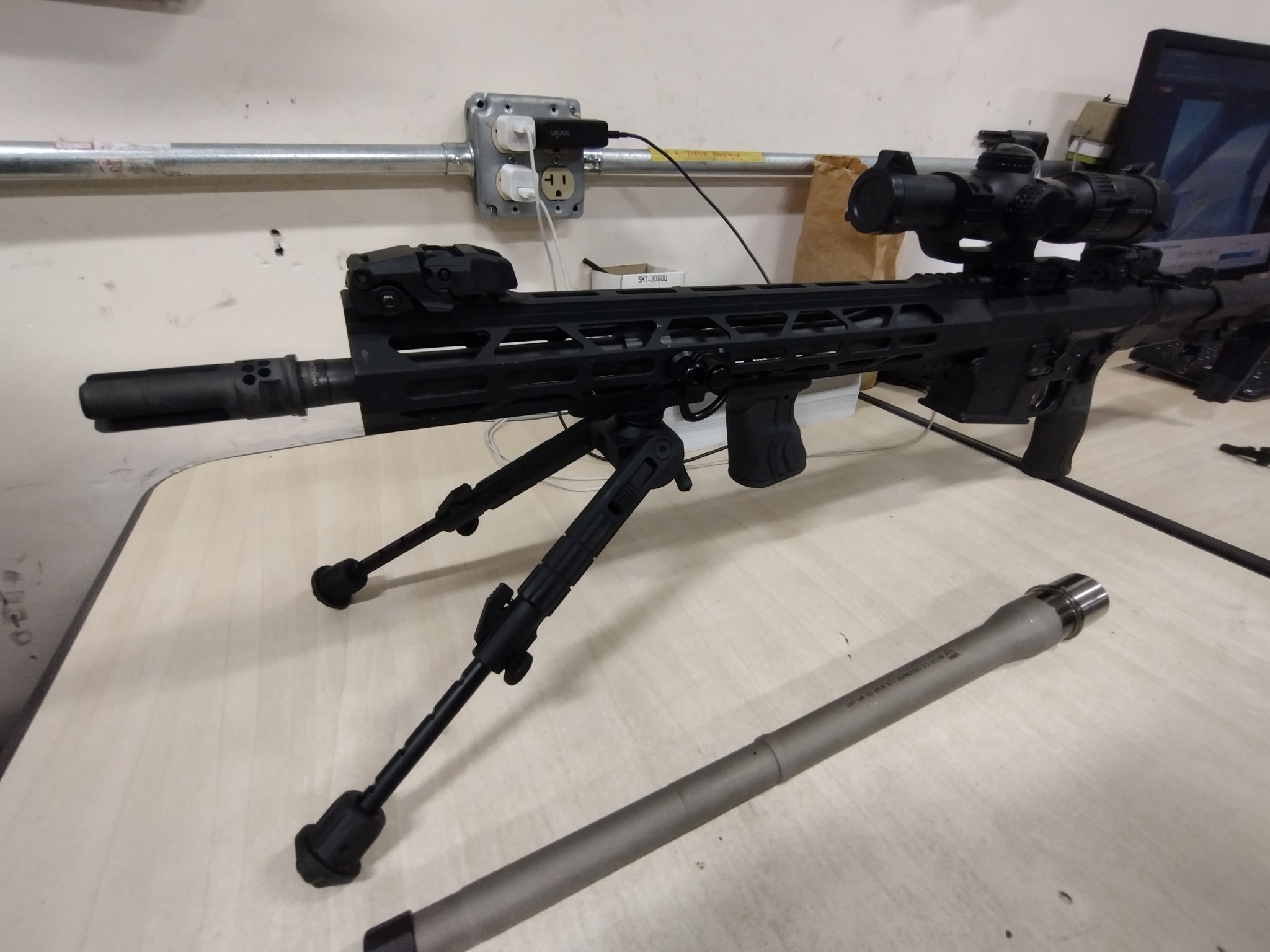

Looks nice! What are the build specs?

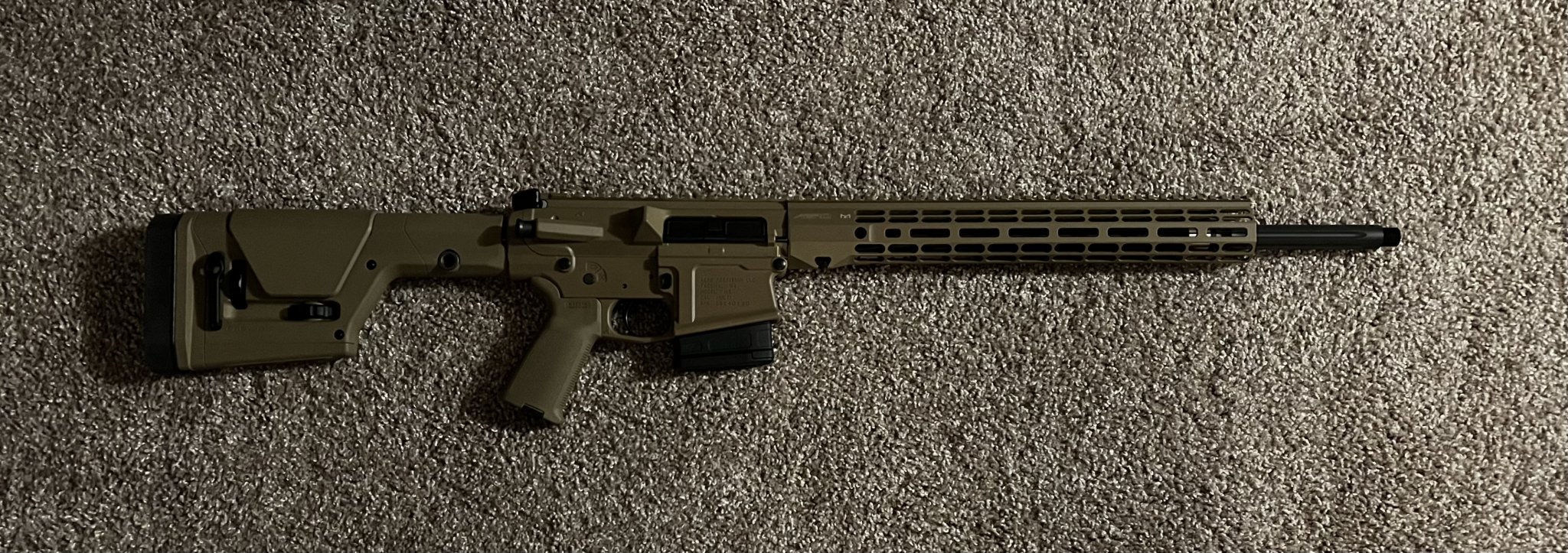

Aero M5 enhanced upper and lower. Aero 15” handguard and small parts kit. Wilson Combat 18" "Hunter" barrel. Geissele SSAE trigger, Superlative Arms adjustable gas block, Magpul Furniture, Radian Arms charging handle and ambi controls.
scope is a NF SHV just for shits and gigs. it may stay there, it may get the ATN i have as well. undecided. have 3 weeks to send the ATN back
