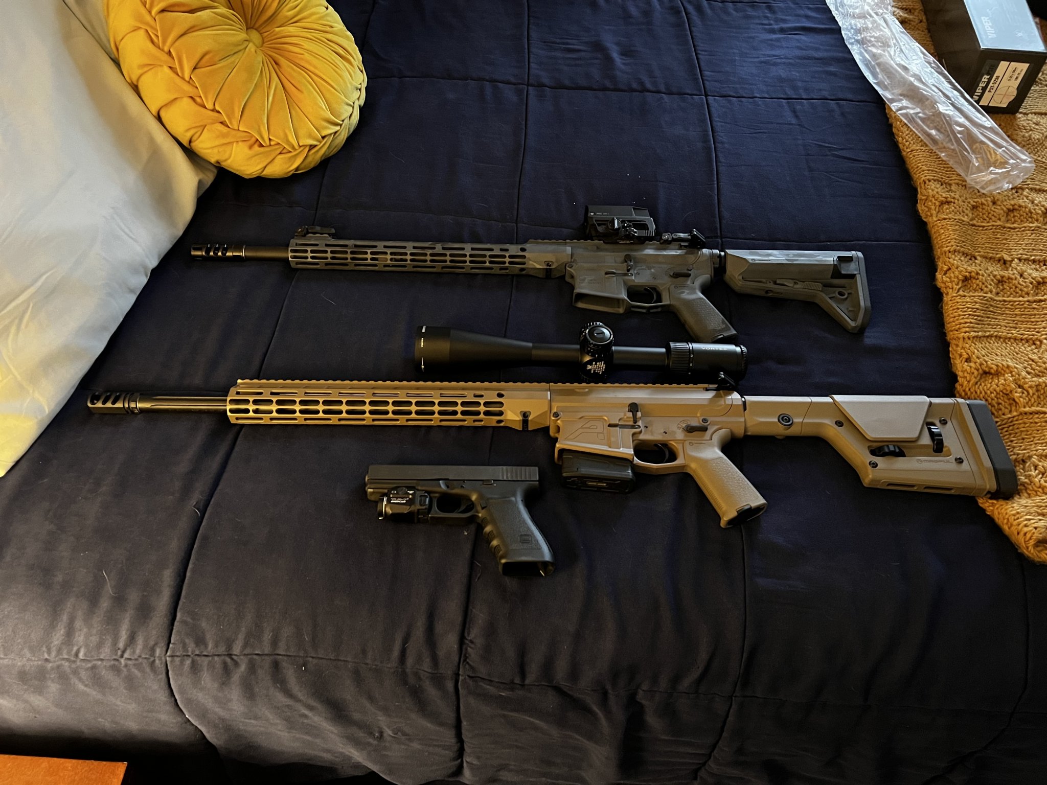

Just about done with my M5 build. Decided to do a family picture with my 6.8 and Glock 21.

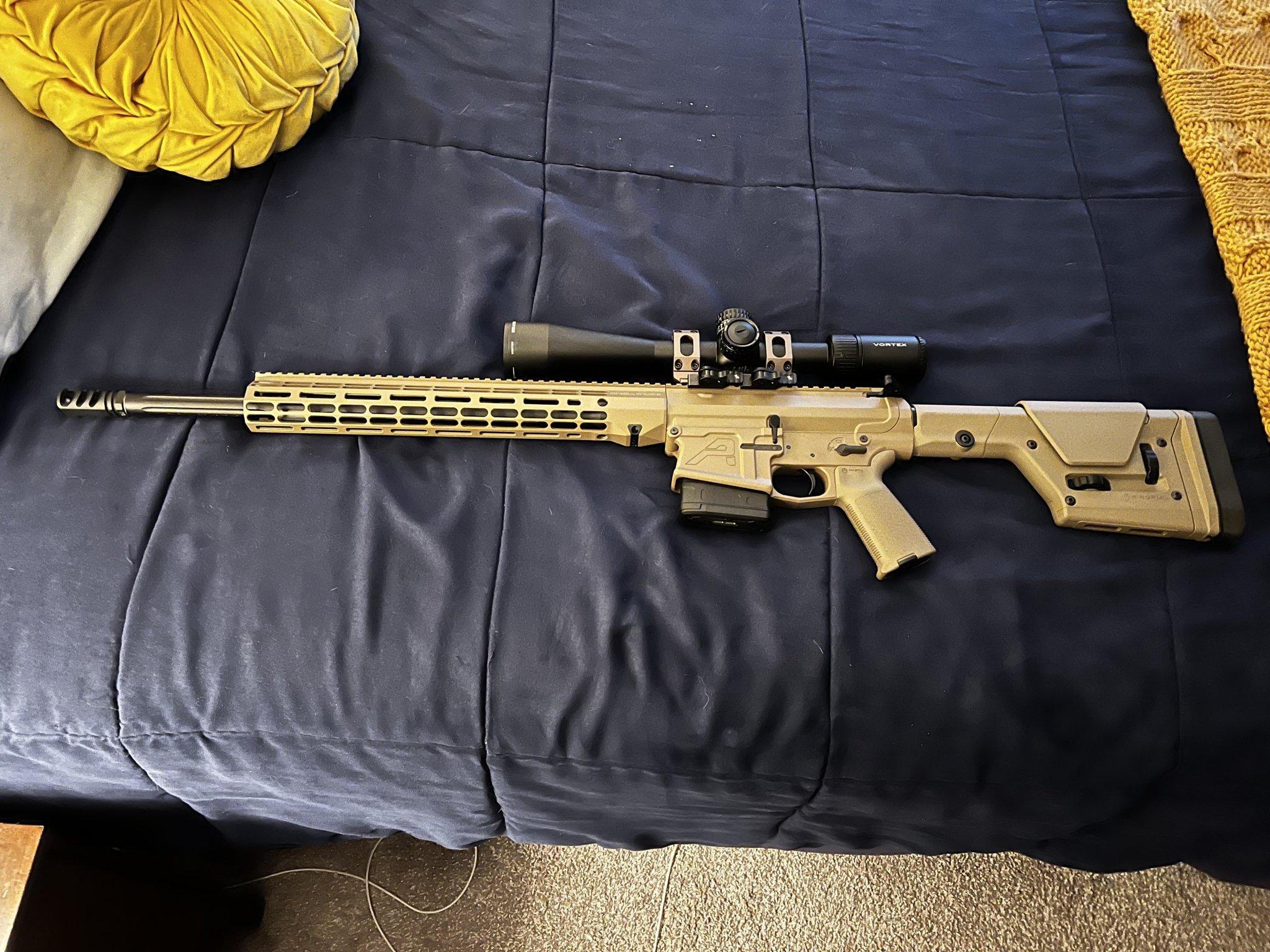

Thank you to all the people that helped me out. I appreciate it. Can’t wait to put some rounds down range. Got 100 rounds of 175 FGMM on the way.
Reactions: Sigmanx

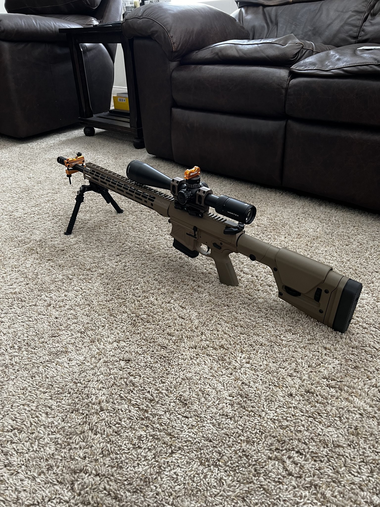

Finally took the rifle out this morning. Put about 40 rounds of 175 FGMM through it and had no issues. All 40 fed, fired and extracted. The wind was blowing my target around pretty good so I didn’t get a solid zero. Got it roughly dialed in. Ranged a rock on a hillside at about 1000 yards and took a few shots at it. Hit 3 of 10 but seeing splash was hard. Either way, it went better than I expected. Very happy with the build.
