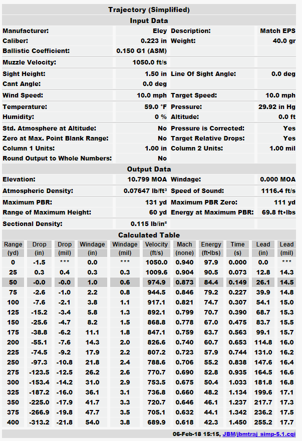

    Looking for opinions on a Tikka scope base in 20 or 30 MOA.
    It will be building a Tikka T1X .22 for practical style matches. Distances from 25 to 350 yards. I know 350 yards is probably extreme but that’s the farthest my local range goes and would be interesting to shoot that far.
    Scope will be an Athlon Argos 8x34 with 13 mils of elevation or a Vortex Gen II 5x25 with 20 mils of elevation.
    Will I be able to zero at 50 with the Athlon AND dial to 350? What about the Vortex?
    Thanks guys for the help.

    To take a 22lr to 350 yards youre going to want as much available elevation as you can get. I would skip the Argos 34x as youre limiting your adjustment too much. I think the vortex with 20 mils (guessing PST?) would be close as well.
