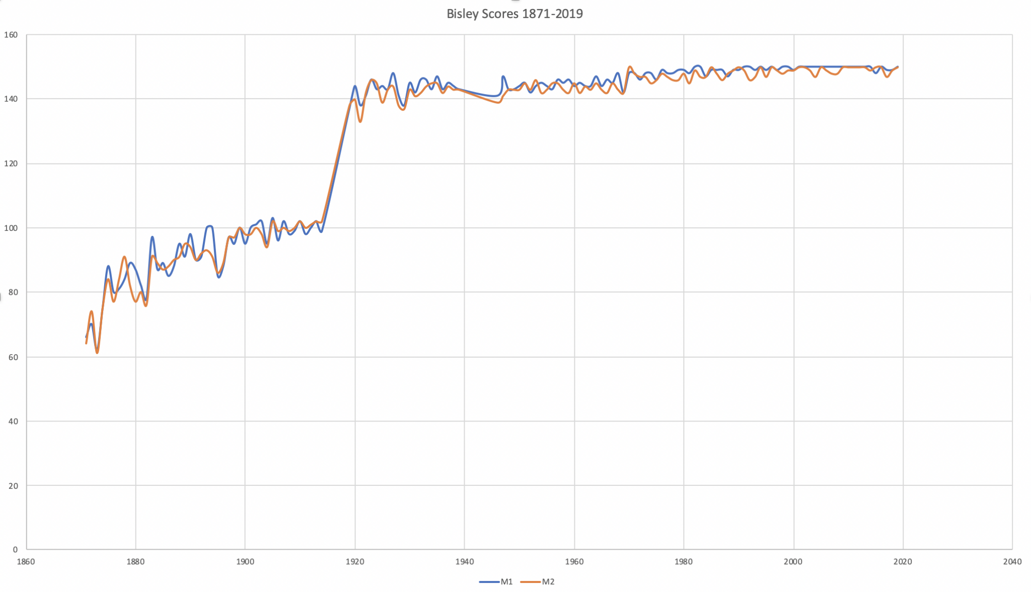

I've been recently for other reasons doing an alaysis of Bisley scores through the ages. It's a shining example of what I'm talking about. Thius is a single type of match that's been running since the late 1800's. I'm almost done with it so I'll pop a graph in this thread shortly which will more than make my point.
We see a really big world changing event around the time that WW1 ends which came with huge improvements in arms and armor technology and ammunition technology. From the 30's to the 50's there was a lot of refining but not much progress in any sub-decade time period despite an up and to the right sort of general trend. By the 60's it's hard to be competitive without shooting a 140-class score and it seems that this might be where we had chased all but the last couple of decimal places out. By the 70's individual cleans are being recorded but even into the 2010's there has not been a 100% clean by any team and a competitor can drop 2 shots and maybe possibly still not lose it for their team. I suspect that with technologies that I work with today which aren't really ready for small manufacturers to use (extraordinary complexity and fairly high cost), we'll see another small upward trend which will chase out those last couple of decimal places in the next 10 years. Then Bisley is going to have to change the scoring system to deal with the fact that everyone's shooting cleans.

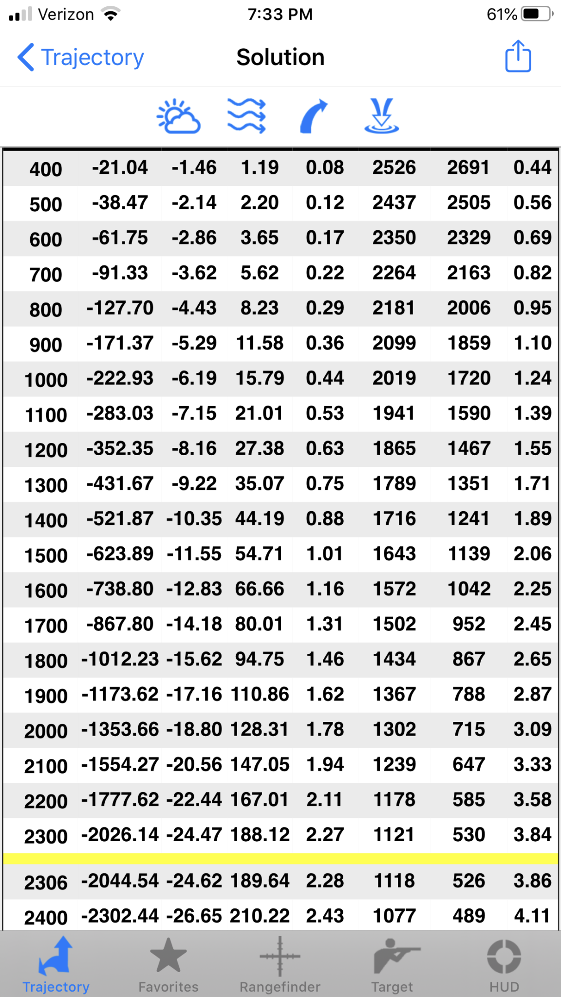

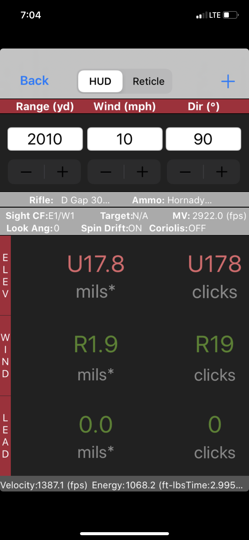

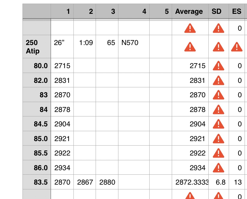

Share the results!

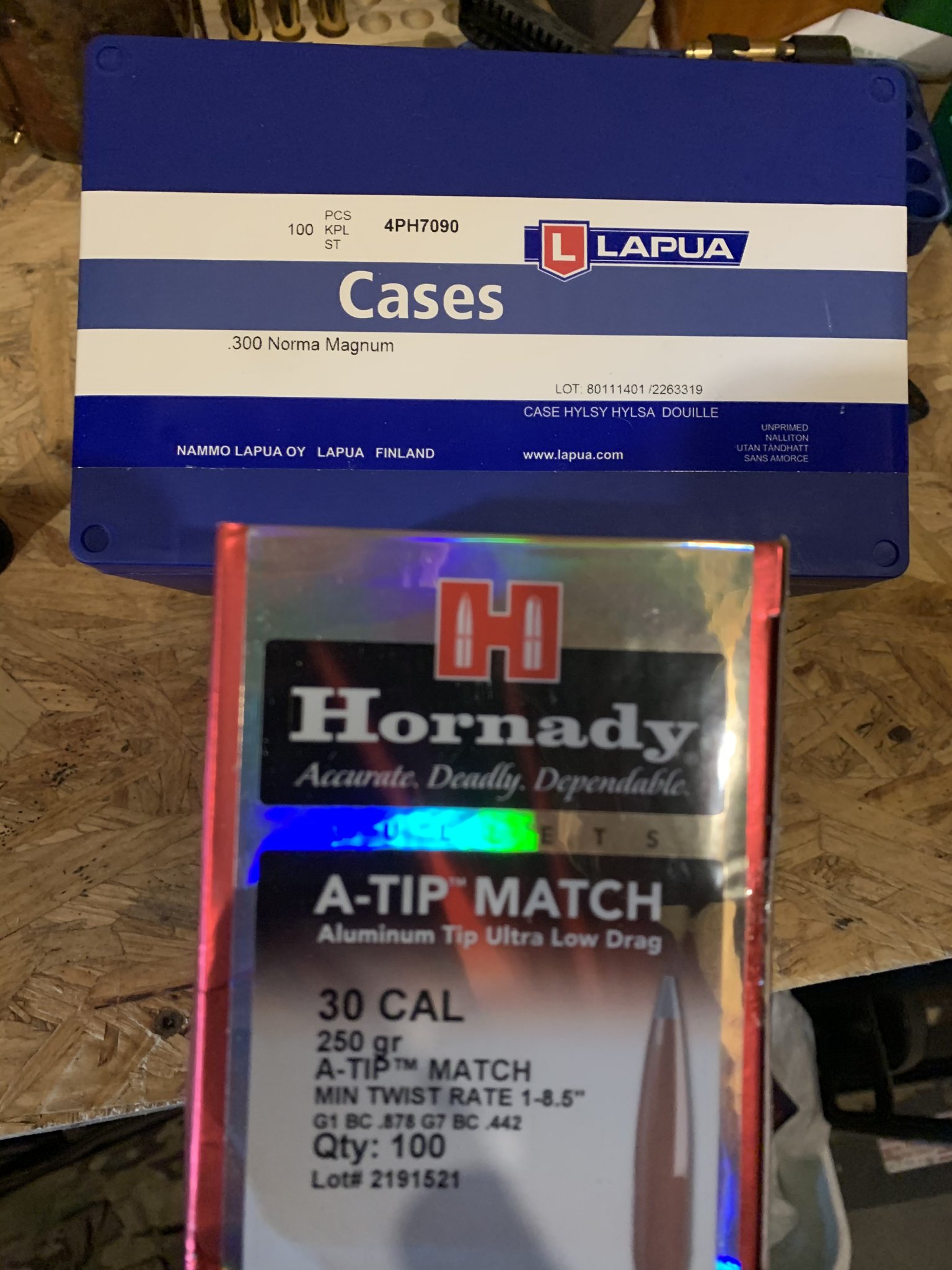

Rifle is a Surgeon 1581 action 26 inch Bartlien 9 twist built by GA Precision
Lapua brass
N570 powder
Hornady 250 ATip
CCI Primer
I never did hit pressure up to 86.0 and 2934 fps. I didn’t think I’d get that far when loading ladder but found what looks like a couple good places to work with around 2920 and a wider node at 2870 as well. Can’t wait to stretch the legs on this one!
Pic 1 AB ballistic calc for 2010 yards and 5500 DA which is about average here
Pic 2 results from lab radar put into a spreadsheet
