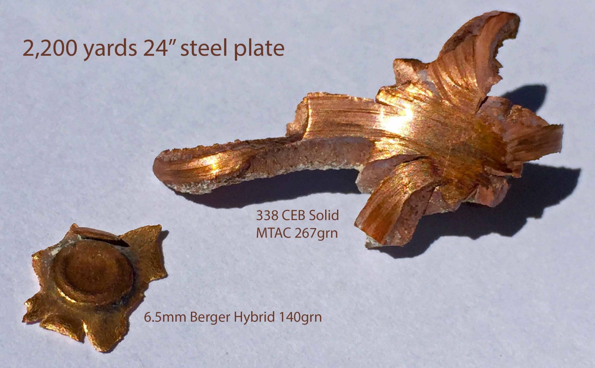

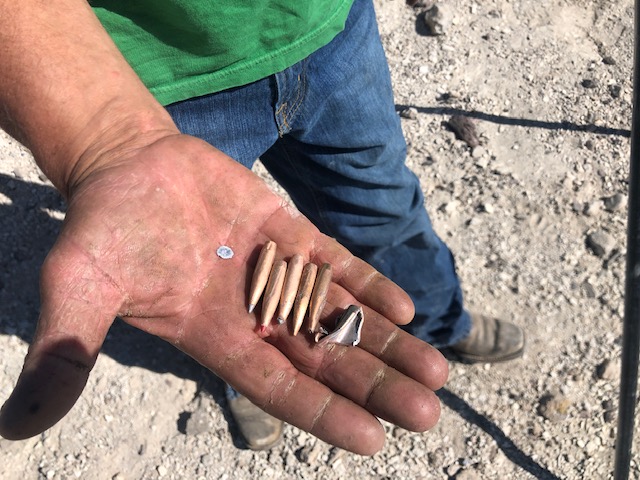

Another real issue with solids is impact identification. Not only is the mass per BC lighter, but the bullet does not leave anywhere near the frag signature as traditional jacked bullets. So comparing a 180 grain 30 cal solid to a 300 grain traditional bullet on a plate at 2000+yards, is night and day. Solids tend to hit the plate and deflect and traditional bullets explode even with very little energy left. The result is very apparent when trying to spot similar weight & caliber bullets; even worse if you're down caliber for a similar ELR target.
Below are A-Tips and a traditional Berger (the little circle), from 6.5s on a plate about 2k.. But honestly, impacts on bother were impossible to spot. The first A-tip and A-max were in the dirt and did not hit the target; they looked like they could be reshot. Some of the others apparently did impact, and were found in front of the plate.
Look below (if you have patience) for a difference in impact between a traditional 338 at 2400 yards vs a similar weight solid at only 2200 yards. Note that we could see the frag through the scope on the traditional impacts and not at all with the solids even though it was a couple of hundred yards closer.

How can you say that? Can you show us evidence that is counter to the video I shared?
Please look at the dust signature from the same exact target location on the solid vs the lead bullet.
Explain how a bullet that doesn't not frag or does very little frag in any way creates the same "dust signature".
Please explain how a 3000fps 30 cal is not at Mach 1.2 (the transition area) at 29.9inHg by 2000 yards, when in many cases 1.2 is closer to 1800ish
If you are going to post please back it up with examples and facts. I think that would help us all understand what you are saying.
Again, I am a fan of solids, but they are NOT magic.
I agree solids don't show much splash on steel, for sure. But for kinetic energy related 'splash', e.g. dust, noise and movement, I have found solids are OK relative to lead swagged bullets the further out you. This is from the higher maintained velocity and resulting energy they provide over the lower form factor swagged bullets. I don't have video of this, as I don't have video of any shooting. This is just my observation from several hundred solids fired at 1500 to 2200 yds over 3 years of shooting them. I have never seen a solid impact at further than 2200yds so I can't comment past that range.
And I said at "Montana density altitudes", e.g. 5000 to 7000 ft. A 300NM fired 198gr is easily doing 3100fps at muzzle will still be screaming at 1500fps at 2000yds ... and still carrying over 1000 ftlbs. You are correct that at sea level, the entire ELR shooting gets harder, and this is for all projectiles, solids and other.
And I would maintain that projectile choice rather than cartridge choice is the key to long range hits.... 300 win mag, 300 wsm, 300 nm, 300 prc etc will all get the bullet moving at a fast enough mv without a lot of variation, with the smith and barrel are good.

what make the frag signature in the dirt when a steel plate is struck?
it is the lead, the solids do not frag the same way into the dirt.
The further you go the more intact a solid will stay. I pull them with most their mass frequently. It’s just how it is, again please go back and see a 338 solid going nearly 3100 compared to the much slower lead core, and the lead core was further at 2400 yard. Forget the plate, watch the dirt.
