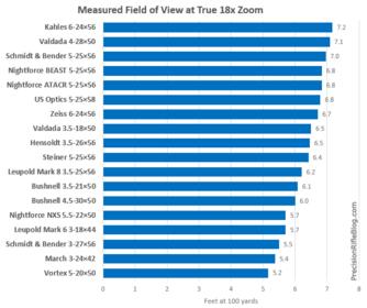

Optical Performance Results – Part 2 ARE IN
The Kahles K 6-24×56 rifle scope offered the widest field of view at 18x magnification with 7.2 feet at 100 yards, which is quite impressive. But the Valdada IOR RECON 4-28×50, Schmidt and Bender PMII 5-25×56, Nightforce BEAST 5-25×56, Nightforce ATACR 5-25×56, US Optics ER25 5-25×58, and Zeiss Victory Diavari 6–24×56 were all right there at the top as well.
