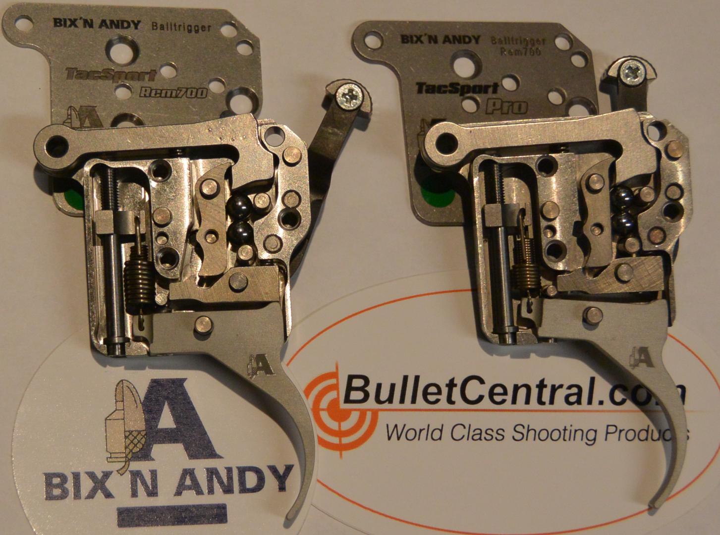

Bix'n Andy TacSport and TacSport Pro 700 compatible triggers

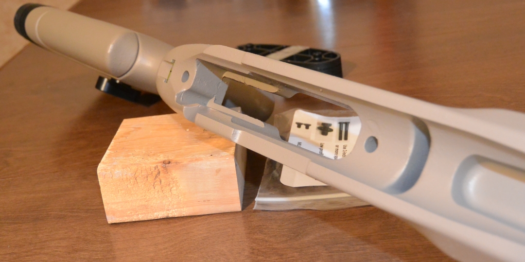

Today I got one of the new Grayboe Ridgeback stocks in for a review this year and I figured that I would share a few picks, dimensions, and generally what I plan to do. I'll even try to be brief though it may just kill me to do so.
Grayboe is, as most probably know, the company started by Ryan McMillan, son of McMillan CEO Kelly. The idea was to make a stock that did not require the 8 skilled man hours of labor of a hand lay up fiberglass composite stock method that McMillan stocks use but still use epoxy and fiberglass (rather than injection molded plastic) as the materials. The Grayboe company shared the McMillan location for a while and there was some confusion about it being a part of McMillan. Ryan and Kelly really have only themselves to blame for this as they did a lot of interviews about it together and blurred the lines a good bit in the beginning. I expect it is a tricky thing to both try to get a little piece of the name recognition of the established industry leader who you worked for many years and also differentiate yourself as an entirely independent entity. Anyhow, Grayboe now has it's own facility though I do not think that the confusion has been totally abated or maybe ever will be. Grayboe is not part of McMillan. That probably didn't help but I tried.
Grayboe is a little sparse on the tech specs on the site so I will drop some measurements I did here and many more with he real review (which will be a shiny front page thing).
Some tech specs I measured:
Weight: 58.3oz (3.64lbs) This is basically exactly what a McMillan A5 adjustable fiberglass stock averages
recoil lug slot thickness: .3565"
recoil lug slot depth: .5455"
recoil lug slot width: 1.34"
barrel channel width at stock front end: 1.034"
Width of forend: 2.524"
Inlet: M5, Grayboe sells a Mesa Precision arms one but you can use any. DBM is not included with stock.
It has a bubble level in the stock
LOP (with included parts and stock rem trigger): 12.5" - 13.885" with 5x .277" spacers for adjustment
I have not totally decided all of what I am going to do with the review but I do know a few things. I am going to either use my Remington 5R barreled action or drop a new custom build I have been kicking around doing in it. I will start out just using the stock inletted as is but I may eventually bed it. Both of these options seem quite popular with users as Grayboe stocks are low enough in cost to appeal as a drop in option but also look to be high enough quality to warrant the full bedding treatment. Grayboe molds Aluminum pillars into the stock so these things are pretty darn easy to bed. I am told that these stocks are very easy to cut and machine so I will certainly test that at least with a detachable molded palm rest and perhaps with bedding as well. We will see where it goes. for now I can tell you that the unique cheek piece design is totally solid (it actually looks like they added a guide rod over early prototypes) and that it comes with a nicer than expected recoil pad.
Anyhow, I wanted to get a little info out there before I wrote up the whole review since I expect that will be a good while in the making.

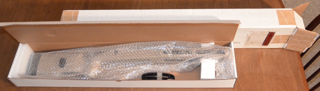

Unboxing

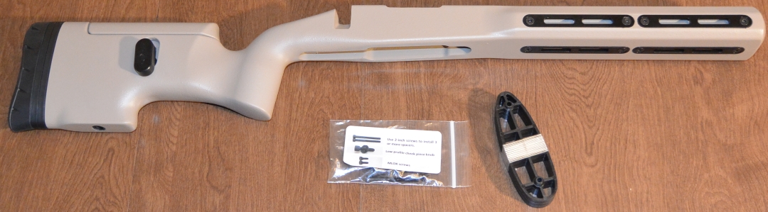

What's included

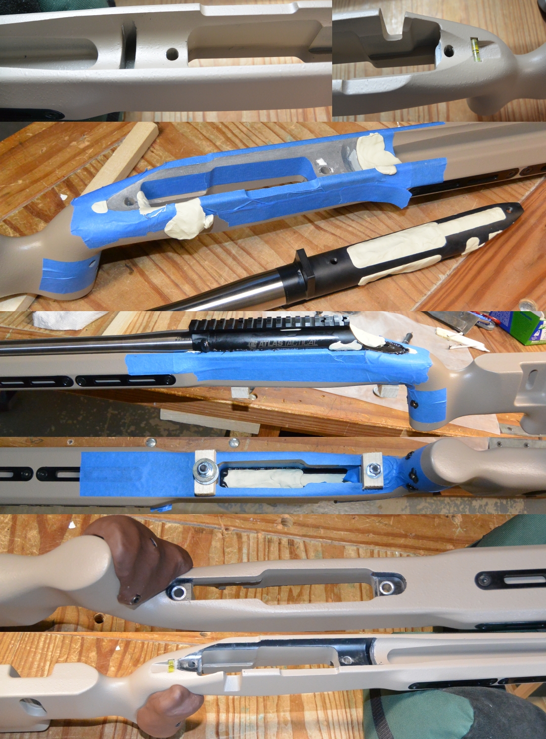

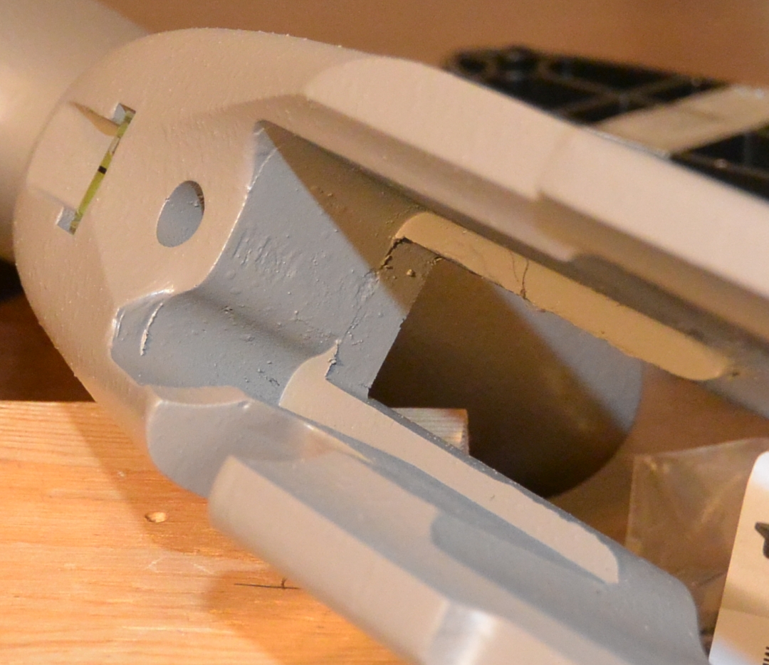

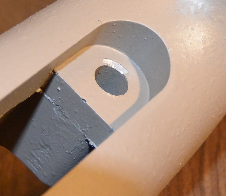

Action inletting overview
Action inletting detail

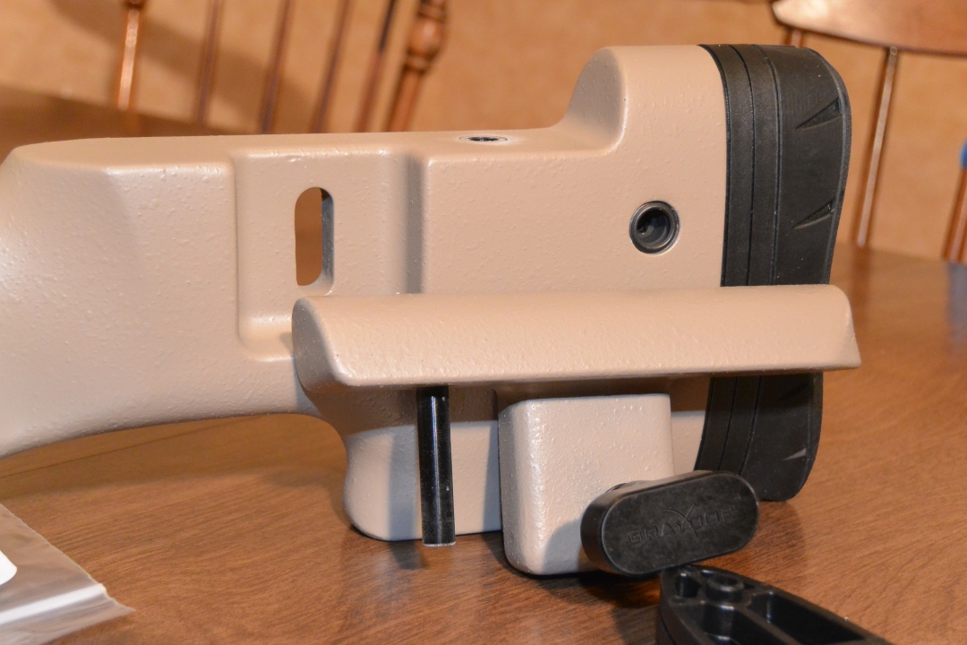

Cheek piece detail
There are aluminum pillars molded in.

Now that adjustable cheek piece is interesting to me, easy to make and keep costs down but looks like it should be adequately solid. Interesting.
Yes, when I first saw pictures of the prototype your thoughts were very similar to mine. The prototype version actually didn't have the metal guide rod and so was entirely dependent on the friciton generated by the thumb screw to keep it secure as the channel is not a tight enough fit to offer total restriction on the range of motion of the cheek piece. I expect there was some small degree of rotation possible in this design as the friciton would not have been enough to keep the piece from being able to rotate one way or the other to the extent the channel allowed. With the guide rod that has been added the design locks down with no movement at all. The design indeed looks very inexpensive to manufacture and is quite solid. Really, that is the idea behind the Grayboe stock in general.

The shortest LOP with the included recoil pad and a common curved (as apposed to fancy adjustable shoe) trigger is 12.5". Included are 5 spacers of .277" thickness (presumably you could use more) so you can get to 13.885" using the included parts. I'll add this data to the specs in the first post as well.

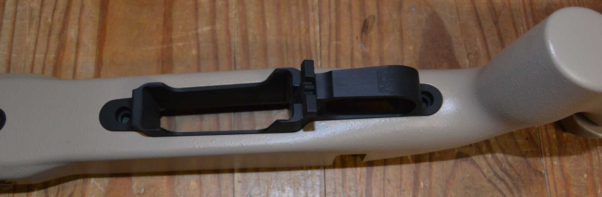

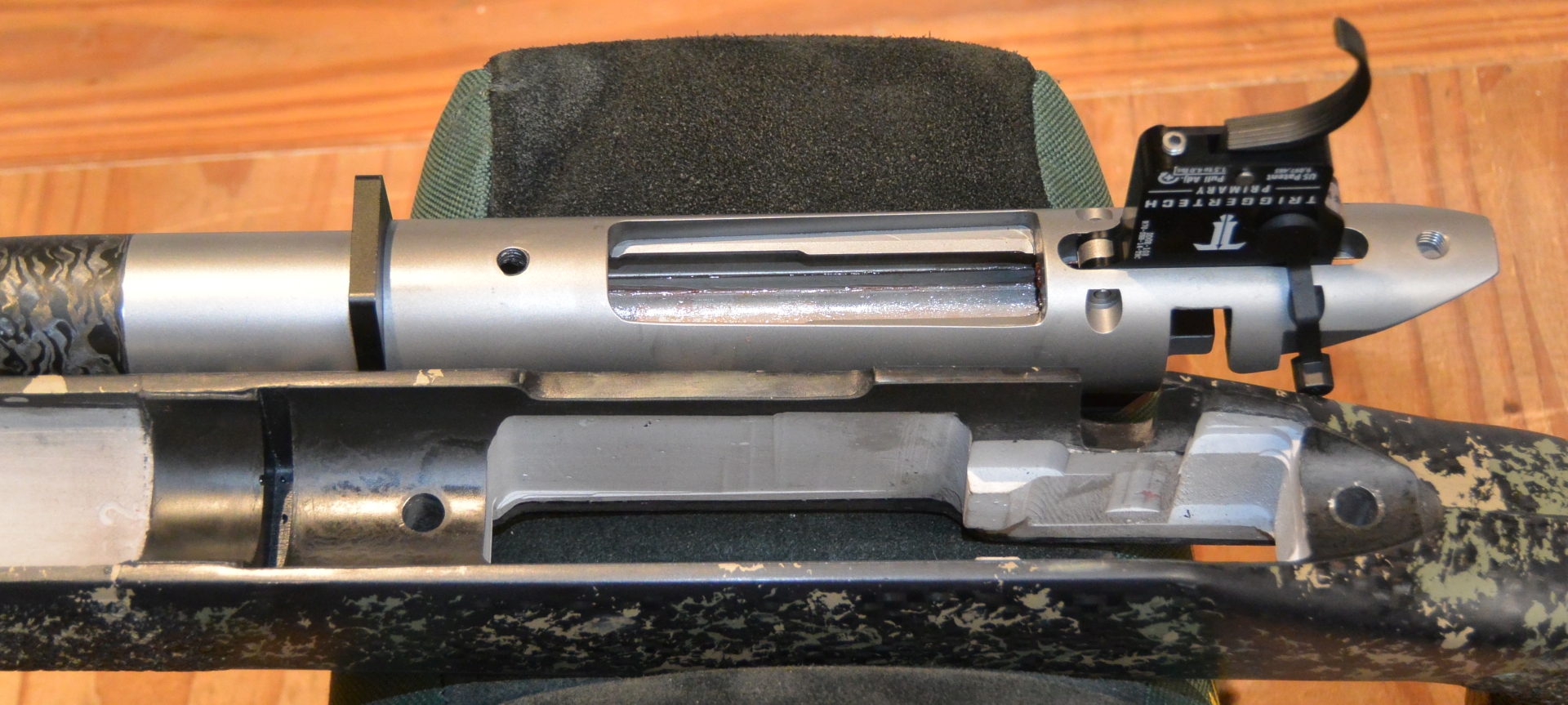

The Mesa Precision Arms bottom metal arrived yesterday so I figured I would update my progress on that review as well as the others that have sprouted from it.
First off, here are some pics of the MPA bottom metal sitting in the Grayboe Ridgeback. The fit is excellent.
I should next update on how and what is going to be tested since a lot has happened. What was once a single stock review has become a stock and two rifle reviews. I'll lay out to you all the components involved since custom rifles are a Lego-esque undertaking.
The first rifle review will be a build in the Grayboe as I hopped. It will be a Kelbly Atlas Tactical action with a Krieger barrel installed by the Kelbly guys. The caliber will be .223 Rem and it will also feature a not yet released model Bix n Andy trigger. I will be testing this both unbedded and with an end user (me) bedding job. I am still lining up all the ammo for the review but Lapua, Prime, and Copper Creek will be included with the possibility of Desert Tech and Hornady as well. I have a Sightron SIII scope in for review later this year that I will also use in a Bobro mount.
The second rifle review will be a 6.5CM ultralight hunting rig built by Mesa Precision arms. This will be based on their Crux line and include their new Titanium action, their bottom metal, a Proof carbon wrapped barrel, a McMillan Edge carbon stock, and Trigger Tech trigger. I will also use the Sightron SIII on this with the Bobro mount. Prime and Copper Creek ammo will also be represented along with the Lapua (if they have their 6.5CM loaded ammo ready by that time) and possibly Desert Tech and Hornady.

I am running the MPA bottom metal as well, and also find the fit and finish to be excellent. It started in a Grayboe Renegade, and now it sits in my McM A5, fitting both very nicely with no gaps.

I’ve got a Grayboe Renegade with mpa bottom metal and it serves me just fine. Fit and finish excellent and the barreled action that sits in it shoot great. I’ve been considering trying out a ridgeback. Look forward to seeing how the full review goes.

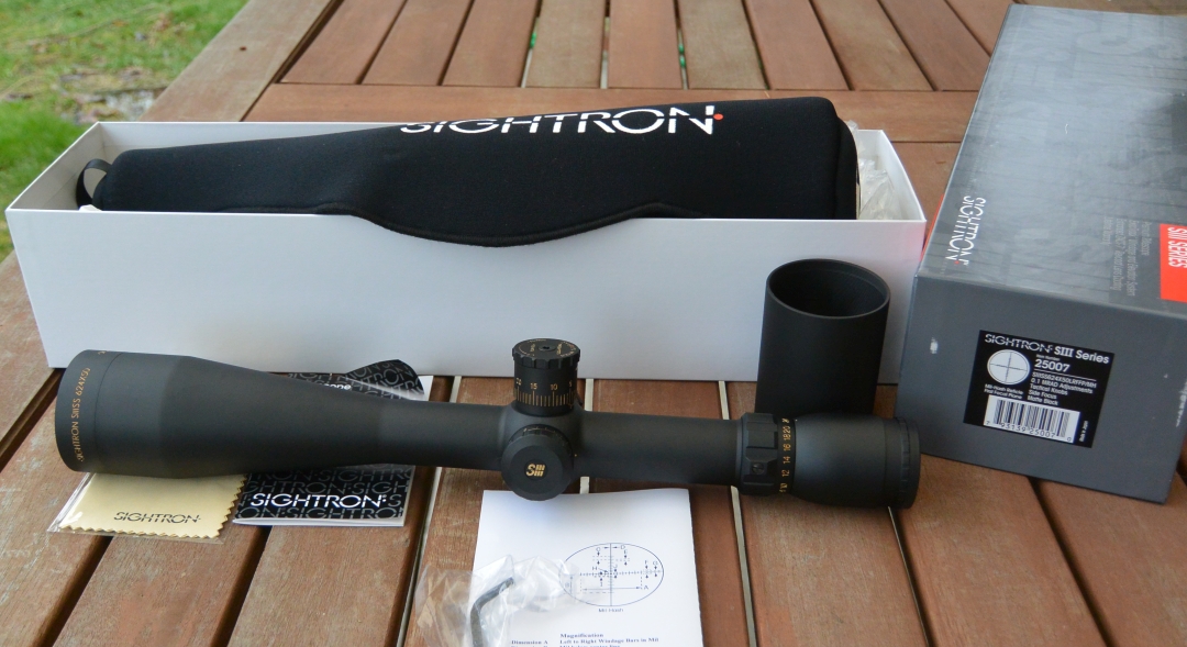

    I also mentioned last time that the Sightron SIII SIIISS624X50LRFFP/MH scope arrived for review later this year and would also see some time on these rifles. Here is a nice unboxing pic of that

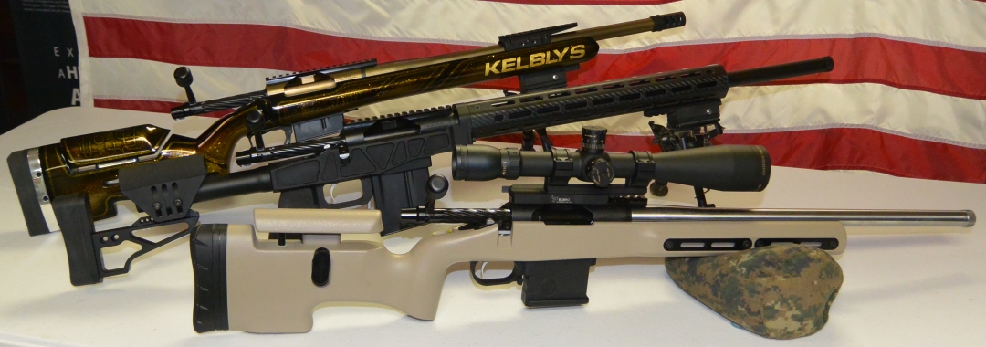

    Kelbly Golden Girl rifle, NYX rifle, and the new .223 I am testing.

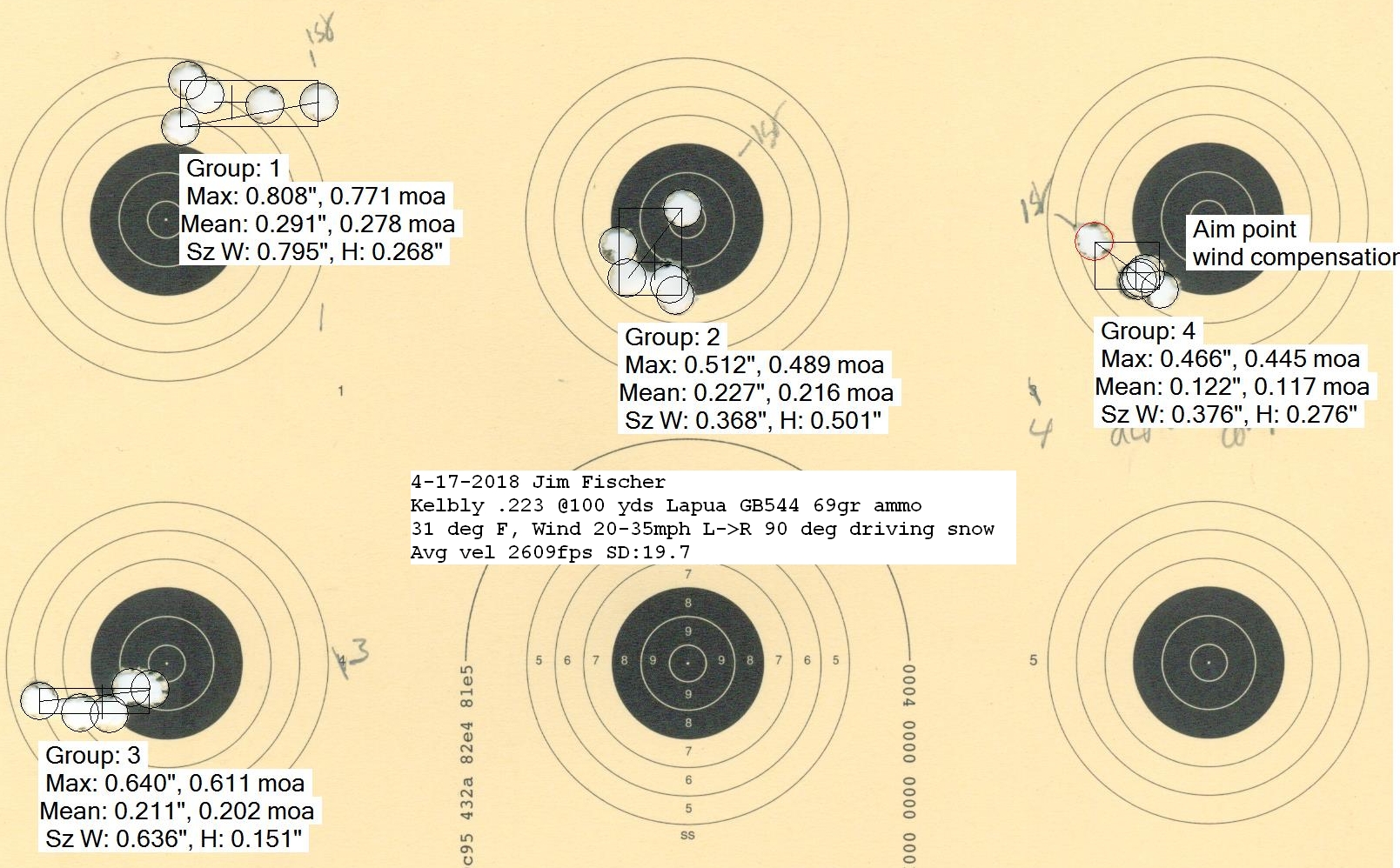

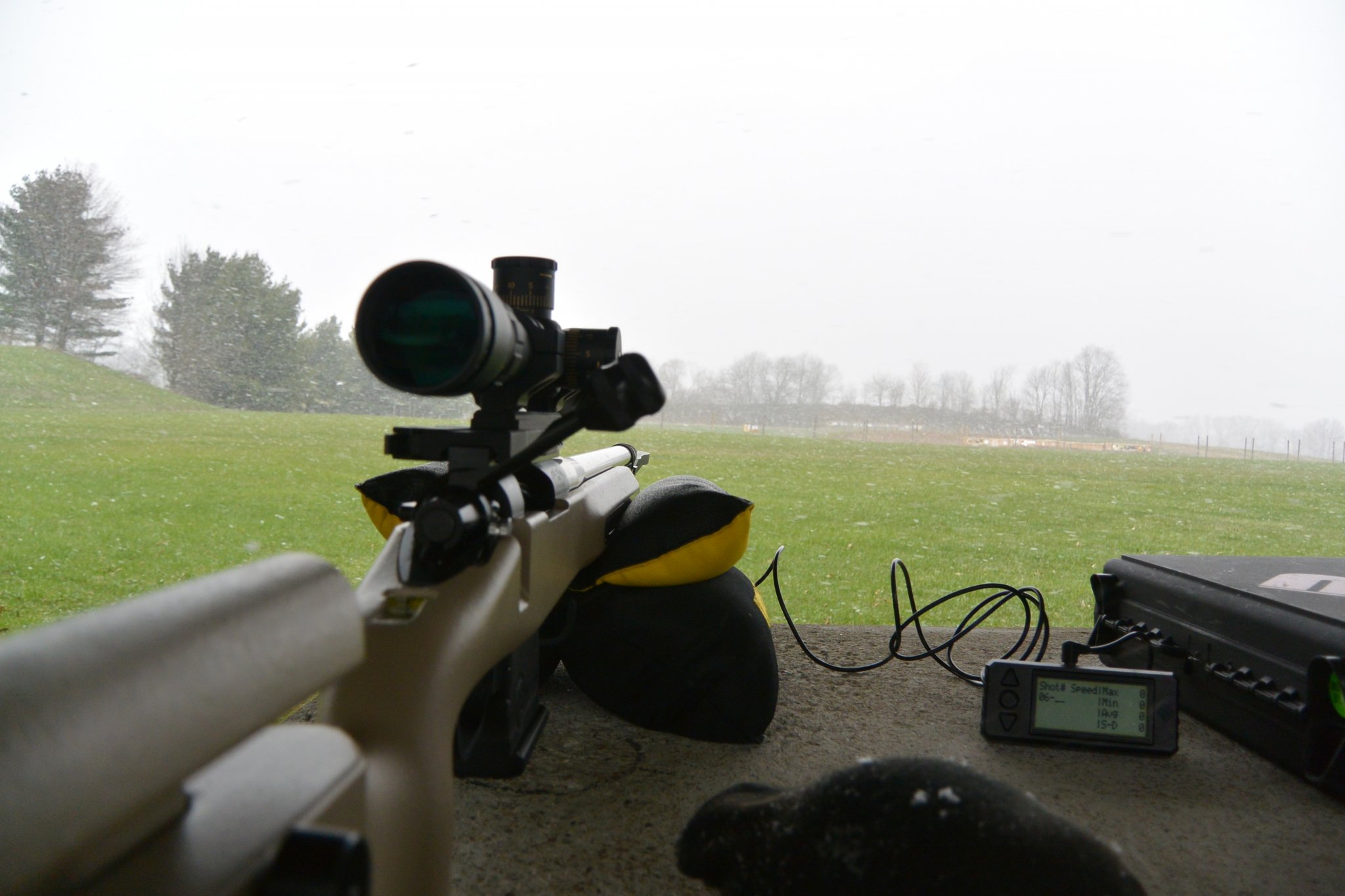

    This is what you like to shoot in right?
    Sitting there, in 31 degrees, with the snow driving horizontally across my field of fire, I starting thinking that I must be out of my mind. I was also thinking that between the cold, wind, and snow, this could make for some really lousy groups. What the heck though, I had the day off work, a new rifle, a box of ammo, and the benches would even have been covered if the snow would just condescend to descend some. If it all went to hell I could just pack it in early, tour the Kelbly factory, and be home early for dinner. It didn't exactly go to hell though. It actually went much better than I expected and I came away with a few thoughts:
    Not bad groups for a blizzard.
    1) 30mph wind is no joke. Whether I tried to pick my timings (the first 3 groups) or move my aim point (the 4th group) the wind still spread everything quite a bit more horizontal than it moved vertical.
    2) I wonder how much effect hitting big juicy snowflakes at 2,600fps has on a projectiles trajectory. Does it become a special snowflake itself?
    3) This rifle is really going to bug hole. Two of these groups are half an inch in a blizzard, there is .25" vertical spread on most of these groups, and this is the first ammo I have even tried.
    4) The first shot is the furthest on 3 of the 4 groups. I wonder if bedding the rifle will bring that in some and how much better weather will help.
    5) I have got to get me a magnetospeed chrono like Ian's that I borrowed. It is so damn easy to use and it works in the snow. Mine does not work in the snow. I wish it wasn't so blasted expensive.
    6) This Sightron SIIISS624X50LRFFP/MH scope is working perfect for this. It has a pretty fine reticle even at 24x, the parallax isn't showing any lash, and the optics and tracking seem good so far.
    7) This Lapua ammo looks like it is going to agree with this rifle well. I wonder how the velocity numbers will change in better conditions. It noticeably increases on shots where the round has been in the warm barrel longer. I also wonder if the SD on the velocities will tighten up some. 19.7 is not terrible but it is not world beating either.

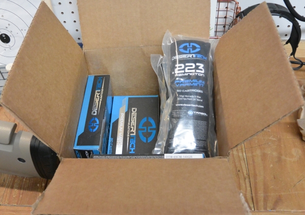

    Desert tech ammo unboxing.

    The stock bedding and grip add on are done. The Grayboe stock does machine very easily and the inletting process, which, involved grinding away the paint and some stock from a large area, did lead to some interesting insights on the stock construction. I should also note that the paint is quite resistant to chipping as the drill holes for the grip anchors did not chip out at all. It appears to be a very durable paint. The embedded aluminum pillars were very nice for easing the bedding process as the alignment of the barreled action in the barrel channel as well as the depth in the stock relative to the magazine system were therefore not subject to being messed up during the process. When an action is bedded with the pillars getting all of this alignment and spacing perfect can be tricky. The bedding compound I used is Acraglas. I have no opinions on it relative to alternatives as I used it on the first rifle I bedded and, being satisfied, have not changed since.
    Step by step bedding of the Grayboe Ridgeback stock
    For those interested, the grip is made of an oven hardening polymer clay available at any craft store for around $10. It is secured to the stock with machine screws threaded into brass 10x32 injection molding inserts that are embedded in the stock with the epoxy bedding compound while I am bedding the stock. In this way I can make a new grip for around $10 and change it out easily. Most stocks offer garbage trigger hand position and way too much trigger reach. This one is no different in that respect but Grayboe's material is very easy to change that with.

    The Kelbly's rifle review is progressing well and I was able to have it out for another day of shooting this week. This time was the first time I had some reasonably good weather. It wasn't windless, but it was manageable. I was able to get quite a lot of testing that I have good confidence in done and I was able to go pretty low on a few of the groups. The couple below were with the 69gr factory Lapua. This ammo averaged under .5"@100yd for all groups fired on this day with good conditions. Next up should be doing some long range steel shooting with it. I have quite a bit of velocity data on all the ammunition tested and the rifle is zeroed and ready to go for that.
    A few tight groups from the Kelbly .223 shooting Lapua factory 69gr GB544

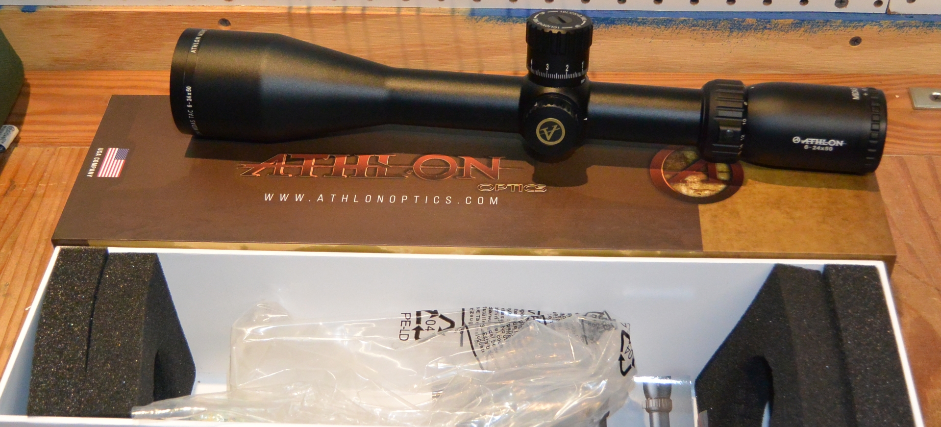

    Athlon Midas TAC 6-24x50mm just out of the box.
    While playing with the Bix N Andy trigger in the Kelbly build I have found myself running down the rabbit hole regarding trigger design and theory. Their concept of using ball bearings to take the bulk of the down force from the topsear is very interesting and my testing is indicating that it works very well. The writing about this is now somewhere between a subsection and it's own review in length so I am not exactly sure where I am going to end up on that. For now I will tease you with a well labeled picture of the operating mechanism so that you can take a gander at the concept as well as the quality of the machining.
    Bix N Andy Tacsport pro prototype labeled for clarification.

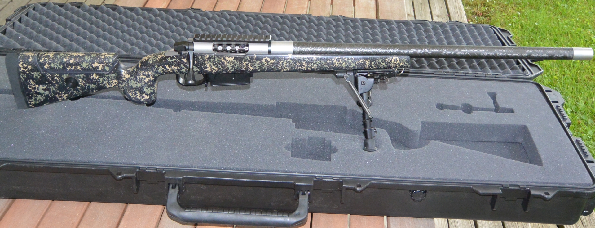

    Mesa Precision Arms Crux in McMillan adjustable carbon Game Warden stock.
    Today I picked up the Mesa Precision Arms Crux from the FFL. He was impressed, and I can see why. It arrived with the full custom cut foam Pelican box treatment. Opening that beastly case to see all that steel, carbon, and titanium all so nicely ordered is feels pretty good. The look of the visible carbon on the proof barrel and McMillan adjustable carbon Game Warden particularly set of the appearance adding depth to the visuals. It was a rainy and terrible day that has put me behind in business but I am smiling and I think it will be a few days before that wears off.

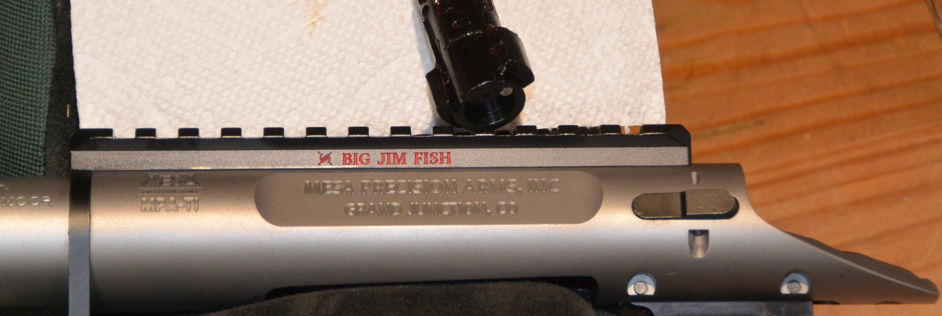

    Mesa Precision Arms Crux bedding
    New Mesa Precision Arms titanium action and bolt.
    I'm very excited to go out and shoot the new beauty.

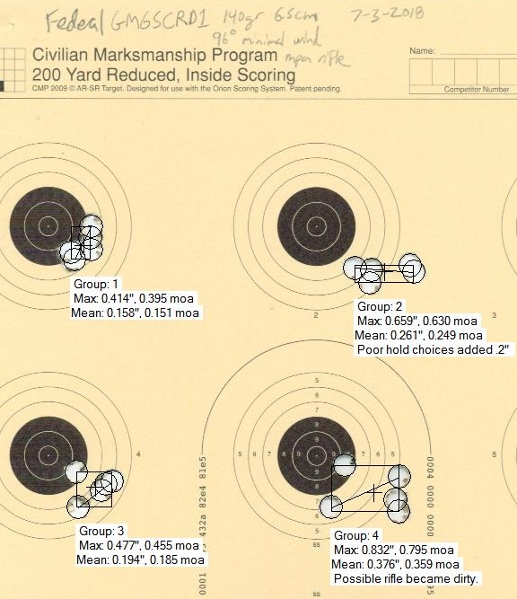

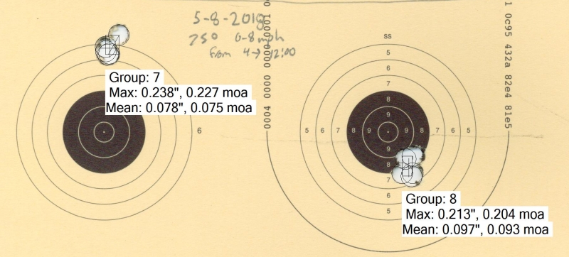

    The Mesa Precision Arms Crux review testing is rolling along well now. In fact, it is mostly done. The rifle is shooting quite well and has proven to be sub .5" with Federal GMM 140gr SMK factory ammo. It is a pity that I made poor choices on my hold on the second group I fired because I added .2" to that group with the bad calls. One intends to lower group size by adjusting the aim point to conditions not increase it as I did.
    The Mesa Precision Arms Crux goes sub .5" with 140gr FGGM factory ammo.
    In addition to grouping quite well, the FGGM ammo also proved to have a velocity SD of only 13fps. That is very good performance on both counts, is frankly a bit better than I expected from Federal, and is realistically actually match grade. My brother and I have argued for years about the quality of FGGM ammo and he is very much enjoying his victory in that argument.

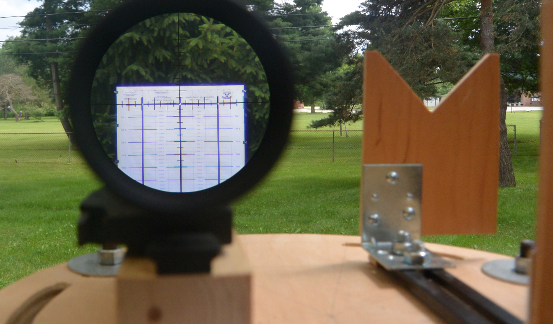

    Some progress has also been made in the scope reviews. The Sightron SIIISS624X50LRFFP/MH, which I have very much enjoyed using for the 100 yd testing of both the Kelbly and MPA rifles, preformed very well in the mechanical testing. It's reticle dimensions were spot on accurate, the reticle showed no cant, and was totally accurate to 4 mils. At adjustments greater than that it started to gain a little reading 4.9 mils at 5.0 mils traveled on the target and 12.4mils at it's adjustment limit with 12.7 mils traveled on the target. I suspect that this is exactly in spec and that the eventual deviation is due to complexities related to spherical lenses and linearly threaded adjustment screws. The 12.7 mils is from optical center so represents half of the total adjustment range which looks to be a little larger than the advertised 23.3mils. Unsurprisingly, the Sightron returned to zero fine. So far I am very pleased with this optic at it's price point.
    Mechanical testing on the SIIISS624X50LRFFP/MH.
    It was the plan to also test out the Athlon Midas TAC 6-24x50mm mechanically on the same day as the Sightron. Unfortunately, rain poured out of the clear sky to destroy the test target and make me very unhappy indeed. Since I have only one 3' x 8' 25mil test target left, and they are not made anymore. I'm having it laminated just in case and I should get back to testing later this week. If the weather wants to get me again it will have to hit the target with lightning to ruin my day next time.

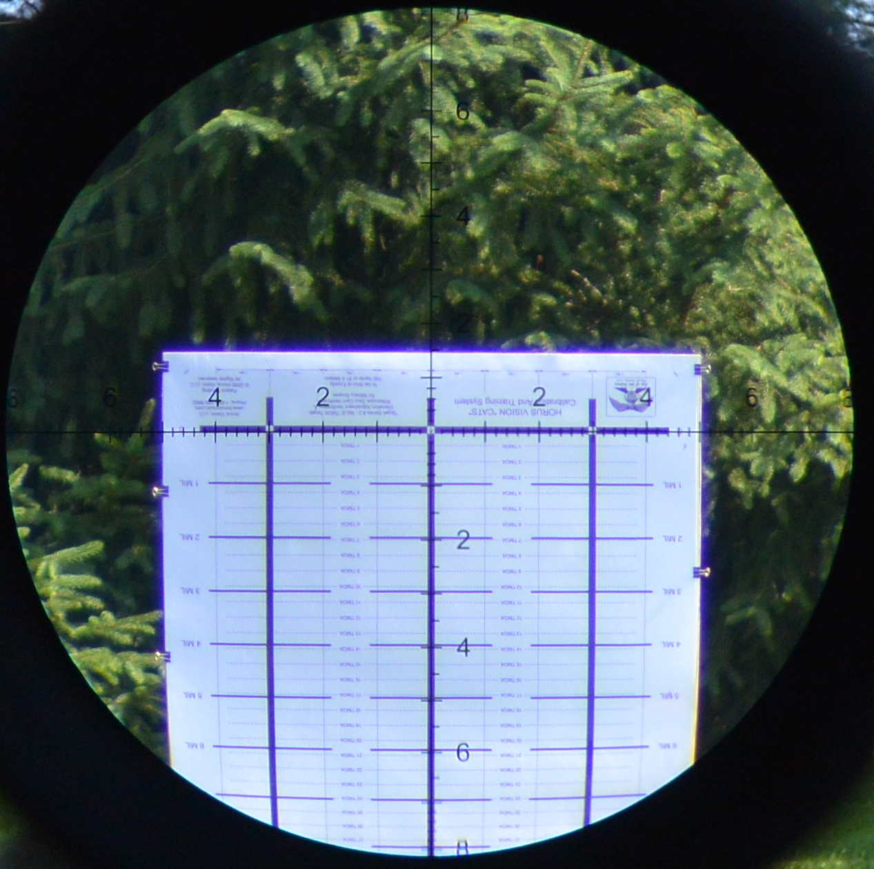

    Update 7-25-2018
    The big news is that the Mesa Precision Arms Crux rifle review is finished and should be up in a week or so.
    In scope news, I just recieved the Athlon Ares BTR yesterday. I will probably get to working some with that this weekend. I have done some mechanical and optical work on the Athlon Midas Tac now that I received my test target back from the laminators. The Midas reticle is spot on in size and the adjustments are also tracking right on. There is really nothing else you can say about that. No further news on the Nikon Black. Hopefully, it will get here by the end of this set of reviews.
    Calibration testing the Athlon Midas TAC 6-24x50mm with APRS2 FFP Mil

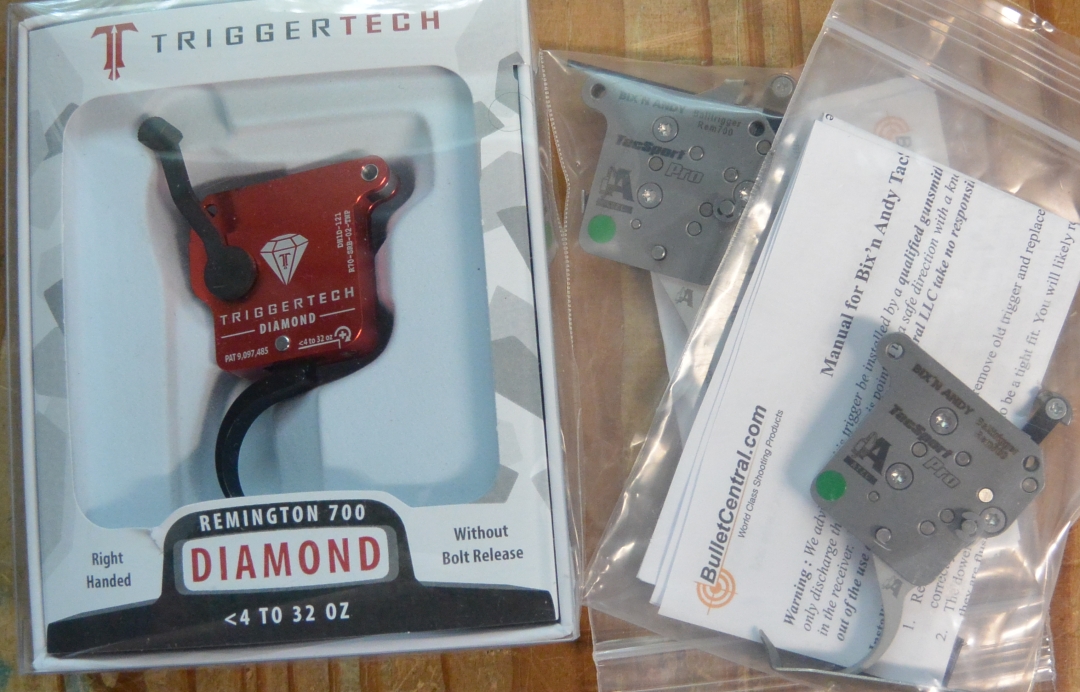

    Last week, I received the last test samples from each trigger maker. This consists of a few Tacsport Pro production units from Bix'n Andy and a TriggerTech Diamond. I will be finishing up the testing on these and should have a Bix'n Andy review next week as well as some updates to the TriggerTech section of the Mesa Precision Arms rifle review. This will involve further testing of pull to pull variation as well as looking at topsear force.
    TriggerTech Diamond and Bix'n Andy Tacsport Pro's arrive for some testing.

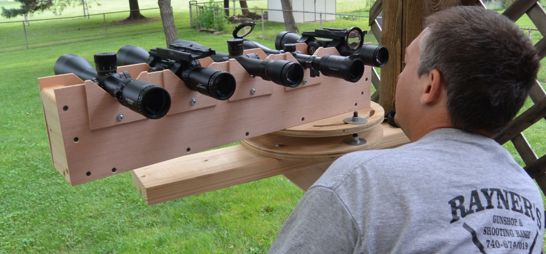

    Optical comparison testing for the sub $1k ffp mil/mil precision optics series.

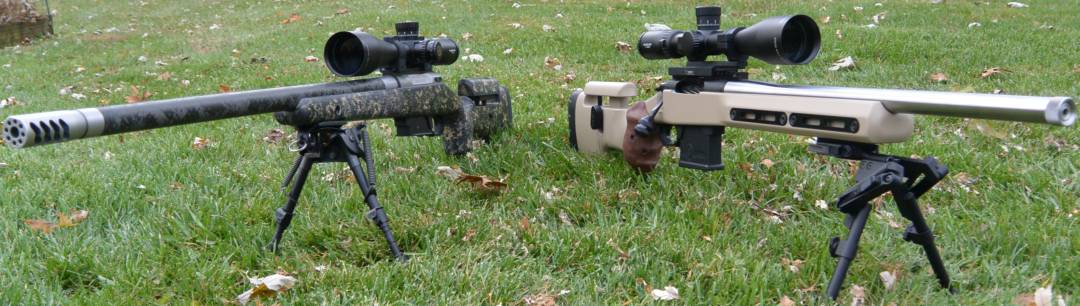

    Athlon Ares BTR 4.5-27x50mm on Mesa Precison Arms Crux next to Athlon Midas TAC 6-24x50mm on a Kelbly’s Atlas Tactical
