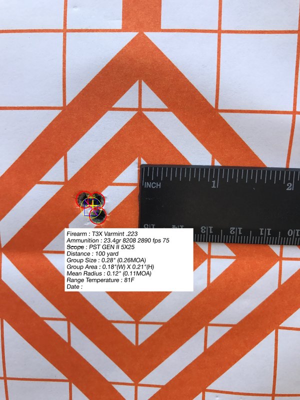

Did a 10 rd load development with the 75 BTHP
But this thing seems to shoot.

My load for the 75 BTHP is going 2890 AVG with a 9 SD using cheap S&B primers and random cases.
SDs below 5. Lake city and cheap Russian Primers.
