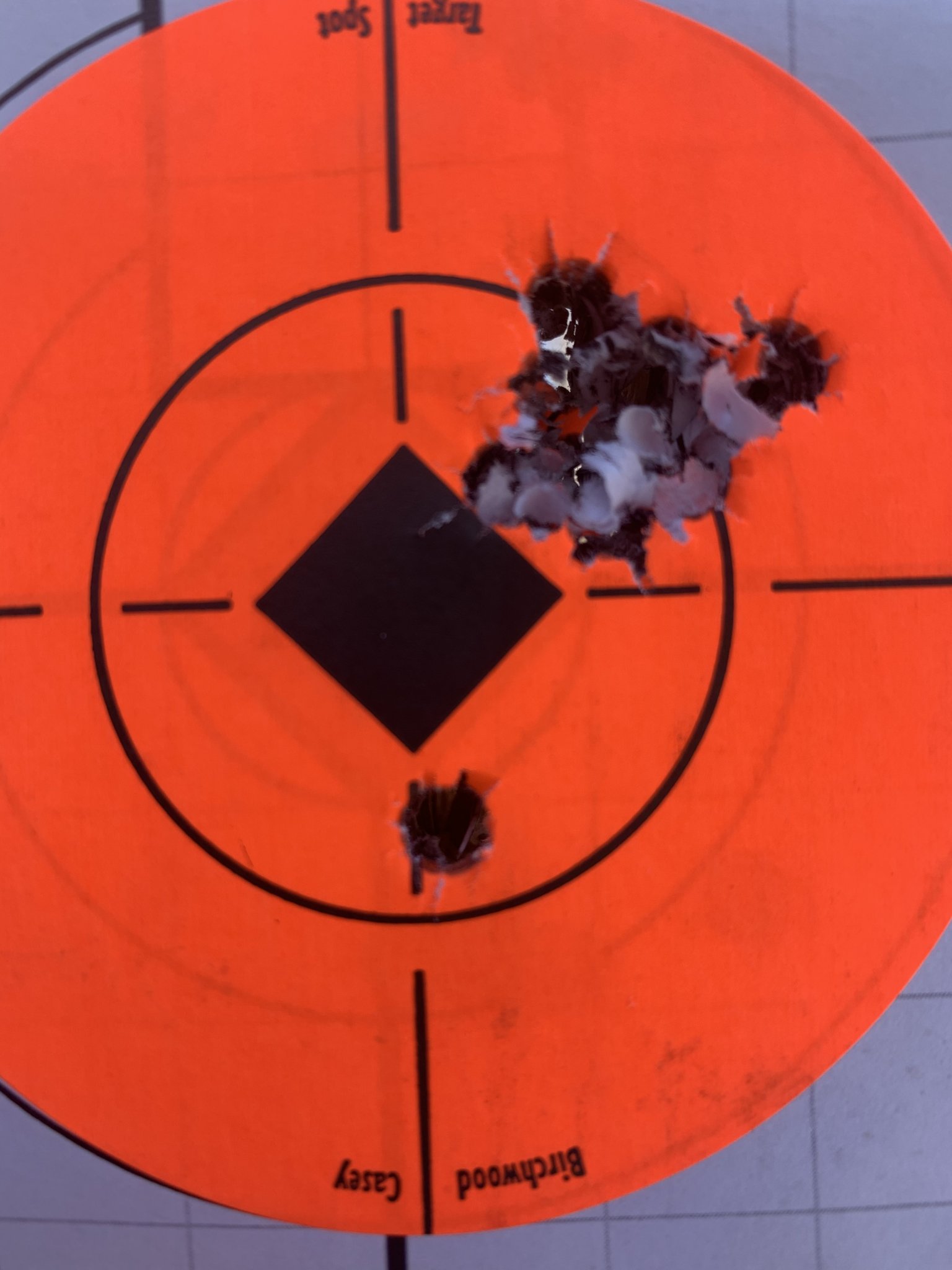

Well I shot some groups with RL26. Averaged about 1/2” across the board testing some different seating depths. I tried both sides of the node I found at 42.9 43 and 43.1. What is interesting is every group I shot had one flier sending the groups out to 1/2-3/4”. I ended up getting a bit frustrated so I hung the rifle up for the day. I don’t think I’ll give up on RL26 quite yet as the SD and ES were beautiful. I am annealing my cases and will see if I catch something in my process causing the flier.
Here is a picture of my most recent 10 round group. I am happy with the consistency of the load for now. 1 round fouler on clean bore followed by 10 consecutive with 43 grains RL26 CCI BR4 and lapua brass. Seated at 2.700 with the 85.5. I might fiddle with primers a bit because I am obsessive. I will be annealing all my brass now as I haven’t as of yet. That may bring it down a bit. Group measures .550 for 10. What do you guys offer for advice. My reloading process is clean, FL size .001 under, expand with KM mandrel for .002 neck tension, seating with Whidden and only getting .002 variance on the high end.

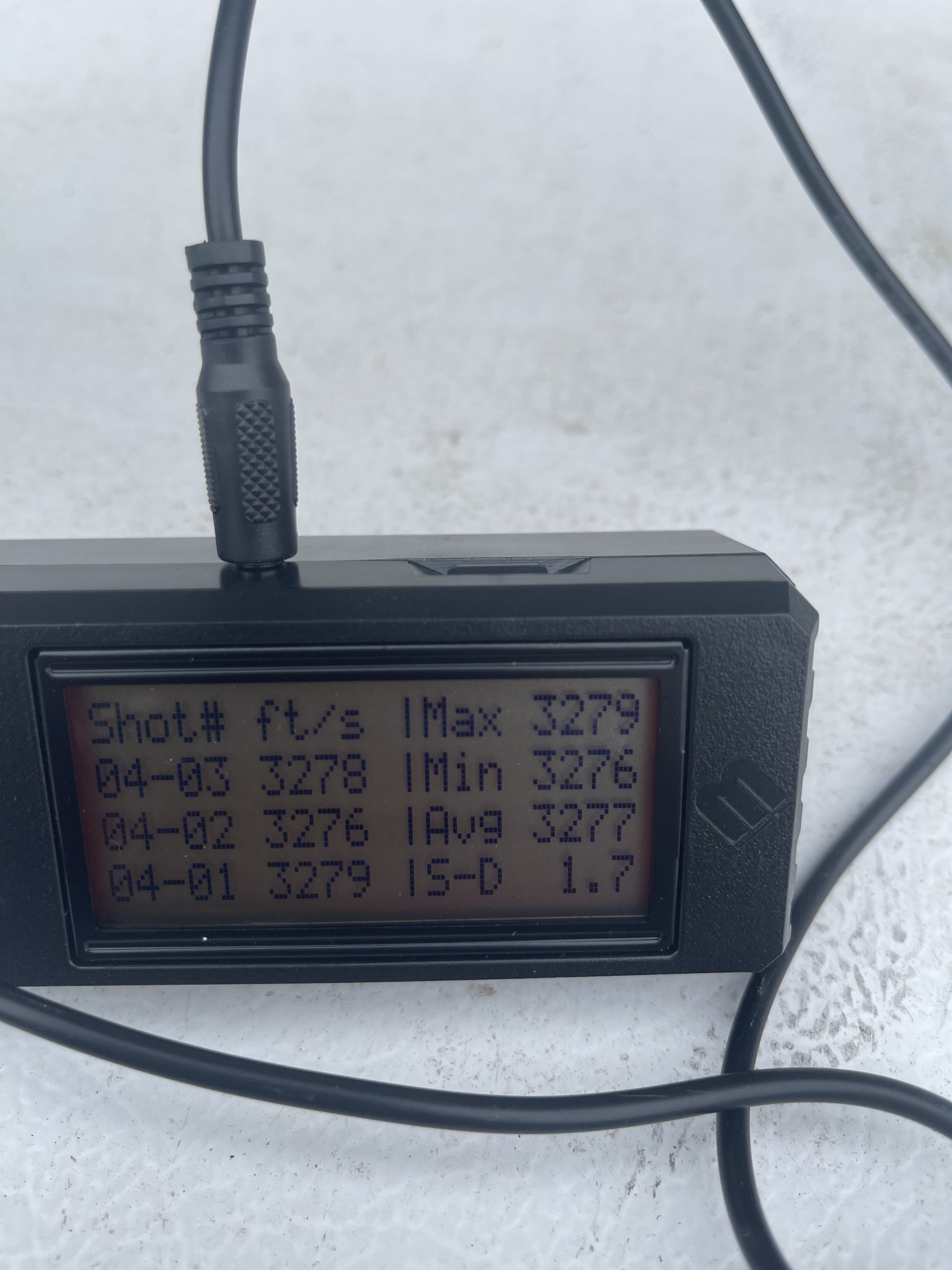

Group looks good, have you measured MV?
