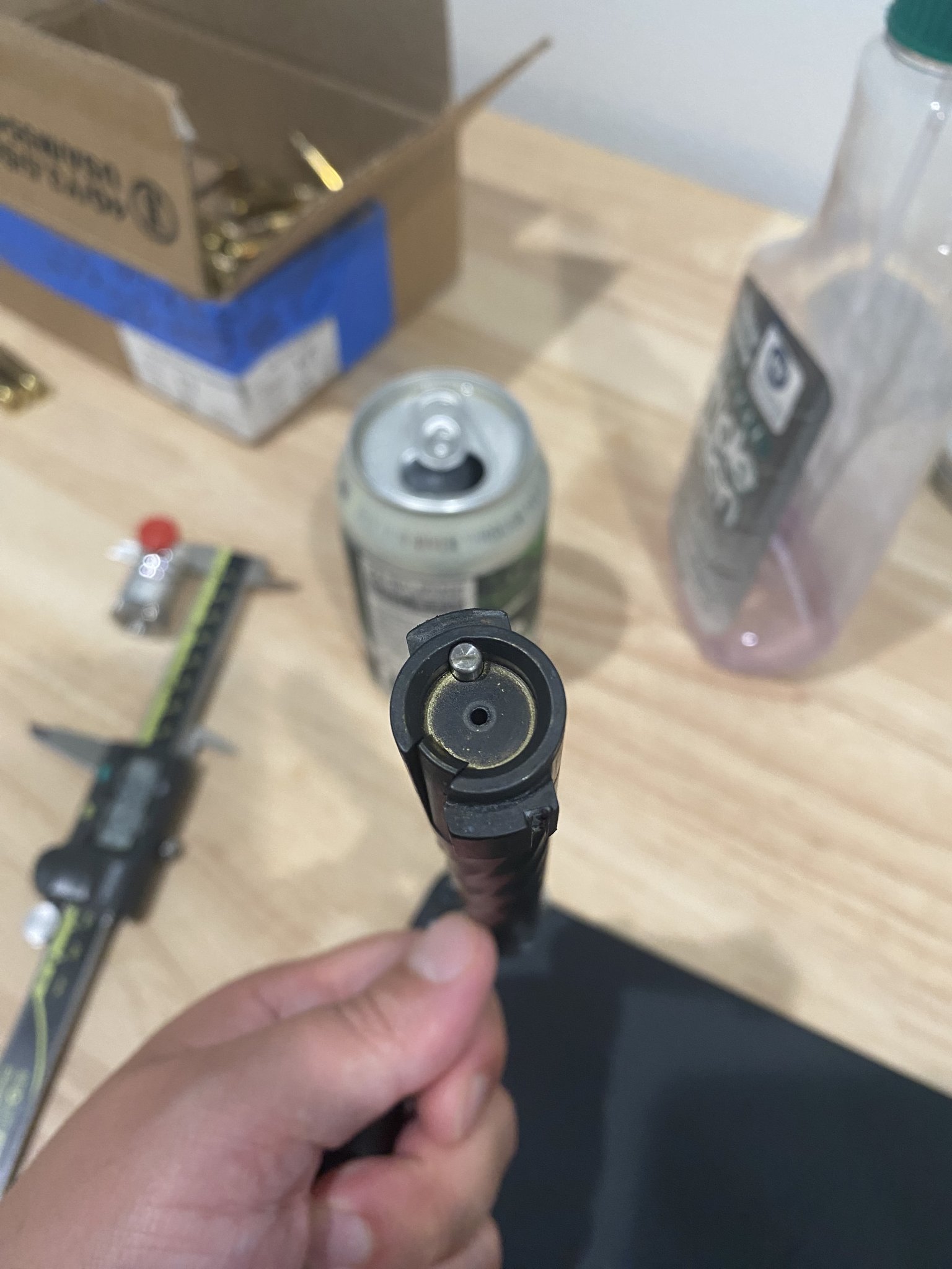

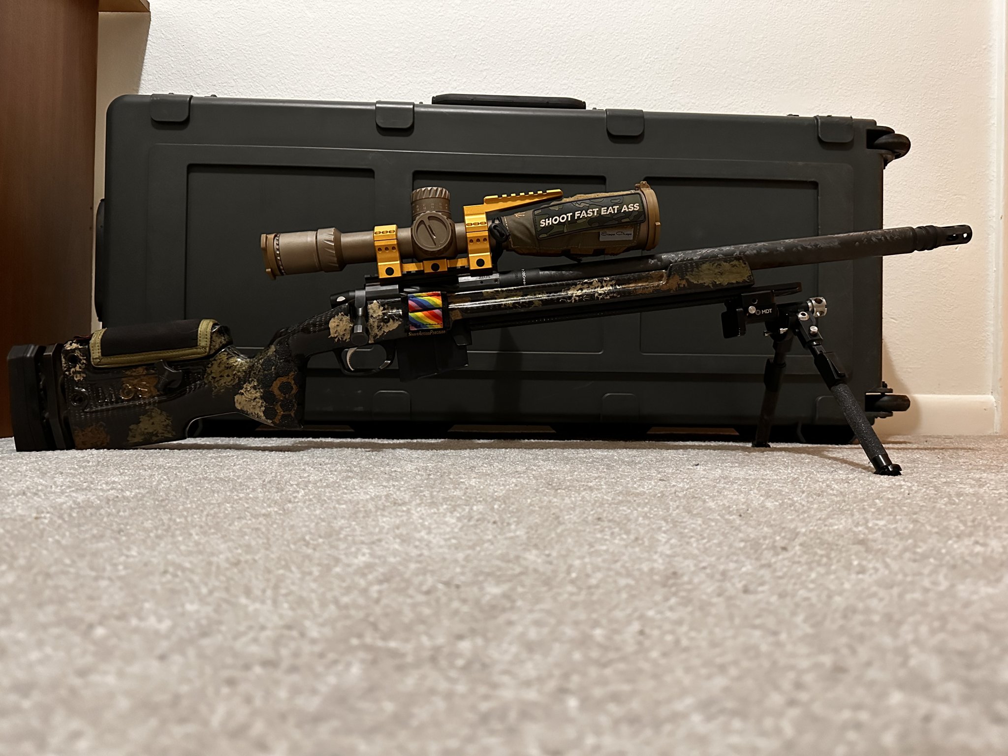

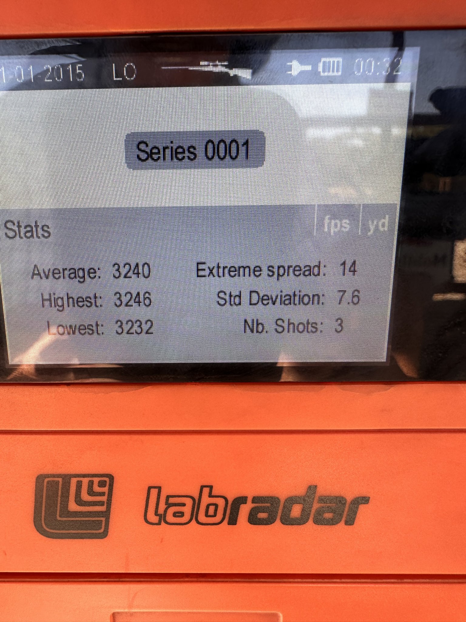

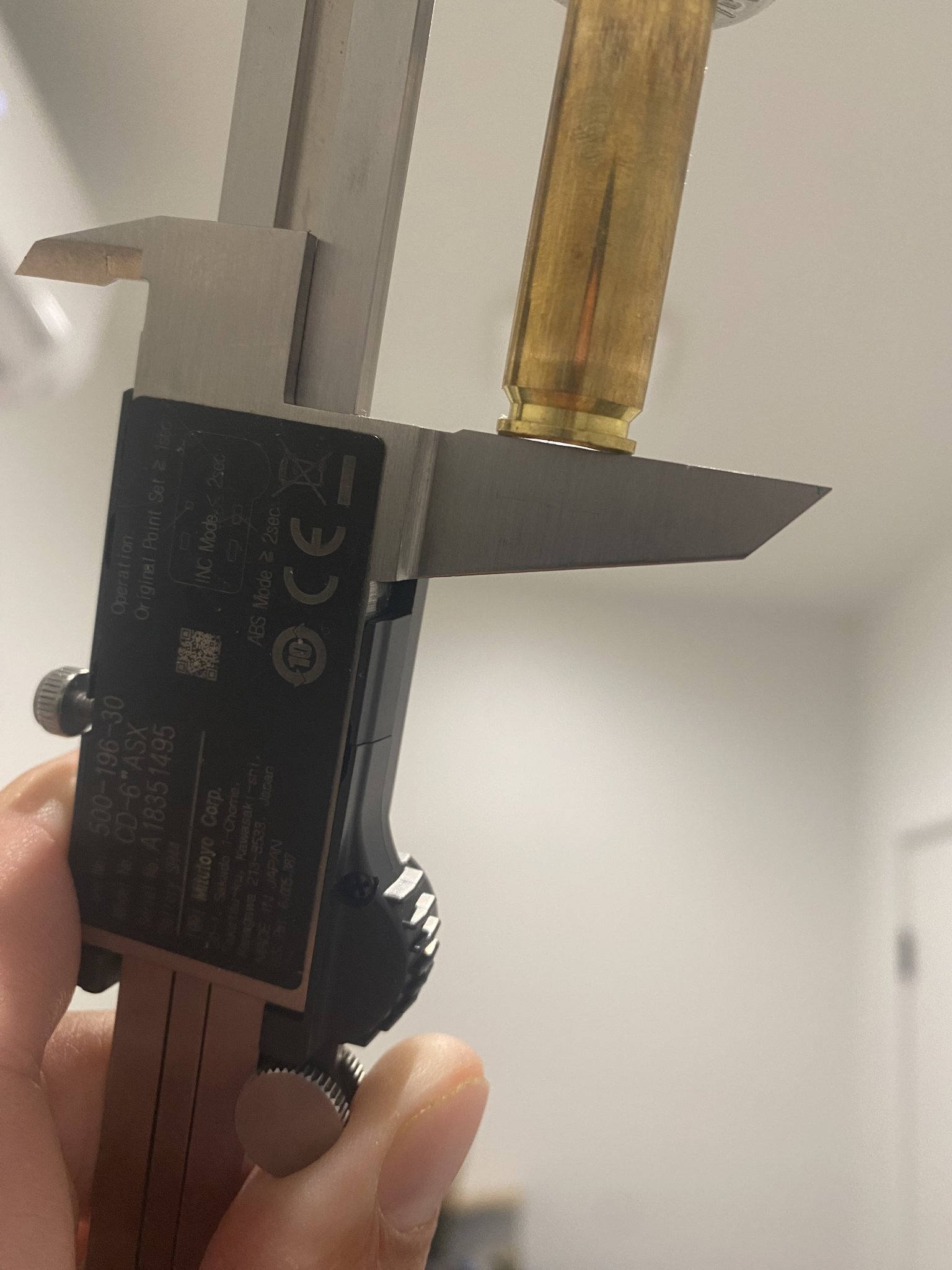

Finally got some time to play with mine, 110 on it now. It’s a Lone Peak (nearest in the red manners CS-2) with a 25.5” 7.37tw med Palma Bart modbb (that was on the tight side) chambered with a custom reamer for 85.5s.
Some of the brass is kinda whack so it’s hard to tell pressure:
But anyways, it’s hitting what I was looking for (3200-3250fps), so all good I guess. Alpha SRP Brass, RL26, 85.5s at about 45k jump (~2.700 COAL). I expect it to speed up a bit more, but I’ll simply drop charge to stay within the 3200-3250 range.
Need to get a NV bridge and rails added to the CS-2 for laser and clip on, since it’ll be the Texas snack deer and critter rifle. Still need to get another scope for it as well, another 420ZCO or maybe a 3.6-18 MK5.

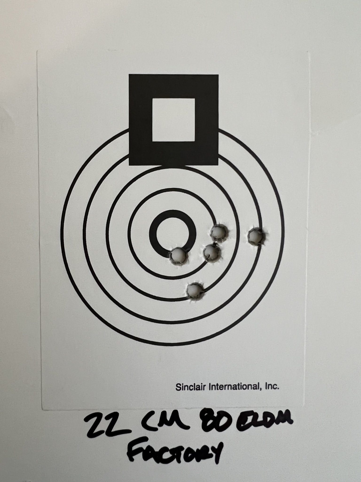

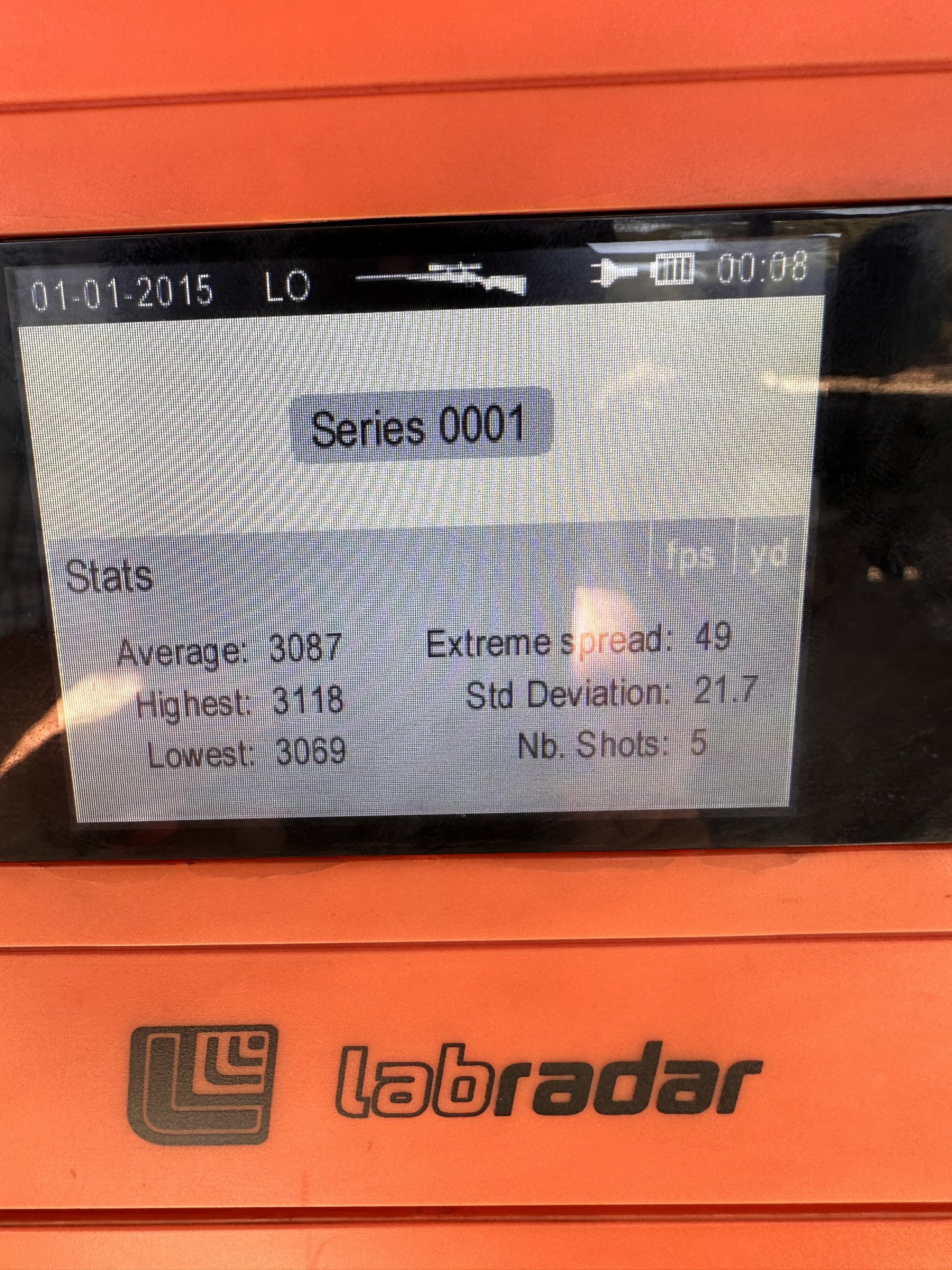

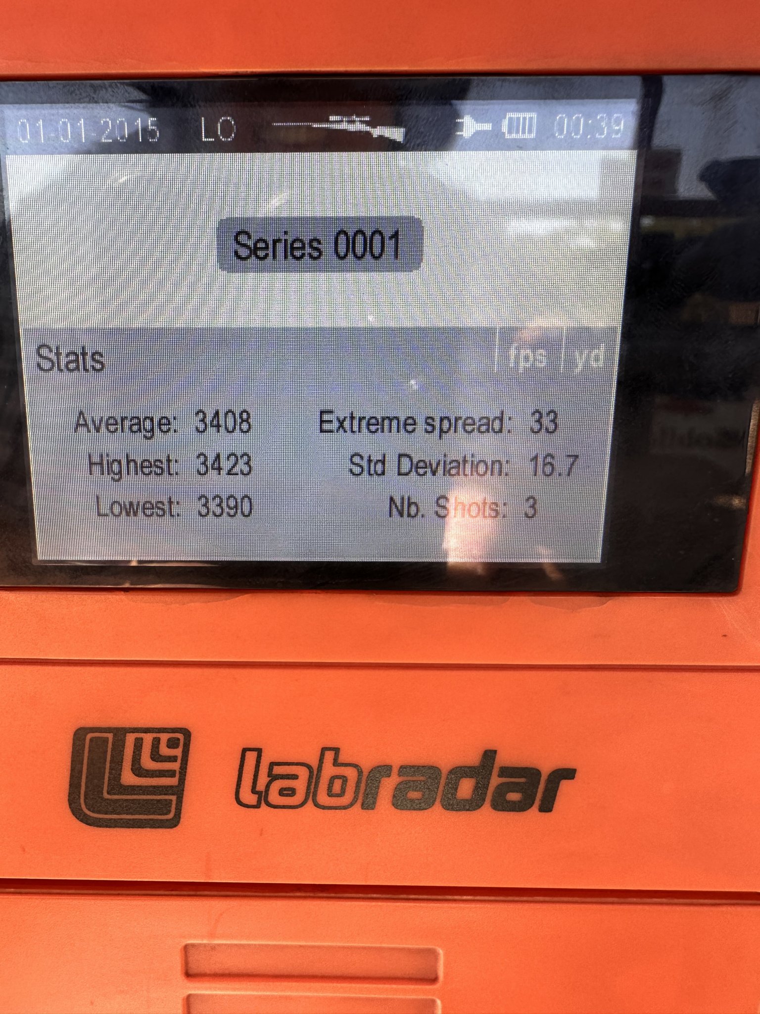

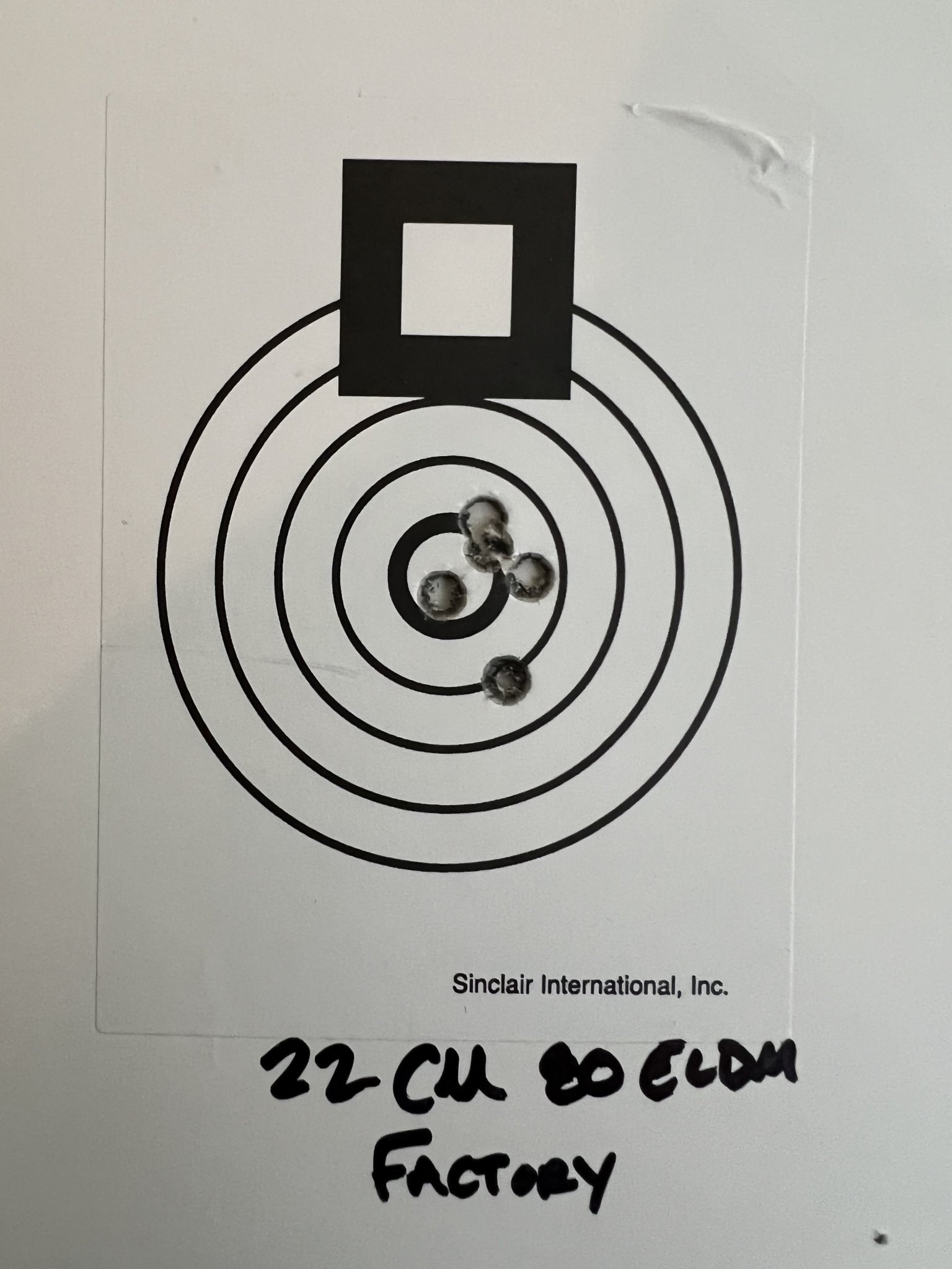

Finally had time to start playing with my 22 Creed a few weeks ago. You guys probably already know, but Texas Ammunition loads the 80 gr ELDM in Peterson brass. I bought 100 rounds when it was on sale during Black Friday and used a box for the first 20 rounds down my barrel. Avg of 3184 FPS from my 22” barrel. My Bartlein seemed to like it, especially once the barrel fouled up a bit. Here’s the progress of four 5 shot groups at 100 yards (first 20 shots ever out of the barrel).
