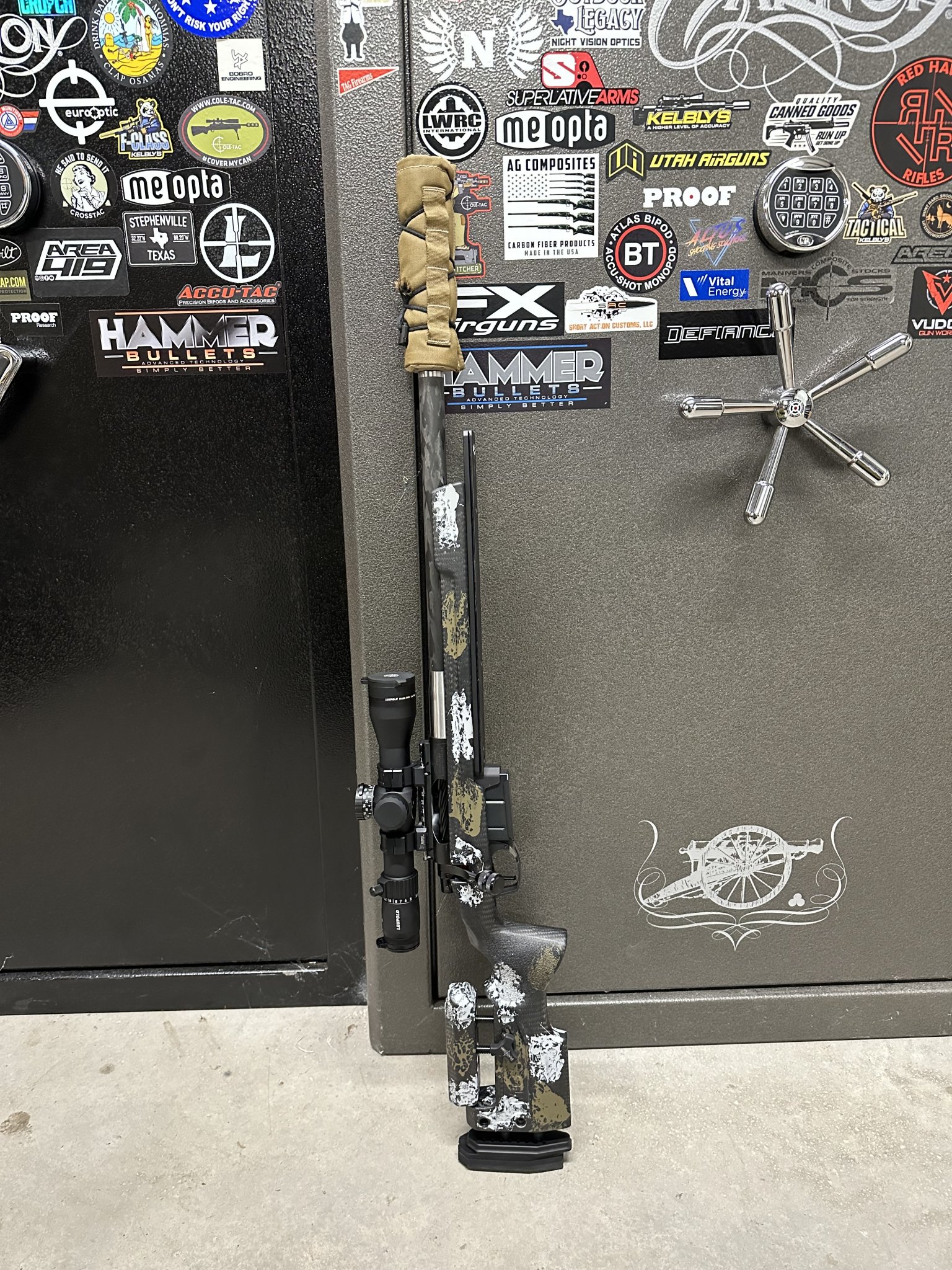

Picked this up from another member here. 20” straight taper proof carbon 8tw 22cm spun up by SPR. Need to go pick up my Magnus SR from TBAC on Thursday. Looks like I can expect some good speeds from this thing paired with 80gr eldm’s. Will make for an excellent coyote rifle!
Any idea on the manufacturer of the cheek pad?
Is one version.

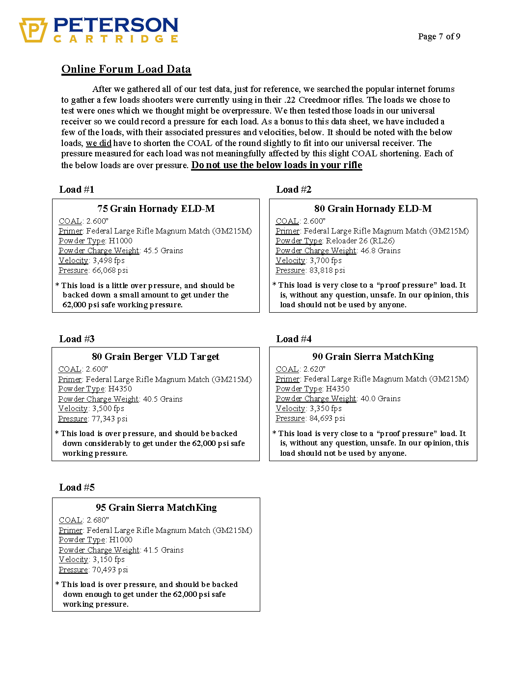

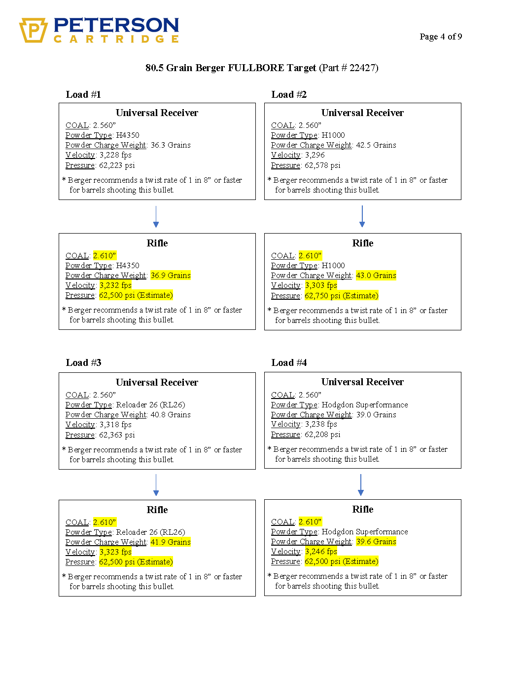

Anyone running the Berger 80.5 FB with 43 grains of H4360 is that to hot ? I’m running a bolt action Krieger barrel 1/8 twist lapua brass I know every Barrel is different but where you guys finding your seeet spot ? I’m just got my gun from gunsmith so just started to do load development.
I reached pressure with 42.5gr of H4350 with a 75.
I always run things through QuickLOAD and GRT… then step down from max in .2gr increments in 10 steps. Usually, I always find a good speed (low ES & SD) and no signs of pressure load.
From there I do seating depth testing the same way, I start at .015 off the lands and then move back in .003 increments. Same story as speed testing, the target will show a wave pattern and thats where I find the seating depth window. From there adjust forward .003 when the accuracy drops off from barrel erosion.
Total transparency, I used to over complicate things and also teetered on the edge of danger. Best advice I can give anyone is read, watch videos and learn. When you practice what you learned, proceed with extreme caution until you build knowledge of your own rifle and with that comes confidence. Measure Measure Measure and always write things down. This can be a very rewarding fun hobby but can also be your worst nightmare if you don’t humble yourself and pay close attention what you’re doing and end result thereof… Happy Shooting Everyone!

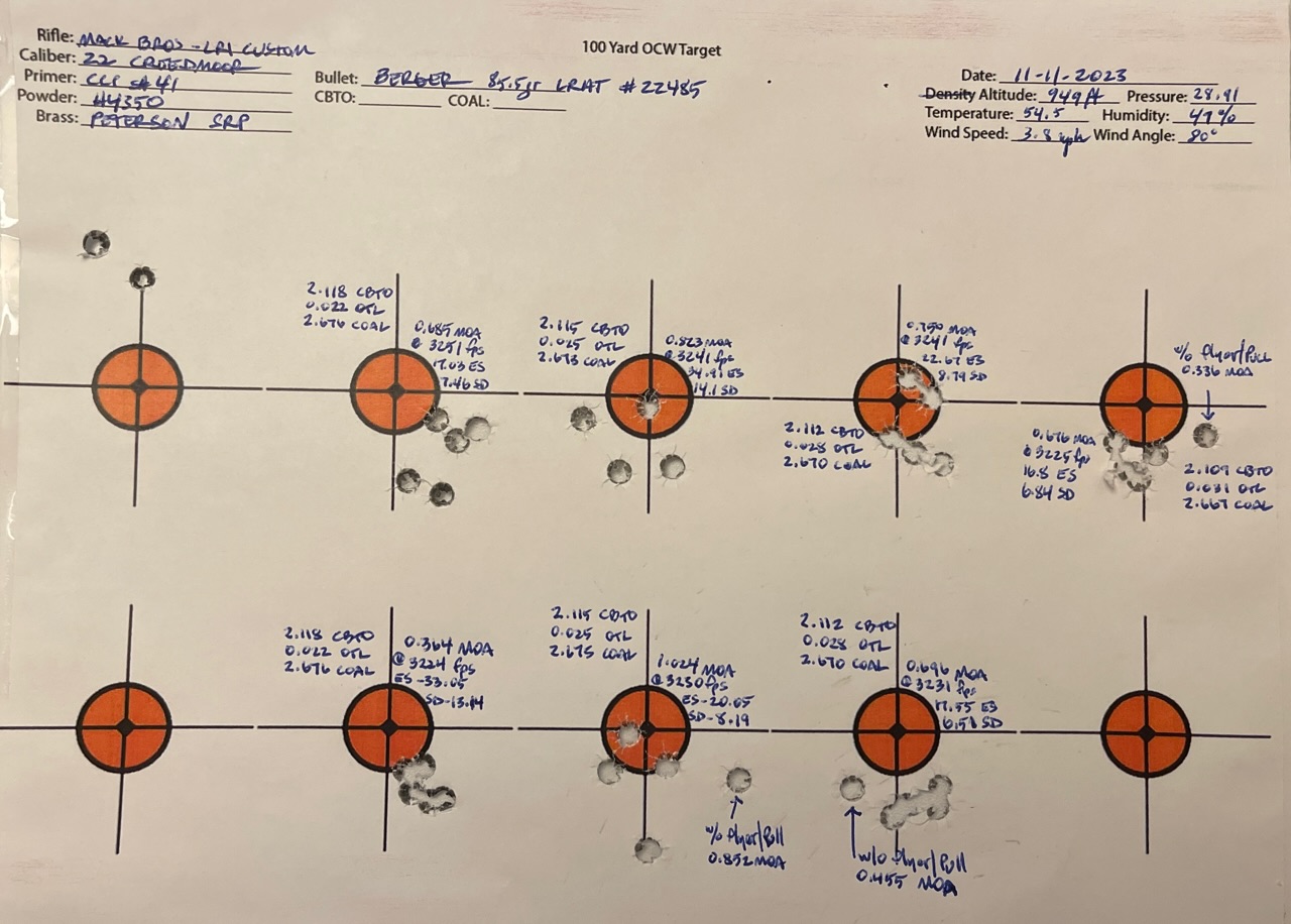

Btw.. Here’s my final seating depth test on the Berger 85.5gr LRHT #22785. These things seem to perform great in my rifle. These were shot off a Harris Bipod with Hawk Hill spike feet and an Armageddon Schmedium rear bag and some patience.. LoL
Rifle Data…
Mack Brothers SS EVO Action
K&P 1:7 RH Twist 6 Groove chambered by LRI
Manners PRS1 T Stock
Timney HIT Trigger
Vortex Razor Gen 2 4.5-27x56 in PMR Rings
My Load is..
40.20grs of H4350 in Peterson SRP Brass with CCI #41 primers seated .009” deep, neck turned to 0.0135”, annealed on an AMP and trimmed to 1.915” on a Henderson Trimmer.
Timney HIT Trigger
My Load is.. 40.20grs of H4350 in Peterson SRP Brass neck turned to 0.0135” and CCI #41 Primers.

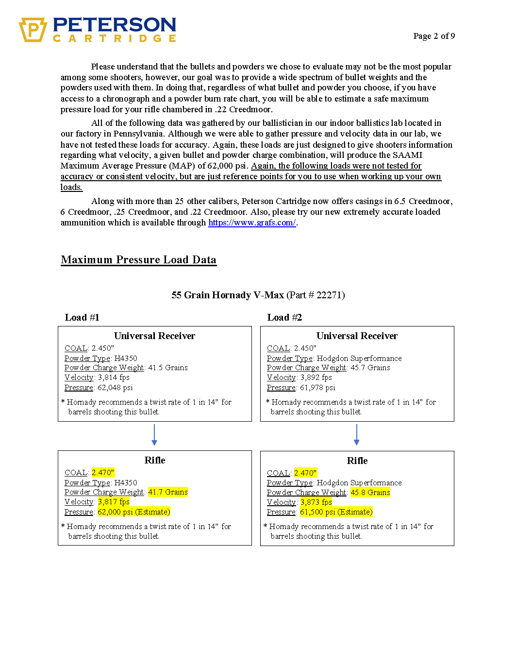

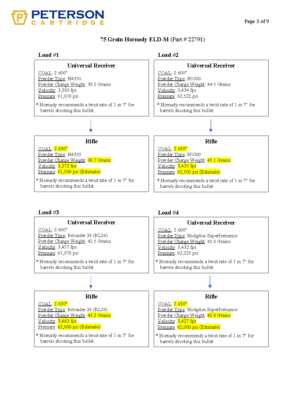

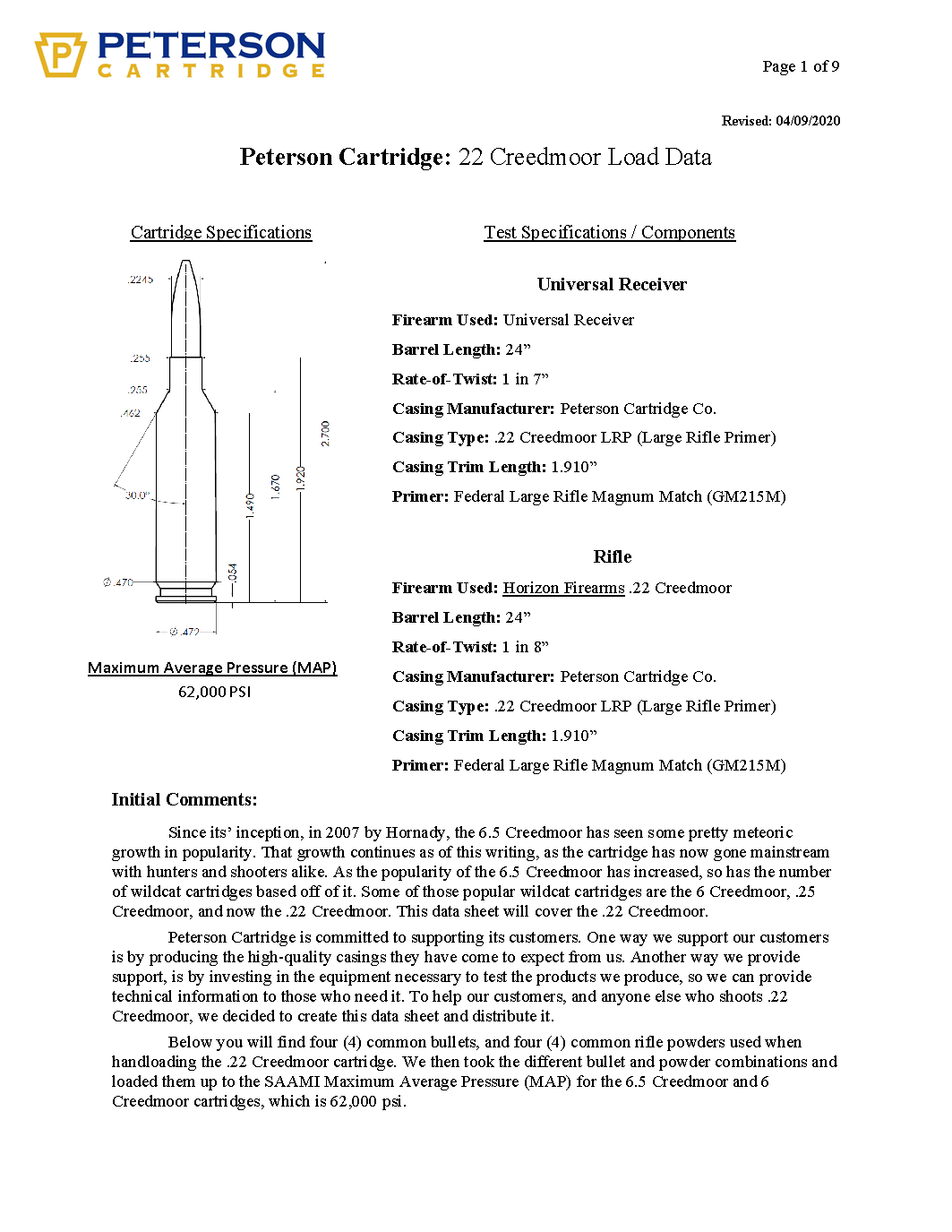

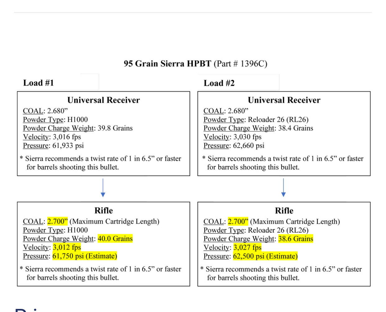

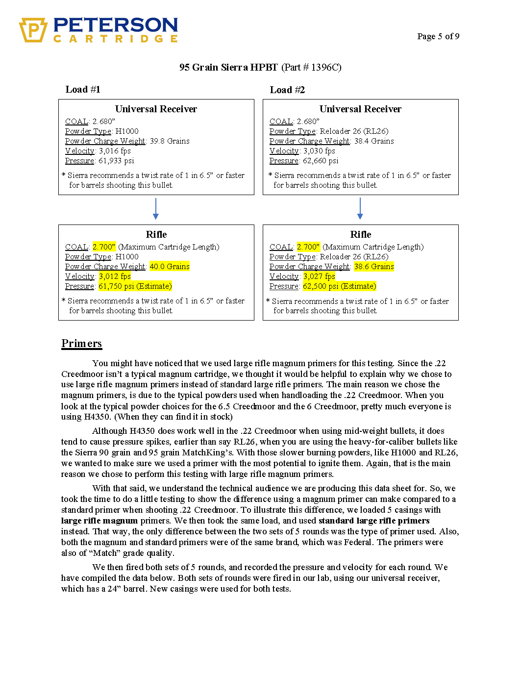

Good advice above! The original load I ran back in 2014 with Reloder 26 was where Peterson got the info to use that particular powder in their tests.
My load was 72,000 PSI so needless to say I backed off even though I had had no issues up to that point…. Well except the burnt out barrel after 900ish rounds😎
Reactions: Flea21
Ouch! Yea, that’s why you don’t take someone else’s load data. There’s a lot more going on than just the data. Every rifle is unique like a fingerprint.
As far as barrel life goes.. jeesh! I’m not gonna think about it, I’m just gonna shoot it till I can’t anymore and then bite the bullet on the cost to rinse and repeat with a new barrel.. LoL
I figure, the same thing as reloading though, make my own barrel life data than read someone else’s even though I know this one has a reputation for burning out quickly. But like anything, it’s all in how you treat it.. My motto is, Use, don’t abuse!
I knew going in it was going to be a “barrel burner” but trying to figure out what powder combo gave optimum results took a little while. After that I didn’t use that barrel to play anymore just kill stuff so I definitely got a lot of fun out of it.

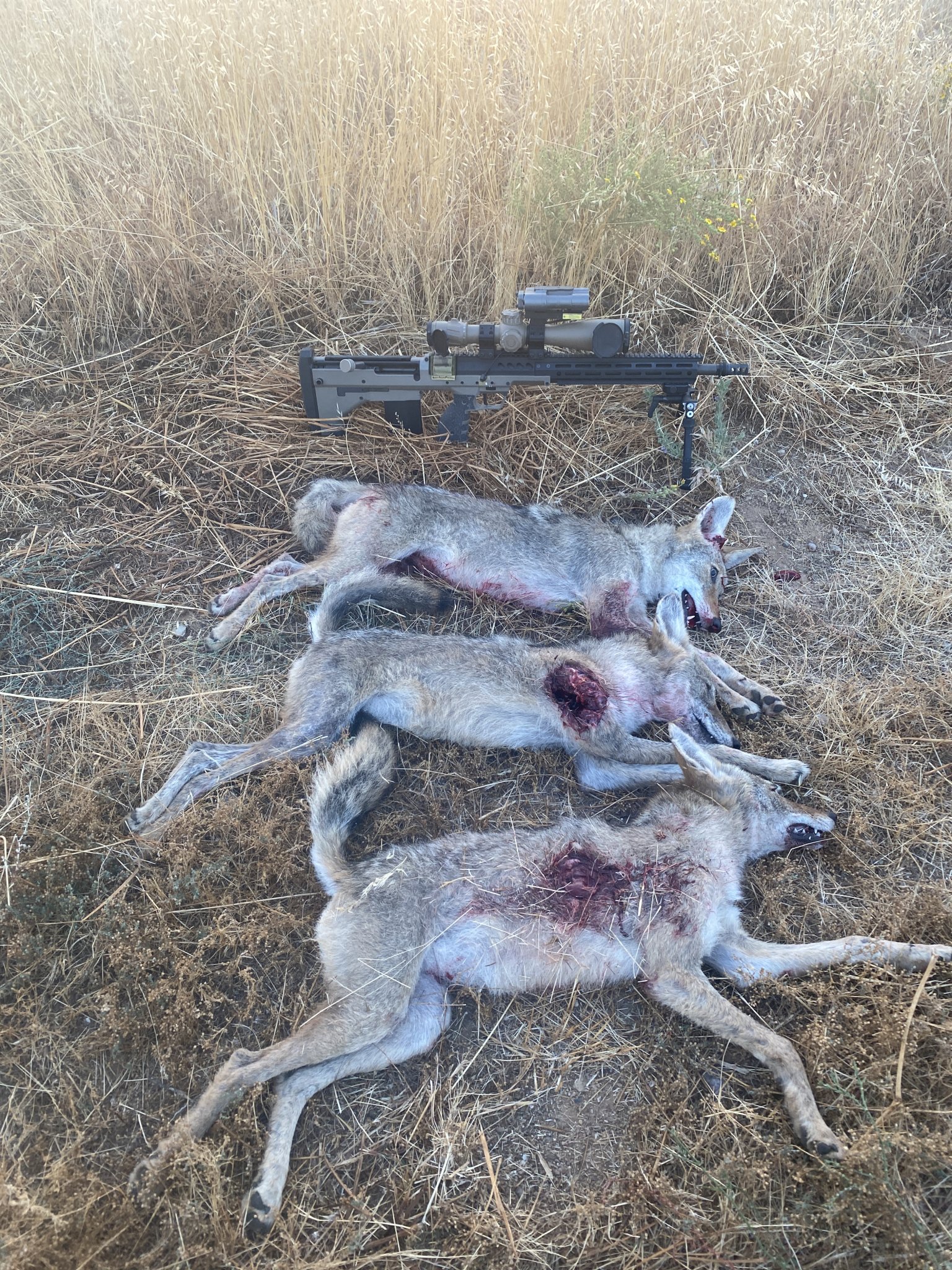

Looks like you killed a lot of coyotes congrats on that are you calling them in ???
Yes most all I have shot are called.
All that seems to be changing as Thermals have come on the scene and now even all the calling contests have started to allow them.
Fact is they shouldn’t even be called calling contests just shooting contests nowadays. I am what most here refer to as a Fudd which is fine.
All the contests will eventually been banned (most western states already have) which is ok too I guess as I would just do it because it’s what I do.
But I digress.😎
