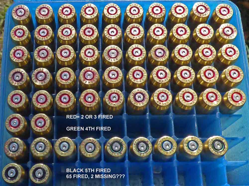

Here's the brass from one 600 yd F-Open match. Lost 2 cases somewhere. Color coded the brass. View attachment 7419430
