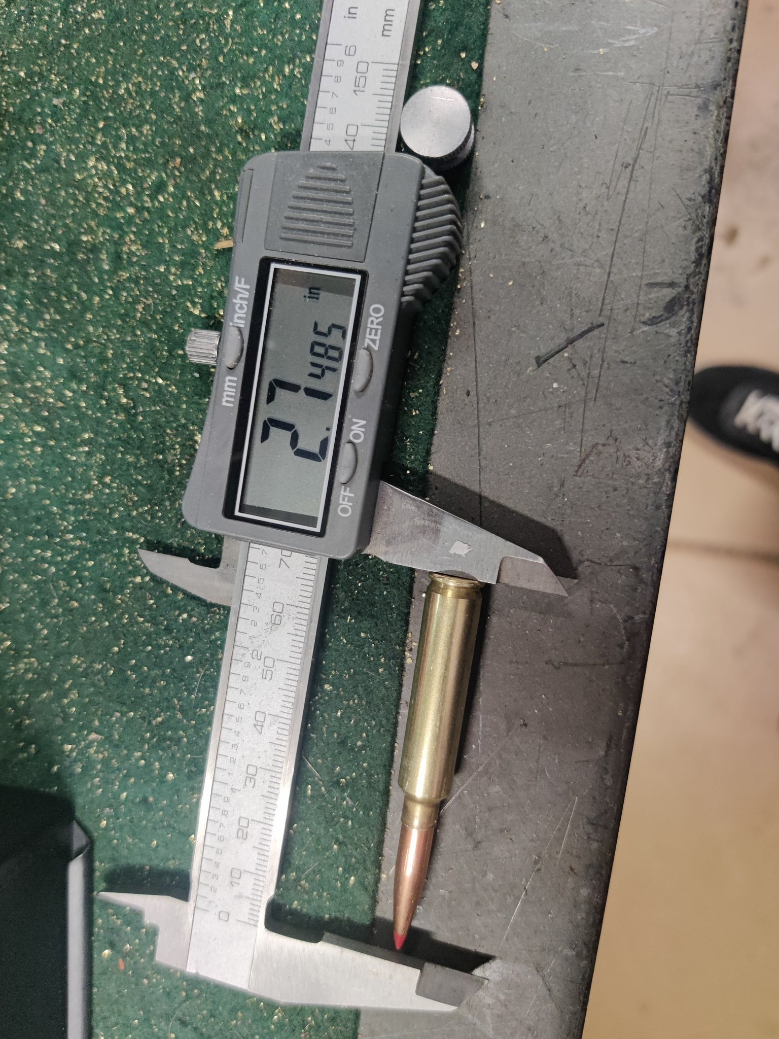

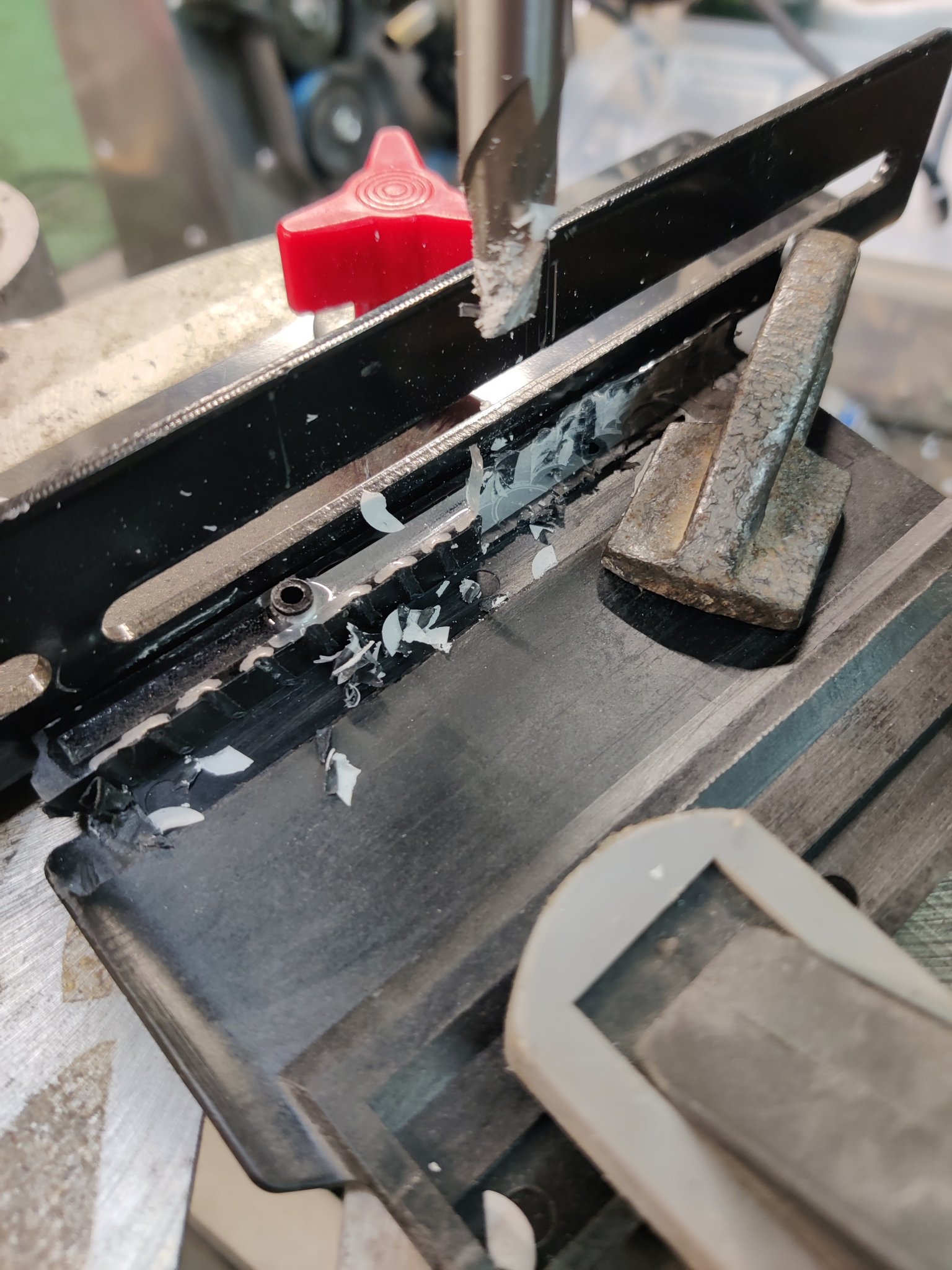

If you don't mind some milling, you can get stupid long with the accurate mag ones.

The rifle came with an Accurate mag. I milled the insert today and just cycled 6 rounds without a hiccup. These are seated at 2.445 which is kissing the lands. I think I'll get another Accurate mag and be done.

If one is hoping to get away from the horribleness that is filing plastic for fine tuning (w the Accurate), you're not. It has a polymer filler inside the metal lips.
