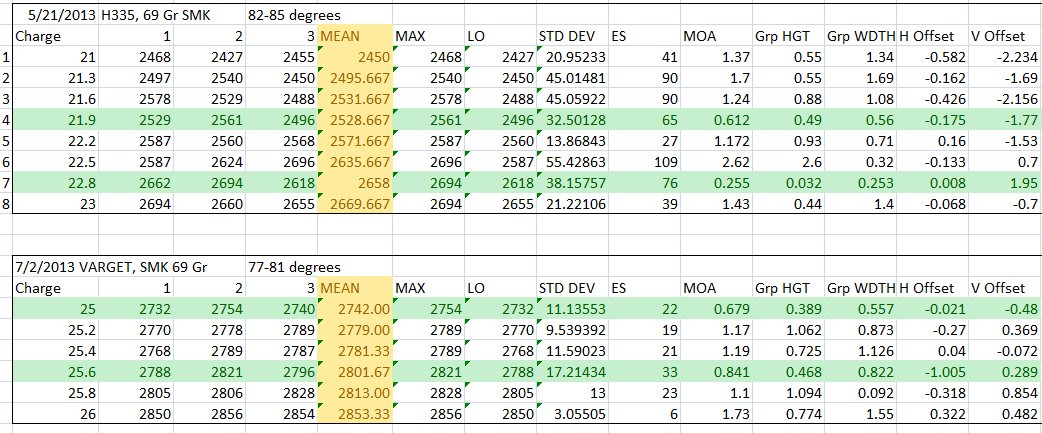

Loads for a BOLT GUN. Caveat: Go carefully and work up.

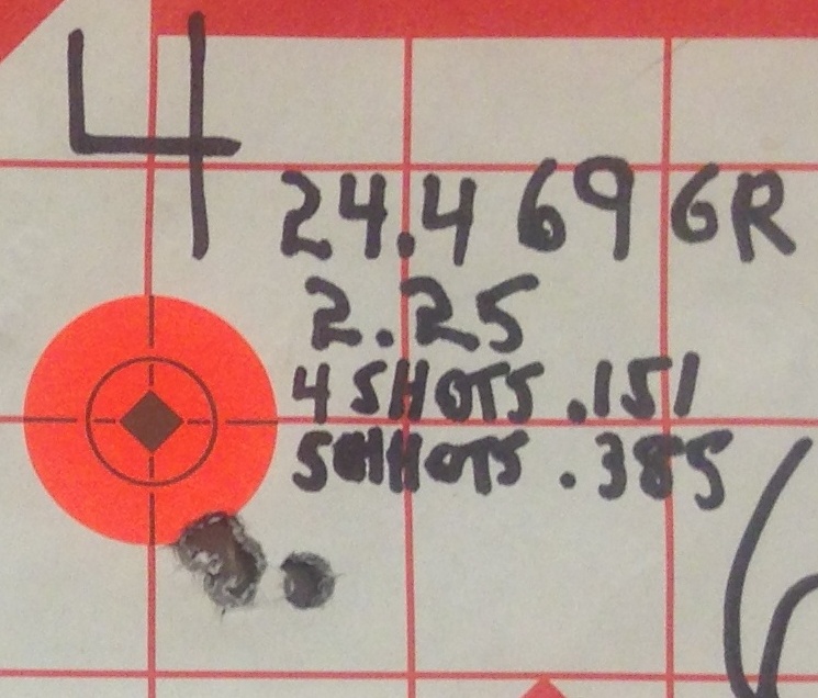

Five shots-go ahead and take a guess which one was the LAST FRIGGIN' SHOT!!!!! ;-)
Win brass, CCI BR primers, H4895, Sierra Matchking 69 grain. Dillon 550 but one shell at a time and powder finished off with weighing and a trickle powder drop.
Savage 12 FLV with a few custom things I added myself. Barrel is stock.
Oh yeah, 100 yards.
