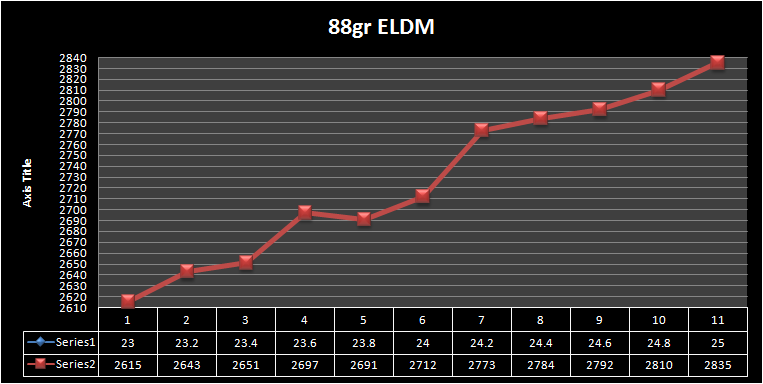

88gr ELDM

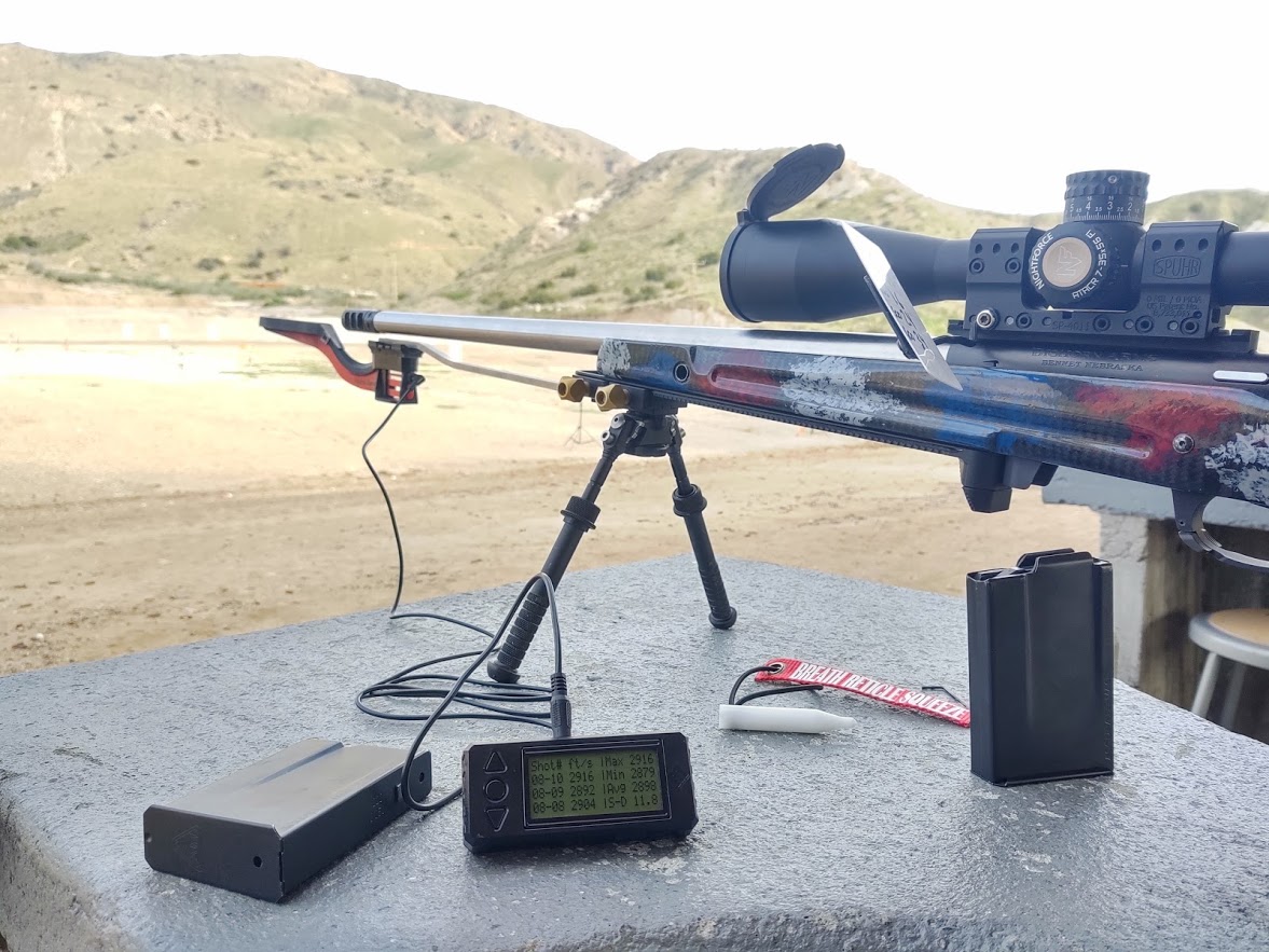

The rifle specs are as follows:
Action: Bighorn TL3
Barrel: Rock Creek 26” chambered by Patriot Valley
Muzzle Brake: PVA Jet Blast
Stock: Manners PRS1 with Mini Chassis
Optic: Nightforce 7-35x ATACR
Bipod: Atlas
Chronograph: Magnetospeed V3 with custom adapter to keep off the barrel
Magazine: Accurate Magazine modified to get 2.55" OAL

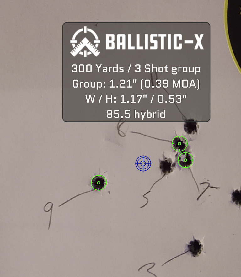

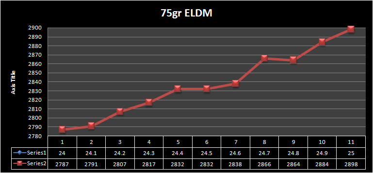

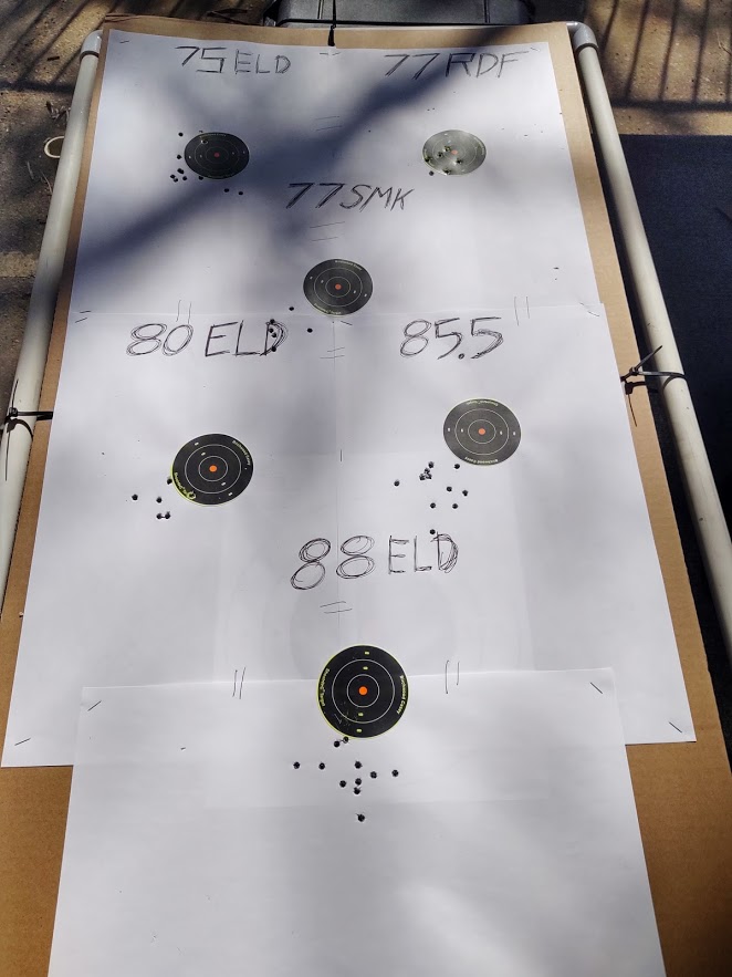

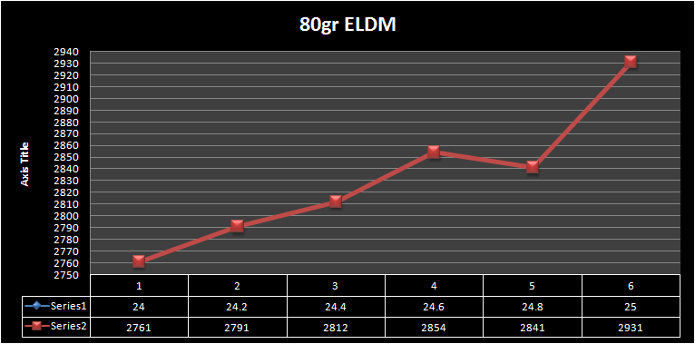

The way I decided to test this was with a poor man’s version of a shot marker. I set up a white paper backdrop with Shoot’N’See targets as aiming points. Directly behind my shooting position was a friend on a Vortex Razor HD 27-60x Spotter with a Phoneskope attached to record the impacts in order to verify their position later. I set up the target at 300 yards. I was looking for vertical dispersion amongst the impacts.
*While I did test the RDF, it was with 8208XBR and was unsuccessful in the long run. Will retest with Varget in the future.
Here are photos of the targets with numbers showing which bullet went where.
75gr ELDM
77gr SMK Tipped
80gr ELDM
85.5gr Hybrid
88gr ELDM

PART II

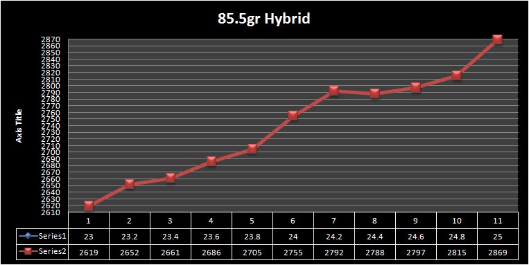

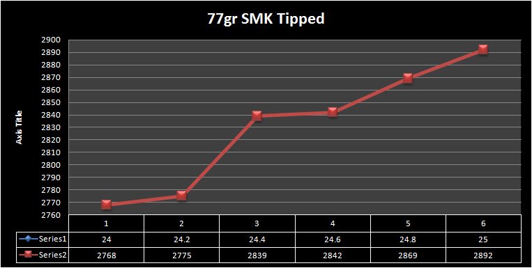

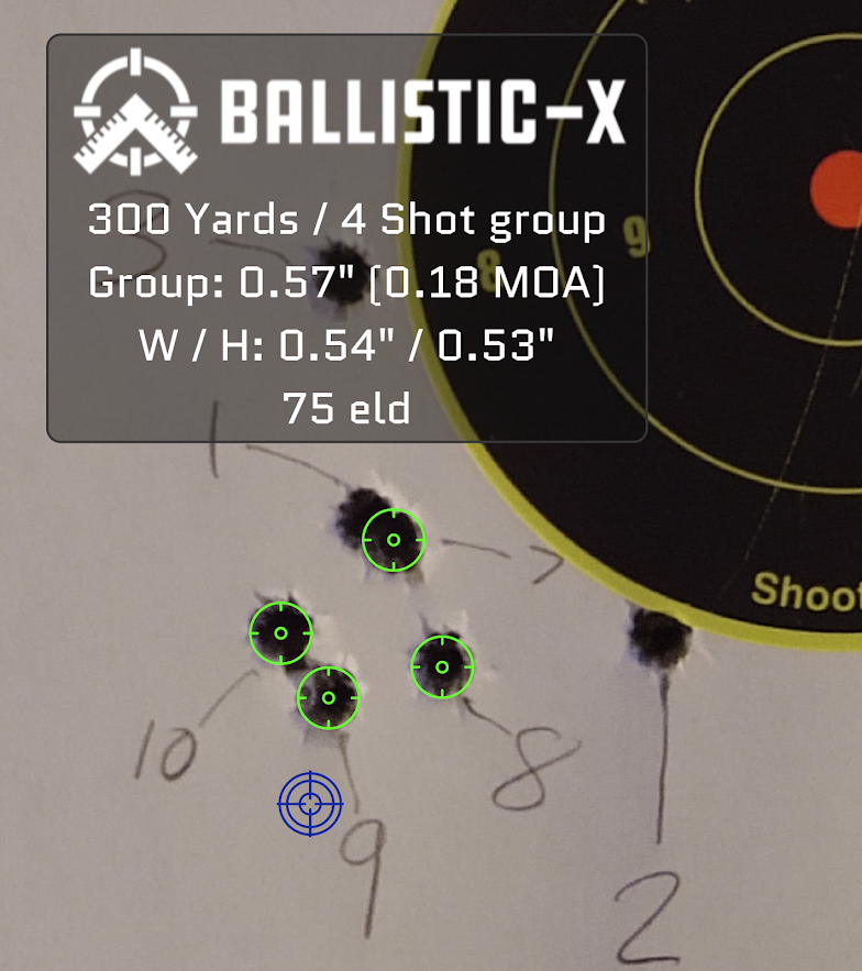

From these targets, I then took groups of the tests that landed closest together.
75gr ELDM
77gr SMK

85.5gr Hybrid

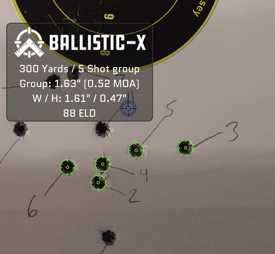

88gr ELDM

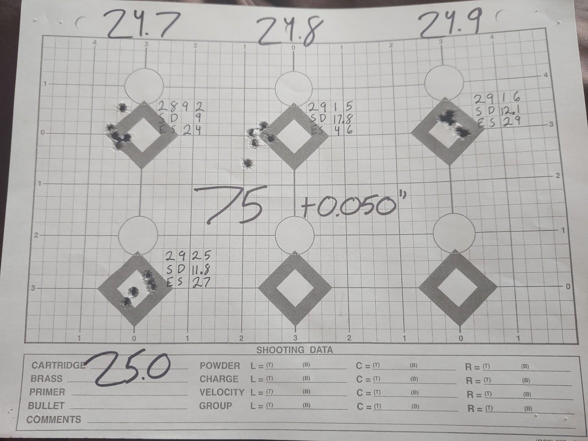

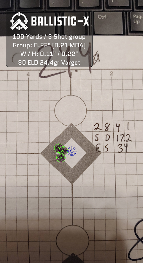

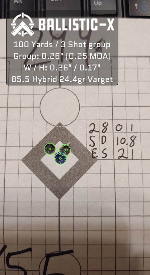

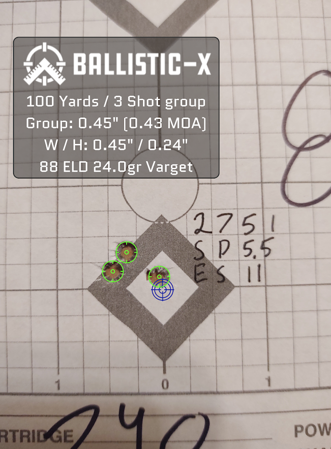

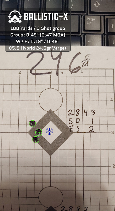

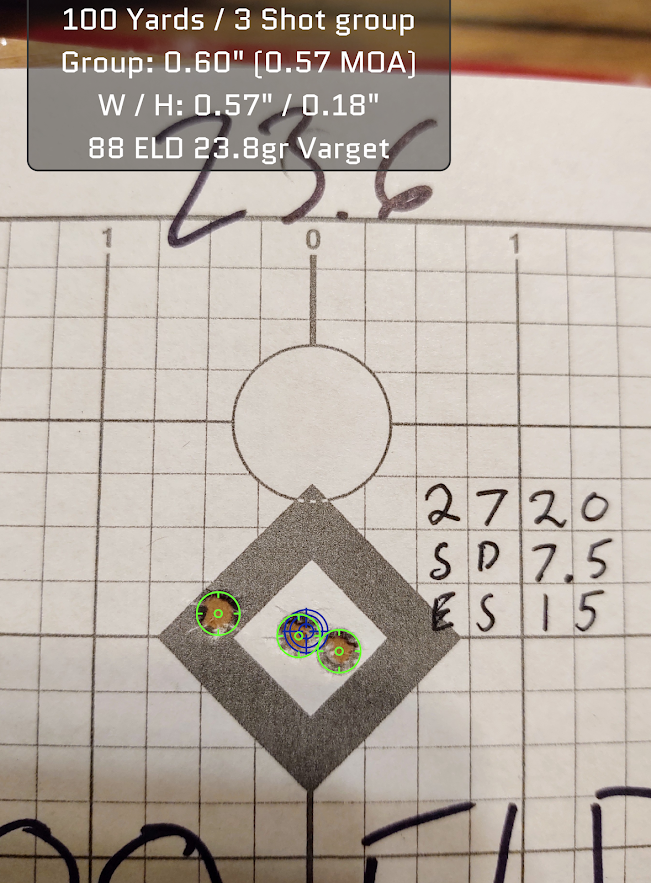

The next phase of these tests is taking 3 shot groups of the loads that landed closest together. I performed 100 yard groups. I know 3 isn’t a lot to get solid data off of but I only had 100 bullets of each and was trying to be as frugal with what I had.
Seating depths were done from researching with the manufacturer, on the hide, and other friends who have shot these different bullets. I picked one seating depth and stuck with it the entire test to stay consistent and reduce variables. These groups could probably get a little tighter with seating depth tests. In the future I may get a chance to do so.

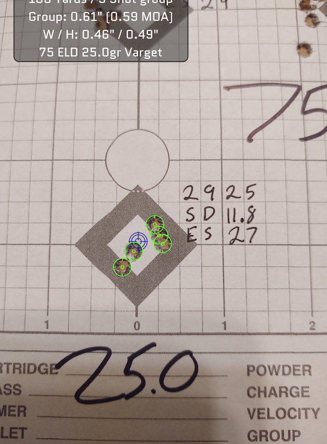

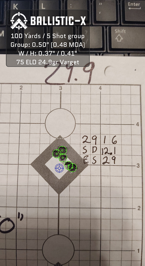

75gr ELD 0.050” jump
*This was the only one I tried 5 shot groups because it is my load for PRS Tactical Division*

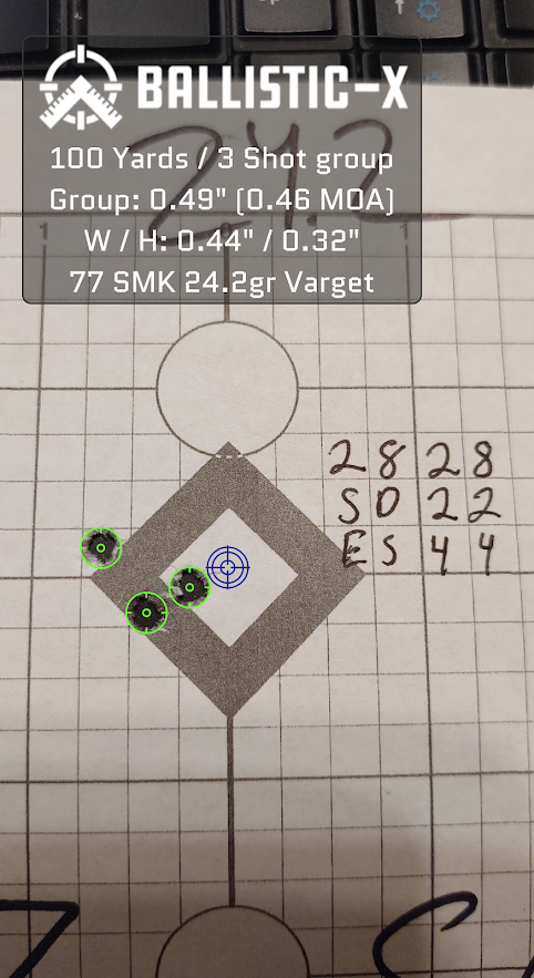

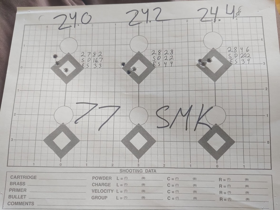

77gr SMK Tipped 0.005” jump

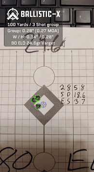

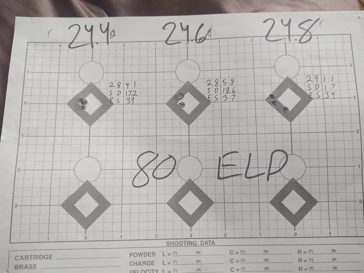

80gr ELDM 0.005” jump

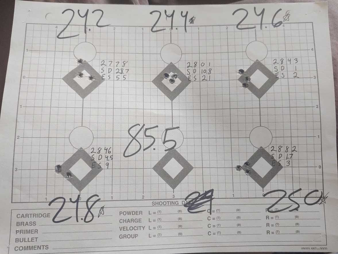

85.5gr Hybrid 0.015” jump

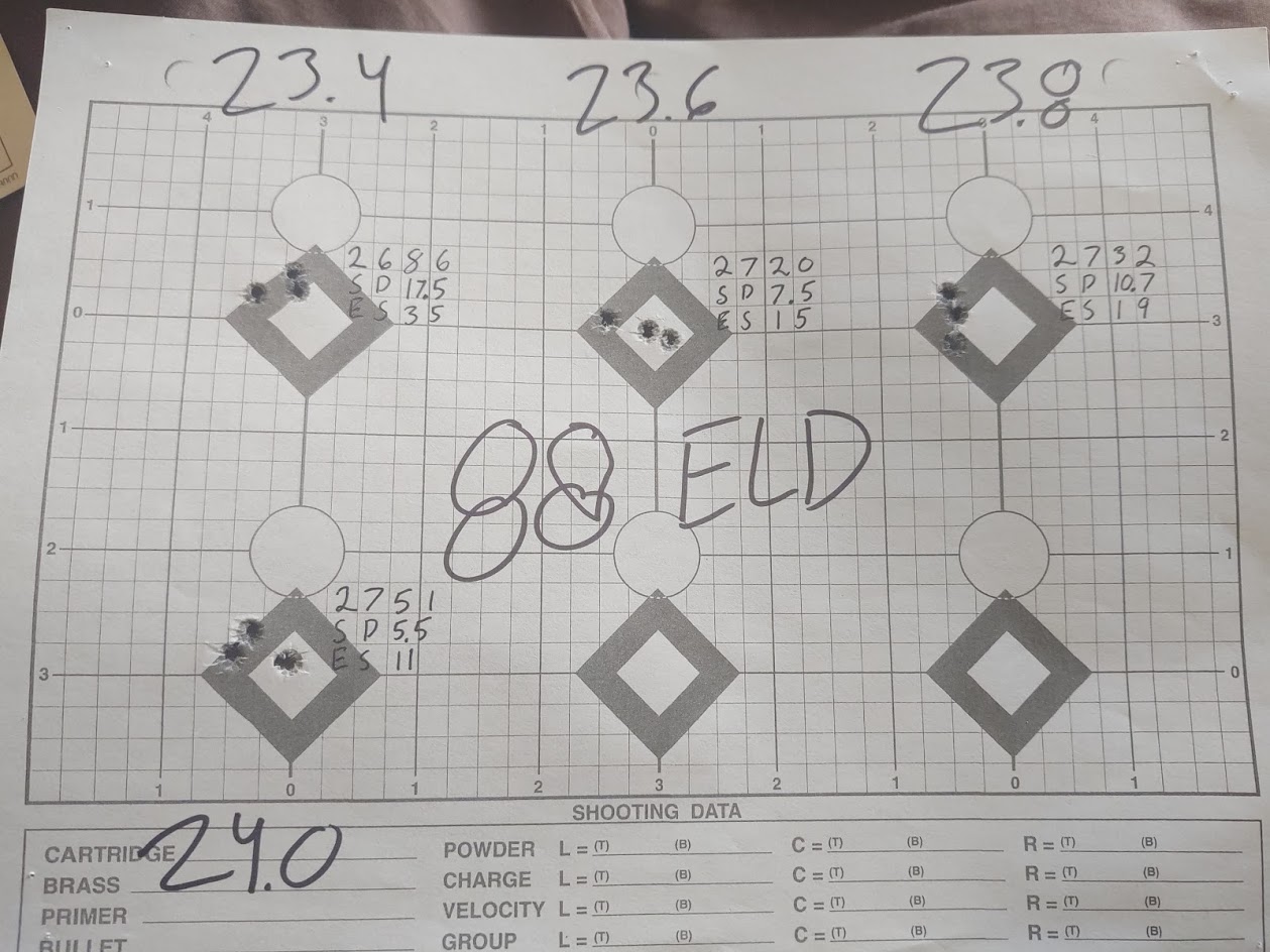

88gr ELD 0.030” jump
