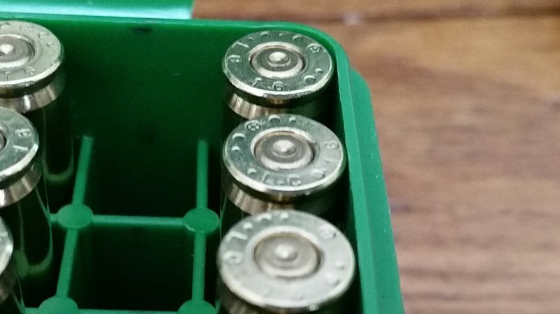

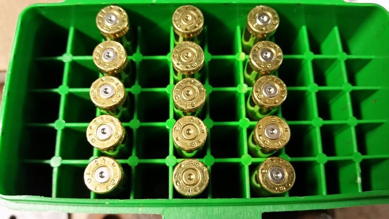

Found the magazine issue on my rifle. The magazine took a pretty good rap to latch. It indexes off the front of the magazine against the barrel nut lock and latches in the back. There was pretty significant sign of hitting the barrel nut lock on the front ('toothed' indents in first picture) so the Dremel and sanding drum went to work and removed about 1/16" off the magazine nose (second picture). Mags now click in with just a bit of pressure. Since they are plastic mags, I figure to leave a little material so they can wear in.
First rounds thru the .223 RPR were Hornady Match 68gr (only Match Off-The-Shelf ammo available to me right now while I wait for the 80gr bullets to come in). Out of 20rds fired, 5 pierced primers and ALL were pretty heavily cratered. Accuracy was OK ... keeping sub-moa. Velocity seemed OK. 2860fps with or without suppressor with a box-printed velocity of 2960fps, probably for a 24" barrel.
Contacted Ruger Customer Service about the pierced primers and they are having me send the rifle back for evaluation. I really don't want to have to replace firing pins here and there from erosion when 25% of the rounds fired send hot gases past the firing pin.
Girl I spoke to was unaware of this issue being reported on other RPR .223 rifles, so if you have seen it ... which it looks like some have ... report it so they can come up with a fix .. .like correct firing pin-to-bolt clearance.

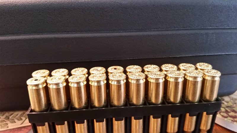

Took mine out to the range today ... finally. I did some OAL measurements a couple days ago and it looks like the throat is 0.015" longer.
Shot 2 different ammo batches today. 25rds for zero's and groups with/without the can (very consistent .4MIL elevation drop when adding my can, no windage). The other batch was 3 groups of 5rds all loaded with 23.6gr 8208 and Nosler 77s loaded to 1.885" BTO (2.265" OAL), which is about .030" from the lands. 3 different primers used, CCI 450, Rem 7 1/2 and CCI BR4. Of the 40rds shot I had just a couple very faintly cratered primers , and nothing close to pierced primers. The fired brass reads a "0" on my Mo's headspace gauge on the fired brass so the headspace is perfect. The Mo's gauge reads "0" on a GO gauge (1.4636"). The BR4s shot a .5" group, the Rem 7 1/2s shot .6 and the 450s were a vertical .4". Can't wait to shoot some 80gr loads and see what this thing does at distance.
I will echo Twinsen's comment about the bolt. Pretty doggone smooth for a new rifle. The only feeding issue I had was if I limp-wristed the feed stroke it would hang up. This rifle/mag combo seems to prefer a nice, steady, firm hand on the bolt.
Fired brass:
