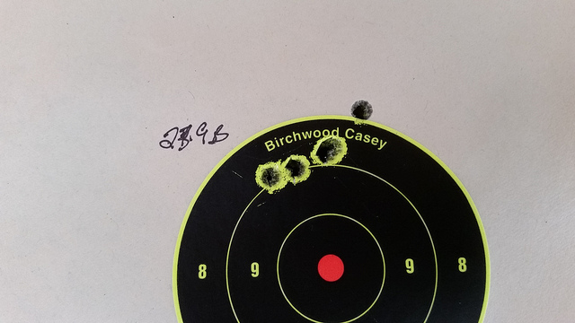

Well 23.9gr of 8209 seemed to be a good mix under the 80gr ELDM. 2797fps/9fps SD in virgin Lapua brass seated .010" from the lands. Here is my 300yd test target:
[IMG2=JSON]{"data-align":"none","data-size":"full","src":"https:\/\/farm5.staticflickr.com\/4475\/37502781340_f6fbe64962_z.jpg"}[/IMG2]
23.7gr also showed promise with a shooter-induced left-side wanderer:

I had good results with that combination up to 2850 FPS with very low SD’s I just backed off cause I was having bad primer cratering due to the shift firing pin fitment. I may try and file it down shorter like someone suggest in this tread earlier
