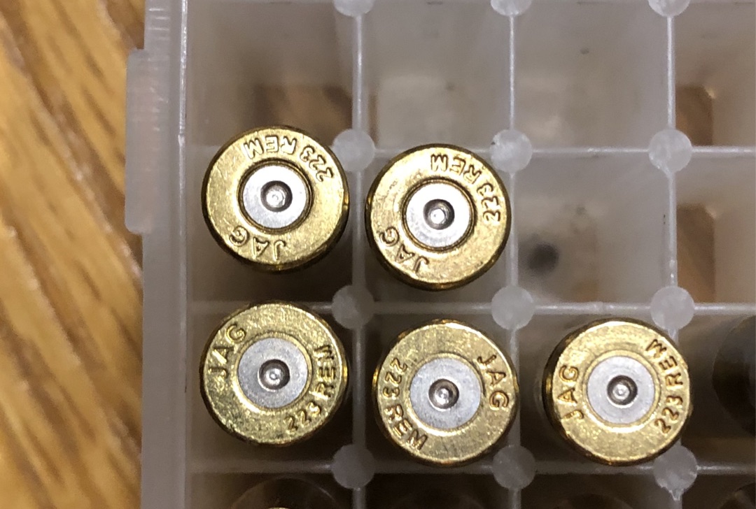

Again, shortening the story, I have found that loads which shoot fine in my Tikka T3X Varmint bolt gun (decent accuracy, no excess pressure signs, acceptable ES/SD) with CCI 450s show excessive primer flattening with CCI 400s with the exact same powder load. Different powders (IMR-4895, H335, CFE223), different bullets (55gr FMJBT, 77gr SMK), all loads worked up from Hornady data. Brass is once-fired new (not remanufactured) brass from Defender Ammunition, a veteran-owned&operated business I like to support.
I understand that the standard primer has a thinner cup than the magnum, which explains the difference in pressure tolerance (velocities are maybe 10-20fps higher with the magnums - no surprise).
So, my question is simple: Am I correct in thinking that the badly flattened standard primers are a harmless byproduct of the thin cup, or are there potentially harmful effects of which I'm not aware? I have not had any pierced primers, and cratering is minimal to nonexistent with the 400s. Pierced primer would be an instant show stopper.
Here's an example: 55gr FMJBT, 25.0 grains H335, once-fired Defender brass. Top two are CCI 450, bottom three are CCI 400.
They are currently a harmless byproduct but like anything, if they stretch too thin they could fail. With all the variables Im not sure anyone could tell you how close you are to that point.
This is why you should be paying attention to all the pressure signs and not just the primer appearance.

They aren’t ideal for the high pressure but I still shoot 400s in my 223s almost exclusively. I leave the 450s to the dasher.
I’ve found I start to get heavy bolt lift about the same time I get the 400s flattening too much. Pushing them with a 450 would only allow me to push them further toward over pressure.

Are you certain that 400's have a different cup thickness than 450's? I have heard that for years, as I did that 41's were thicker than 450's. I asked CCI directly about the 41 vs. 450. They said they are exactly the same primer only the 41's have a different angle in the anvil to reduce slam fires.
I wish I would have asked about the 400 v 450, not that I still could not, but I ran across an article by Allan Jones (worked at CCI) where he says the difference (post 1989) between a standard an magnum CCI primer was the magnum had a more aggressive mix. He did not mention anything about the cup.
If you are going to use Magnum primers you want to download the powder.... Flattened primers are not a harmless byproduct. In my rifles, everytime I have flattened primers there has been a difference in recoil, I can feel the gun getting "hammered". Most of my 308 loads are reduced almost 2 grains when I use Magnum primers.... and I use a lot of them. And remember if your load data doesn't include Magnum primers you are coloring outside the lines.....
