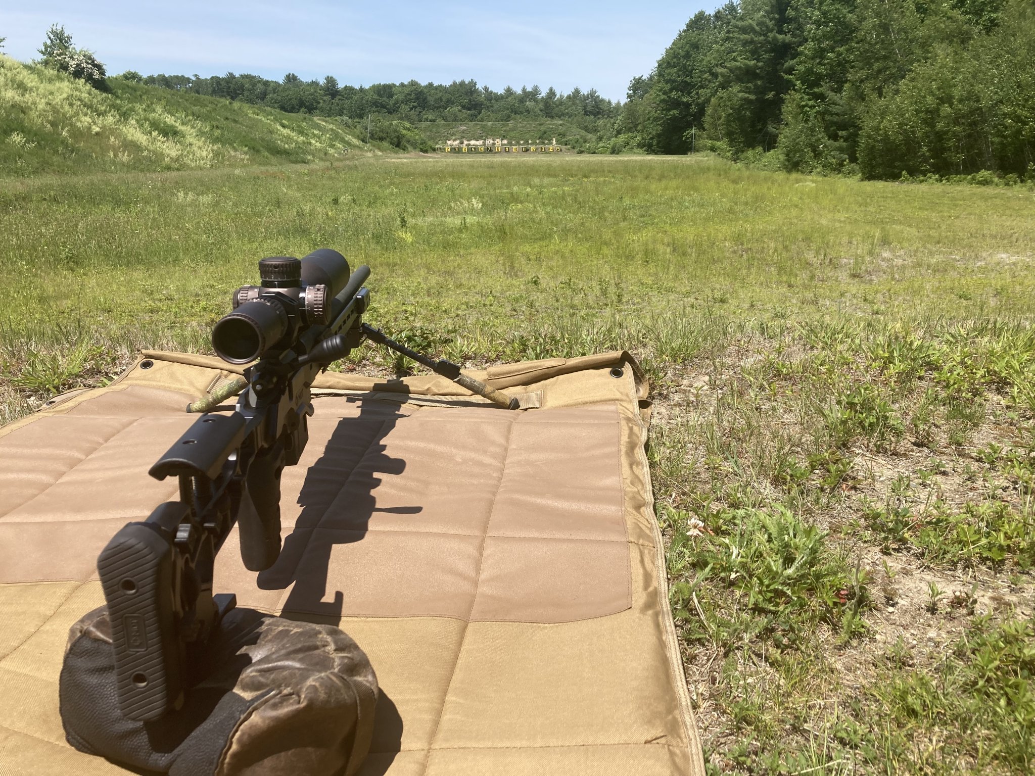

    Ok, so an update on the testing for those of you not following along on Instagram (@vudoo_labs). I'm headed down to Alabama to Boone Ballistics on June 22nd to start testing on the 23rd. I'm taking three rifles, one 16 twist and two nine twist. My buddies from Lothar Walther are bringing a couple 12 twist and possibly a couple nine twist. We'll be shooting Lapua almost exclusively with the exception of one of the tests where we need super sonic ammo. Eley falls apart after 50 yards and my Vudoo's won't close on most Eley ammo, which is just fine with me.
    The ballistics range is a twin Oehler 89 System, so no lack of capability to gather sound data and the protocol has been drafted and approved. Should be a good time and most certainly a great opportunity for the rimfire community.

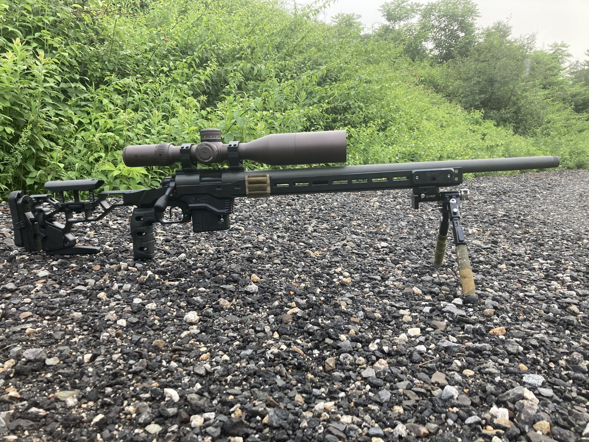

    Would you mind sharing your experience with this fast twister?
    My experience so far is I picked up the barreled action from the ffl today, put it together, and shot 150 rounds from 50 to 75 yards. So far it’s shoots just as good as my 16 twist Vudoo at those distances. I’ll report back once I actually have useful experience.

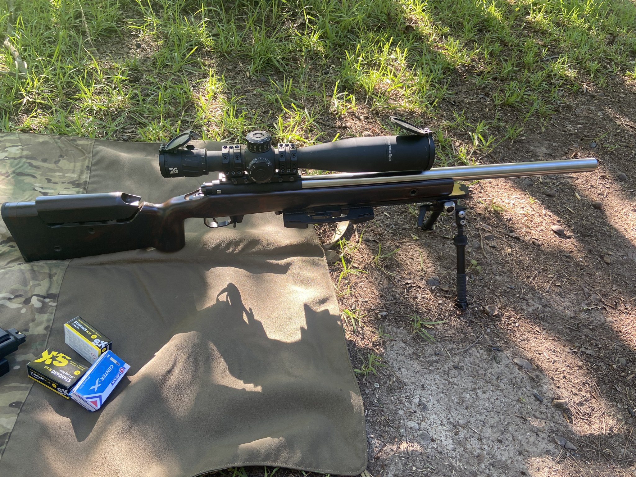

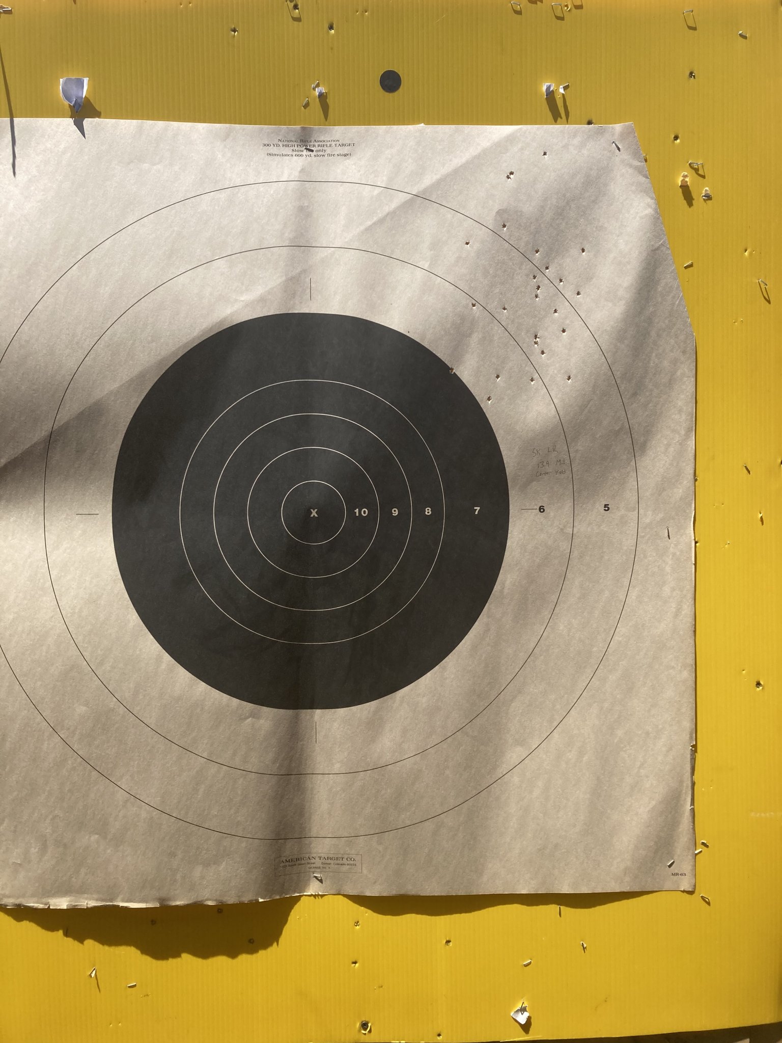

    Here is my first 300y group with the fast twist.
    Keep in mind I got this rifle Wednesday, and have not tuned or really tested much yet.
    Dialed 13.9 mil, impacted .9 high. 13.0 Total elevation vs 14.5 with the cz on a previous day. So there may be something to the BC thing. I’d have to shoot side by side in the same conditions to see for sure.
    25 shot group measures 10” high 6.5” wide. Held center and ignored wind and elevation.

    I’m pasting here what I posted on Instagram (@vudoo_labs) about our testing of the fast twist barrels. This is preliminary info, will post data sheets when I get home.
    Ok, more on todays fast twist testing, but I have to first shout out a HUGE thank you to Buford and Miss Cindy at @booneballistics. The facility is incredible, the capabilities and knowledge base is impressive, and it’s all closely rivaled by the hospitality and Miss Cindy’s sandwich making spread.
    All total, we shot 12 tests today and three of the platforms were V-22 based rifles. One 16 twist Vudoo/Ace barrel measuring 20” in length and two nine twist barrels; one being a @bartleinbarrelsinc and the other a Vudoo/Ace. Both nine twist barrels are finished at 22”. The other barrels were from my buddies at @lotharwalther_usa and included nine, 10, 12 and 16 twist. I won’t speak to the Lothar results, as that is for them to do, but I can easily say that we had an incredible day validating the merits of spinning the @lapua_ammunition 40 grain lead bullet much faster than the standard one turn in 16 inches. All tests were shot at 100 yards.
    For the @vudoogunworks rifles, we set a baseline with the new Three60 three lug and the Vudoo/Ace 16 twist. All recorded ballistic coefficient data is based on the G7 drag function, but the Oehler system makes it easy to select and display other drag functions. All ammunition was Center X and we averaged 1084 fps from the Vudoo/Ace 16 twist with a G7 of .0721.
    Where it became really exciting was shooting the two Vudoo nine twist rifles across the Oehler and recording the results while simultaneously watching five shot groups through the spotting scope. The Vudoo/Ace nine twist barrel showed an average velocity of 1094 fps with average BC of .0742. The Bartlein nine twist showed an average velocity of 1093 fps with average BC of .0740. Pretty incredible, especially while watching the repeatability in the wind at 100 yards.
    I’ll post up actual data sheets soon but I know there are many waiting to hear how the testing went, so the info I’m sharing now is directly off the summary sheets generated by the Oehler system. All-in-all, the testing was a complete success and without a single doubt, validates the Lab findings that started four years ago. @foundation_stocks @zerocompromiseoptic @mannersstocks @bulletpro150 @drengr.srl @timneytriggersusa @btindllc @area419official #defti #wordsmatter #toldyaso
    More to follow….
