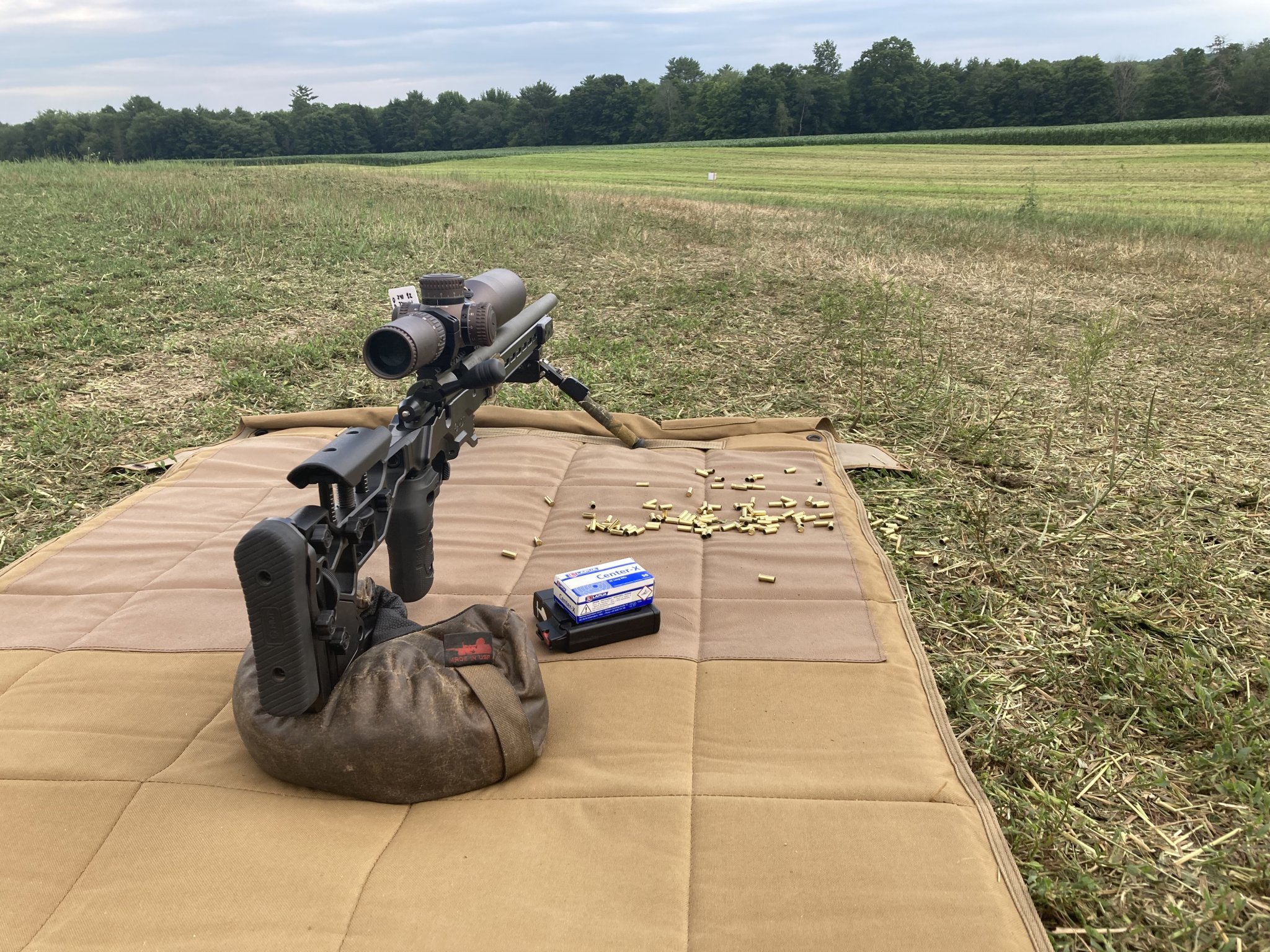

Today, I was able to shoot with no wind at 146 and 208 yards.
Unfortunately, I was a little disappointed. Not necessarily with accuracy, but with the drop. Accuracy at least matched/maybe surpassed my Vudoo (1x16 twist and 20”), but required about .7 more elevation at 146 and 1.3 more at 208 yards. Upon trueing my velocity, it showed 1009 fps.

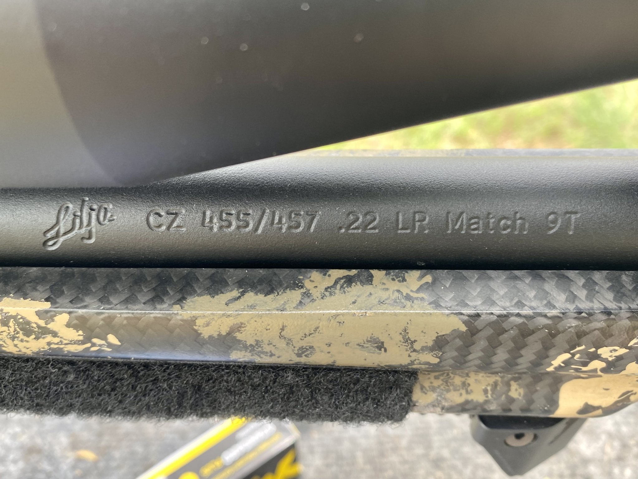

Got my 457 Lilja fast twist barrel(s). Mounted one up in a brand new 457 action, MDT ACC Chassis, 20MOA rail and 20MIL Eratac mount. Using my CF rifle’s Vortex Razor HDII Had to jerry rig measuring the action depth, but I set it to 043, or how ever that voodo math works out ;)
22 inch barrel looks funny in the chassis. Amazing how long it takes me to put a rifle together. Looking forward to some fun this weekend, as long as the weather doesn’t blow.

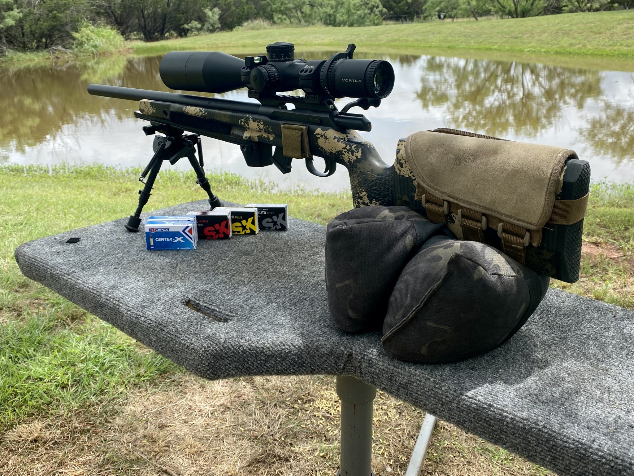

Speaking of velocity, I had favorable conditions and took the fast twist out to 250 yards. Accuracy was again very impressive. Ended up trueing again based on further distance and came up with 1030fps (Lapua CX. So that’s a little faster than initial testing.
Another interesting note, I came across a couple boxes of SK Auto and thought I would try some at 250 while there. To my amazement, it was well over the plate. I ended up dialing down from 10.4 MILS to 9.1, which was my normal 1x16 dope. Accuracy was very close to the LCX. To confirm the SK Auto, I dialed down to 50, moved forward and it was still on. Two factors are at play, I think. Sk Auto advertises at 1132fps, so that puts the tight bore reduced velocity very near my normal 1x16 velocity of 1085 or the dimensions of this bullet
different minimizing friction as compared to LCX.
Accuracy is still fantastic, but I’m not yet 100% convinced it is better. Meaning: bucks wind better, better accuracy than a 1x16 from 50-350 yards. Time will tell though.

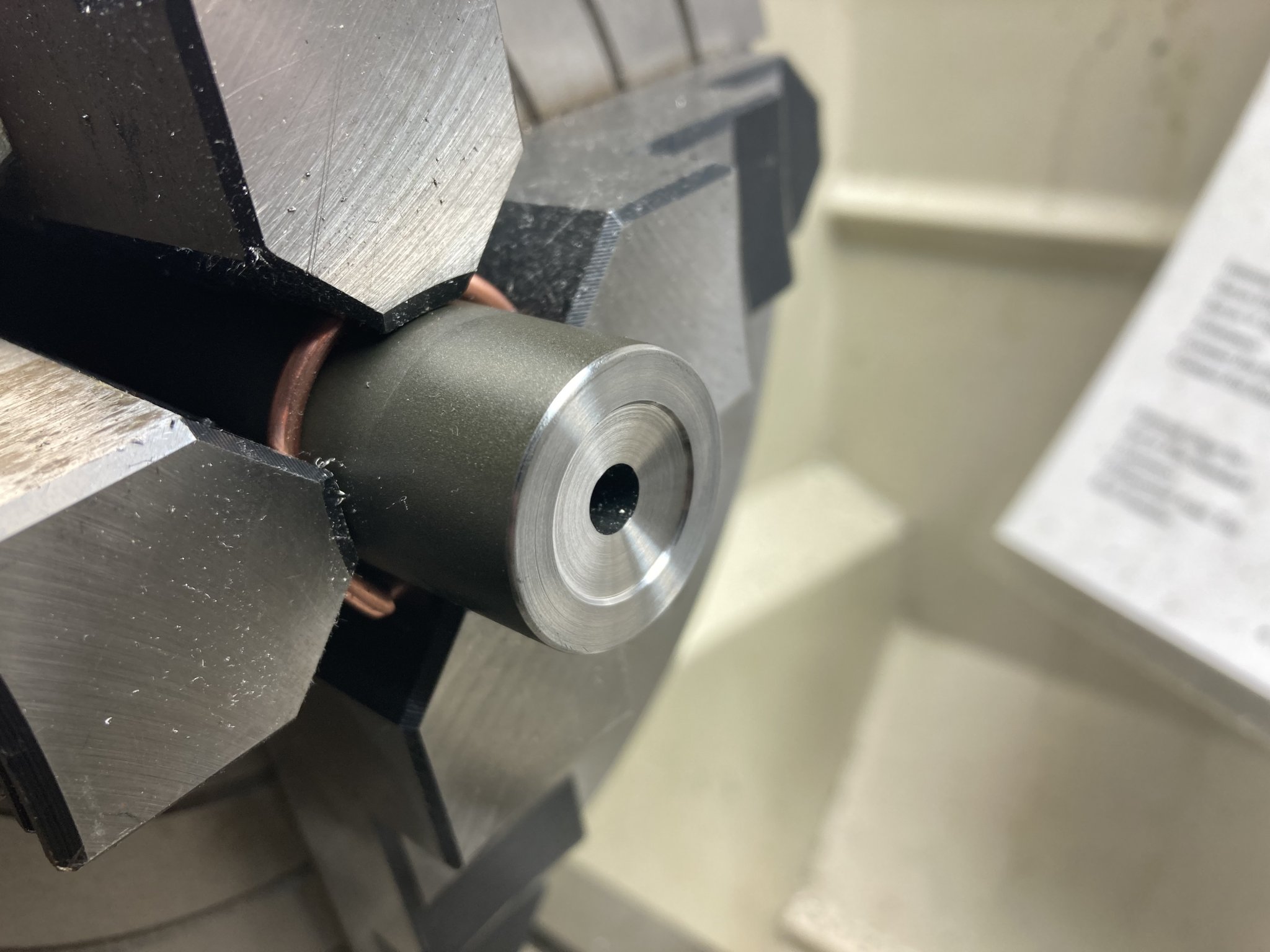

One of the things that was found yesterday was a loose section in the barrel right at the muzzle.
I took it to the lathe and removed the 1/2-28 threads and about .100 beyond the shoulder.
Should be able to test on Friday and see if it shrinks the groups at all.
It would be best if you send it in, but we're not ready to start doing more nine twist builds just yet. The barrel has to be made very specifically and there's a lot more to educate end users on as it relates to what to expect in performance and why. We'll communicate accordingly as we stand up vendors to make barrels to my specs so the variables are under control.

Was the opinion that the thread or operation of threading the cause of the loose section right at the muzzle ?

Yes I work in manufacturing and it’s pretty normal to have material relieve itself after stock removal. We usually turn tight dimensions in stages alternating cutting the OD, then ID to let the stresses release before the finish bore and turn. Even if it is stress relieved material.
The less material you disturb the more stable it will be, so larger threads, say 5/8-24 or 3/4-24 would result in less movement on bore diameter. Target crown would move the least.
Makes sense to me, which would mean that the only way for a thread at the muzzle end to have less influence would be too do the thread before final boring & finishing.
My lathe might be getting a bit use soon.
It would have to be roughed to say thread Major Dia + .020 from the barrel manufacturer. Which would be impractical for them to do.
Reactions: Drew M
