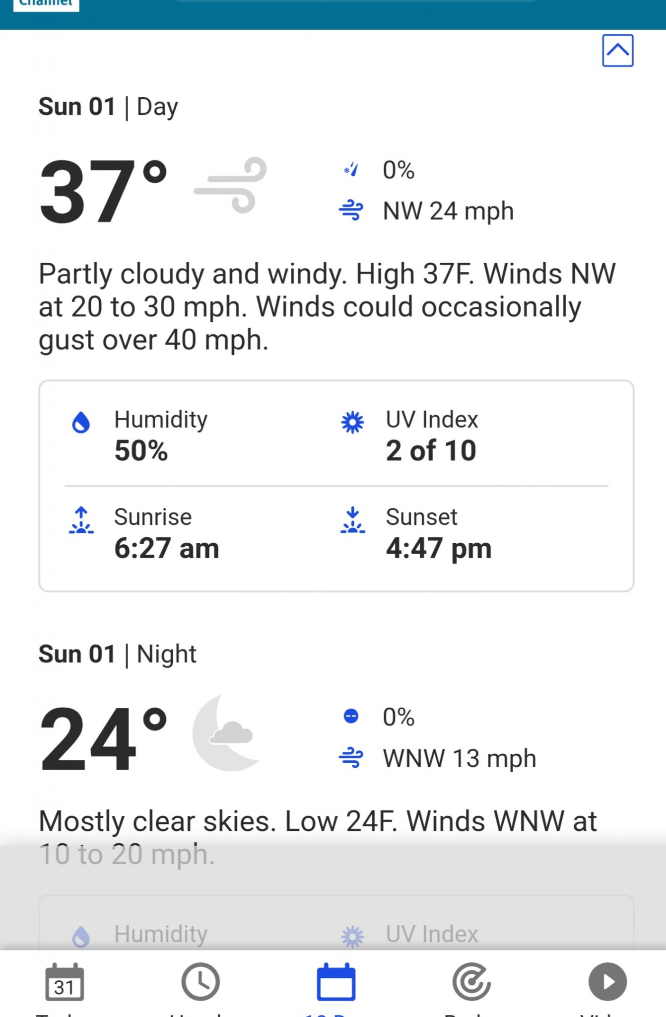

As I live in the North there really are some seasonal hardships when it comes to muzzle velocity.
But to my understanding how this works is that the barrel length is there to slow down the bullet.
So basically the colder it gets the less angular velocity is gained and thus groups should not get bigger due to too fast twist, on the contrary.

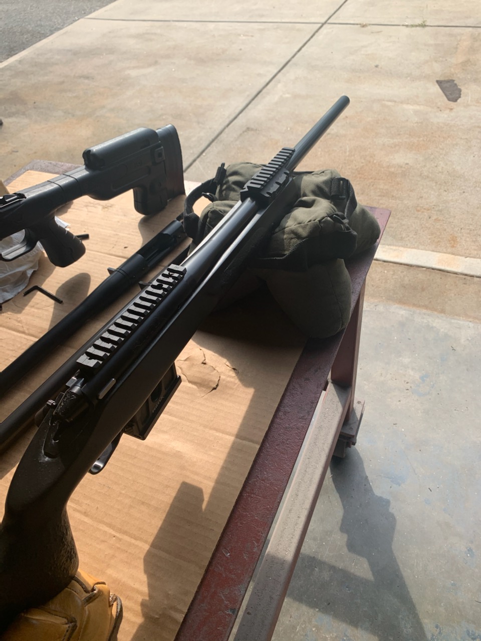

Howdy, I ordered and received my 1:9 twist Lilja barrel. Put it in a RPR Rimfire. Wish I would have read Ravage88‘s posts about going 22in vs 18 though.
So the modifications I’ve done with this rifle are as follows.
1)Timney Trigger set at just a tick over 9oz post on IG about it @LibertyHillPrecision
2) Shaped striker
3) installed 1:9 twist 18in Lilja SS barrel with threads for suppressor
results
1) no real difference in accuracy but very nice trigger and a pleasure to shoot.
2) massive difference in what ammo “shoots well” before 1 ammo shot a 3/8in hole minus the occasional flyer (always a velocity diff used Labradar) with CCI subs now it shoot almost everything I stuff in it with 3/8 to 1/2 25y 7-10 shot Groups and very few flyers. Oddly the CCI did the worst in this round. Fiocchi which was horrid before is now the best shooting.
3) barrel add with suppressor shot the best. All ammo remained consistent 25-50y with slightly tighter groups. 100y opens to 1.5-2 MOA which of this was a 6.5CM or 338LM would be horrid but was okay I guess for 22LR subs. 200y 4in targets were not to difficult to hit but velocity become extremely important. Trying to consistently hit 2.25 size target was much more difficult. As a side note a shaped striker on a CZ457 with 22in ( I think or maybe it’s 24, anyway) hit the 3in target 4/5 times at 200y to Ravage88’s point about barrel length there must be something there.
So is a 550$ Lilja barrel worth it? Maybe if if had gotten the 22-24in it would show me something different. Regardless, instead of ordering another barrel I’m going to add a Charlie Tarac Micro. Which will add 200MOA of elevation and get me to 900y. I’ll update Instagram for sure when/if that shot happens.
another side note, I got the 1:9 twist to shoot 22 solids that are being made as I write this.

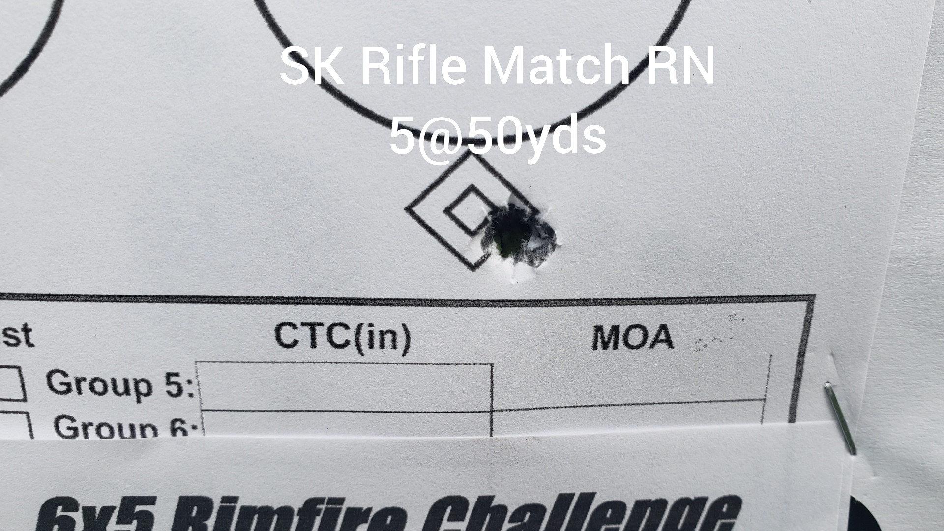

Try the SK Pistol Match and Lapua Pistol king.
They will have less MV / angular velocity and thus are maybe not slightly overspun.
So instead of making the barrel slow down the bullet, feed it slower cartridges. You might find its favorite.

If the weather holds I'll probably be going to the range Wednesday. Will be shooting the 60s era for 40x, 14 twist. Hopefully nobody will give me crap for it this time. Last time I was there shooting at 200, even though I was doing very well was told rimfires aren't allowed at the 200-yard range... American Shooting Center here in Houston

Almost there..
I'm curious to see results of a side by side with my 452 which has held it's own 200 and beyond, and I am guessing is a 16tw?...

Well had the rifle back for errr. prob a month now, had it out twice mainly just to zero and test some ammo. Sorry guys, just been to darn busy to really get out and do anything, been working 6-7 a week, off to work again this morning and rain tomorrow so hopefully next weekend conditions will be more favorable for some distance comparison.
Not much to offer other than test groups so far at 50yds, 40gr with the 14 tw, so kind of inconclusive I suppose.
