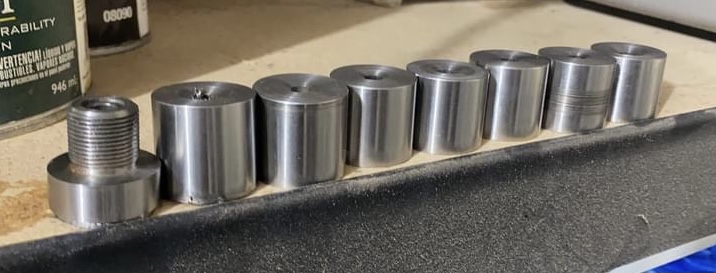

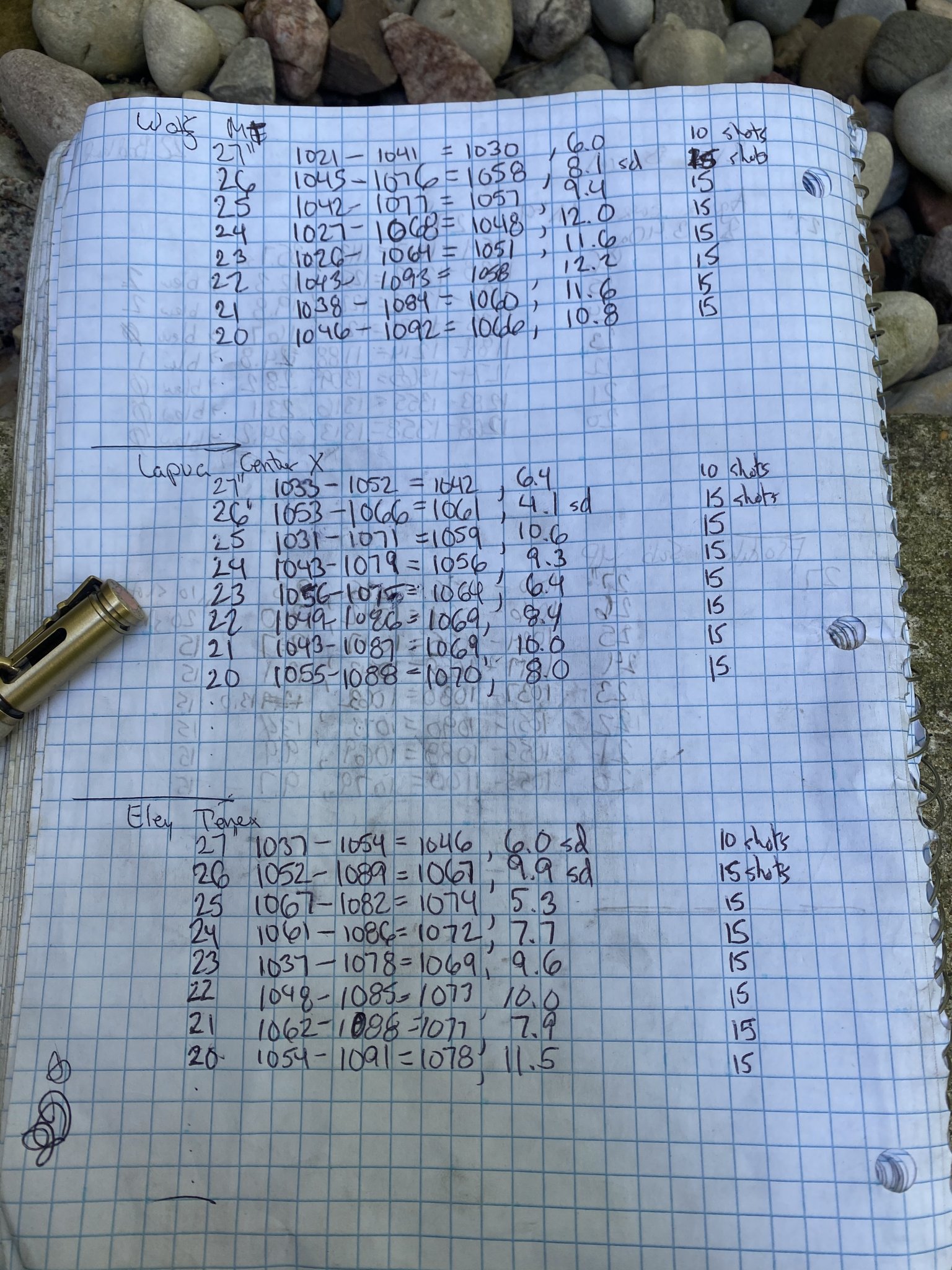

I can save you going too far with the cutting. That’s basically the test I’m running now

I'm very interested in your results when your done particularly regarding velocity spreads. His testing was focused on group size and velocity lost not SD etc.

Some good info there. Velocities are much closer in this test from 20-26 than what the internet would leave you to believe.

I am doing lots of 99 shots for velocity twice at each length 5 different ammo. The issue is temp makes a big difference so got to pick my days lol. I'm not going to be looking at velocity loss as that could get skewed with temp at this point.
