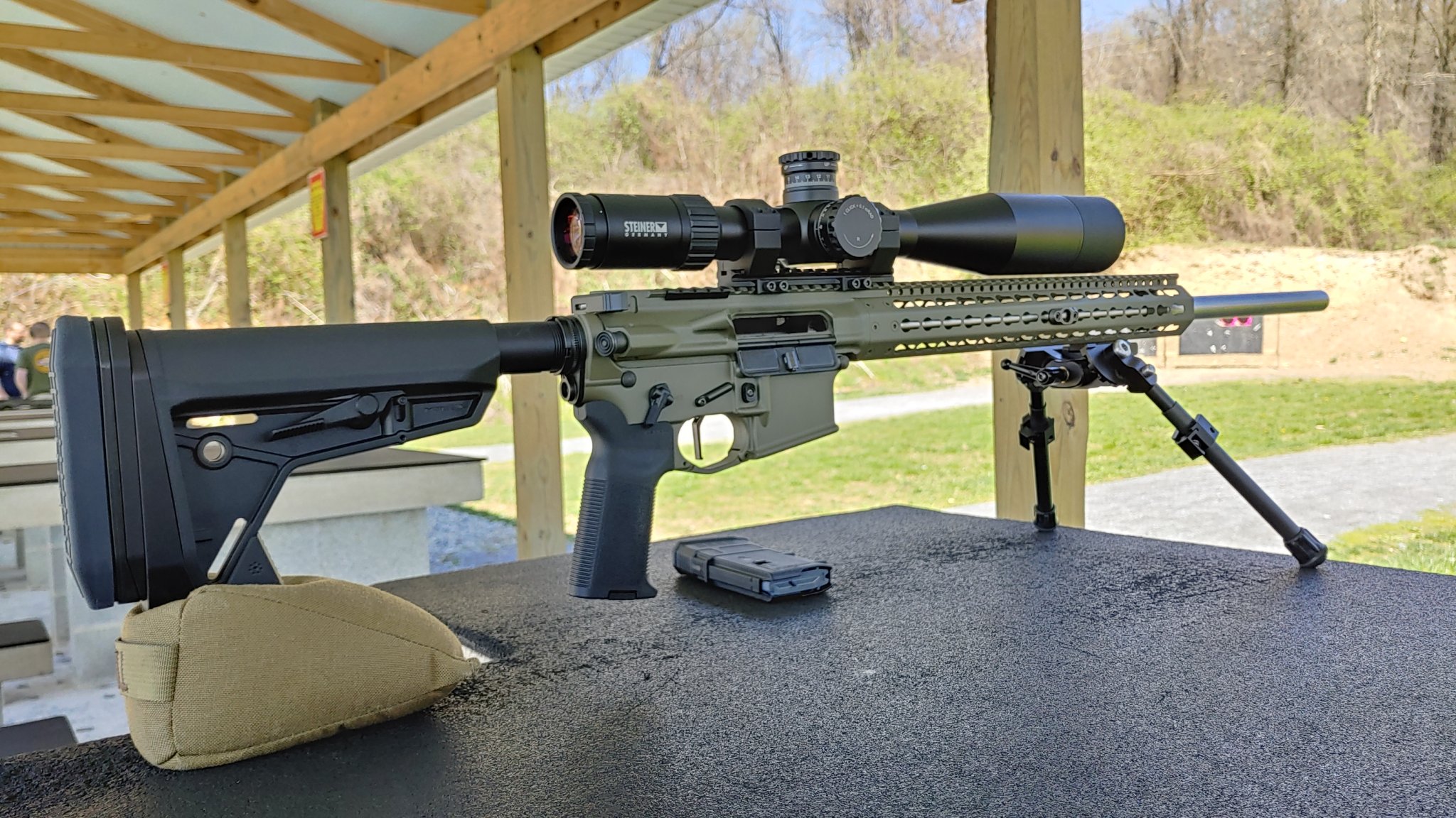

Let me start by saying the recoil isnt because I’m recoil sensitive, it’s more a concern whether something is wrong. Everything works fine/runs fine and is more accurate than me - I just want to make sure nothing is wrong. Just seems to be hard on parts is all.
Built an AR15 with a JP 24” barrel in 223, rifle length gas tube, tried a carbine buffer tube/spring and H1-H3 buffers, now I’m using a rifle length buffer/tube/spring. Buffer changes didn’t really make a big difference at all. Oh, and it has a JP muzzle brake on it too.
It has a LOT more recoil than my ultralight faxon AR15 in 223 which weighs 6lbs. This 24” AR weighs about 13-15lbs.
All factory ammo, no over pressure signs around the primers. Tried H1-H3 buffers and have the gas turned down as possible and have it eject property and Last round hold open. it still kicks way harder than I feel like it should? It recoils so hard the muzzle / bipod will jump. (Yup it’s seated firmly against shoulder). It Feels like a lot for a 223 and compared to my other 16” carbine AR15? I mean it has much recoil as my AR10. Is that just because it’s a 24” barrel and rifle length gas tube?
Built several AR15 pistols and carbines, this is the first longer one with rifle length gas system so wondering if that’s all it is?
I’m thinking about trying a carbine H3 buffer (so it’s shorter than the rifle length buffer, in a rifle length buffer tube, with the rifle length spring to see if it’ll have a little more room for the bolt to slow down?
Is there anything I should check to make sure it’s all ok? A couple of my buddies think it had kind of a lot of recoil for what it is too.
The answer may be, “sounds about right to me, run it” and that’s totally fine, I figured I’d just double check tho :)

Hey, looking at your pic again, how tall are you? Do you have your PRS extended out because you need the LOP or because you didn't do a cantilevered scope mount?
Dang good eye man!
I’m 5’11 185lb - that’s just where I found LOP to be nice and then moved scope to proper eye relief.
I’ve seen the thing with the LOP being determined by putting the stock in the crook of your elbow and where your trigger finger hits the trigger, but to me it always feels so awkward and cramped like that so I’m sure if I went to a school they would tell me I’m a moron tho lol
Dang good eye man!
Those PRS3s are kind of on the long side for me so always wonder about folks that have them adjusted out. If it's comfortable for you then go with it.

If so, the “recoil” might just be the insane amount of concussion these “tank brakes” can produce.
Beyond that, bipod hopping is caused by your position allowing the rifle to move.
I’ve posted this before. My son, who was a 135 lb 14 year old at the time, shooting a hunter weight 7mm rem mag. I’m going to posit that it recoils more than your ar15…
I don’t think it’s that bad, but I should throw a can on it to see next time I go out
What specific buffer spring do you have?
Also, extra buffer weight will not increase your felt recoil bt itself.
....A spring that isn't the proper strength or too light or heavy, or too short or too long, etc, will cause more issues.
If you adjust the gas for lock back and the gun still recoils hard, something is not right with the spring and buffer.
Did I read right, this has a light weight bcg?
And you are right it shoot like a bb gun
Reactions: NSKYLINE34
Is the JP brake this obnoxious thing?
This is my brake:
I will check on the spring, it’s either an aero precision rifle length or it’s a blue spring. I can’t recall which ended up staying in there.
BCG is NOT a light weight one in this rifle.
I will have to check which spring is in there right now though to be sure.
Reactions: mettee
A rifle buffer spring, in a carbine receiver extension, with a carbine buffer, is going to cause coil bind.
Right now it’s all rifle length stuff - tube, spring, and buffer.
I was just brain storming, but someone brought up a good point that it would abuse issues lol
I did order a JP silent buffer for another rifle, so I will have to give it a try in this one first and try out the different springs it comes with
Not if the harsh recoil is coming from the action running too fast.
By me adjusting the gas block to reduce the amount of gas that can go through it, wouldn’t that slow the action down? This is kind of what it seems like - feels like the buffer is just slamming to the back of the buffer tube. Which makes me actually question the spring more than anything. Maybe I got a defective one that’s too soft?
I’ll order another rifle length one from another company. I did build this during covid so it’s possible quality of stuff wash junk and I got a bad one?
I wish there was a device that I could put between my shoulder and the stock to measure the recoil impulse so I could do a direct comparison between several rifles and show the data. That way I can make adjustments and compare it all.
Reactions: RKBArmory
Just ordered another Anderson Arms A2 rifle spring and I ordered a Griffin Armament +15% A2 spring too just in case and so I can test and compare. Only $20 for all of it so worst case I’ll have some spares for the future. But it’ll be good to rule out some things.
Now that I think of it, I’ll have to get some videos of shooting this 24” AR and some other rifles for comparison.
