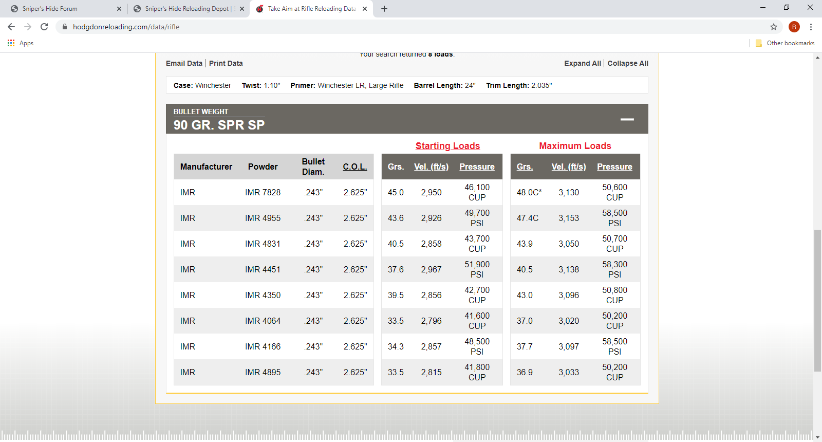

Looking for anybody who has shot 90gr gamechangers from a 243 with a 1-10 twist barrel. I got 100.
I have IMR 4451, 4350 and 4831. I shoot mostly IMR powder just because I've loaded it since I was a kid and its easy to get locally.
The IMR reloading data page shows this
So now I have a hankering to try 4955 and 7828.
I have never loaded compressed loads before. I shoot from AICS style magpul mags.
Does anybody have any experience with 4955 and 7828? Does the extra velocity help or hurt accuracy? I'd hate to spend more money and be disappointed. I know the only way to really know is to load some up and try it. But if everyone else says it sucks or is great it would help me decide.
