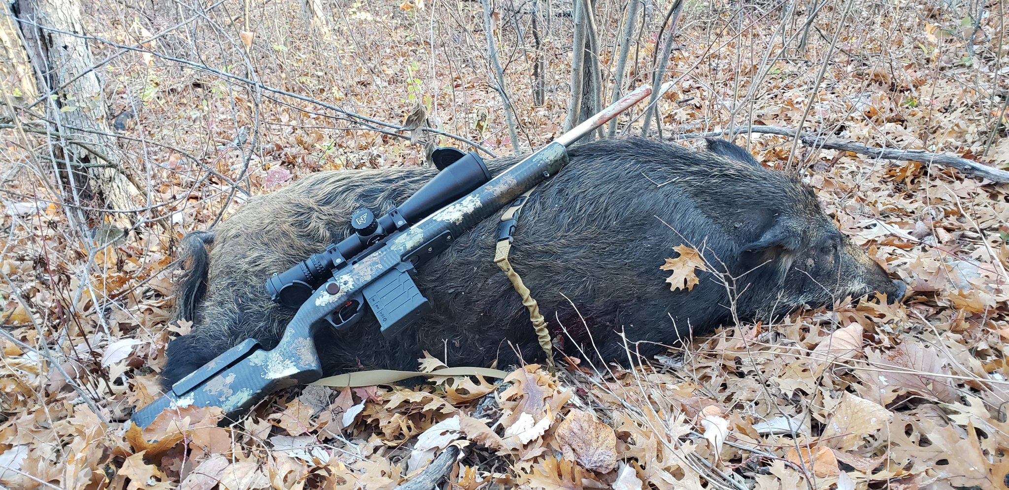

Rock Creek 23" 3b contour.
Just a little something something for fun.... and hogs!

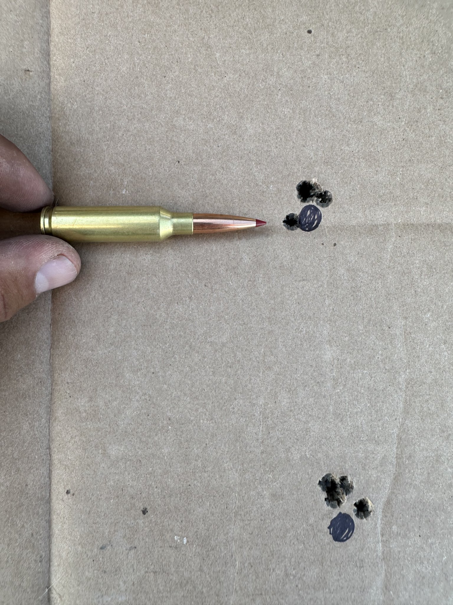

Update.

Berger 133 Elite Hunter (0.283 bushing)
H4350
*New Lapua SRP brass
GM205M
COL 1.9120
*BTO 2.1010
41.0gr 2604, 2617, 2631, 2635, 2626
2612, 2641, 2630, 2622, 2634
SD 11.4 2” min pressure
41.3 2646, 2660, 2641, 2682, 2652
2671, 2645, 2646, 2644, 2640
SD 14 1.6” (8 in 1”) mild-mod pressure

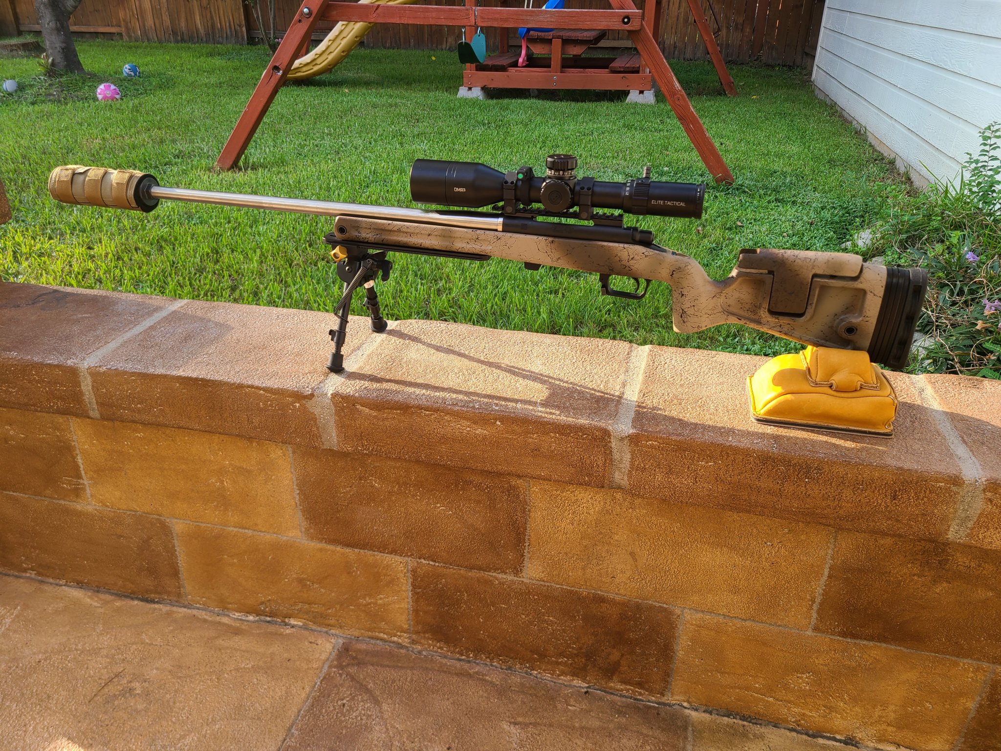

Finally got my 25 creed together.
Solus action, proof 22” barrel chambered by @FisherT&C with enticer s ti can.
Components are:
Alpha SRP brass
CCI 450
H4350
134 ELDM loaded at .050 off the lands. 2.165 CBTO/2.865 COAL
took it out today for its first “ladder” for rounds 51 thru 74 down the barrel. So it’s still very fresh. 38 degrees today
41 gr - 2752 avg, SD of 6
41.5 gr - 2787 avg, SD of 5.8
42 gr - 2818 avg, SD of 19.5
42.5 gr - 2832 avg, SD of 8
41.5 and 42.5 shot the best.
No pressure signs, but I won’t be going any higher. My goal was to get around 2850 ish and that will be easily achieved once the barrel reaches cruising altitude. Which for all my proof barrels, has come around 200 rounds total.
Very promising and “proof” that you can get some good speeds with the ELDM and 4350 without a long ass barrel. Even in colder temps.
