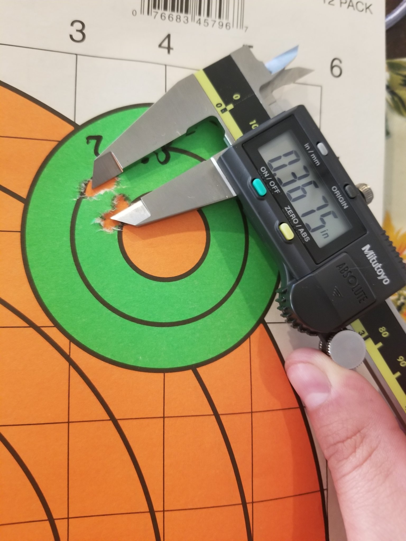

Tell us about your build!
Cartridge, barrel brand, length, twist, velocity, and most importantly accuracy.
Thanks
26" 25 creed 7 twist xcaliber blank on bighorn origin action in a manners t2a
Velocity at 2954 with sd of 3 using unsorted 6 creed starline brass necked up to 25
