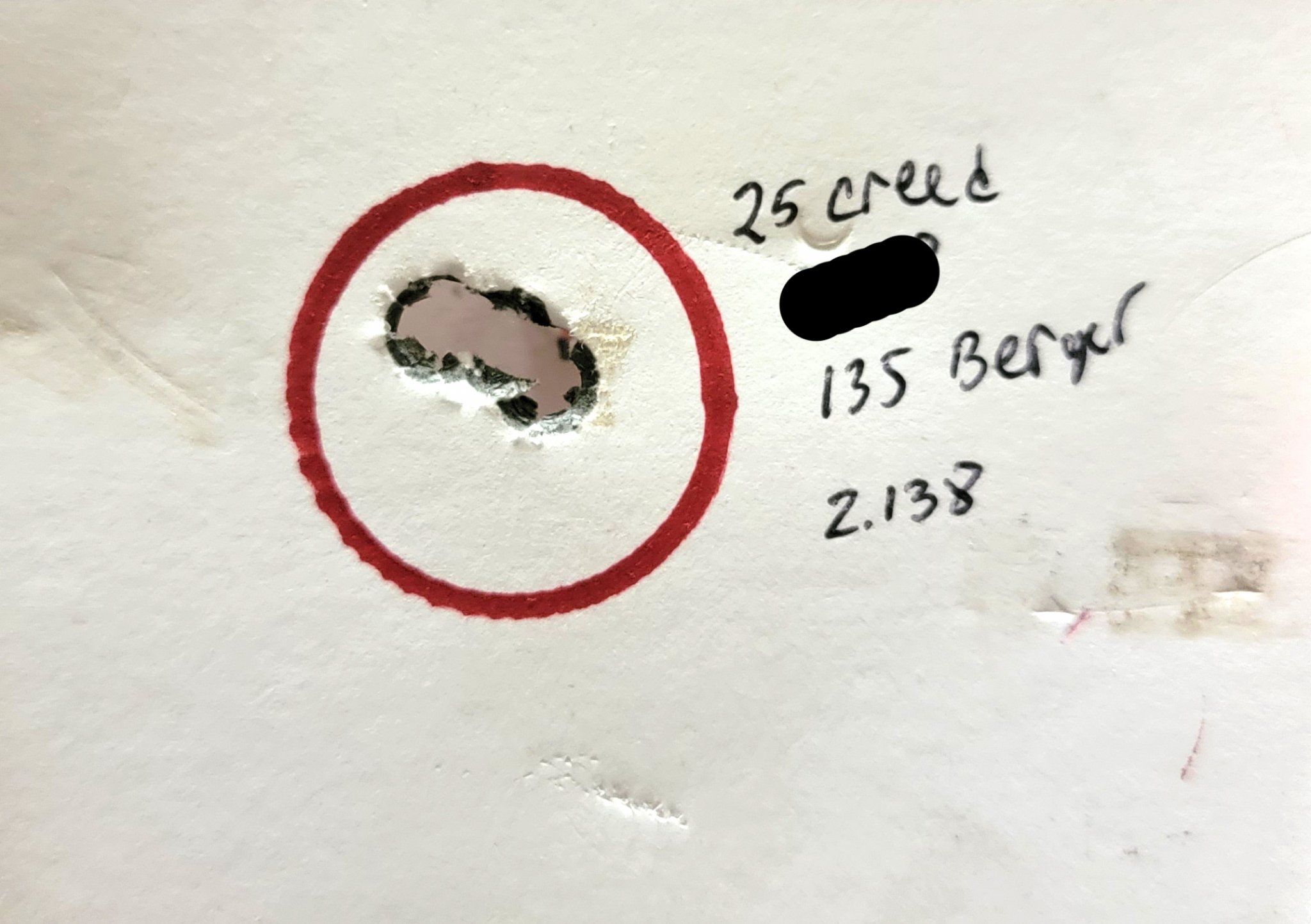

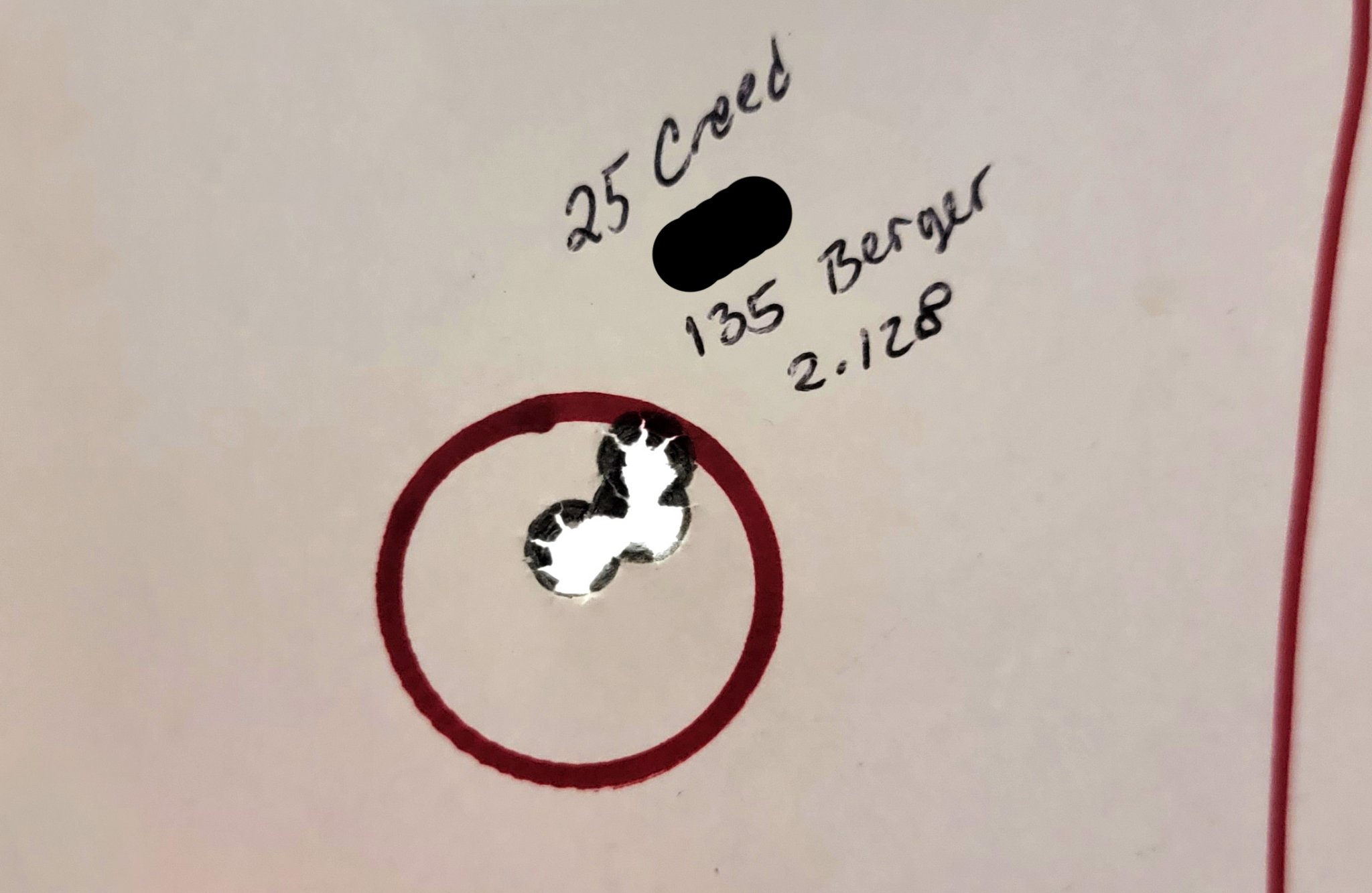

Im using the BJ Rev 2 reamer, which has .115 freebore and a .290 neck. Loaded neck dia in lapua 6.5 brass measures .2845, and annealed/fired cases measure .2885. I think they designed this for “thick” necks, but its ideal imo.
This is my standard load with 135 bergers at .030 jump in a chamber with ~400 rounds on it.
View attachment 8200963View attachment 8200964
Dude, that is PERFECT seating depth! No lost capacity, and no excess pressure spikes from pushing it down into the column. 👍🏼

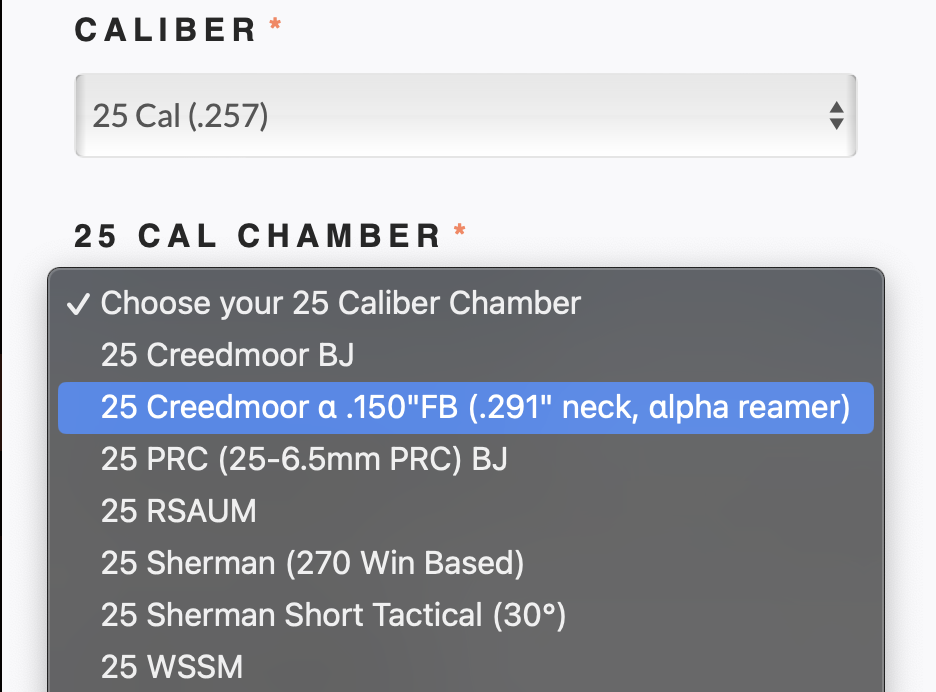

Does anybody know anything about the .25 Creedmoor Alpha spec reamer? Preferred Barrels has both the .25 CM BJ and .25 CM Alpha. Is that spec'd for the Alpha Munitions .25 CM brass?

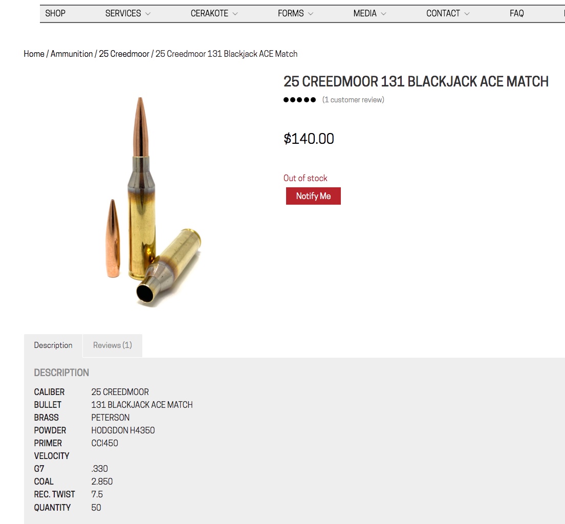

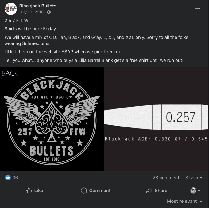

.330 is the number I saw BlackJack advertising in 2018...
...and it's still the number UnknownMunitions has published on Out Of Stock 25 Creed ammo using the 131 bullet.
I don't make the news...I just report it.

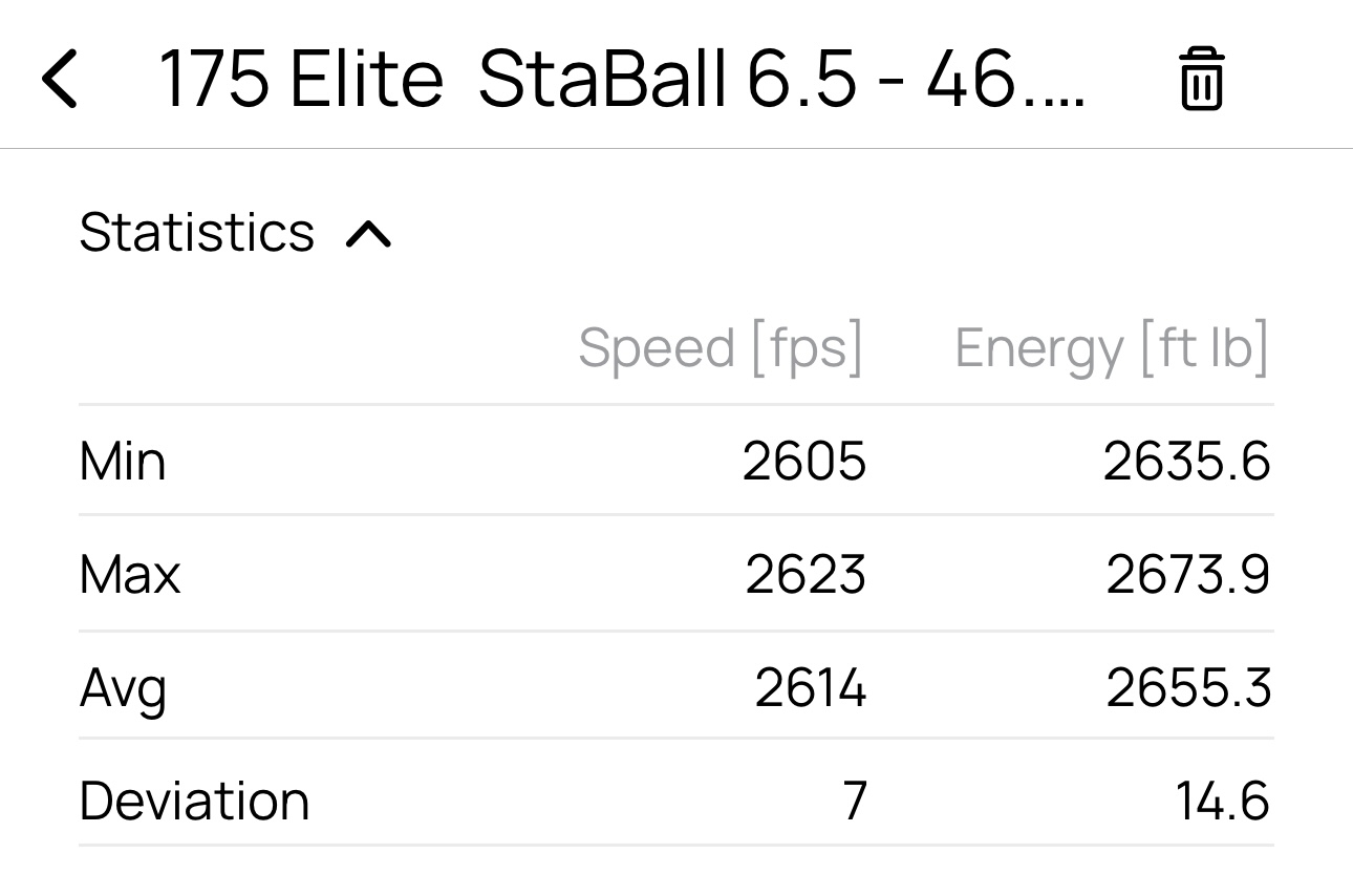

They shoot fantastic, I'm still loading them with H4350. I was a little let down that they aren't as fast as my 131's tho. The 131's were over 2900 with no pressure signs, but these 134's at 2850 are getting close to too much pressure. At least with this powder.
You should try Winchester StaBall 6.5 powder... I gained over 200 FPS (safely) in my 20" 7mm-08 pushing Berger 175 Elite Hunters. I was absolutely floored. It did what they advertised (150+ FPS over your other powders, safely). I was only averaging 2403 with Varget, and ended up at 2614 with StaBall 6.5.

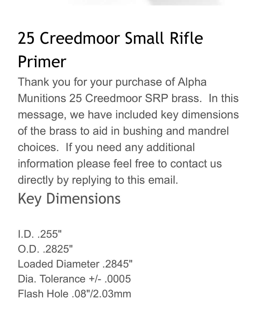

Does anyone know what size bushing is needed for using Alpha brass and a Berger 133/135 to get .003" neck tension?

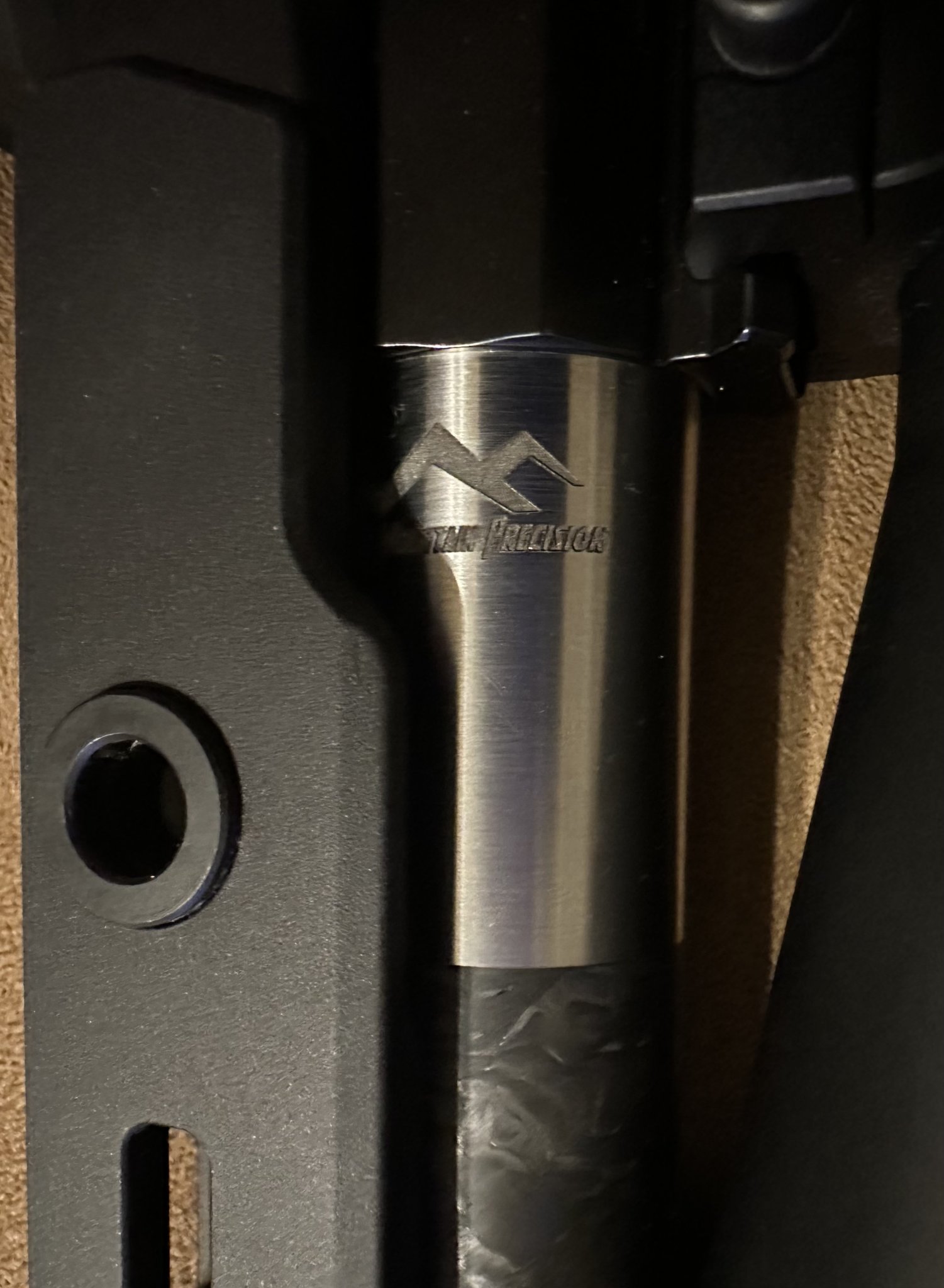

Got my @CarbonSix barrel on order, and working on getting components together.
Im using 283 on alpha in a SAC die. Id get 282 283 and 284 and test.
I use a .282 with the info i got from Tom at alpha. He emailed me this when i bought the brass.
I am becoming a HUGE fan of Alpha. I'm not used to a manufacturer giving out such information. I'm used to measuring my own. Thanks for this tidbit of info! 👍🏼
I am becoming a HUGE fan of Alpha. I'm not used to a manufacturer giving out such information. I'm used to measuring my own. Thanks for this tidbit of info! I will be using it from now on with other Alpha brass. 👍🏼
I had 300x pcs of alpha from their first ocd 25cm brass run, I had a loaded neck Dia or 283-2835 on my micrometer. I have a 291nk chamber, so I switched to necked down alpha 65cm, brought it to 286. Maybe the necks are thicker on recent runs. But I'd prob get a 280, 281, 282 if you're seeking 3k nk tension. Just my limited experience with the Alpha 25cm brass.

I'm thinking I'll get a set of .281's and .282's to run in the dies to see which one it likes best. The reamer that @CarbonSix uses is a rental from 4D reamers, and they don't know the neck specs. I asked them to use the Alpha reamer, but they said they don't have access to one. There's one for sale on their website, but they don't have any .257 pilots in stock. If they do have any pilots, I might order the reamer, and have it shipped to Carbon Six and then have them send my reamer and barrel back when it's done.
My pleasure. I am as well! I guess he does that for everyone if you buy direct from him. FWIW i use the alpha reamer.
Yeah, I’m going to have to buy one, and a a pilot, but they don’t show any .25 pilots available on their website. 🤦🏼 Waiting to hear back from them now.
+1 for the Alpha guys being outstanding, I've been using their brass and reamers for a bit now. I think i still have the first box of 25CM headstamped brass. As far as the bushing, I use a .281, and I kind wish i had a .282.
I ended up ordering a set of .281’s and .282’s (FL & NK) for the Redding Elite Type-S 6.5CM set.
Keep us updated.

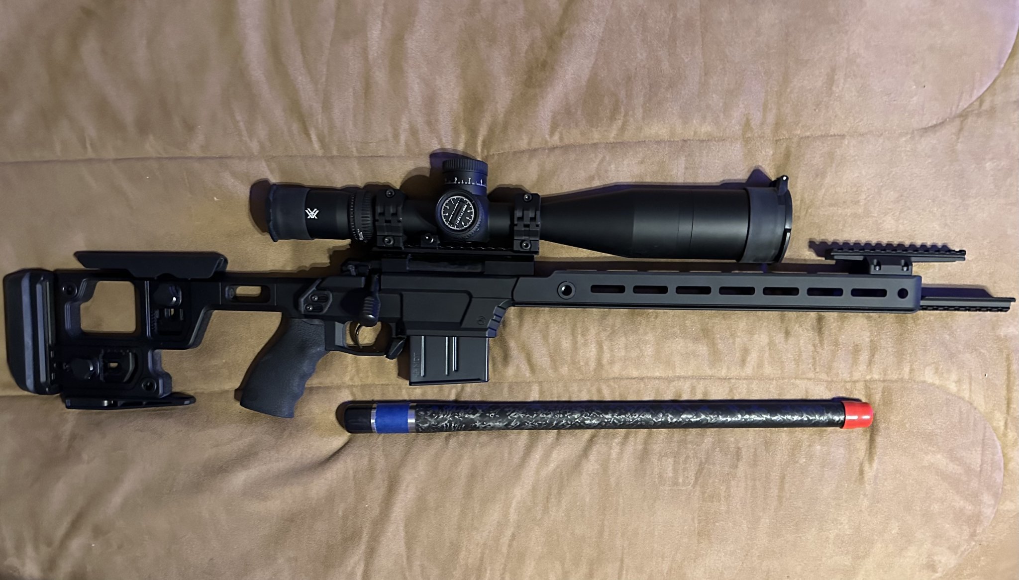

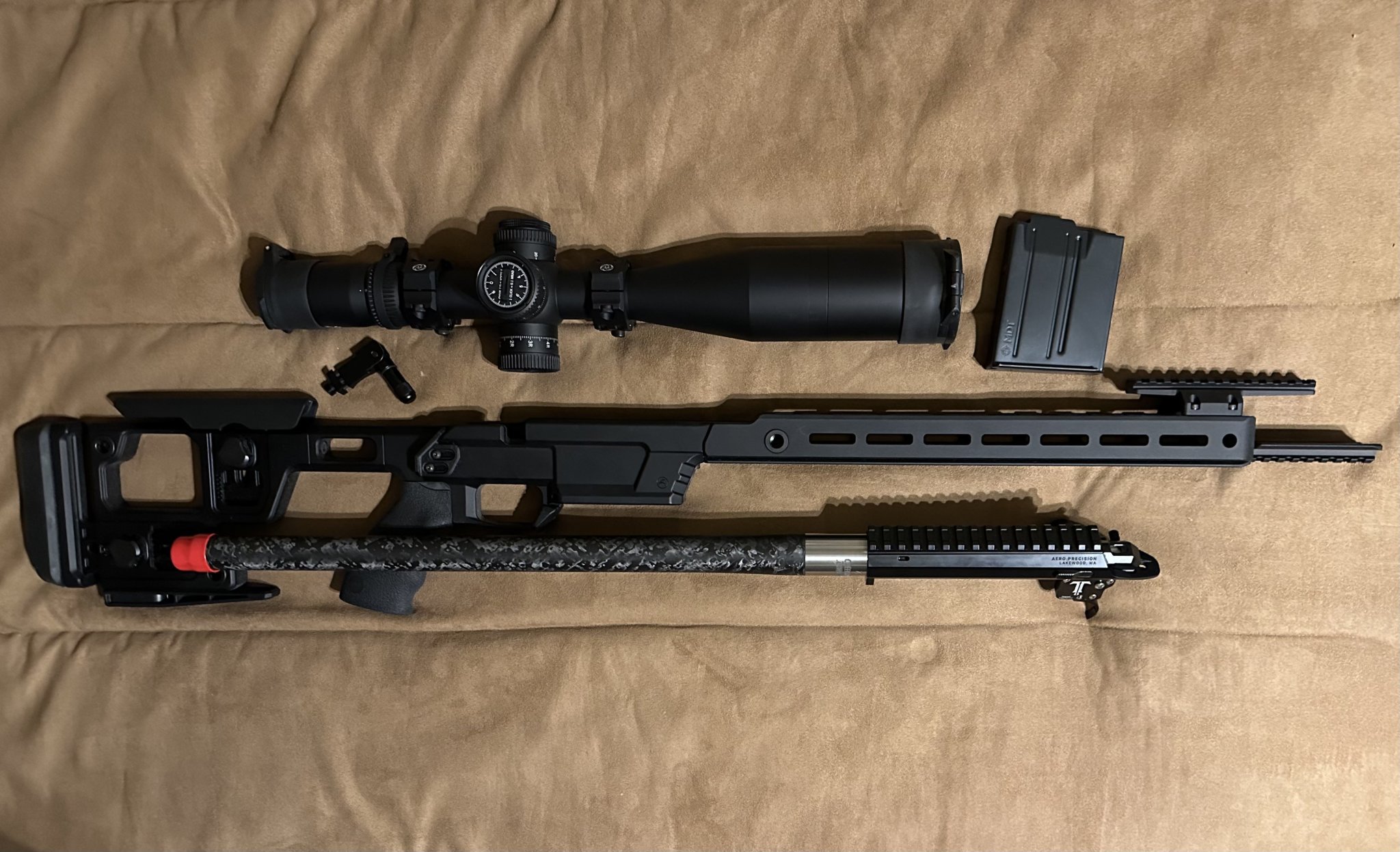

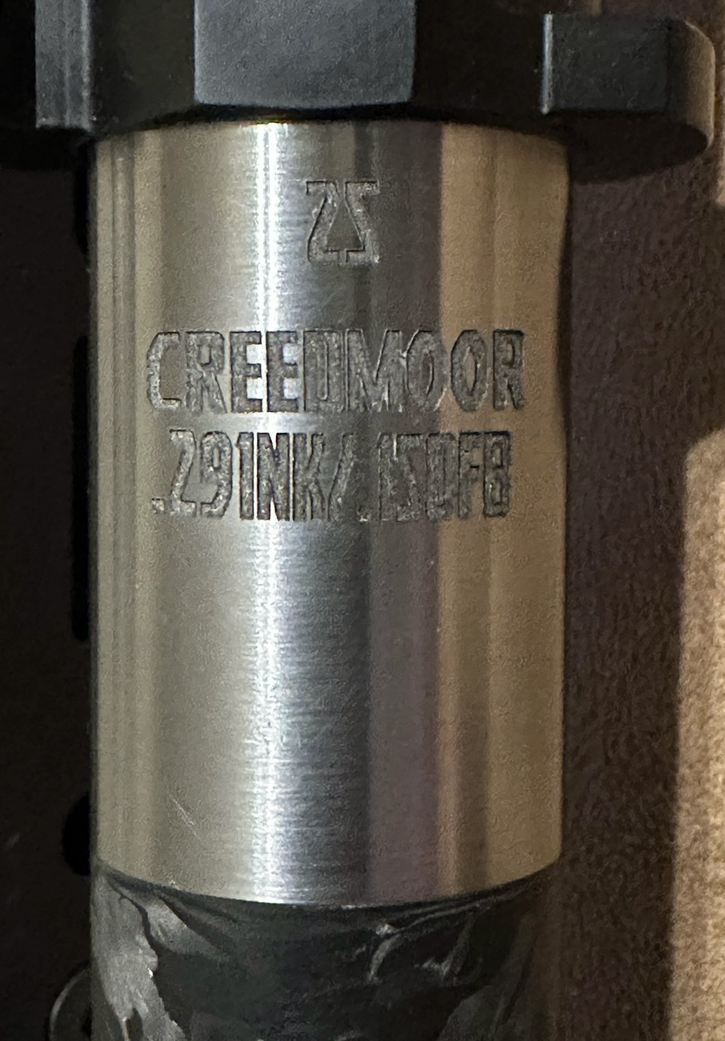

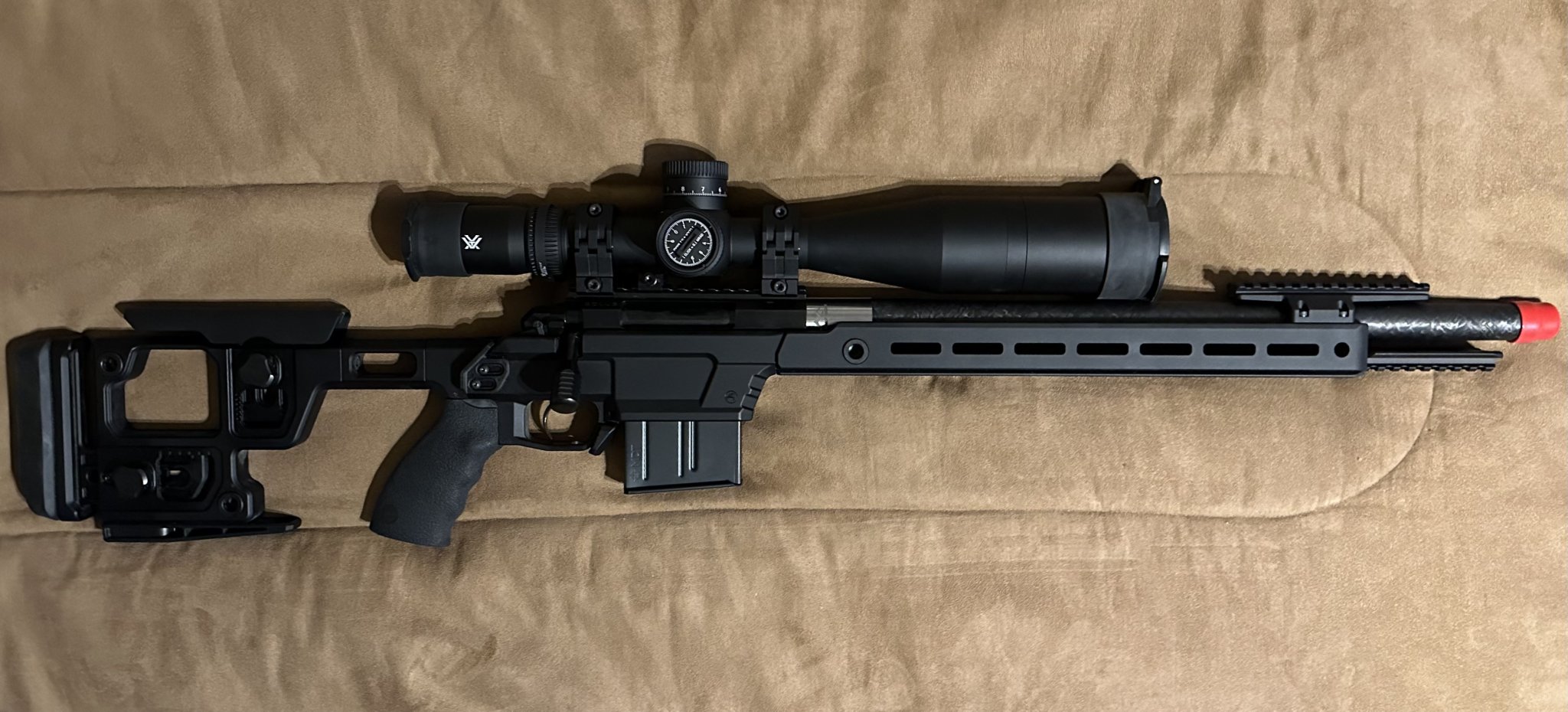

Everything is now ordered, except for the dies and the Alpha .25CM brass. I'll probably order that this weekend, maybe tomorrow at work if I'm bored.
I ended up buying the last Alpha Legacy .25CM reamer & pilot from their website this morning, and am having it drop-shipped to @CarbonSix for chambering my barrel, and they'll just send them all back to me with the barrel, when it's finished. I figured it was the best option since now I have my own reamer and can have my smith cut my barrels from now on, if I need to, or send it into a barrel maker for them to use for my barrels, and specs will stay consistent for my brass, as long as I have them cut the headspace to the same depth.
Reactions: xocyrusx
Nice! Well come to the club. We need to keep it quiet though…. Shhhhh

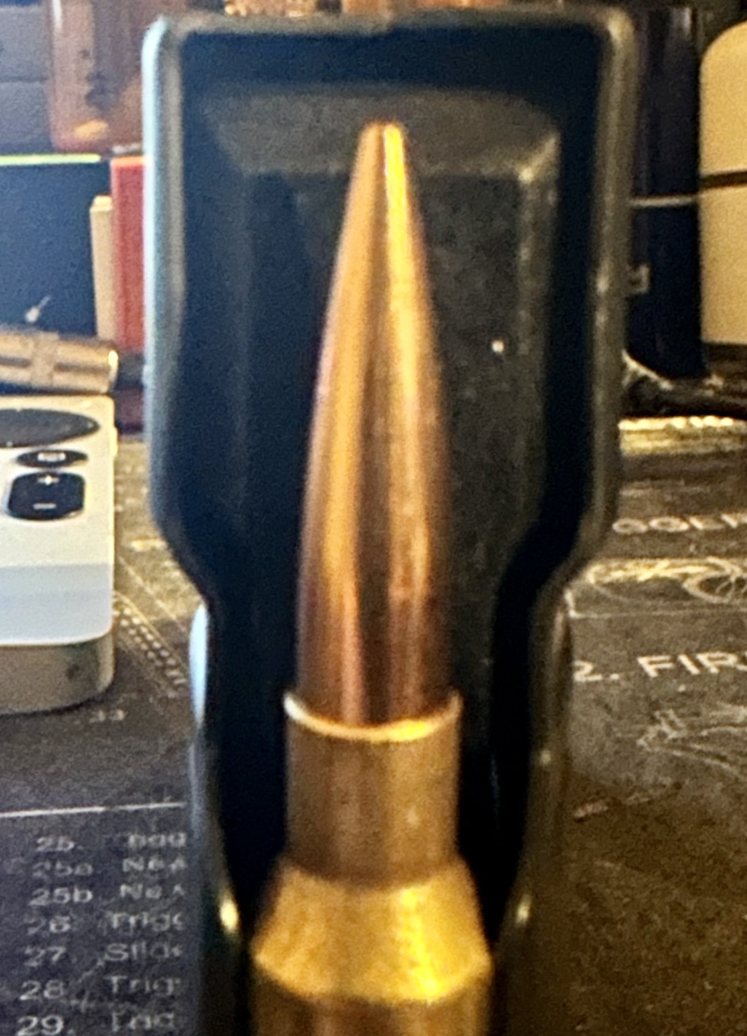

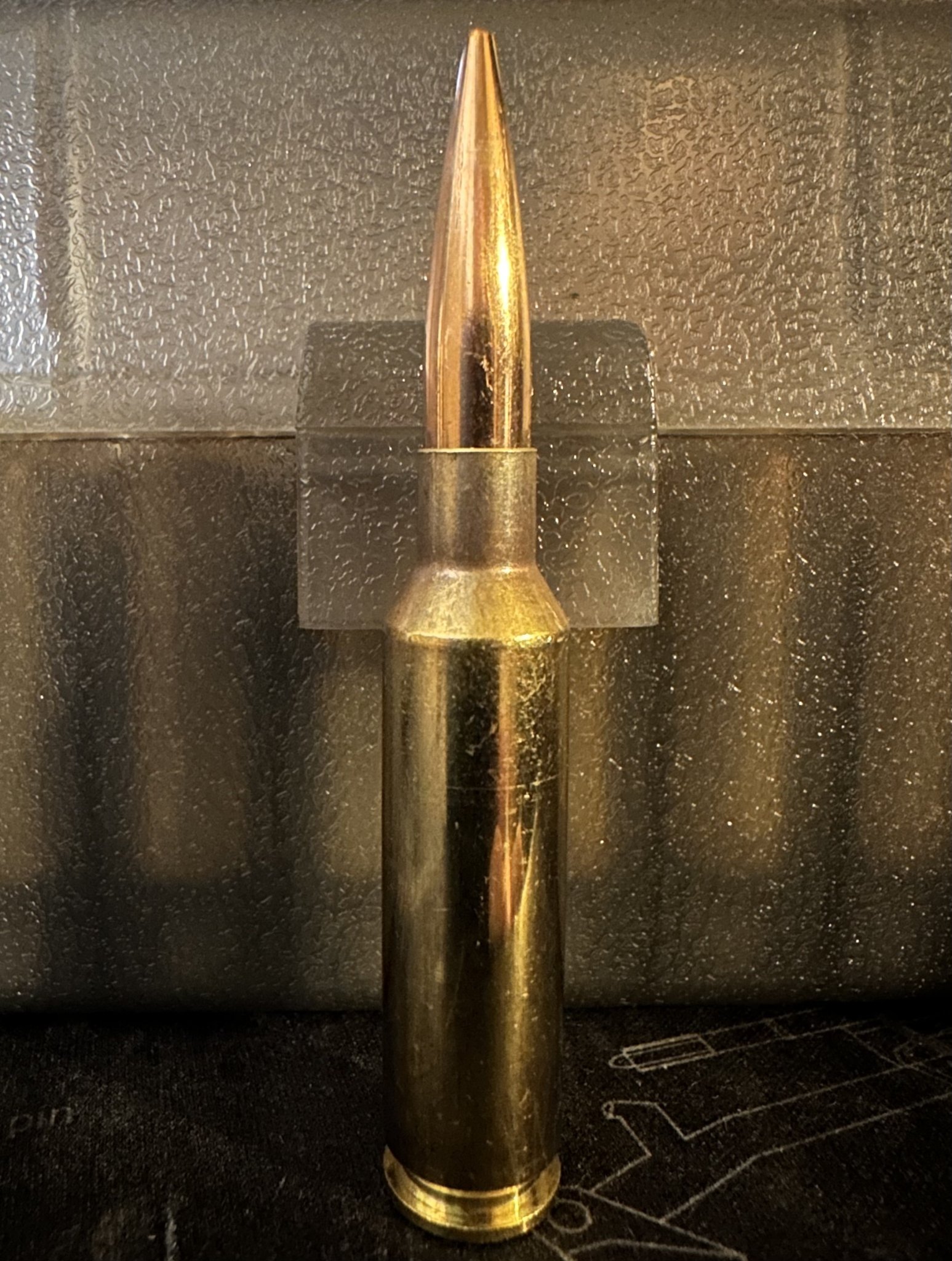

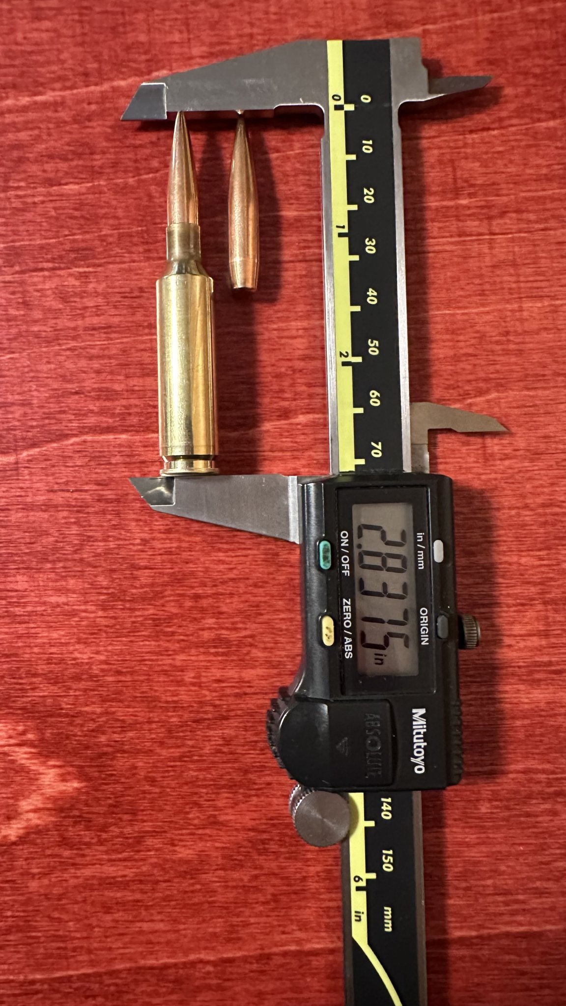

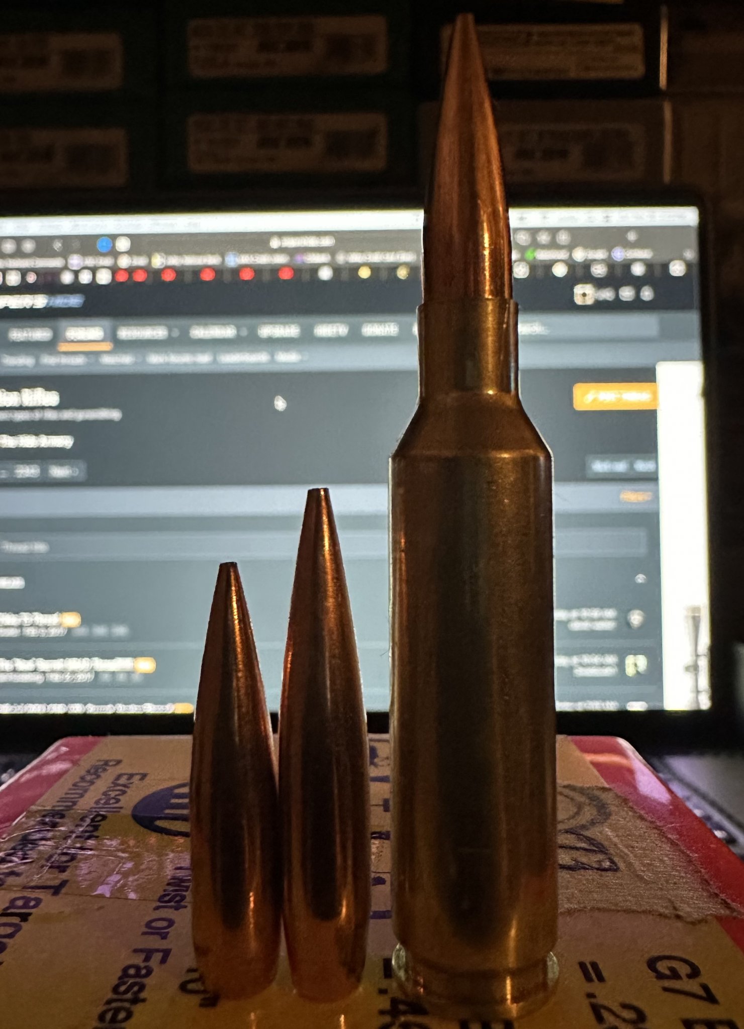

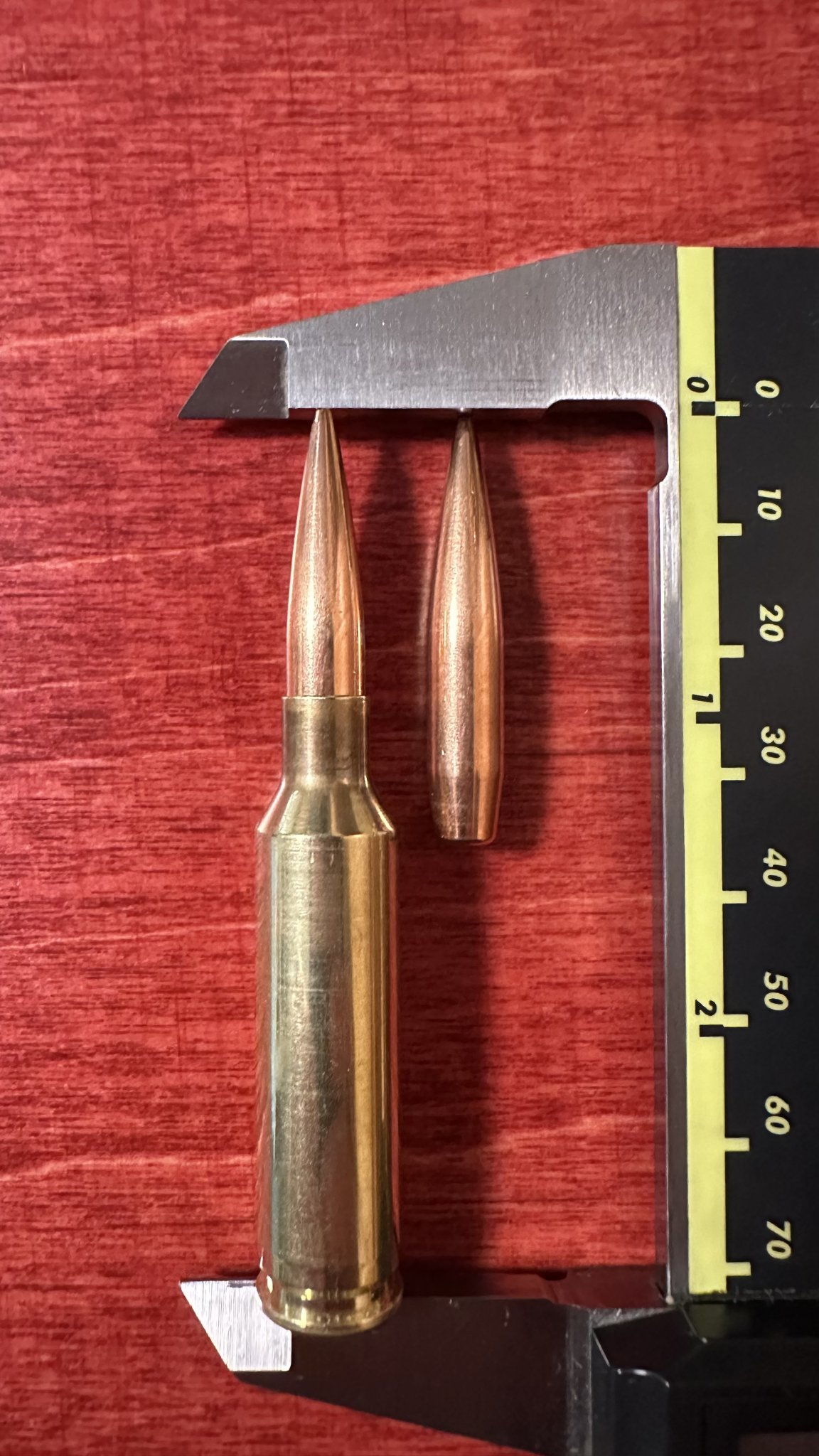

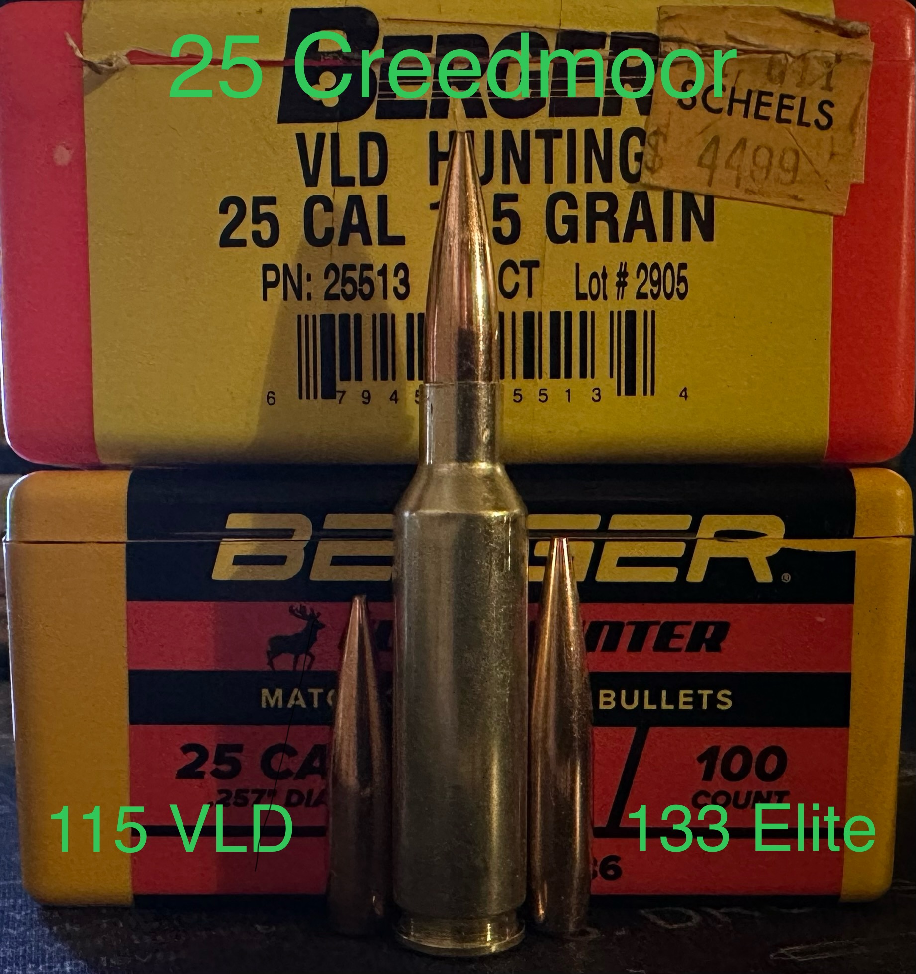

Dummy round made using an old piece of random range 6.5CM brass, and a spare Berger 115 VLD I had sitting around. The end of the bearing surface, where it meets the boat tail, is sitting exactly where the neck/shoulder junction is. So, the only thing dropping into the case, is the boat tail. I hope this will be the case with the 133 Elites with my Alpha reamer... But only time will tell. I won't know until I get my barrel and reamer back from CarbonSix.
Reactions: xocyrusx
View attachment 8282023View attachment 8282024
Maybe I missed it...but if that's what you were going for...why didn't you just make a few dummys with your bullet of choice, seated to the depth you wanted, and make your reamer based off those dummys? If it's close...close enough, but if it's not close, you could always just run a throat reamer in there.
Maybe because I didn’t want to wait six months for a custom-ground reamer, then have it sent to the barrel builder for another 3+ months of waiting… If I’m not happy with the outcome, I will order a custom throating reamer to get it seated where I want it.
