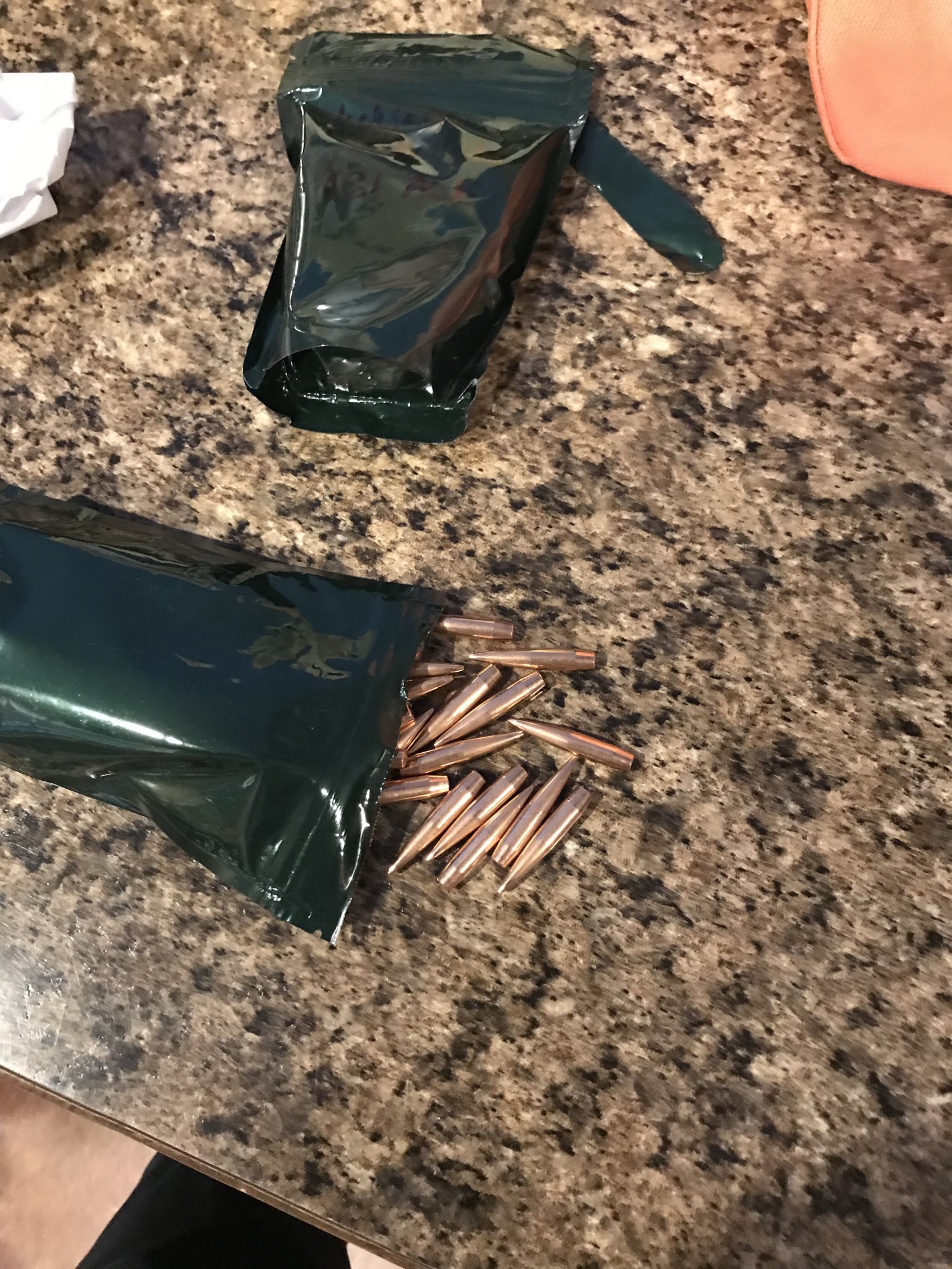

ware dem boolits at
Edit: Seriously, though. I got my barrel inbound and still got no bullets.
We took partial shipment of the bullet run this week so we could get them out to everyone quicker. All orders that are already submitted will be shipped by Tuesday and hopefully our website will be back up by then for new orders.

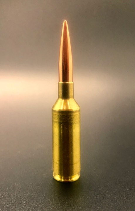

We have some cool things coming down the pipe but here's a sneak peak of the one I am most excited about.
257 Blackjack - cruise control at 3200 fps - more updates in the coming weeks.
We have a solid collective of testers on this one and I'm chomping at the bit to get them out in the field!

So the 257 blackjack looks like a 6BR necked up?
The 257 Blackjack is definitely a magnum bolt face. BR capacity wouldn't get it near 3200 fps
Nobody I know of has burnt a barrel yet and I've got my eye on most of the sources of 25 cal information. Best estimates of barrel life are between 6 Creed and 6.5 Creed. I always like to say closer to 6.5 Creed because of increasing diameter causing a proportionally larger increase in bore surface area and volume, but it's just speculation.
It looks more like the WSM shortened a bit. Left a longer neck on it. Which is a good thing.
