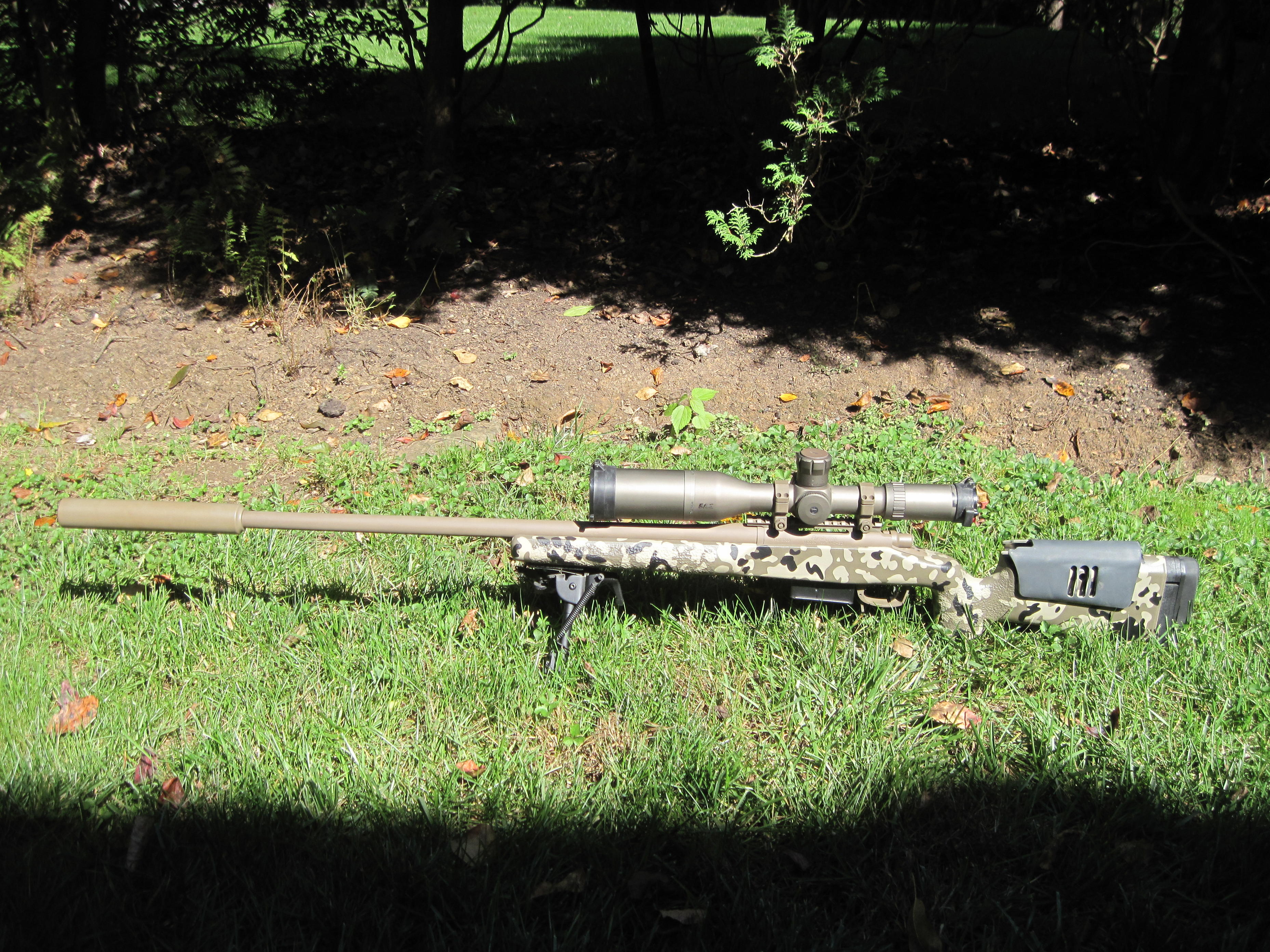

Started as a rem700 acc-sd. Trued Action/ schneider 26'' 1-8 rem varmint contour/ badger base, bottom metal, recoil lug, rings, and bolt knob/ timney trigger/ mcmillan a5 sniper fill stock (painted stock myself using stencils and spray paint, GAP flectarn theme)/Bushnell ERS/ Harris bipod/ TBAC 30p-1. Built by W.A.R Rifles out of Manassas VA. Action and barrel are cerakoted fde. Blind thread protector. Still working on developing a load. (Groups are 3 round,100 yards, shooting prone with a rear bag)

Thanks Anthony! Well I only chrono'd 45.7 grains of 4831sc at 2788fps average (which is what Hodgdon recommends as the max). However I loaded up to 47.7 with no pressure signs. Only problem is they are definitely compressed loads at 2.810 OAL. I was told that since 4831sc is a slower burning powder I won't burn the throat/barrel out as fast vs 4350. Still breaking in the barrel though and developing a load. I'm gonna chrono 46.5-47 next time and seat the bullets out further.

I know that a lot of people like their .260s to go faster, but I like the speed I have at just under 2800. It's accurate as all get out and I'm fine out to 1200 yds so far.

Thanks Lash. Yeah I may end up sticking with something slower if it still preforms well at 1200 yds as well. Right now I was aiming for an accurate node at something more like 2800 - 2850 fps.
