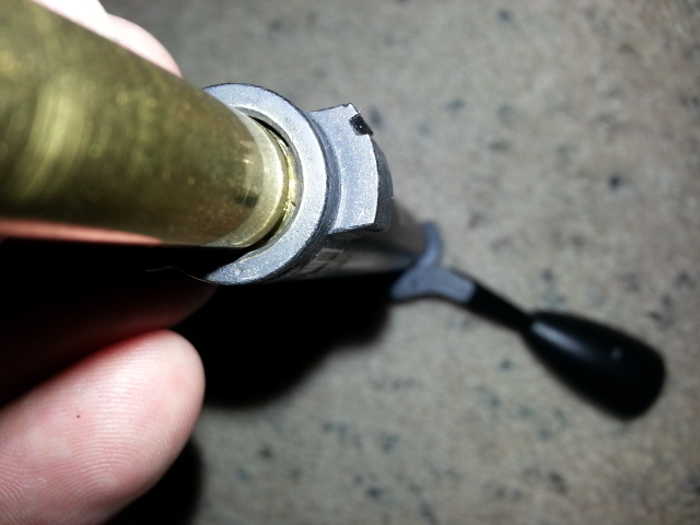

Eta. I took a quick pic of my bolt with a case. I can pull as hard as i want once the case is in and its not coming out. Can your do that or does it slip?

Pics from chambering rounds. Rounds were placed in the chamber and then the bolt was manipulated to lock the lugs and extract. Pressure was placed on the case during extract to ensure there was no additional contact with metallic parts.
Lapua up top
Remington on the bottom. The remington had been chambered a few times, hence the marks on the bullet from extract/ejection.
Hey,doing a really close up view of the the extractor claw it looks like one side is not machine right. The pic looks like one side has the lip like it should (top) but the other side is 2-3times as thick (bottom). Is that just the pic? I would take that bolt apart and look at it real close. Might be it
Ok, one more time. It will not EJECT due to EXTRACTOR holding it too tightly. Look at the rims and note difference in rim thickness. Need to stone EXTRACTOR on inside edge or use Win brass.
