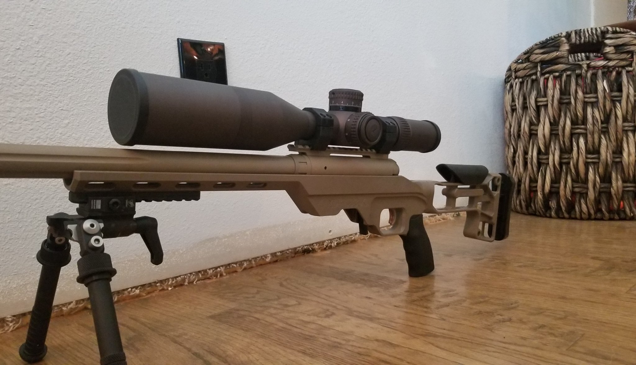

    Rifle details: Savage model 12 LRP w/ 26" barrel MDT LSS XL Chassis, Vortex Razor Gen 2 4-27, Seekins precision rings, Atlas Cal gen 2 bipod with a rear bag.

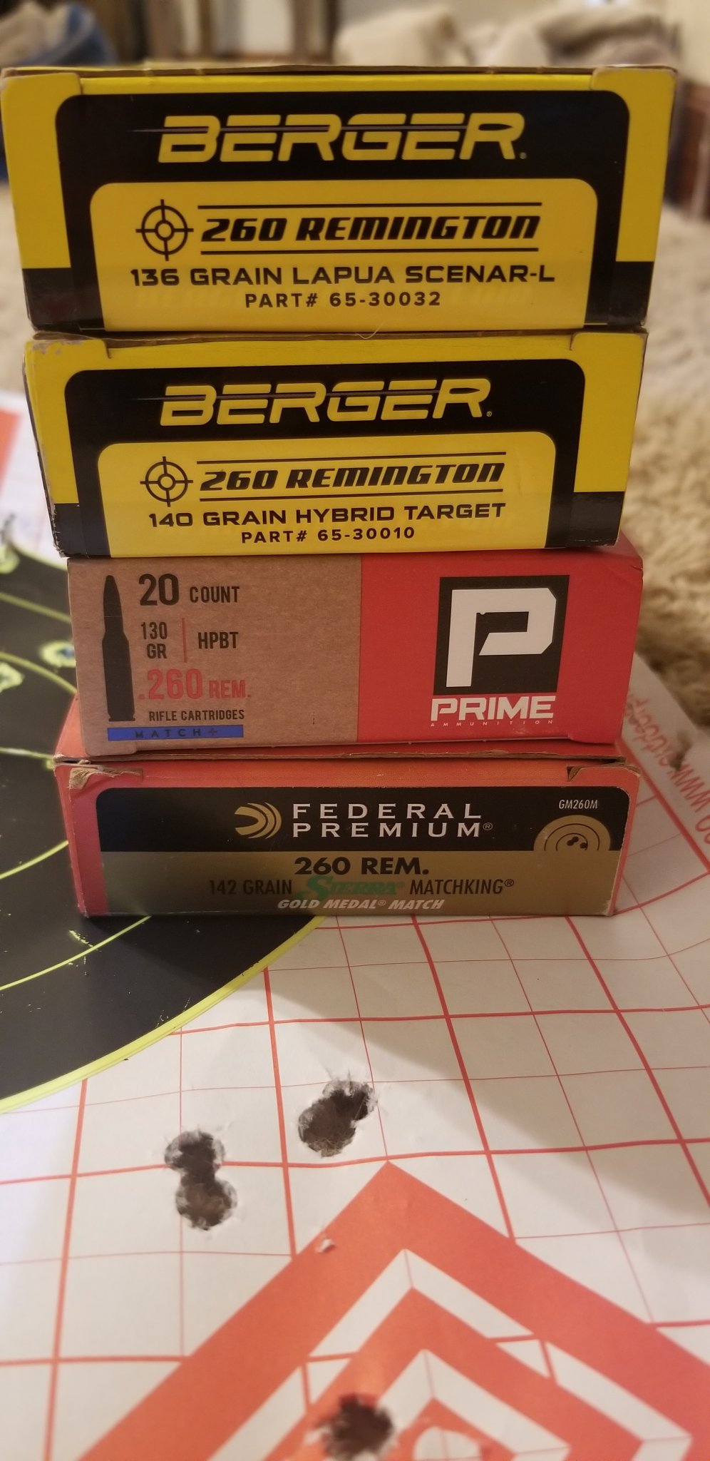

    Ammo flavors:
    -Berger 140gr Hybrid Target
    -Berger 136gr Lapua Scenar-L
    -Federal Gold Medal Match 142gr SMK
    -PRIME 130gr HPBT

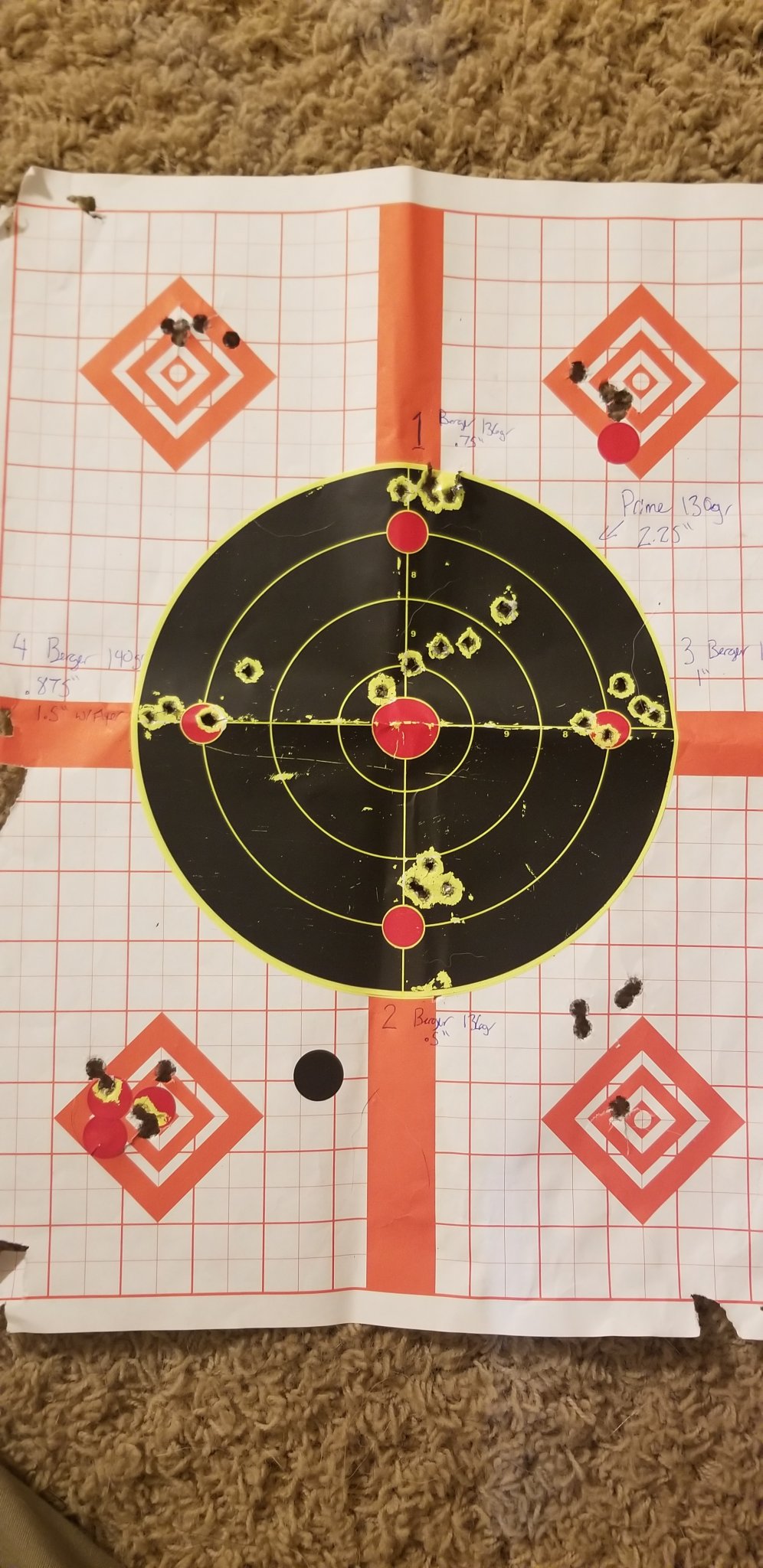

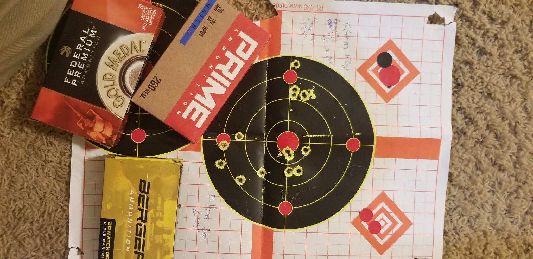

    The Berger Lapua Scenar-L shot the best in my rifle.
    The Prime ammo was a big let down. My rifle just must not like it.
    Each ammo was only fired 10 rounds. Will repeat this test next time at the range.

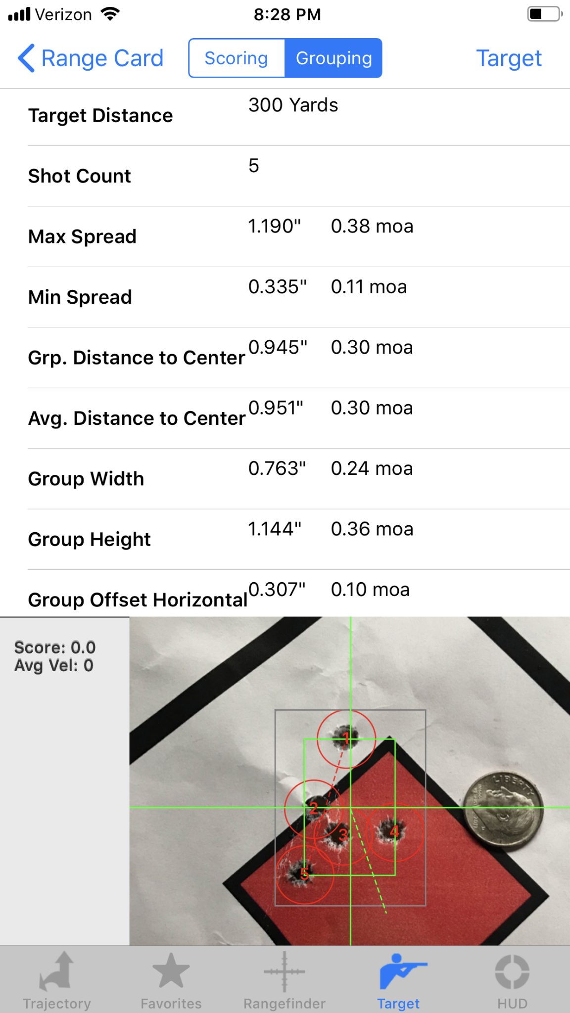

    Best ammo I shot today was some reloads that were sold to me with the rifle. Best groups was a 5 round groups in 2 holes at around .3" hoping I can get the load data on those rounds. They shot lights out.
