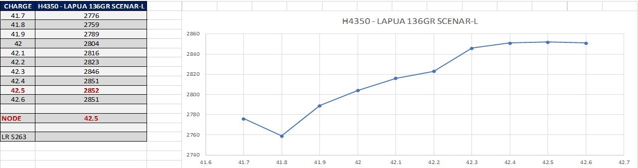

Thanks for all of the comments. I’ll hopefully get my test rounds loaded and fired this week. I’ll post my graph when I’m done

So, I landed at 42.5 grains of H4350 with the 136 Scenar as my “winner”, but now I’ve got a problem as I only have about 1/2 pound of that powder left so that’s not going to last much longer until I can find more of it.
