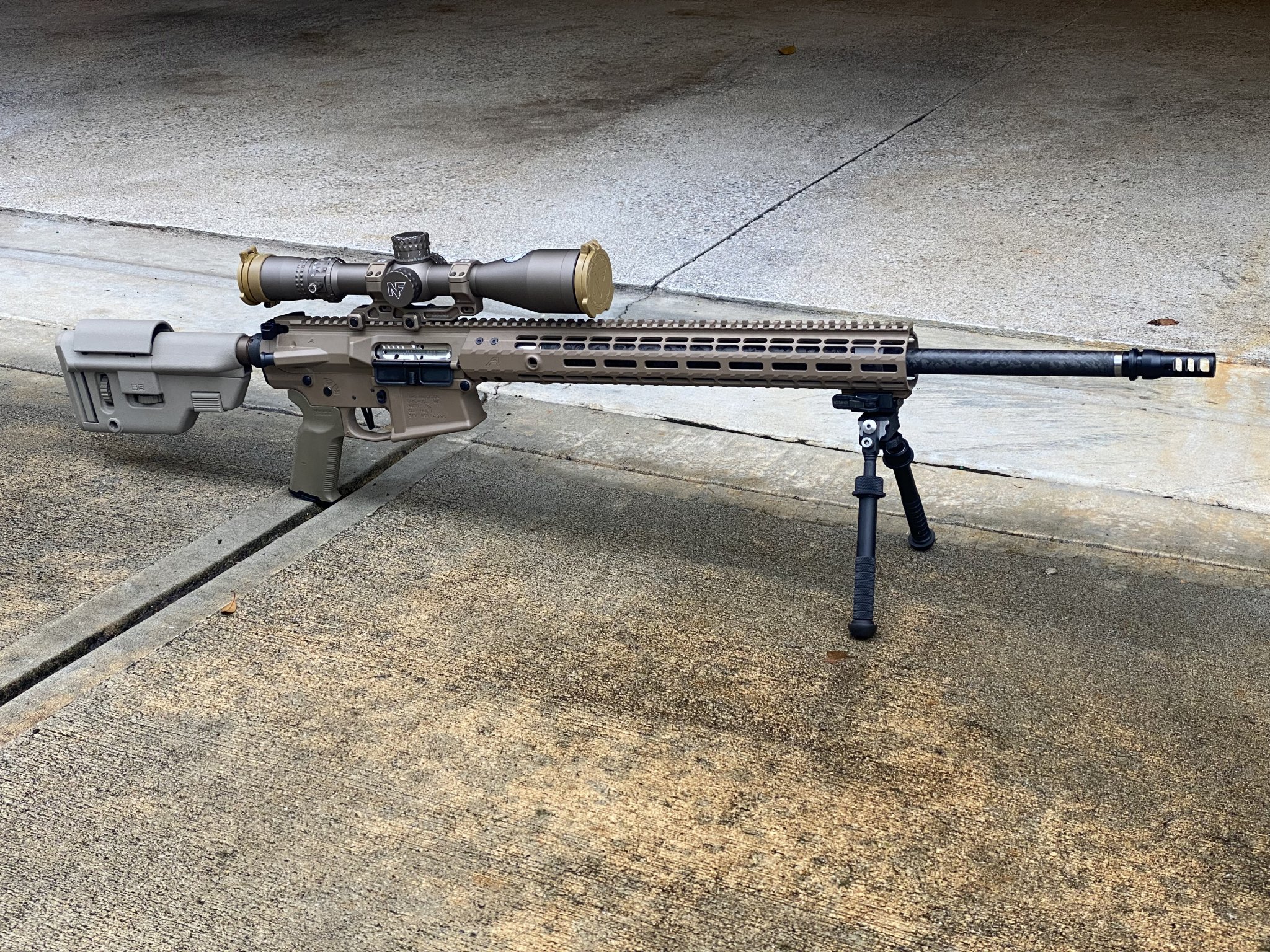

my load data for my PROOF CF AR10 6.5 CM is 40.8 gr H4350, CCI450, Lapua brass, 140 ELDM, jump .015. Muzzle velocity measured 2740 fps, around 10 fps SD, the accuracy is consistently 0.5 MOA. This is the footage of me shooting a cold bore 0.51 MOA 5-shot group with this load using a sandbag and bipod:
also very easy to hit small target at 700 yards. This AR10 is just as accurate and fun as my AIAT high-end bolt gun:
This barrel & cartridge combo is hands down the easiest I’ve ever messed with when it comes to load development. It’s not picky at all, but maybe it’s just 6.5CM is super forgiving. I dunno…

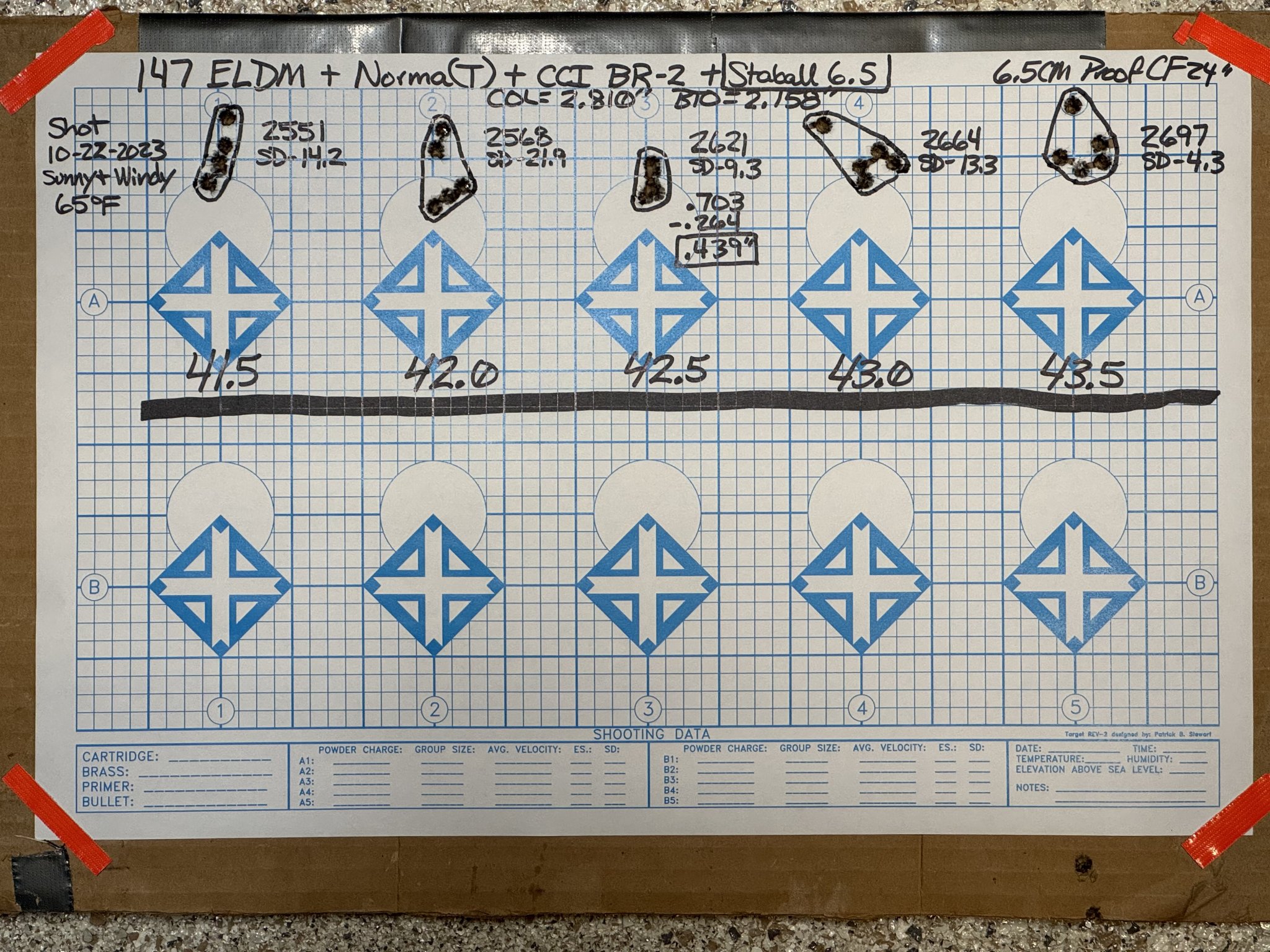

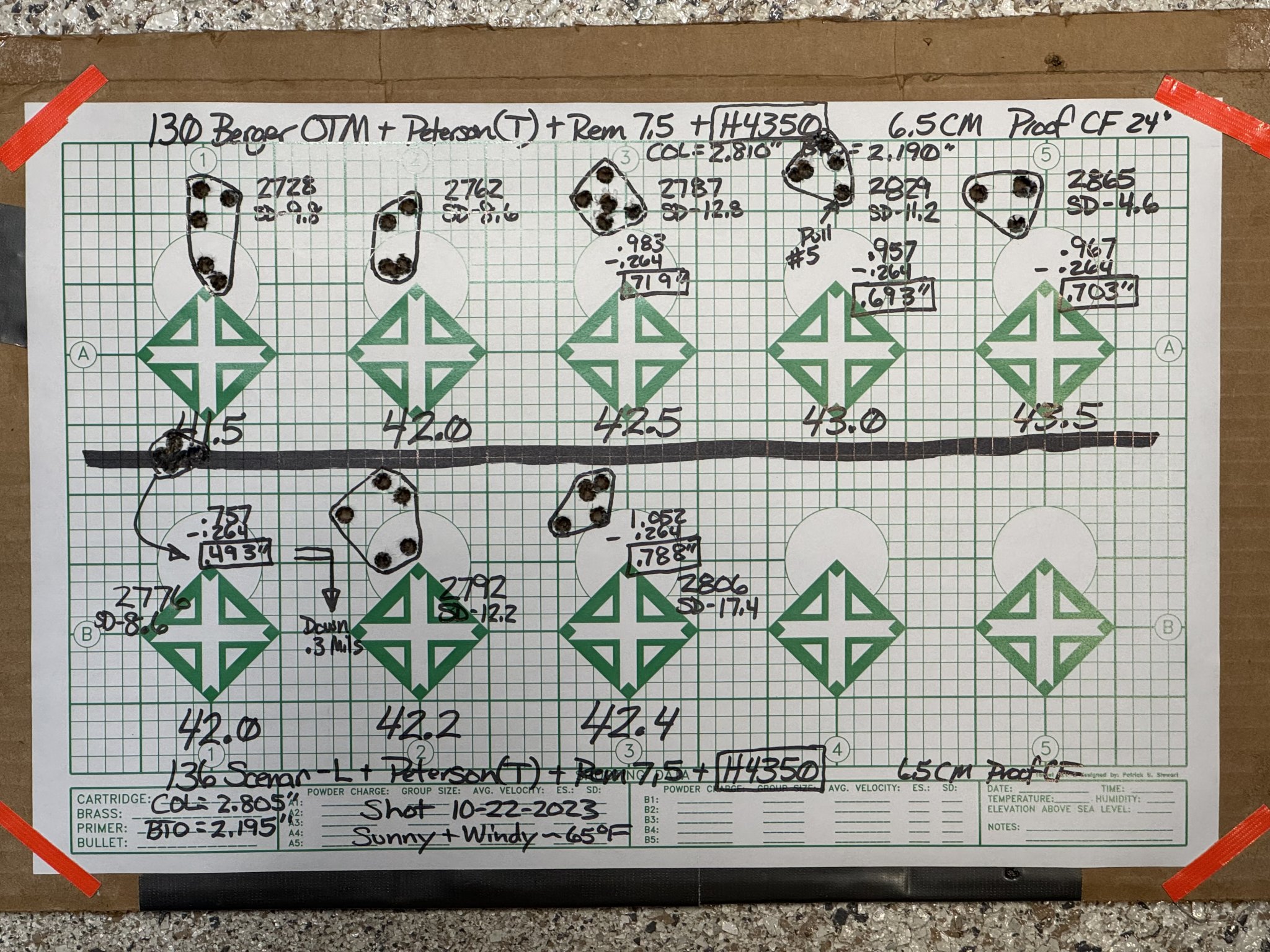

You have everything you need to build a very accurate load.
H4350 is where I would start. You likely will end up in the low 40s. Either ELDM will work fine. Just don't push them too hard. They will come apart in flight, particularly with a fast twist barrel.

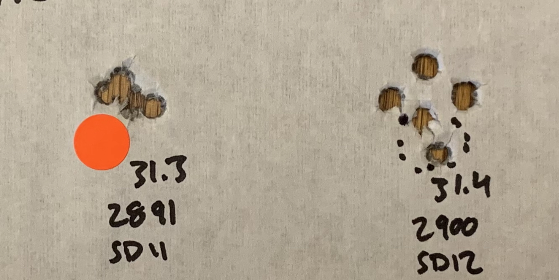

Likely so the aiming point is not obliterated. I always set the impact point away from the aiming point when shooting for groups on paper.
For me, I zero at a 50 yd range, for a 35 yd zero. Ergo point of impact should be 1.6 inches high. I was wondering if he was doing something similar. If I am just shooting or doing load development I adjust the scope to hit center of the point of aim. Then any deviation whatsoever must be the load components. Assuming I am doing my job and aiming properly lol.
I always shift my POI down or up 1”-2” from my POA so I don’t shoot out my aim point. Sighters are typically shot at a separate target board.
I guess I don’t understand the concept. Whatever point you are trying to hit will get shot up after enough rounds anyway. I always have extra targets so I can have clear analysis of my results.
The only time I intentionally get a different POI from POA is when I am zeroing, as described in the previous post.

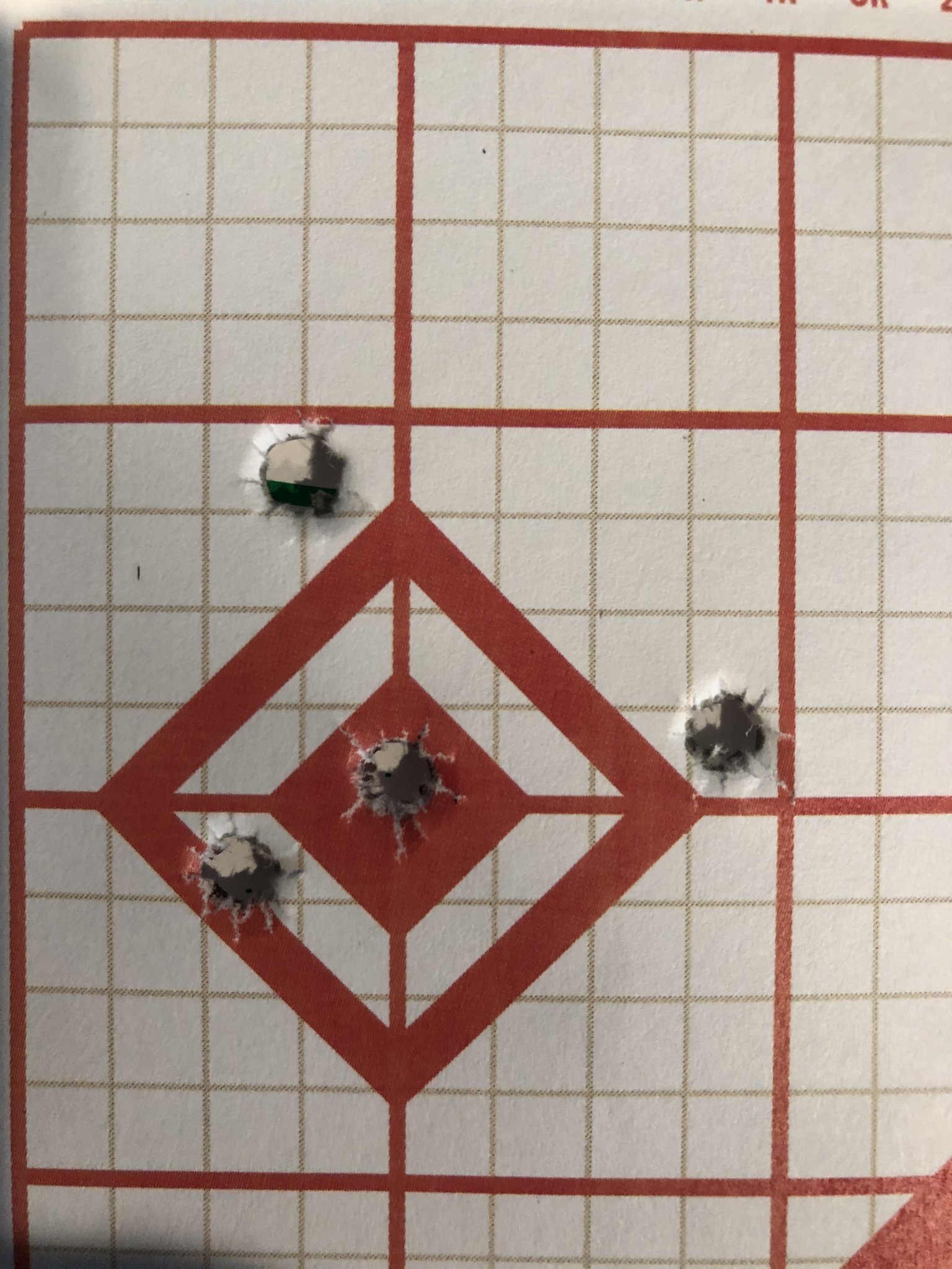

If you shoot well enough that you obscure your aim point, you will immediately cease to be shooting well enough.
Here is a pretty obvious example. First one was low and sucked the sticker through and had to guess on the rest
Here is a pretty obvious example. First one was low and sucked the sticker through and had to guess on the rest View attachment 8305762
I use different targets. Even if I obliterate the POI I still know where it is. My targets have a box within a box. Not just a dot.
I do get what you are saying. I prefer shooting longer than 100 yds, and at typical 300 yd range my groups are not quite that small.
when I am load testing, I dont jack around getting my scope on the bullseye.
Im seeing how stuff shoots.
Not if I can hit the bull….
An inch off each aiming point still gives me the information I seek.
Once I settle on a load and COAL, then I set the scope to smack center……
