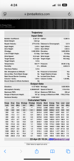

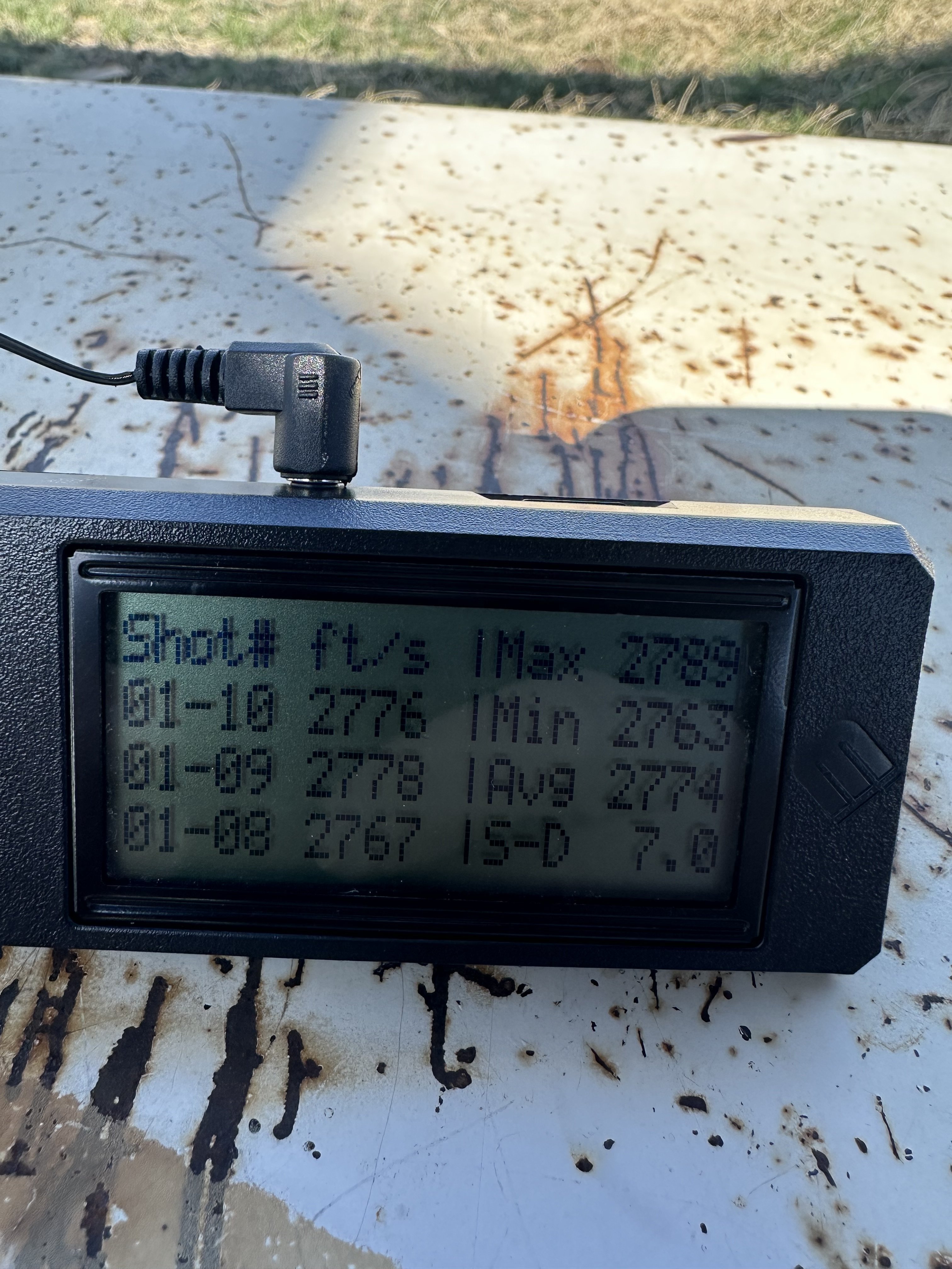

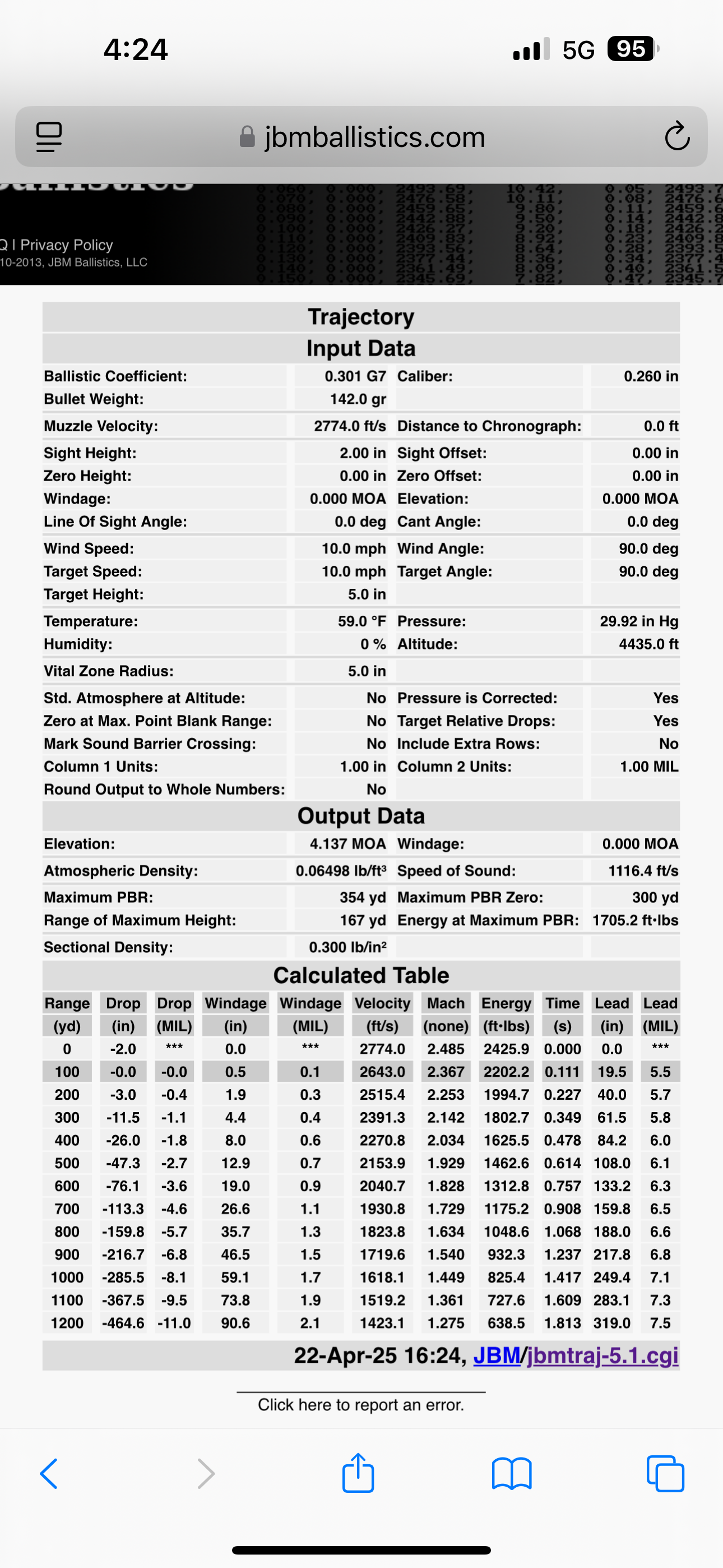

I think I've found my load for now, 44.0gr N555 with a 142SMK @2733. Shooting small and seems to do well in the wind. The TAC A1 seems to be throated perfectly for this bullet at 2.895. At 130 rounds down the barrel it seems to be settling in now. It also amuses me that most of the people I shoot with have no idea what 260 Remington is :ROFLMAO:

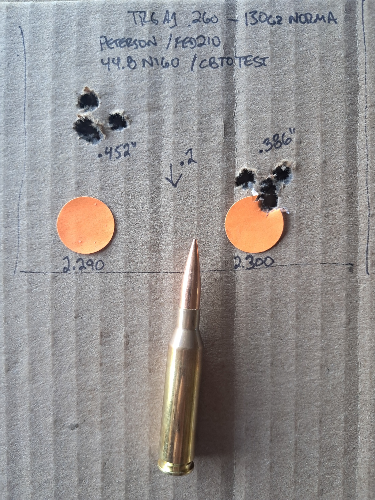

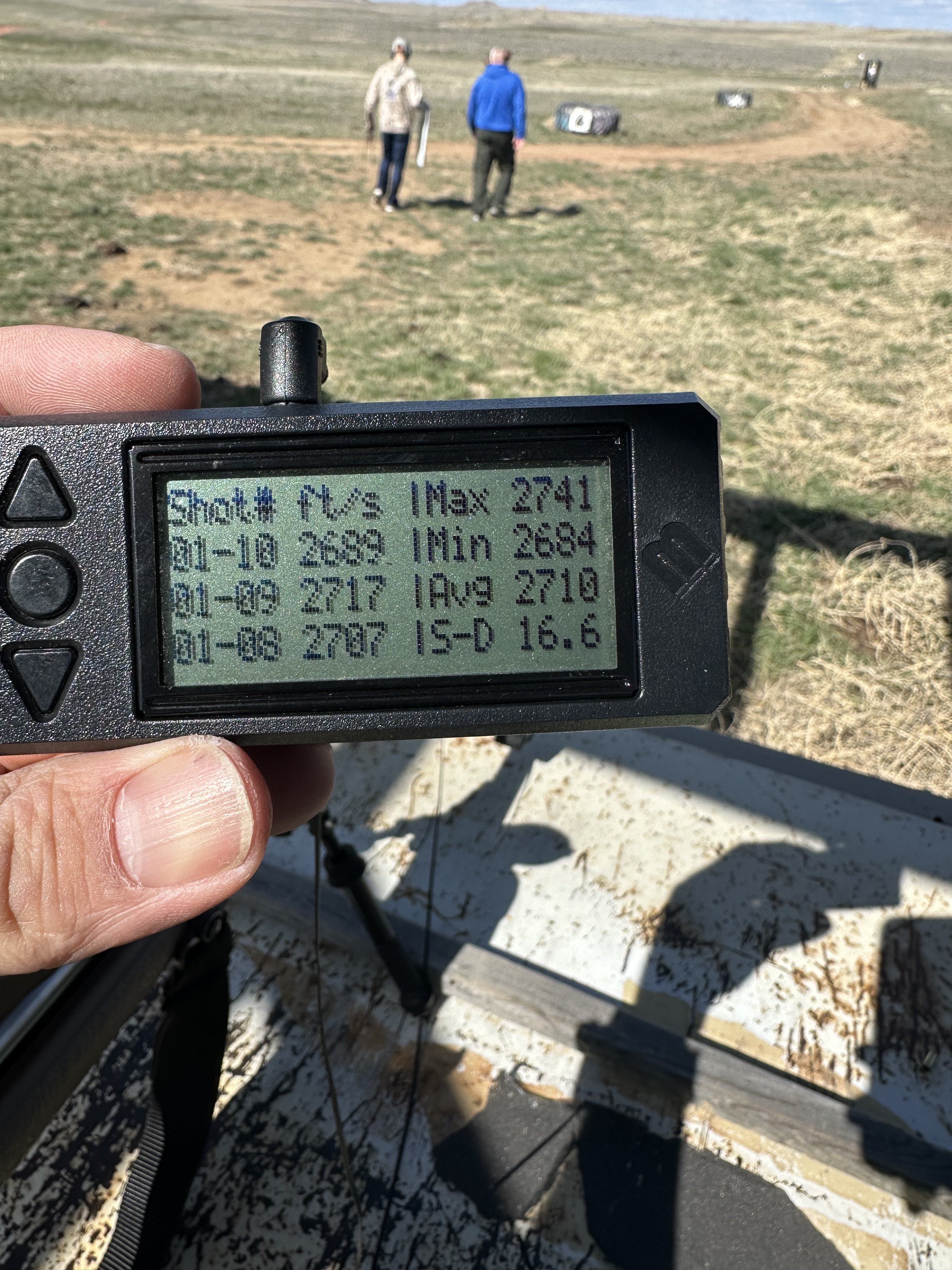

Shot a quick 5-rounder at 650 yards to verify that my old, cheap chronograph was giving me a correct reading of 2,800 FPS...it was dead-on.
The load (I cut the seating depth difference):
And when I verified that it wouldn't suck at 250 a couple weeks ago (about a half-minute again):
2,800 FPS
Sako TRG A1 (26")
130gr Norma GTX
44.8gr N160
Fed 210
2.295 CBTO
