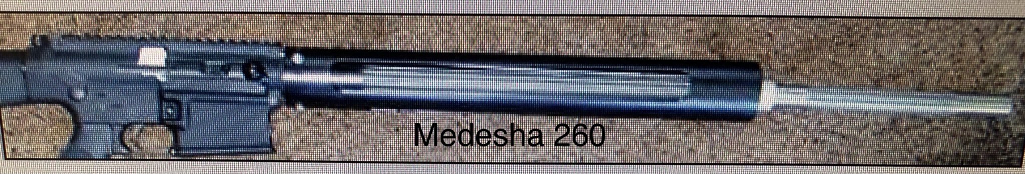

My 700 Remingtons are trued actions the ARs are Armalite AR-10s
This is my Medesha AR-10 upper, it shoots .13 in the AR-10T lower with NM trigger.

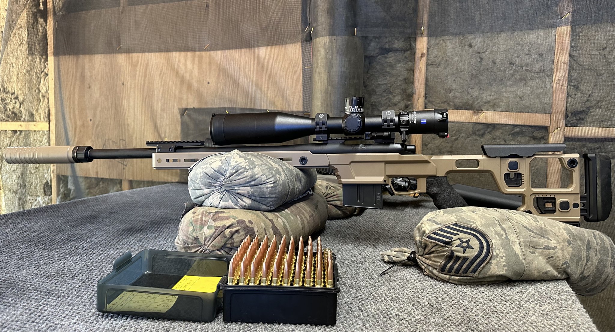

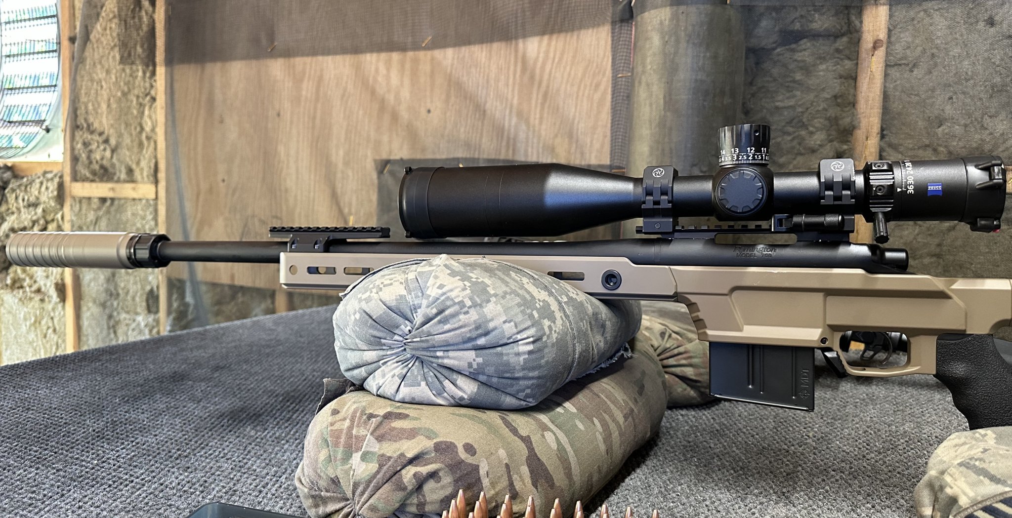

22" R700 5R Milspec .260 Rem in an Aero Solus 15" chassis w/ Ergo Suregrip & MDT mag. Zeiss LRP S3 6-36x56 ZF-MRi (MRAD) scope in ARC M-Brace 34mm Low rings on EGW HD 20MOA base. TriggerTech Special w/ screw removed. And Otter Creek Labs Hydrogen-S 6.5mm w/ DA KeyMo setup.
Target load: Nosler 140 Custom Comp (or RDF) with 38.0gr Varget in Lapua .260 Rem brass and CCI 200 primers. Shoots nice cloverleafs, good enough for banging steel at distance.

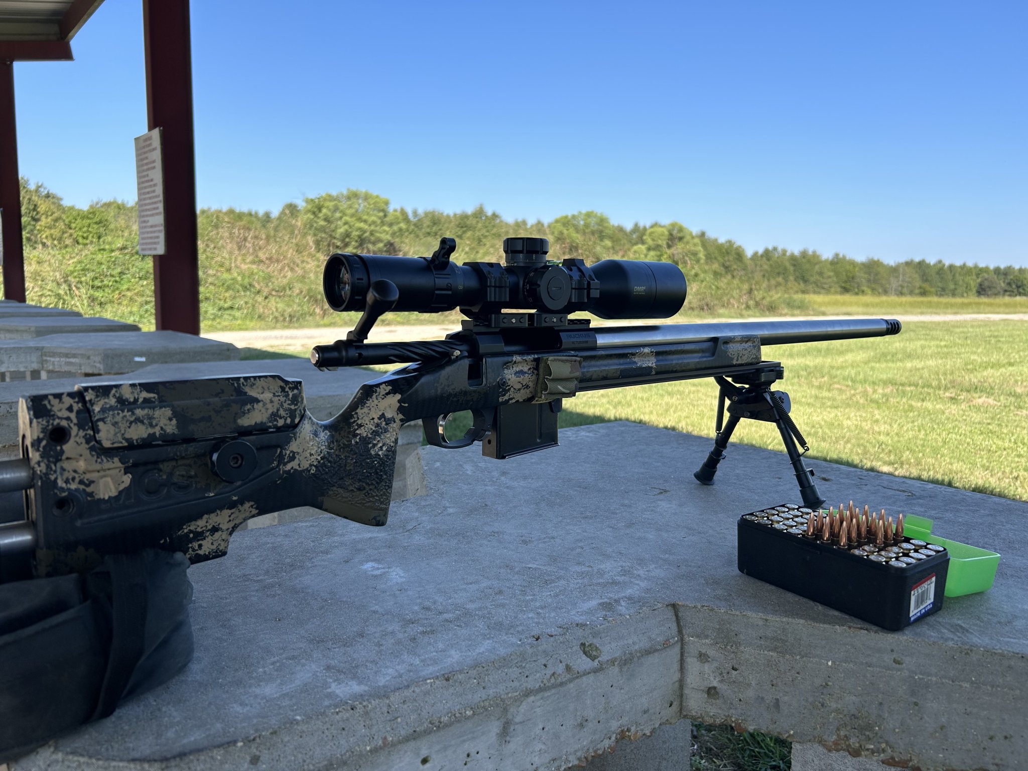

Finished her up yesterday. Just threw this together with Sierra load data. I’ll have 50 rounds down the tube after today. I’ll get down to business with real load development in the next few days.
Defiance Rukus action
Custom rifle barrel @27.5”
Manners TCS
Bushnell DMRII
