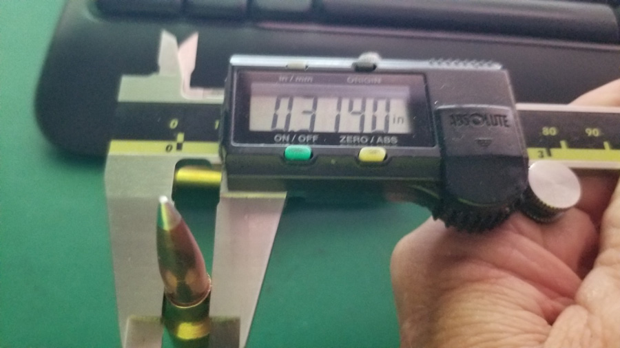

W Wannashootit Gunny Sergeant Full Member Minuteman Sep 3, 2010 2,283 591 FL Saturday at 8:31 PM #1 Saturday at 8:31 PM #1 Looking for loaded neck diameter...trying to order correct bushing with the sizing die and save a step...
Hula Popper Private Minuteman Jan 16, 2024 34 40 Florida Yesterday at 3:12 PM #2 Yesterday at 3:12 PM #2 FWIW: Peterson 284 Win brass: Lot #K120, received 11-2023 Pic 1: 180 Berger Hyb Targets, 0 fired case. Dia = 0.314 Pic 2: 166 A-tip, 2nd firing on case, fire formed to 284 Shehane. Pics don't show it, but measurement taken at mid-height of neck at mid-point of caliper blades. YMMV. Good Luck
