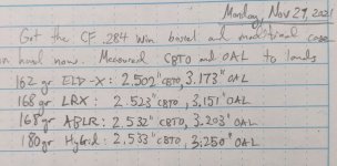

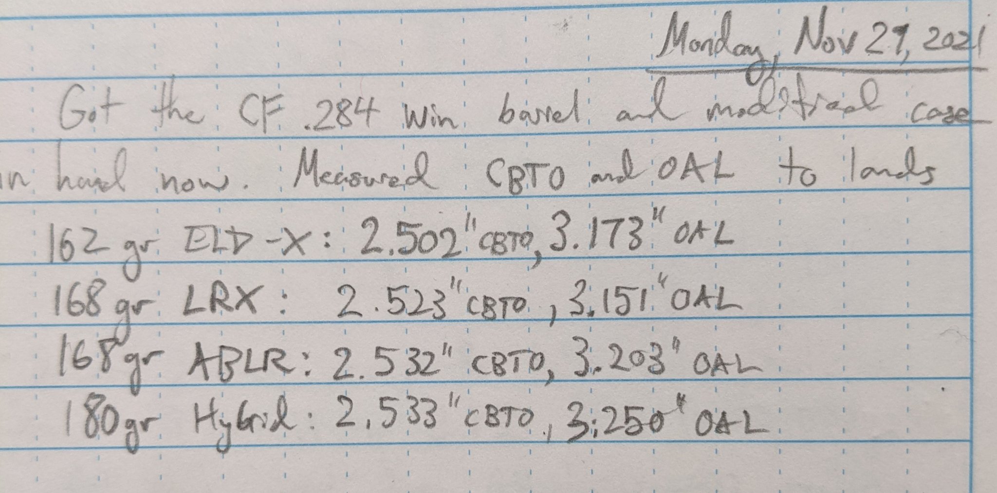

Long. Here are OALs to the lands in my X-Caliber prefit. Works great in my Tikka, more of a medium action.

Medium would probably be ideal for the 284, but long works fine too (provided it is tuned well to feed the rebated case, or have a Mauser type extractor) had tikka with 3.5” mag length (no problems), mausingfield la cip length (no problems) and archimedes la (occasional feed issue). The coal in the different 3 barrels ranged from 3.18-3.255 so realistically the medium is probably a better fit if you can find a chassis you like and get the xm magazines
