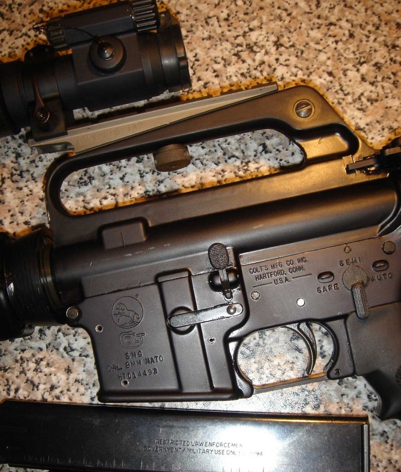

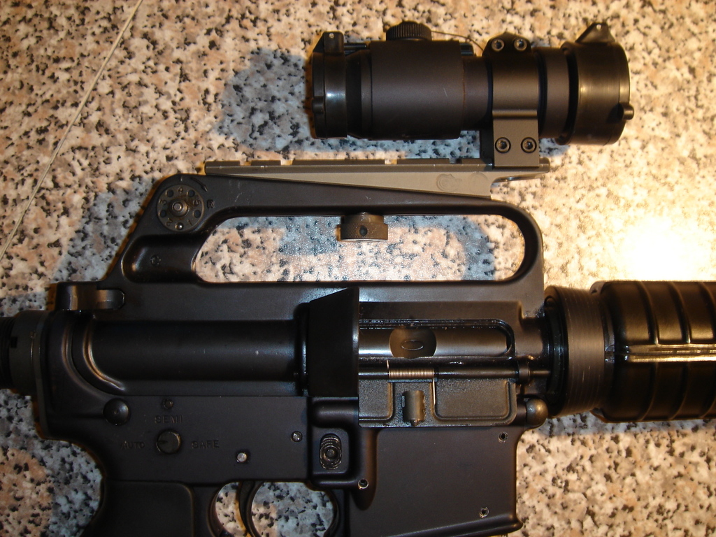

    Yeah, Colt SMGs had three pins through the lower. Your block didn't come with any kind of drilling template?
    Think I'd want to use three pins just to make it easier to replace ejectors should the need arise.
    Could scale these pics (from wikipedia) 1:1, print 'em out, and use them as templates:
    View attachment 7509881View attachment 7509882
    Well, that's not the problem. From what I can tell the two piece units had three pins, the one piece units only have two. And it doesn't really matter EXACTLY where the holes go --they just have to go roughly in the right place. Through the solid parts of the block. What's more important, from what I've read, is that it works prior to pinning and that when you drill it that it doesn't move.
    They don't come with shit. They don't even come with the damn roll pins, instructions, nothing. Sure it's meant for gunsmith installation but a pair of pins and a drawing with a couple x's would have been nice I think.
    I'm considering using a pair of vice clamps and leather pieces to clamp the block in place once it's working and while I drill it. That's what I'd like to know from those that have done it --what did you do to keep it from slipping out of place? Or is it not really a problem because the mag release and friction sorta keep it there well enough to do the deed?
    Think you'll ever need to remove the block? You could glue (epoxy) it into the lower and drill straight through once the adhesive is cured.
    Or, how about drilling an undersized hole through one side of the lower (where you need a hole anyway), tapping it for a set screw, and fitting a pointed screw to hold the block in place. Drill the other hole and pin it, then drill through the first hole for the second pin.
