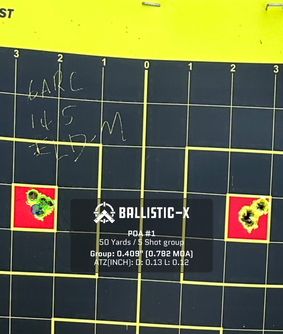

How does the 14.5 group?

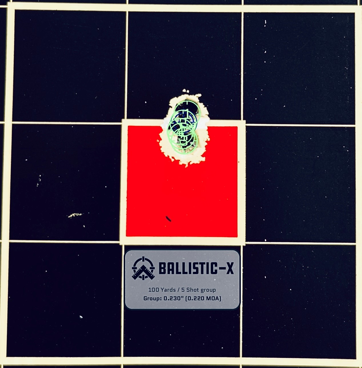

I was going to say roughly 0.75” I was guessing with ELD-M. So, I measured one of the last two five shot groups I shot with it.
Below is a group from a new 14.5 SS Proof Research barrel & factory 108 ELDM. I've had two Proof SS 6 ARC barrels (16" & 14.5") and both shoot consistently sub MOA with the 108 ELDM factory ammo.
Just so I’m clear…as there are some 50y groups and wonky shit these days….
You’re saying this is:
5 rounds
100y
Factory Hornady ammo
Out of an AR

They are dumb accurate everyone is getting way under half inch groups with factory loads and yes 100 yard groups. I’m building a craddock 18” right now but I’m gona grab one of these in 18” when I’m not poor lol

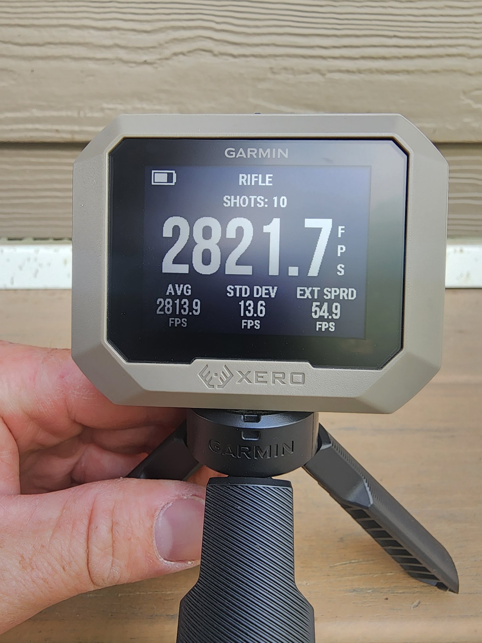

Here are some recent velocity/SD numbers (10 plus round sample size) with brand new Proof CF barrels shooting Hornady 103 ELD-X:
18" 2627 FPS / SD 12.2 FPS
18" 2629 FPS / SD 10.6 FPS
16" 2568 FPS / SD 13.4 FPS
All were sub-MOA, with one 18" breaking half-MOA in the last of three groups and the 16" going half-MOA on the second group. That's with a 75 year old wearing trifocals shooting off a bipod. :ROFLMAO:

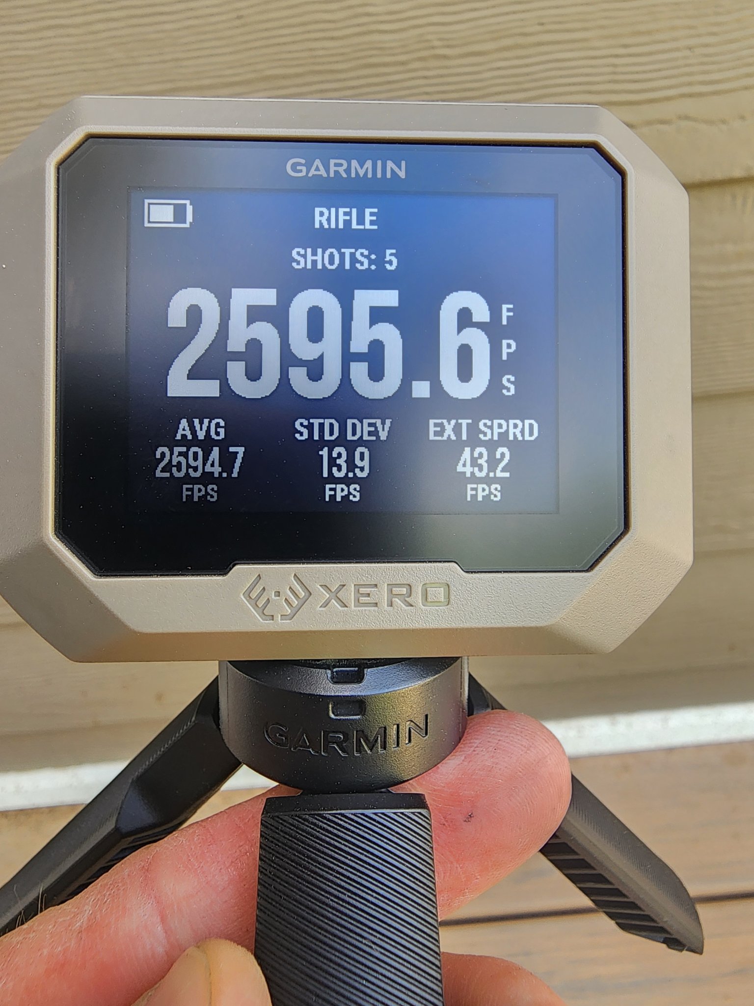

I've got an 18" SS Proof that is averaging about 2615 with Hornady Black 105gr, with about 225 rounds through it. Easily sub minute with that Black 105gr. Have not run any ELD-M Match factory loads through it, or any other factory loads. No hand loads.
Accuracy has been around half MOA or just barely larger for me. SD has been in the 13-15 range. I haven't played with the 106 Atips yet. Eventually I will get some to try when I actually get to loading for this. What velocity are you getting with the 106 TAP?

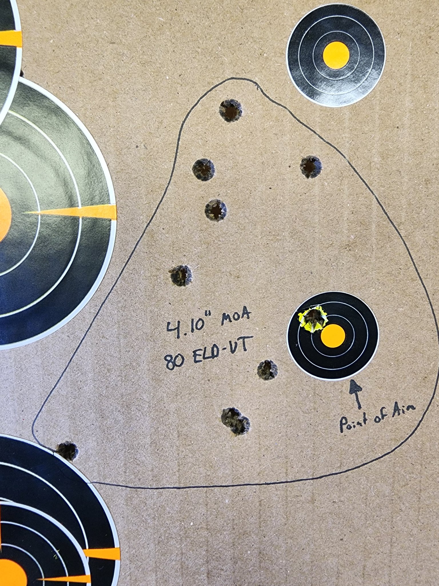

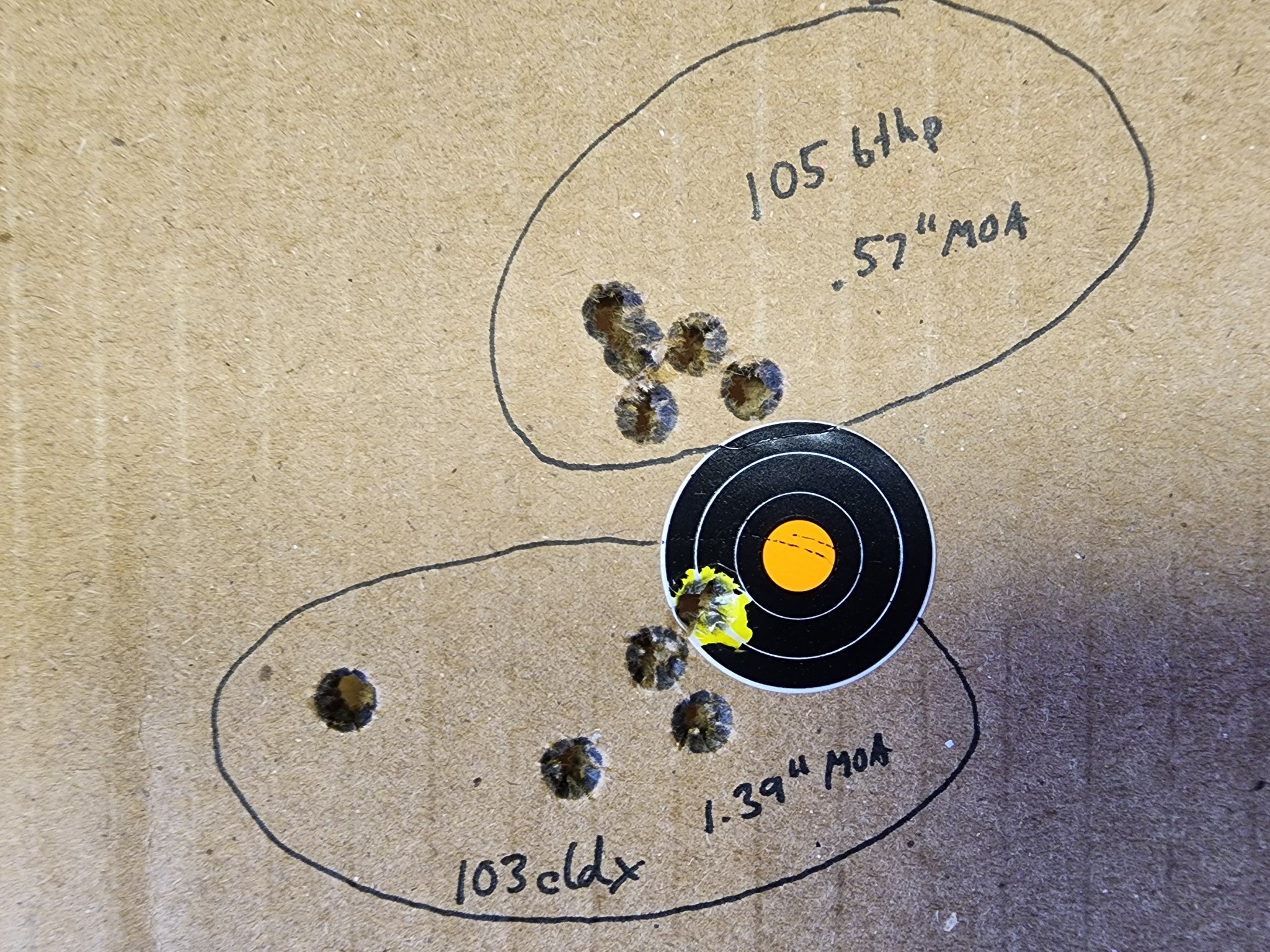

I picked up this 18" Geissele GFR used here on the hide. Here are some my results with factory Hornady ammo. Can someone please tell me why the 80 eldvt is so bad in this gun? I really want that bullet to work.
105 BTHP "BLACK"
80 ELD-VT
103 ELD-X
I can't speak for the GFR, but my 18" Proof SS behaves the same (ELD VTs are 2.5 MOA). I do not know why the VT doesn't work as well, but I did find a 0.8 MOA load of 75 VMAX over TAC pretty easily (no seating depth testing yet). I've not shot black or ELD X out of this one yet.
105 BTHP "BLACK"
80 ELD-VT
103 ELD-X
105 BTHP "BLACK"
80 ELD-VT
103 ELD-X

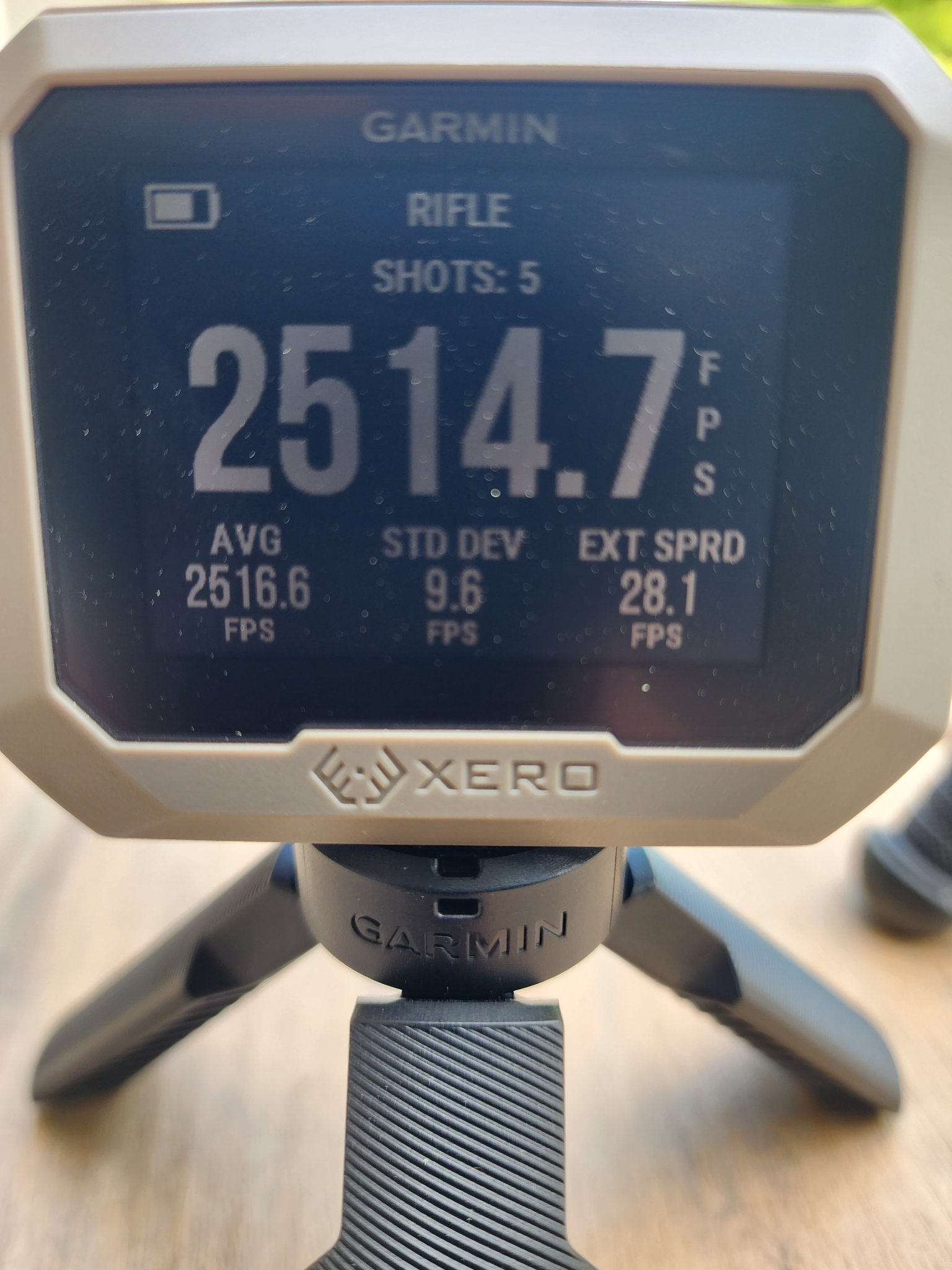

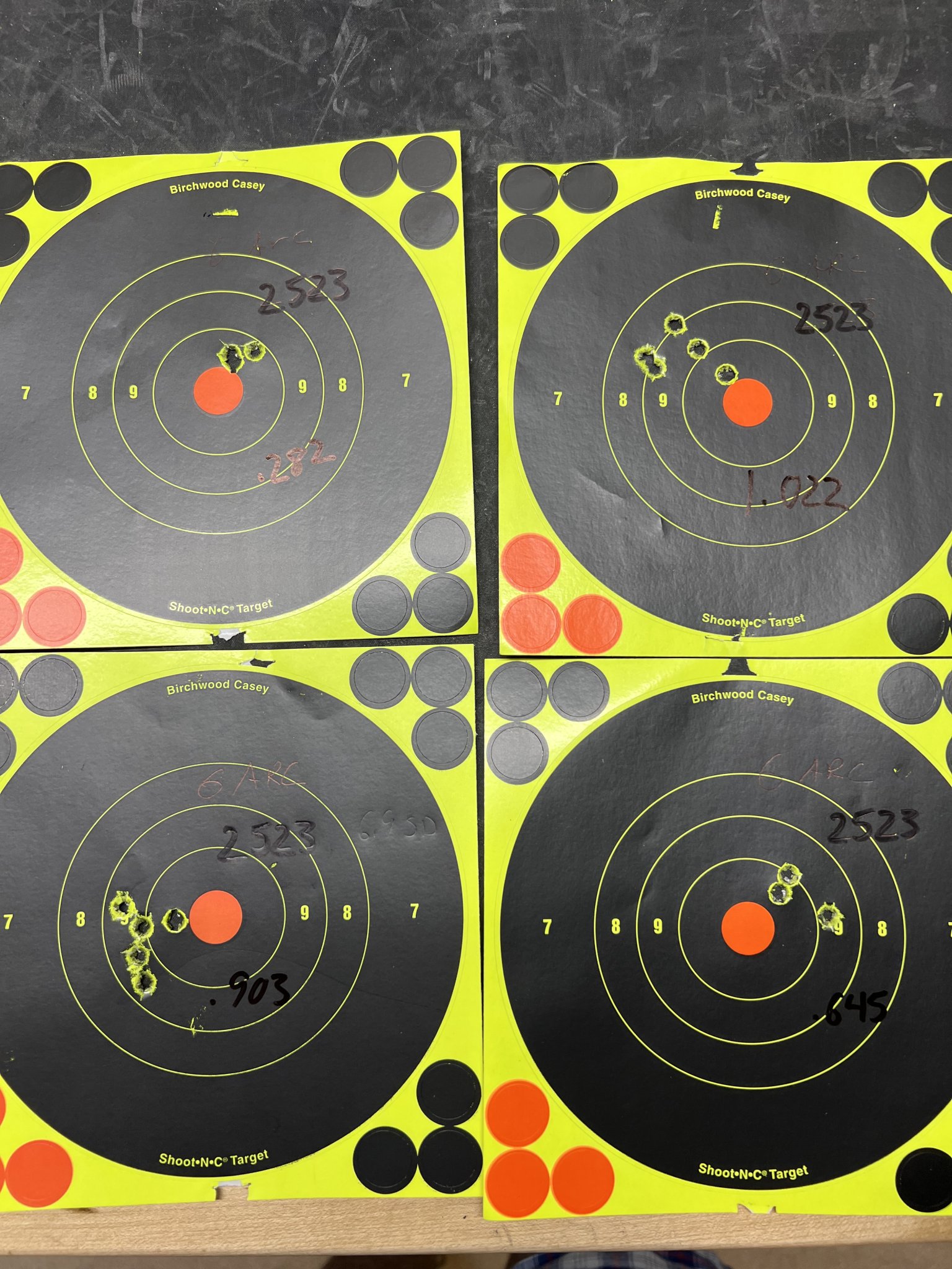

My first four groups out of my Geissele 18" GFR using factory Hornady 108s. Velocity 2523 with SD 6.9. Anyone try 106 TAP?
I was getting .5-.8 moa 5 round groups from my 16” Proof with 108s and the 106 TAP did around a 1.5 moa average.
I’m guessing the 106 TAP is loaded to meet barrier and terminal performance requirements first and foremost. I’d like to see if anyone has any different results.

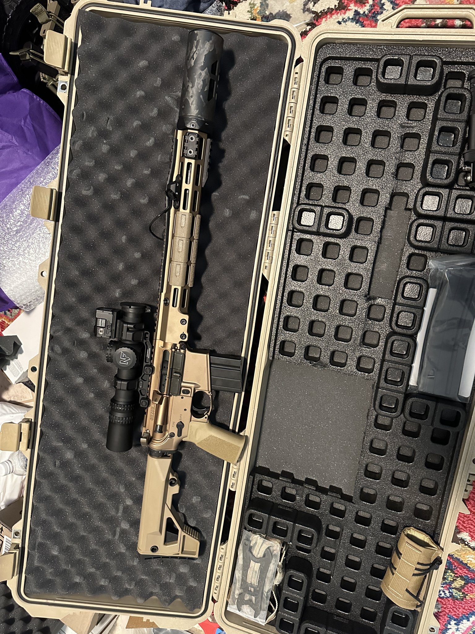

Anyone have feedback on the 14.5” variant? I’ve got an 18” arc but want something a little more handy (don’t have the GFR but the guys using these probably have the most experience)
I have the 14.5” one and the 18” one. Each one seems to really serve its own role with me. The 14.5” is definitely a little handier and lighter. It has functioned flawlessly with both ELD-M and TAP. My 14.5 does not group as tight as the 18”, but it has never grouped worse than 1MOA :). The barrel profile appears to be lighter on the 14.5 than the 18. I have tried it both with a NF ATACR 1-8 and a 4-16. It really needs the 4-16 for the legs this rifle has. The 1-8 is going to limit it on the range potential it has. I’m getting 2415fps for ELD-M and 2502fps with TAP. If you have any other questions let me know and I will try my best to answer them.
Thanks for the feedback! Glad to hear the 4-16 is warranted. You shot anything lighter? I’m running the 75 vmax at just over 3000fps (rifle didn’t like the factory 80 ELD VT) for yotes at night so trajectory matters. However, I do want better long ranger performance than the 22 arc

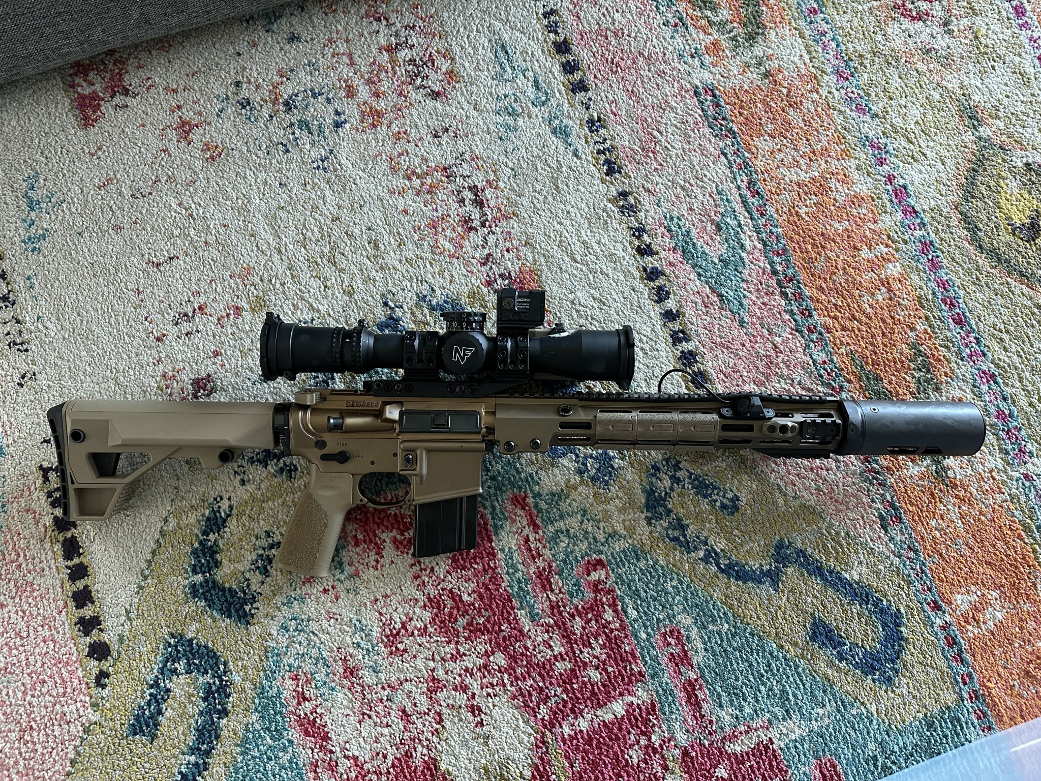

I have the 14.5 and 20 inch stratomatch back ordered. I have an optic picked out for the stratomatch but finding one for the 14.5 that’s light but doesn’t limit its range is harder than I thought. Maybe the new zco 2-10?
I think the 2-10 ZCO may be a good contender for it. A 14.5 6arc is a tricky rifle for optics selection to me. You want weight and bulk low so it is still handy, but an optic that does not cut the LR legs off it too much. I prefer an optic that makes dialing easier so if I want, I am not holding over towards the bottom of the reticle as to keep my sight picture easier.
